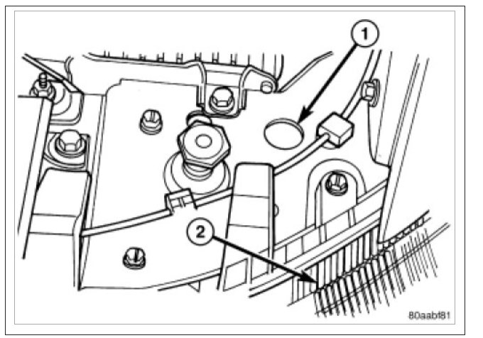

where are the adjustments for the headlights. i can not fine them to save my butt. i just want to adjust them up a little and in a little. it is no trouble to get them out i just can not fine the adjustments... thank you take care tom

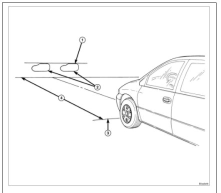

STANDARD PROCEDURE - HEADLAMP UNIT ALIGNMENT
HEADLAMP UNIT ALIGNMENT PREPARATION
Verify headlamp dimmer switch and high beam indicator operation.
Inspect and correct damaged or defective components that could interfere with proper headlamp alignment.
Verify proper tire inflation.
Clean headlamp lenses.
Verify that luggage area is loaded as the vehicle is routinely used.
Vehicles equipped with automatic load leveling suspension should be driven normally for approximately 5 km (3 miles) before attempting a proper headlamp unit alignment.
Fuel tank should be FULL. Add 2.94 kg (6.5 lbs.) of weight over the fuel tank for each estimated gallon of missing fuel.
ALIGNMENT SCREEN PREPARATION
Position vehicle on a level surface perpendicular to a flat wall 7.62 meters (25 ft.) away from front of headlamp lens (Figure 1).
If necessary, tape a line on the floor 7.62 meters (25 ft.) away from and parallel to the wall.
Rock vehicle side-to-side three times and allow suspension to stabilize.
Jounce front suspension three times by pushing downward on front bumper and releasing.
Measure the distance from the center of headlamp lens to the floor. Transfer measurement to the alignment screen (with tape). Use this line for up/down adjustment reference.
Life the hood and you can find the headlight lens adjusters here are diagrams to help (below)
