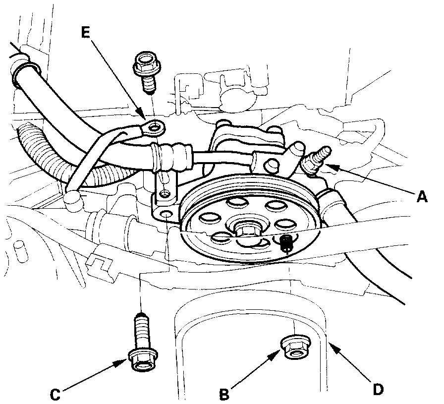

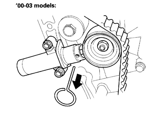

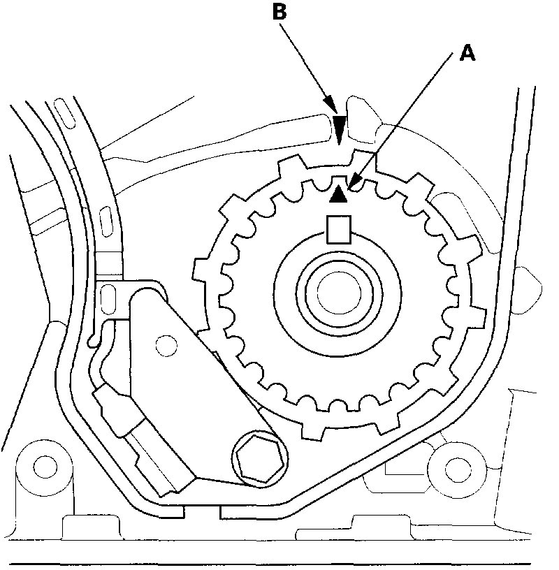

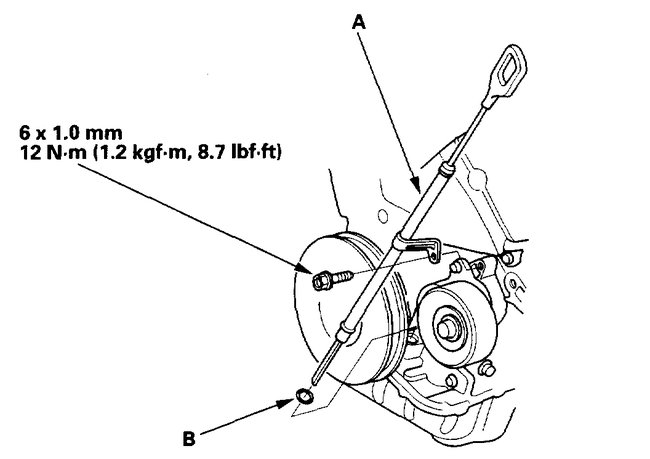

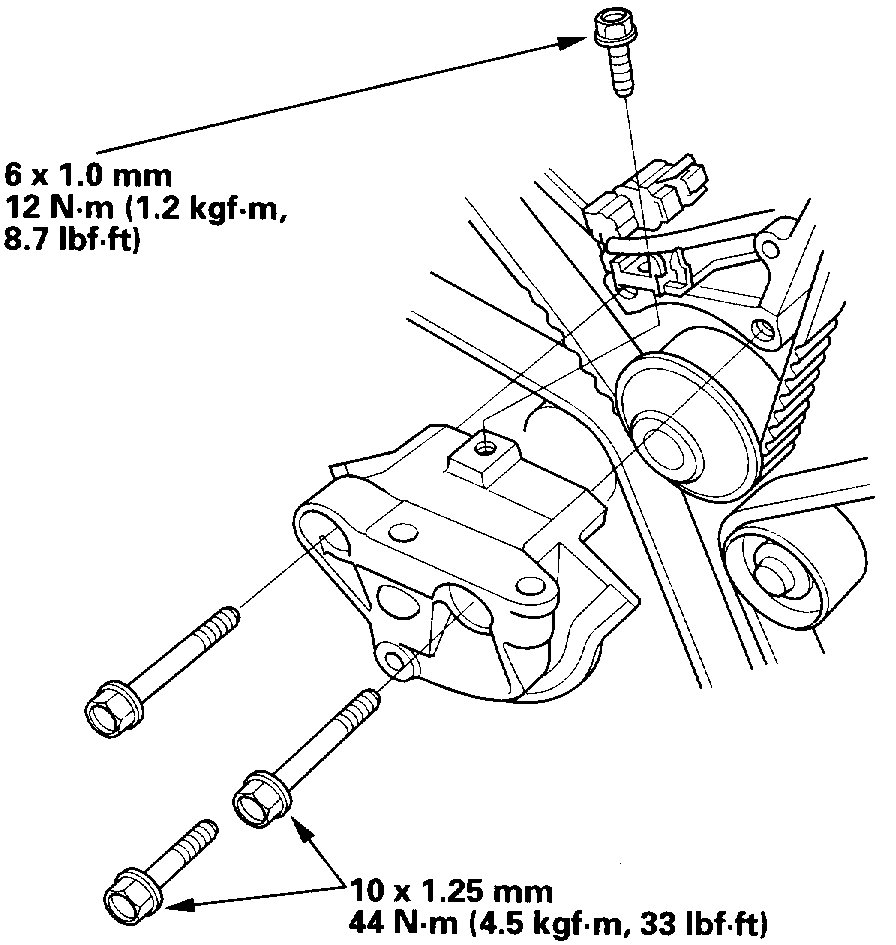

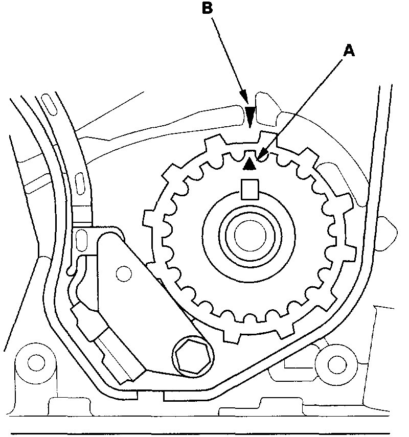

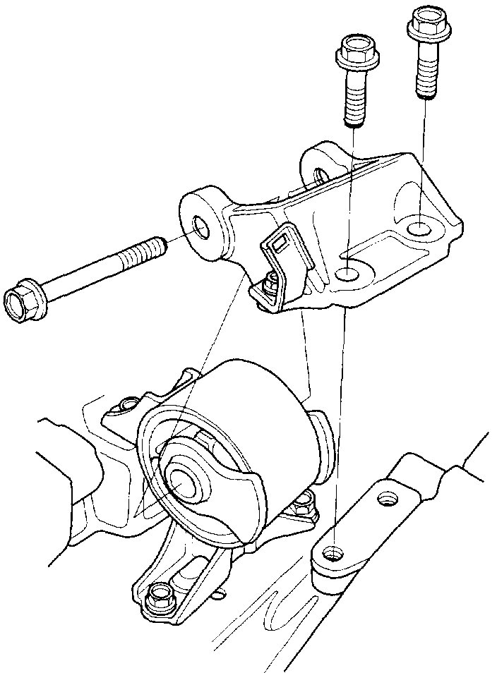

I need sequential diagrams, pictures, video, images, drawings. I learn through my eyes viewing the procedure, rather than just words.
A step-by-step procedure on what tools to use on what parts, first to remove to get to the head gasket and so on, with diagrams, pictures, so I know that it's the same car as mine. I can't afford to take my car to a mechanic. Can someone out there help me, please?
Jan 14, 2019 at 3:06 PM
  • 110,240 POSTS
Here are the directions. They are extensive. You will need to remove the timing belt in addition to the cylinder heads. The first set of directions are for cylinder head removal.

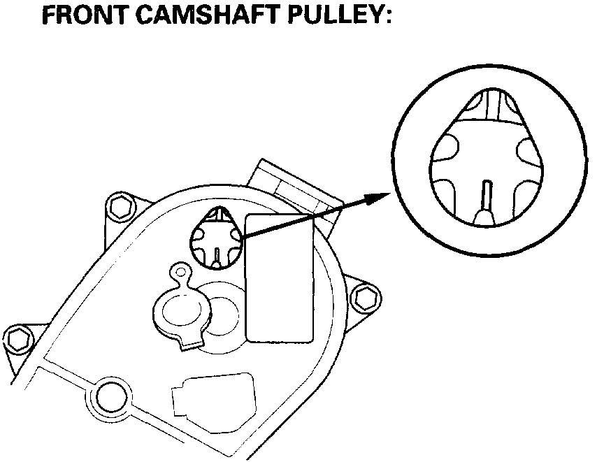

Vehicle Engine, Cooling and Exhaust Engine Cylinder Head Assembly Service and Repair Procedures Cylinder Head Removal

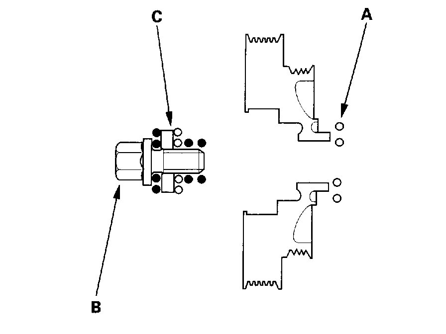

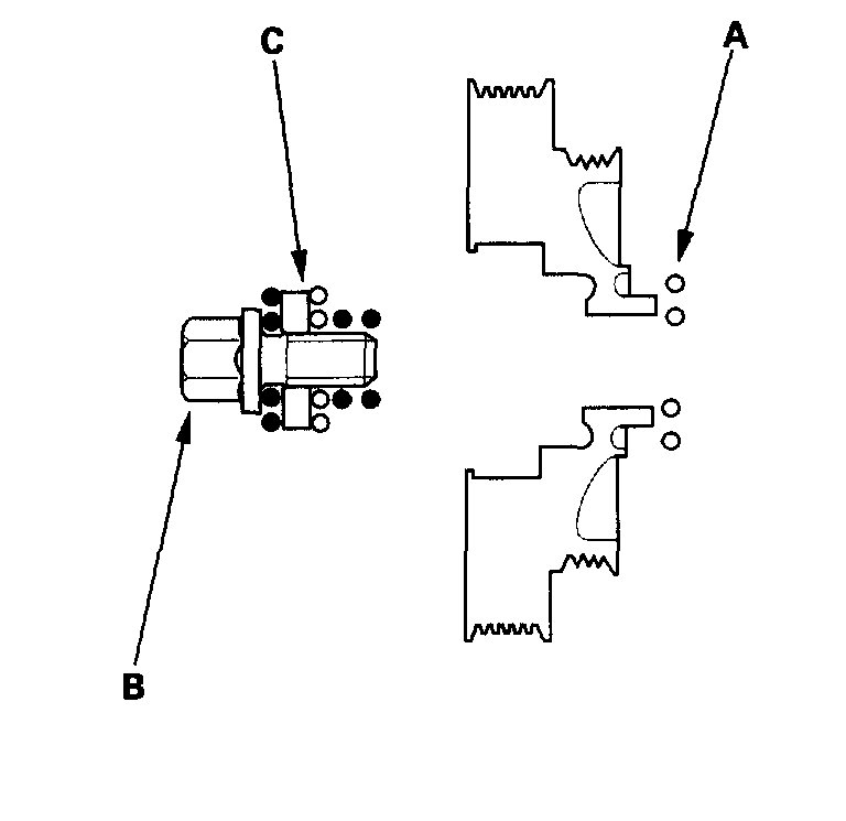

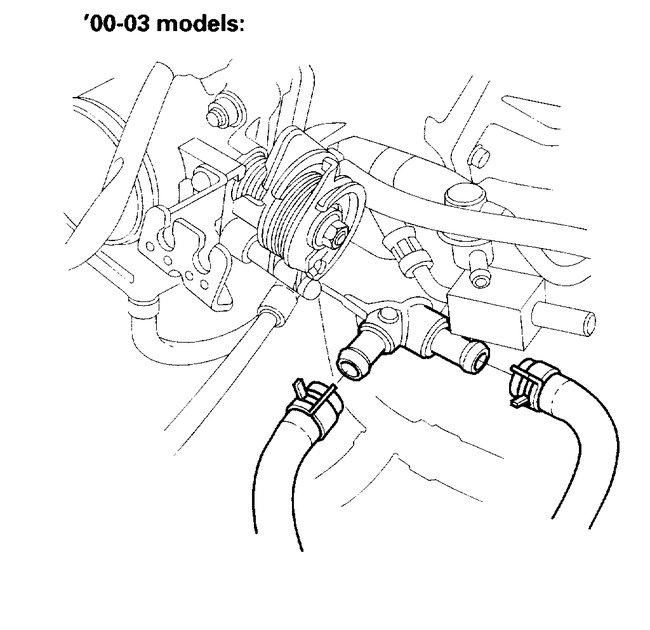

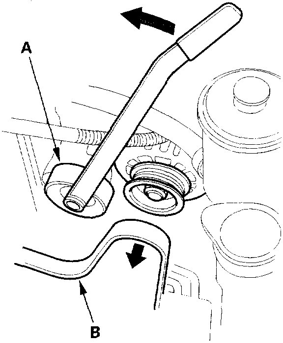

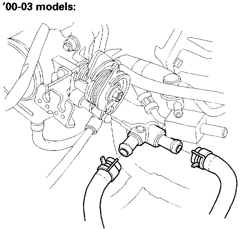

4. Remove the alternator belt.
See picture 1
5. Loosen the adjusting nut (A), and remove the locknut (B) and mounting bolt (C), then remove the Power Steering (P/S) pump belt (D) and pump without disconnecting the P/S hoses.
6. Remove the ground cable (E) ('00-03 models).
7. Remove the alternator.

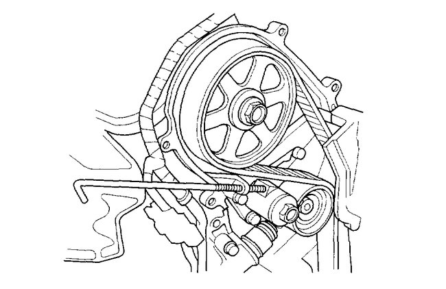

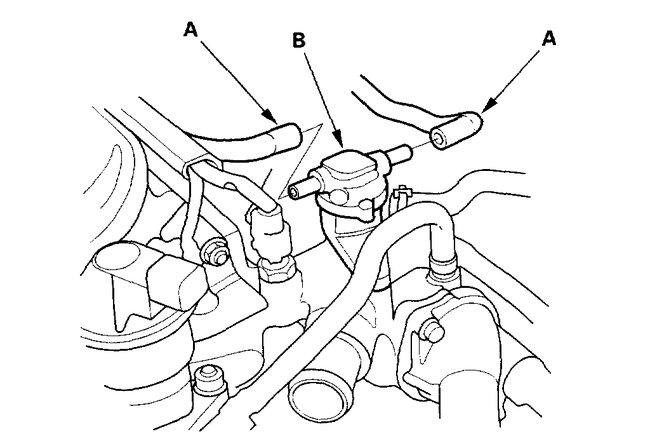

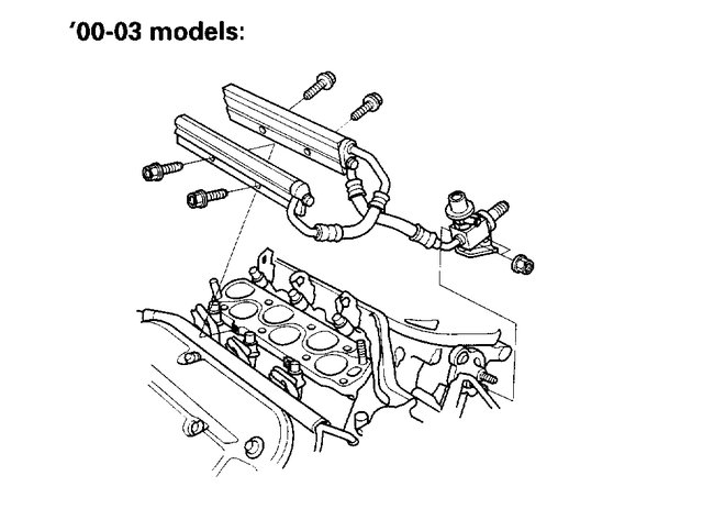

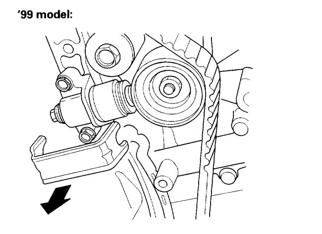

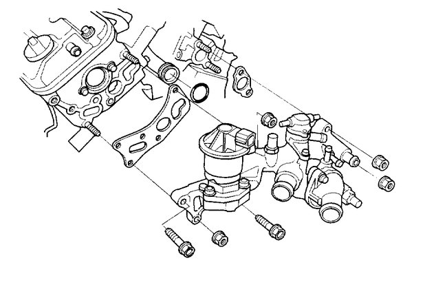

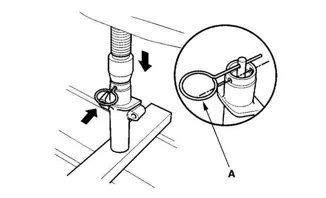

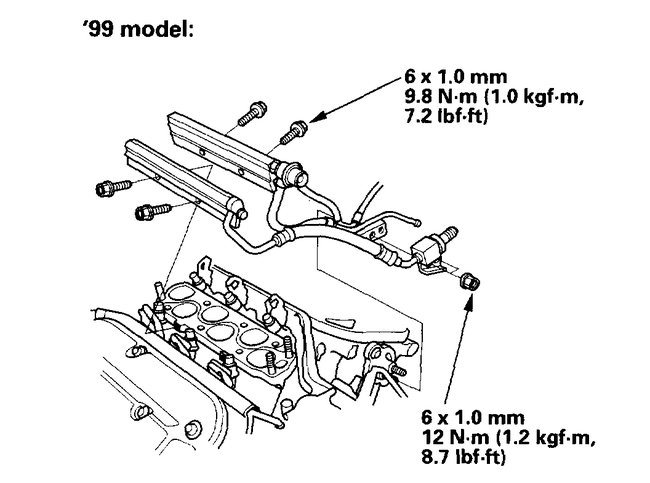

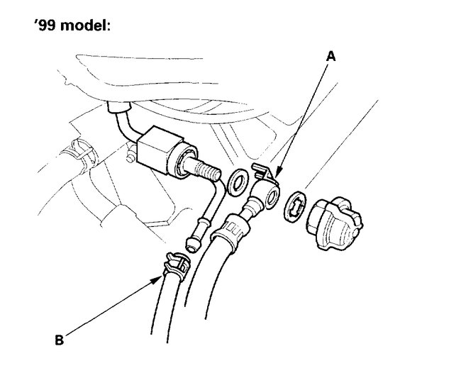

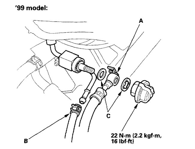

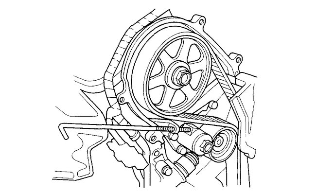

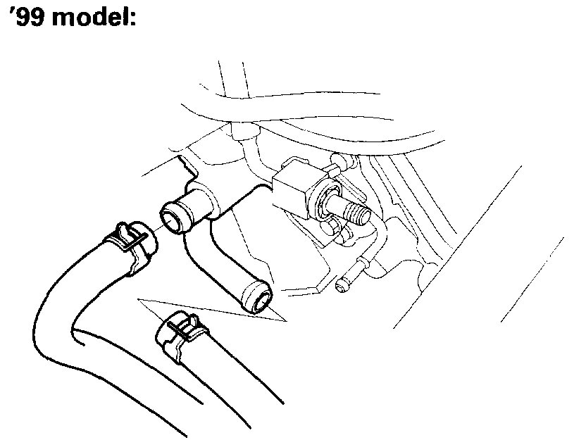

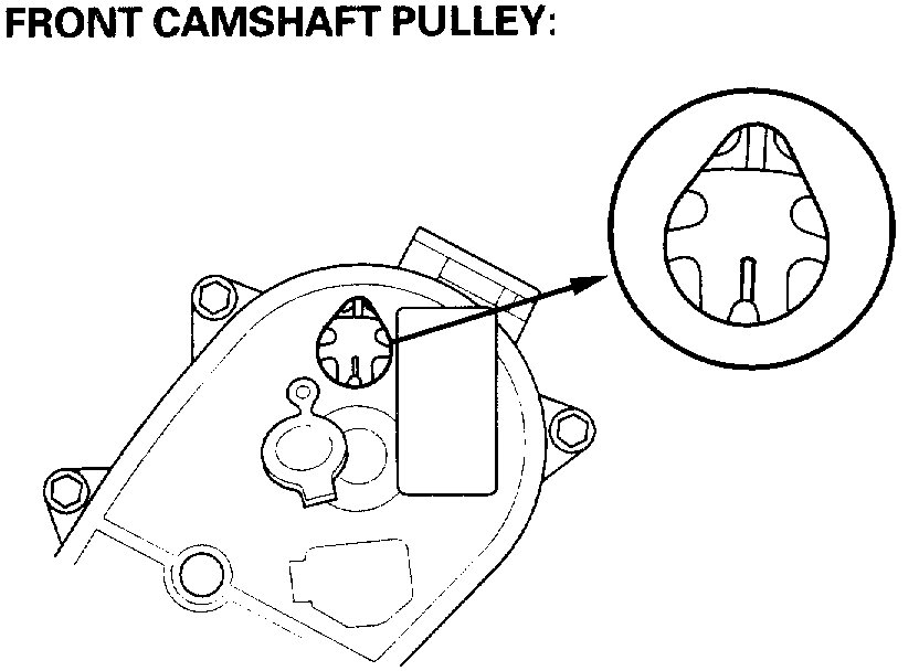

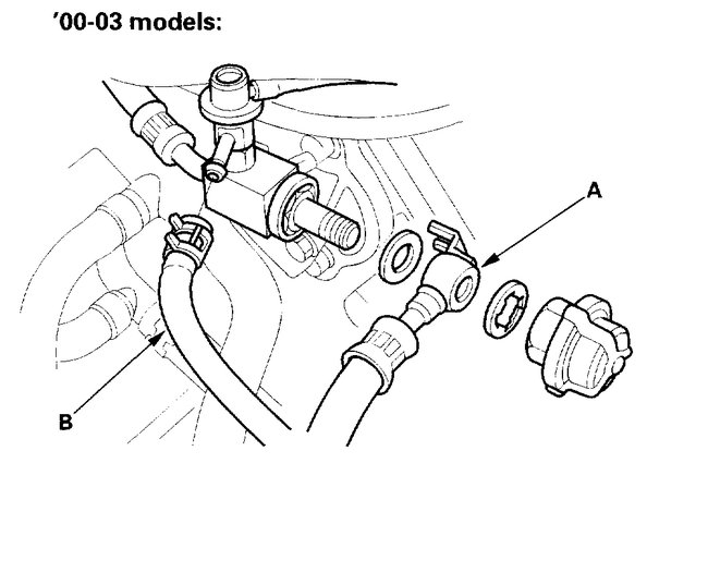

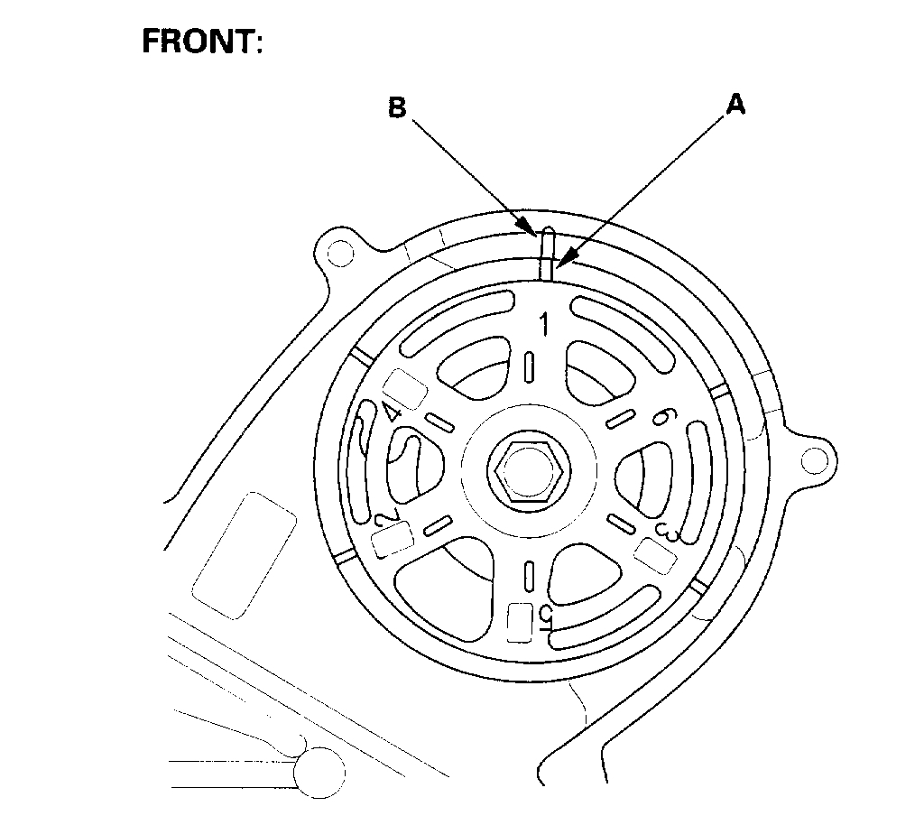

8. Relieve fuel pressure.
See picture 2
See picture 3

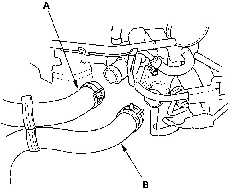

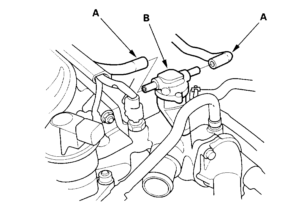

9. Remove the fuel feed hose (A) and fuel return hose (B).
10. Remove the intake manifold.

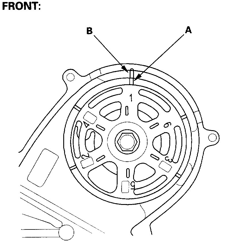

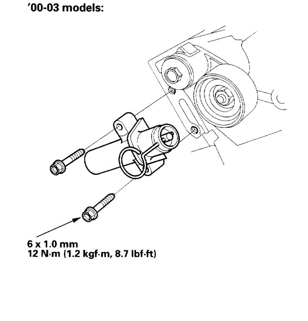

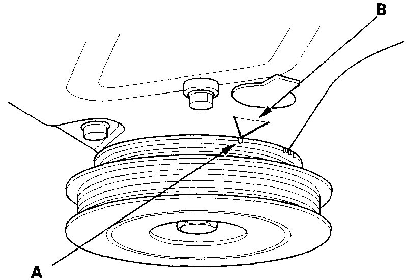

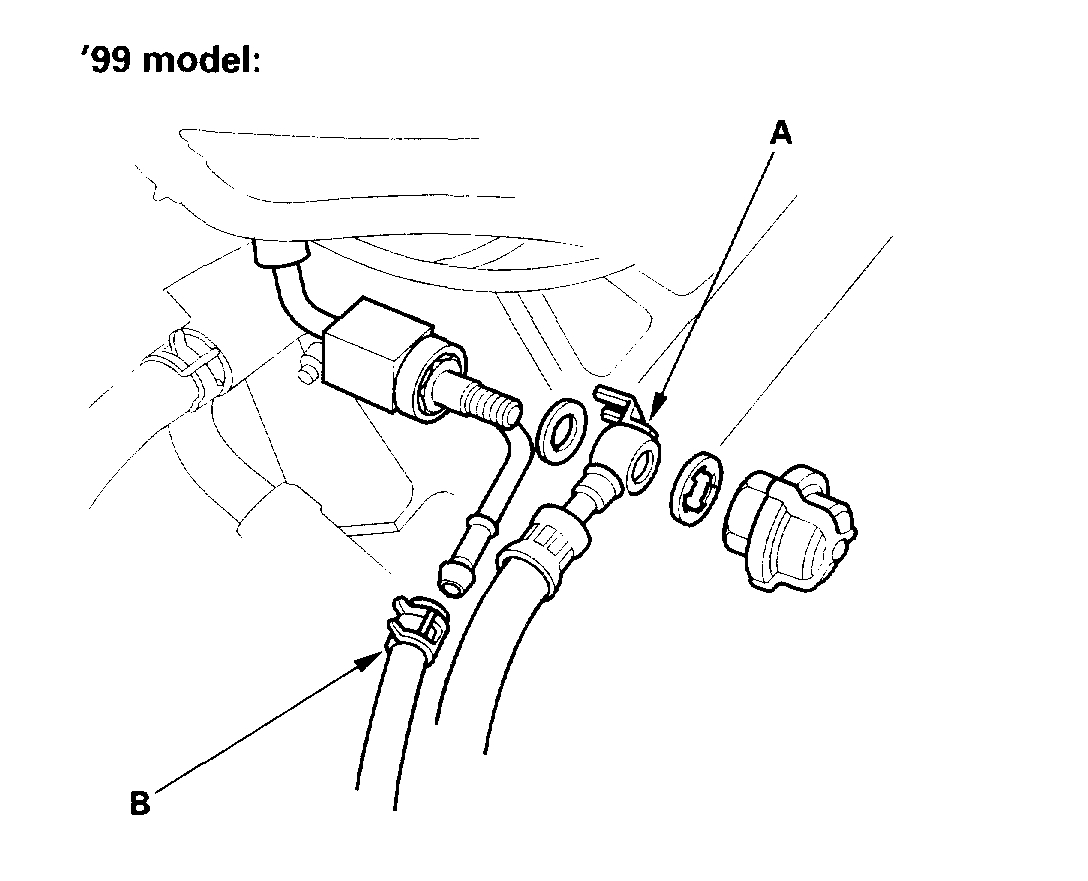

12. Remove the engine wire harness connectors and wire harness clamps from the cylinder head.
^ Six injector connectors
^ Engine Coolant Temperature (ECT) sensor connector
^ Radiator fan switch A connector
^ Radiator fan switch B connector Coolant temperature gauge sending unit connector ('99 model) Crankshaft Position (CKP) sensor connector Camshaft Position (CMP) (Top Dead Center (TDC)) sensor connector Exhaust Gas Recirculation (EGR) valve connector
^ VTEC solenoid valve connector VTEC oil pressure switch connector Oil pressure switch connector
See picture 4

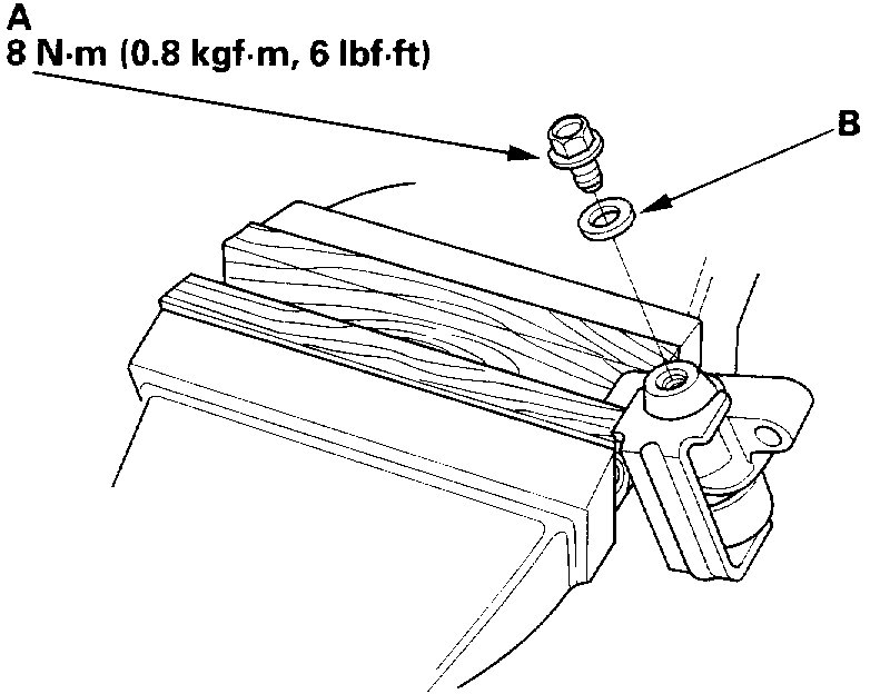

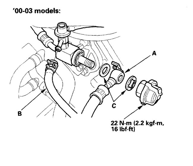

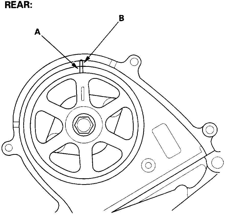

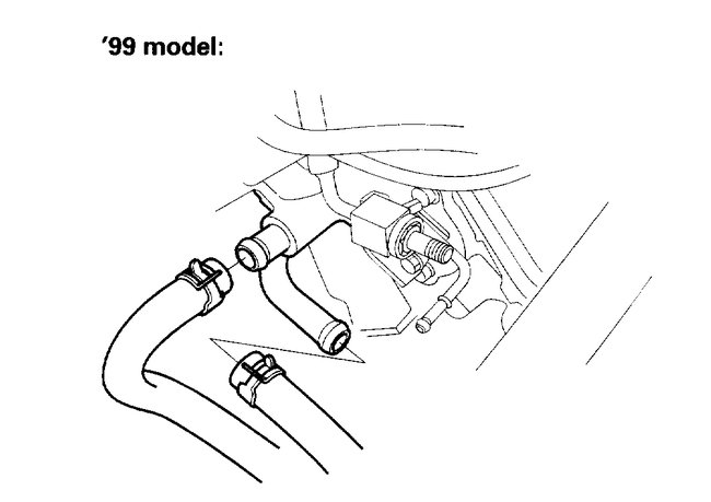

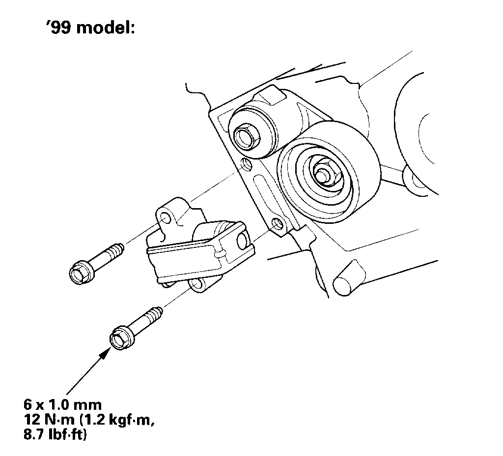

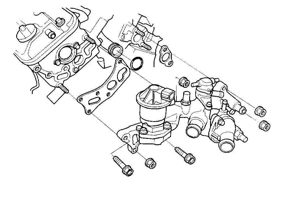

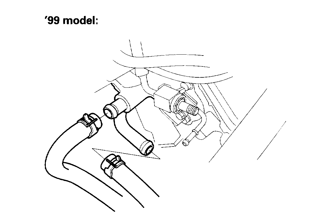

13. Remove the vacuum hoses (A) from the intake air bypass control valve (B).
See picture 5
See picture 6

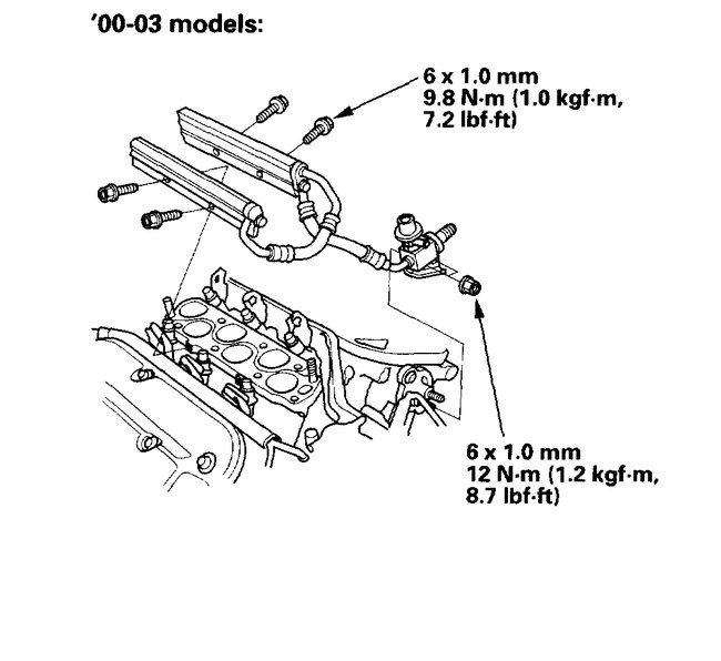

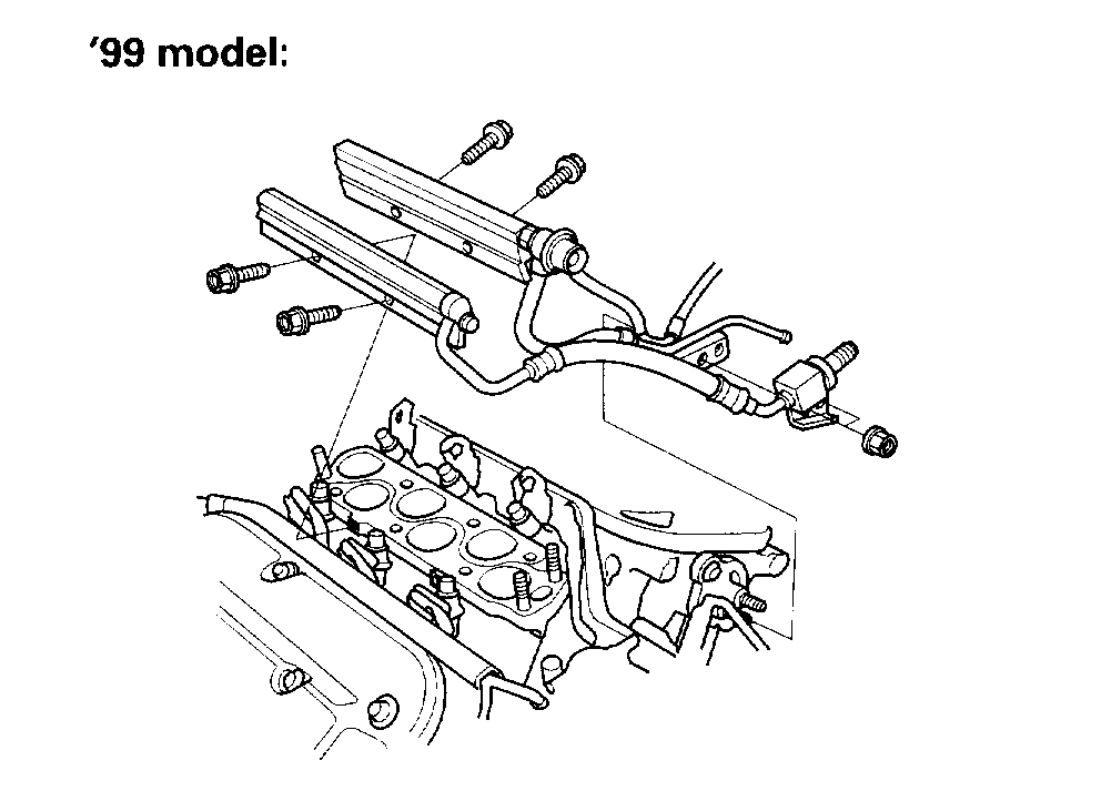

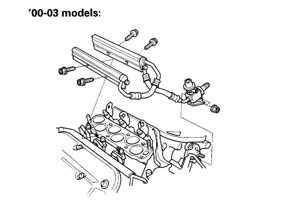

14. Remove the fuel rails.
See picture 7
See picture 8

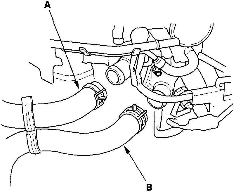

15. Remove the heater hoses.
See picture 9
16. Remove the upper radiator hose (A) and lower radiator hose (B).

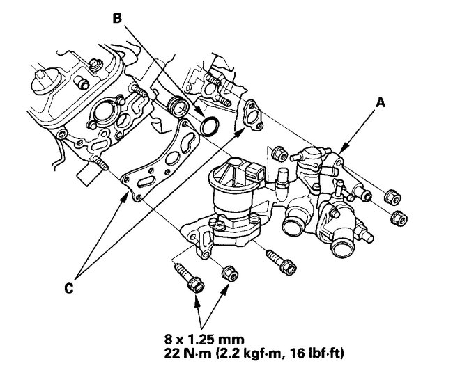

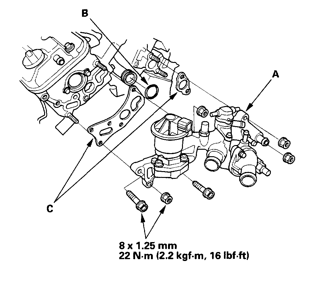

18. Remove the water passage.
See picture 11

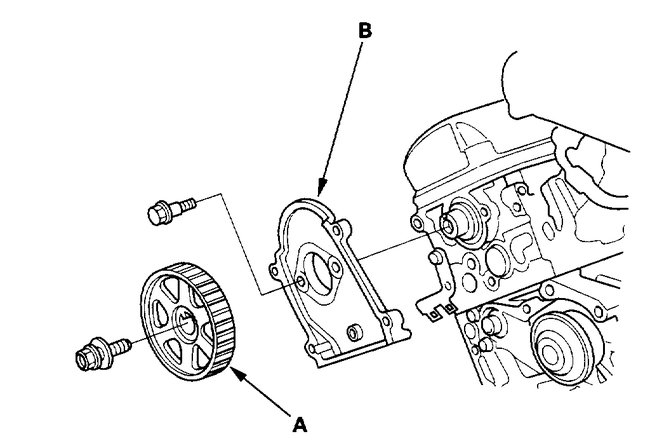

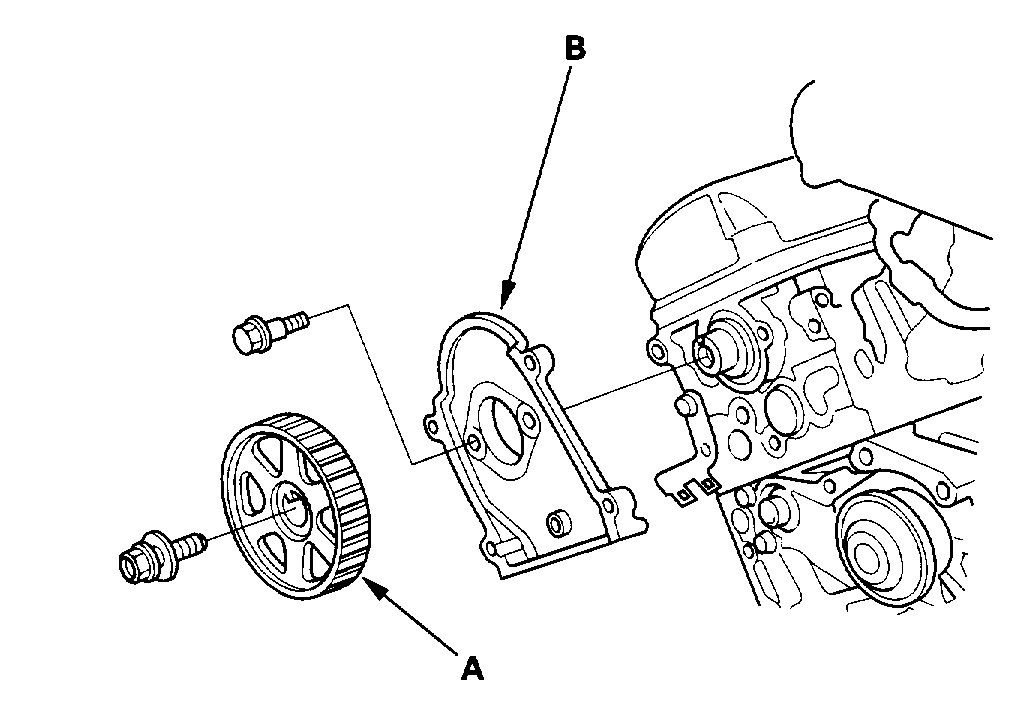

19. Remove the camshaft pulleys (A) and back covers (B).
20. Remove the cylinder head covers.

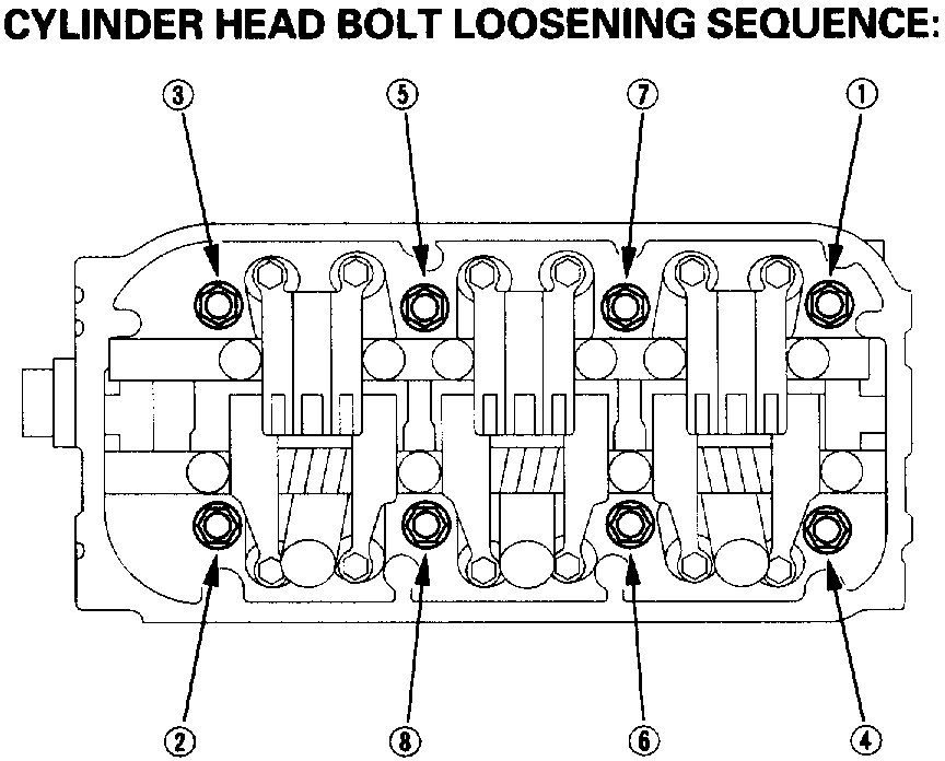

21. Remove the cylinder head bolts. To prevent warpage, unscrew the bolts in sequence 1/3 turn at a time; repeat the sequence until all bolts are loosened.
22. Remove the cylinder heads.

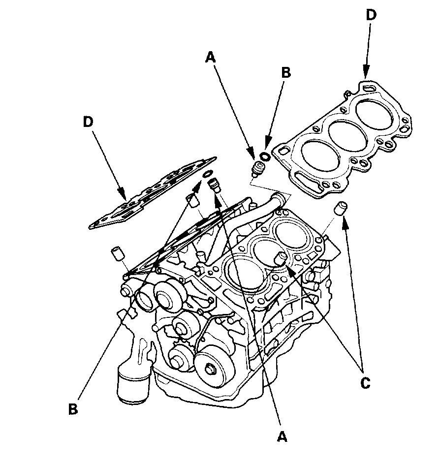

1. Clean the cylinder head and block surface.
See picture 13
2. Clean and install the oil control orifices (A) with the new O-rings (B).
3. Install the dowel pins (C) and new cylinder head gaskets (D).
4. Clean the timing belt drive pulley.
See picture 14

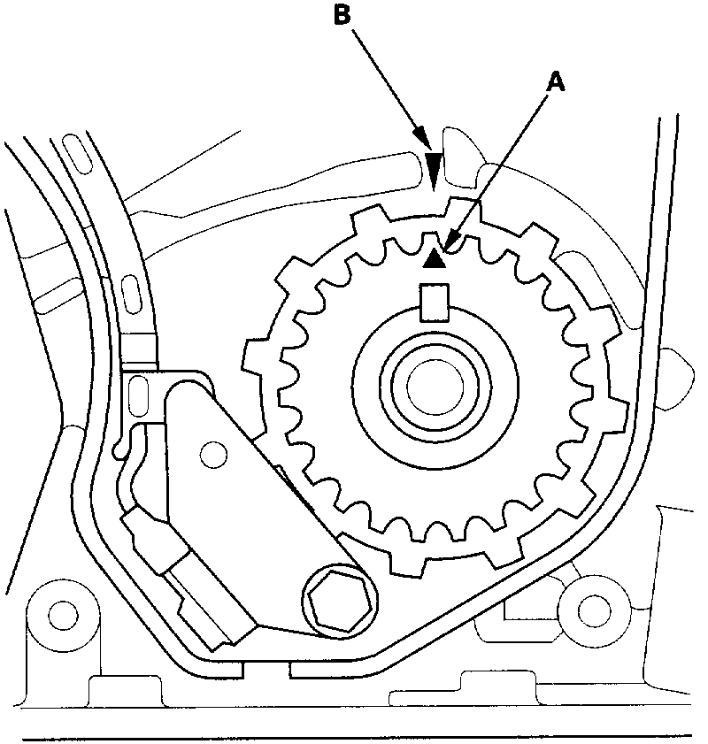

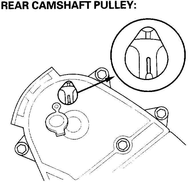

5. Set the timing belt drive pulley to Top Dead Center (TDC) by aligning the TDC mark (A) on the tooth of the timing belt drive pulley with the pointer (B) on the oil pump.
See picture 15
See picture 16

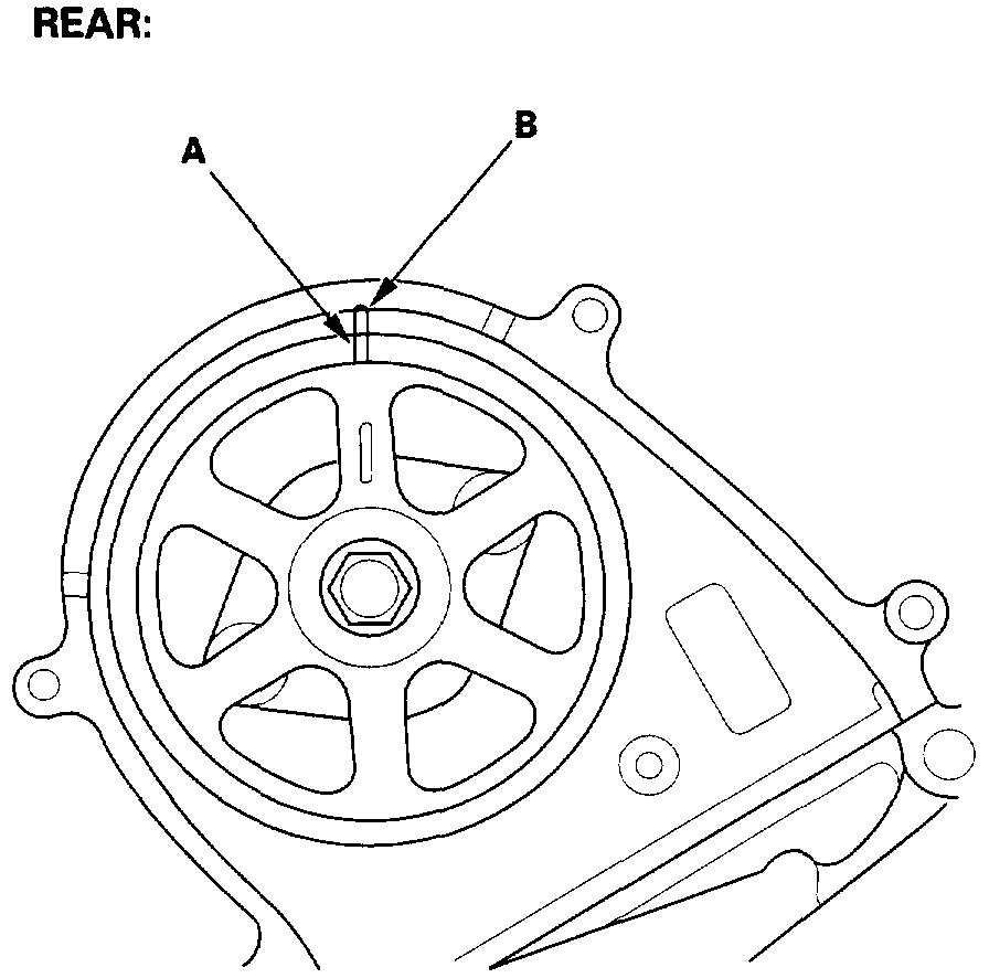

6. Clean the camshaft pulleys. Set the camshaft pulleys to TDC by aligning the TDC marks (A) on the camshaft pulleys with the pointers (B) on the back covers.

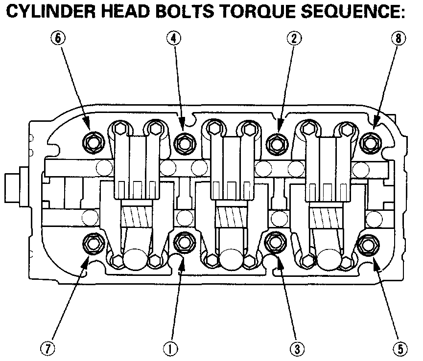

8. Tighten the cylinder head bolts sequentially in three steps.
NOTE: Perform each step twice.
1st step torque: 39 Nm (4.0 kgf-m, 29 ft. lbs.)
2nd step torque: 69 Nm (7.0 kgf-m, 51 ft. lbs.)
3rd seep torque: 98.1 Nm (10.0 kgf-m, 72.3 ft. lbs.)
Use a beam-type torque wrench. When using a preset-type torque wrench, be sure to tighten slowly and not to overtighten. If a bolt makes any noise while you are torquing it, loosen the bolt, and retighten it from the 1st step.

14. Install the water passage (A). Always use a new O-ring (B) and new gaskets (C).
See picture 19
See picture 20
15. Install the fuel rails.
See picture 21
16. Install the vacuum hoses (A) on the intake air bypass control thermal valve (B).

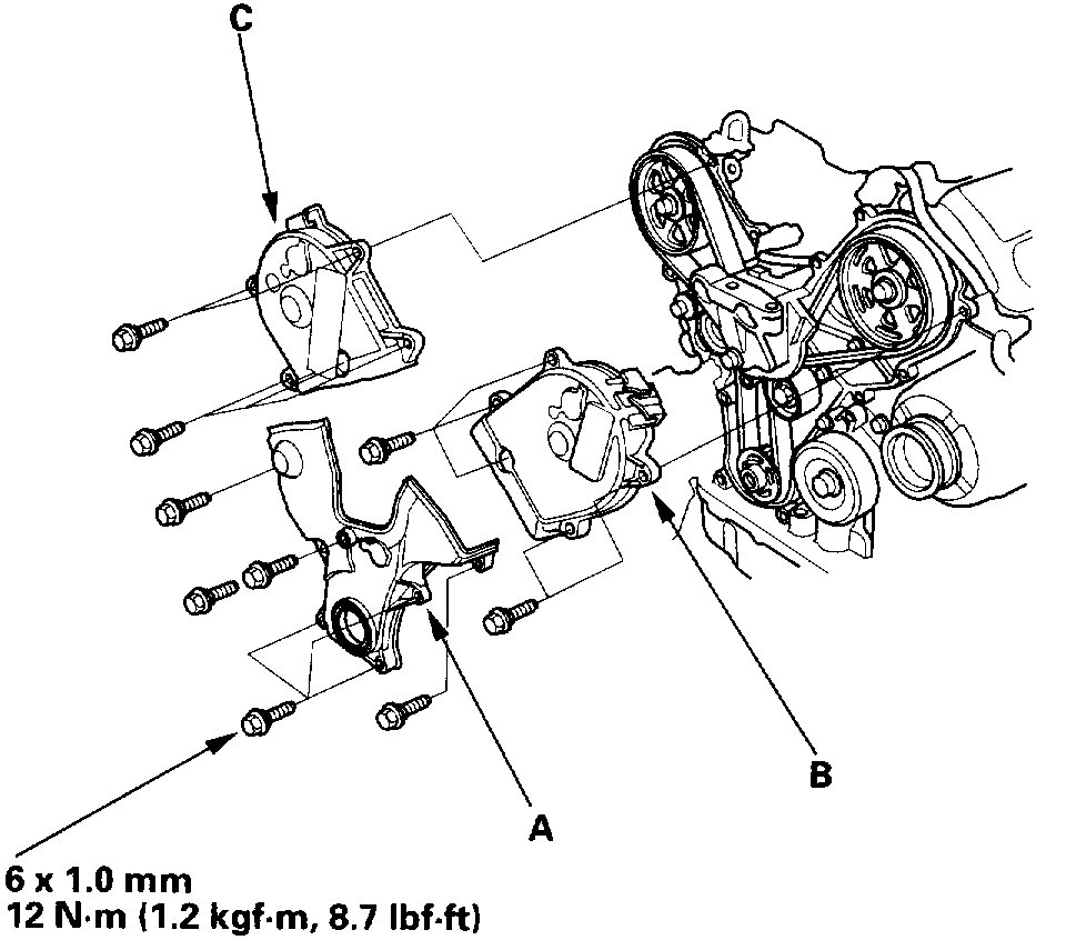

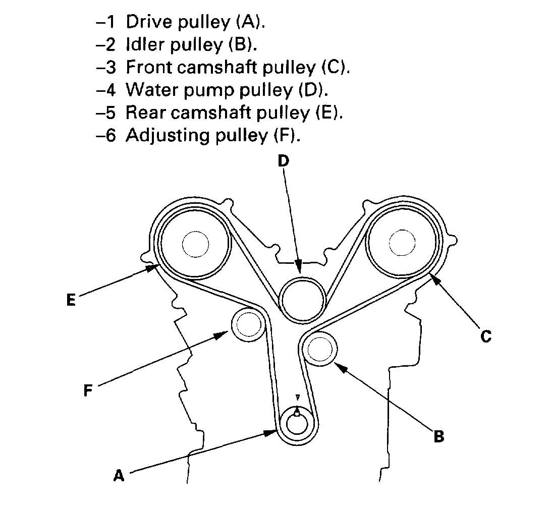

Here are the directions for removing and replacing the timing belt. The first set of directions are for removal and will need to be done before head removal.
Timing Belt Removal
Vehicle Engine, Cooling and Exhaust Engine Timing Components Timing Belt Service and Repair Procedures Timing Belt Removal
TIMING BELT REMOVAL
Timing Belt Removal

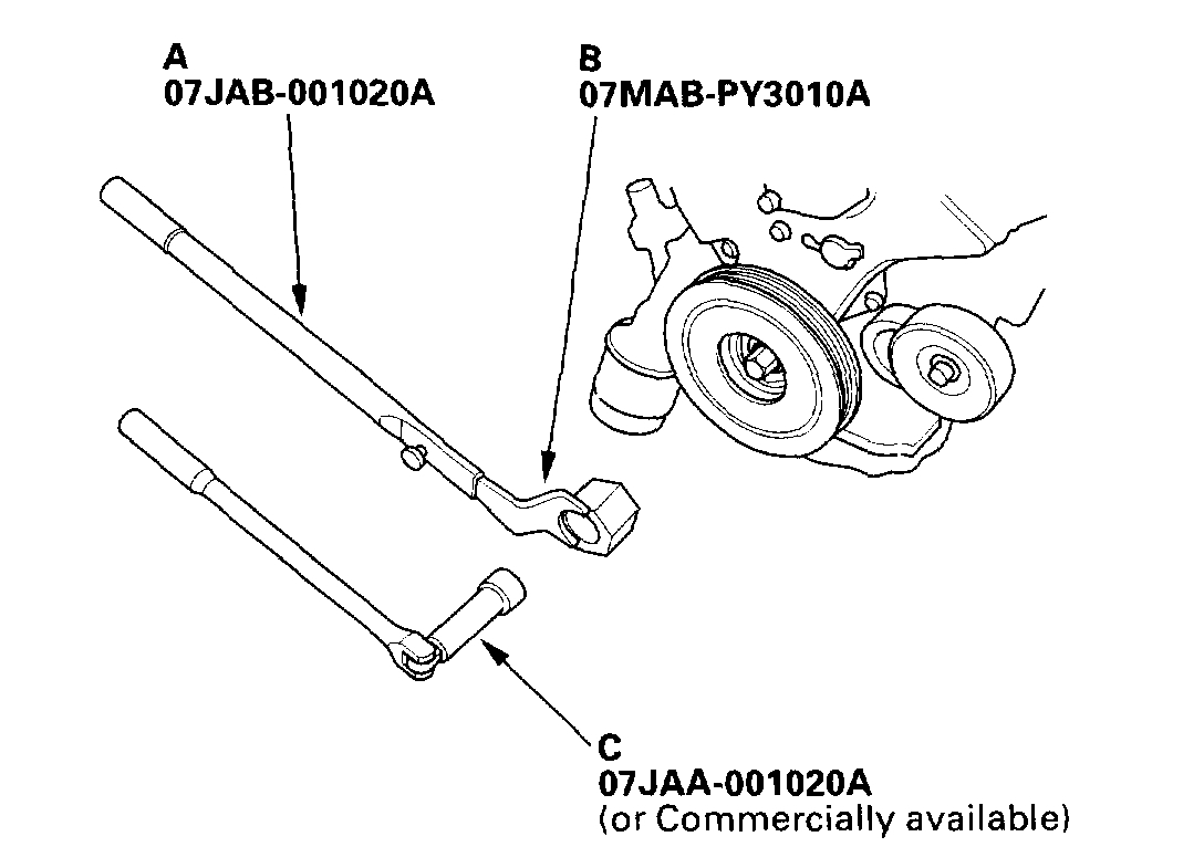

Special Tools Required
^ Holder Handle 07JAB-001020A
^ Holder Attachment, 50 mm, Offset 07MAB-PY3010A Socket, 19 mm 07JAA-001020A or a commercially available 19 mm socket

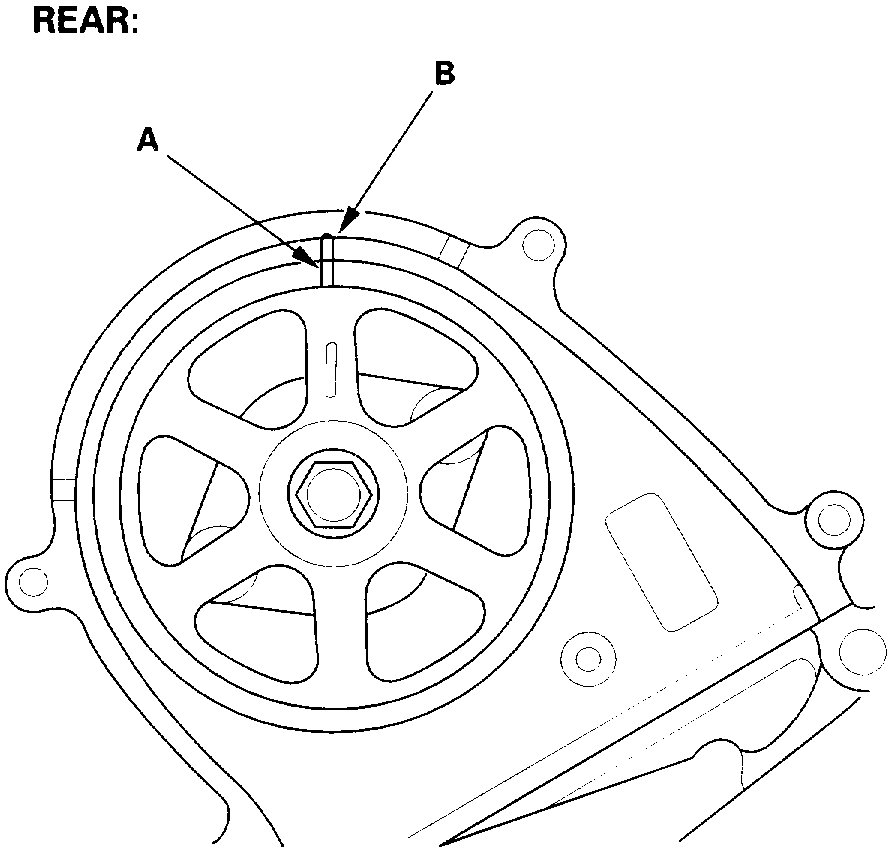

Picture 27

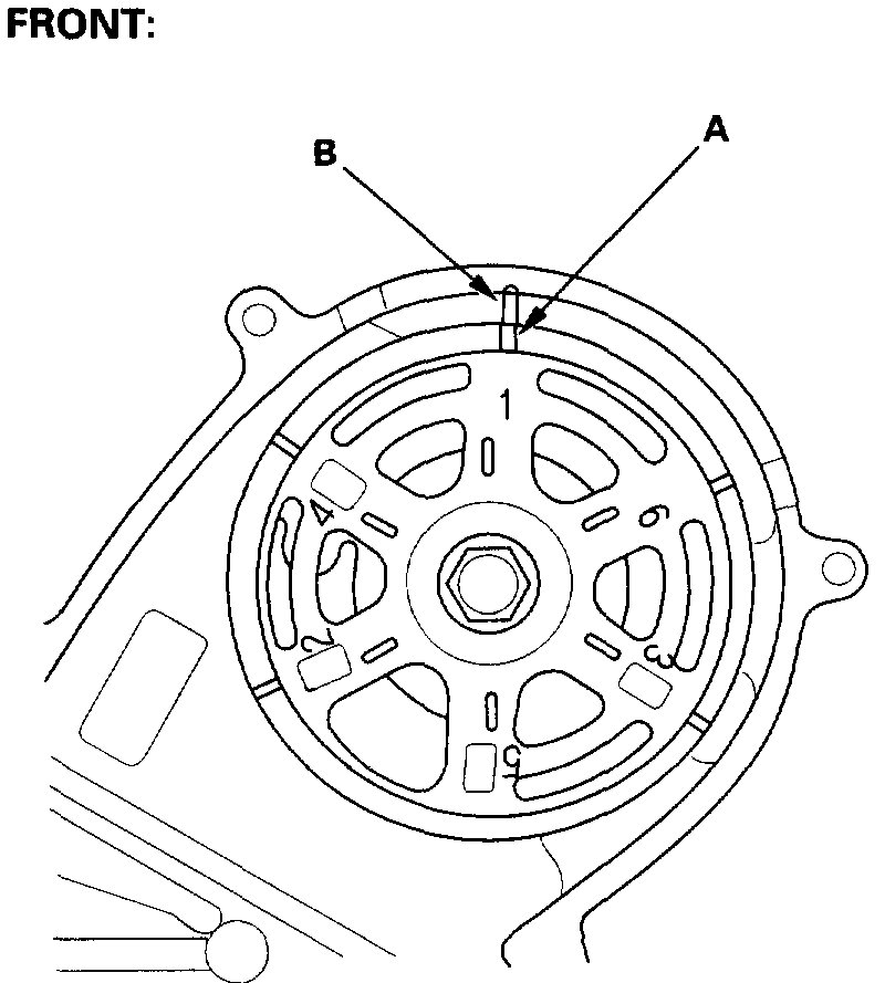

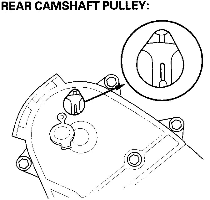

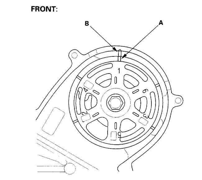

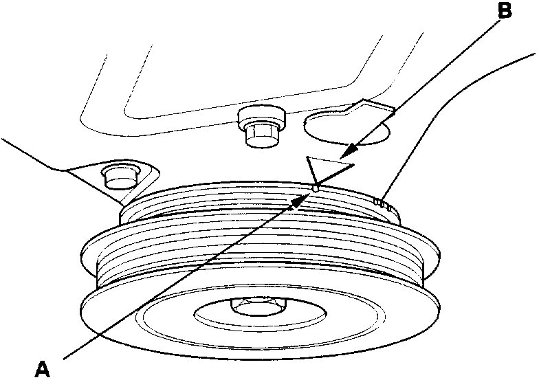

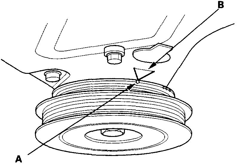

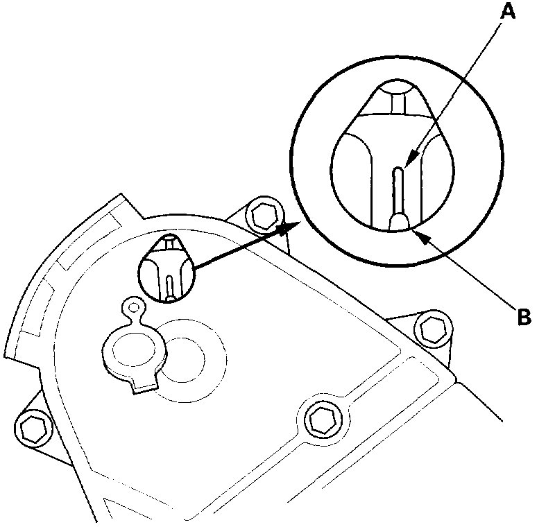

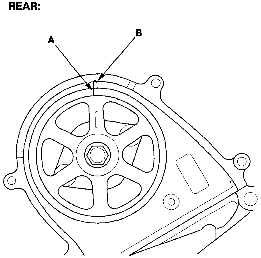

1. Turn the crankshaft so its white mark (A) lines up with the pointer (B).
Picture 28

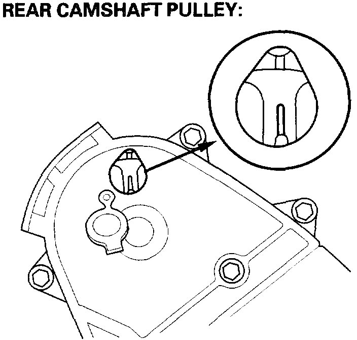

2. Check that the rear camshaft pulley mark (A) and rear upper cover mark (B) are aligned.

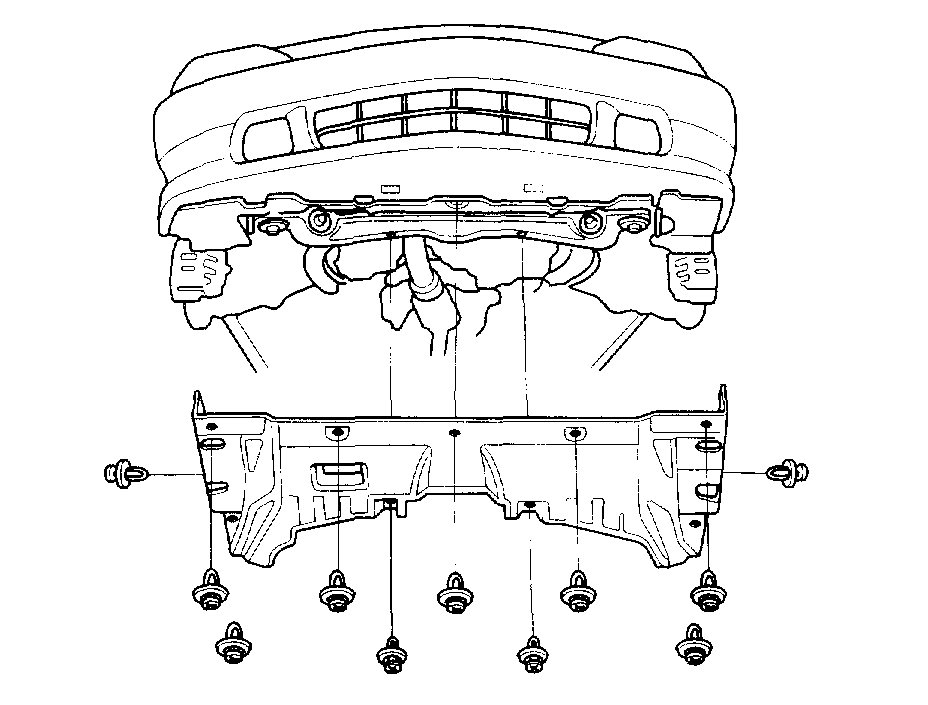

4. Remove the splash shield.

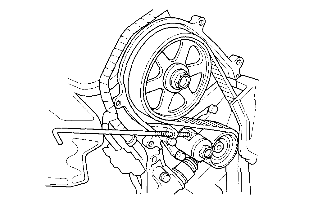

Picture 30

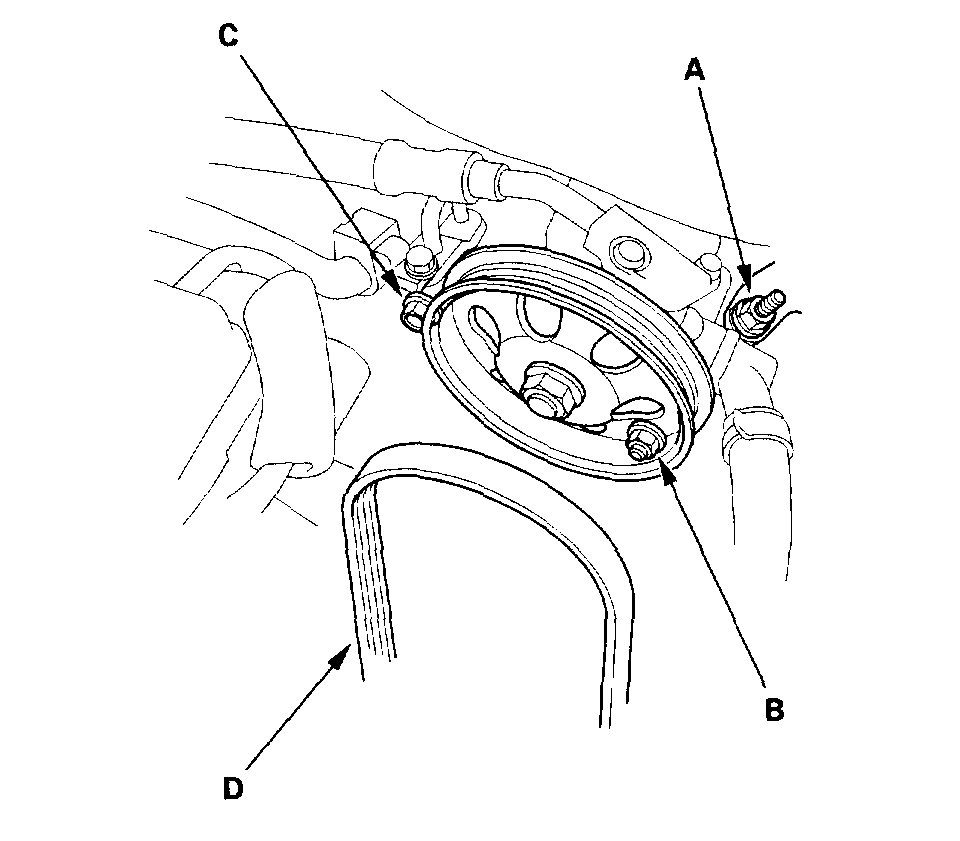

5. Move the auto-tensioner (A) to remove tension from the alternator belt (B), then remove the alternator belt.
Picture 31

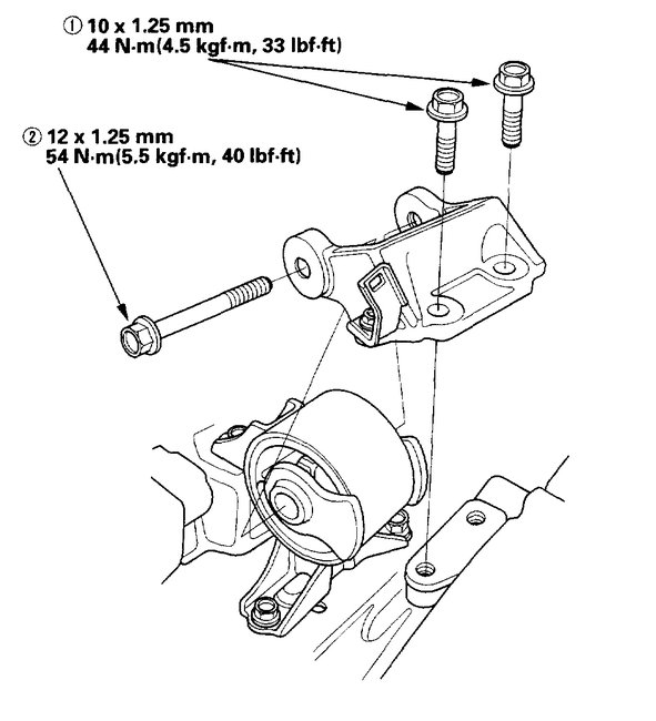

6. Loosen the adjusting nut (A), locknut (B) and mounting bolt (C), then remove the Power Steering (P/S) pump belt (D).
7. Support the engine with a jack and wood block under the oil pan.
Picture 32

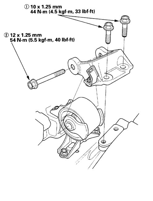

8. Remove the side engine mount bracket.

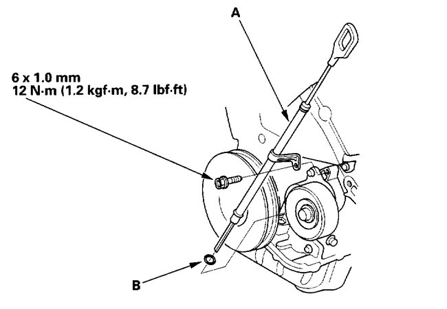

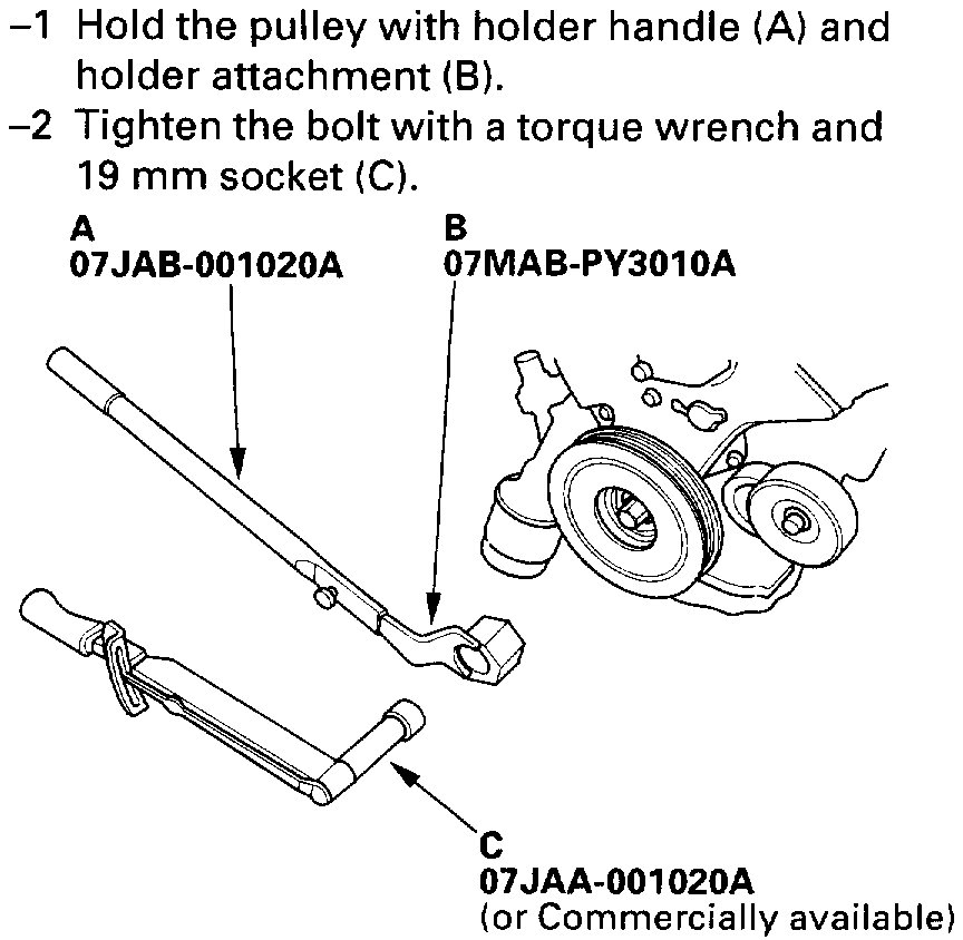

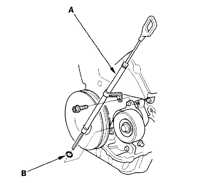

9. Remove the dipstick and tube (A); Discard the O-ring (B).
Picture 34

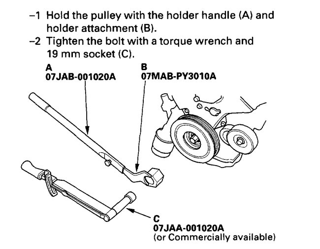

10. Hold the pulley with the holder handle (A) and holder attachment (B).
11. Remove the bolt with a heavy duty 19 mm socket (C) and breaker bar.

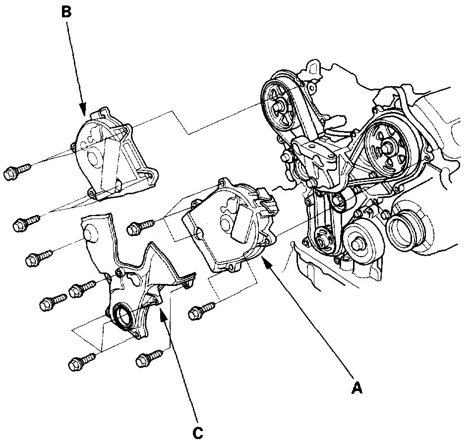

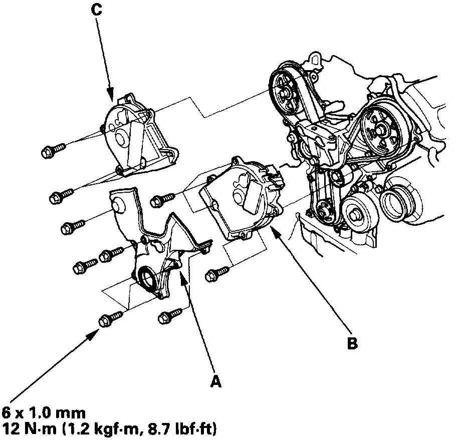

12. Remove the front upper cover (A), rear upper cover (B) and lower cover (C).
Picture 36

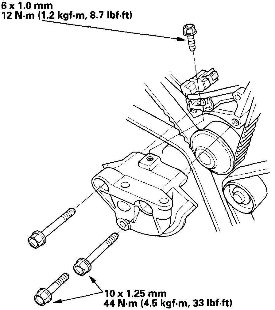

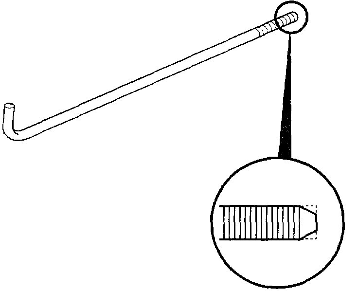

13. Remove one of the battery clamp bolts from the battery tray. and Grind the end of it as shown.
Picture 37
14. Screw the battery clamp bolt in as shown to hold the timing belt adjuster in its current position. Tighten it by hand, do not use a wrench.
Picture 38

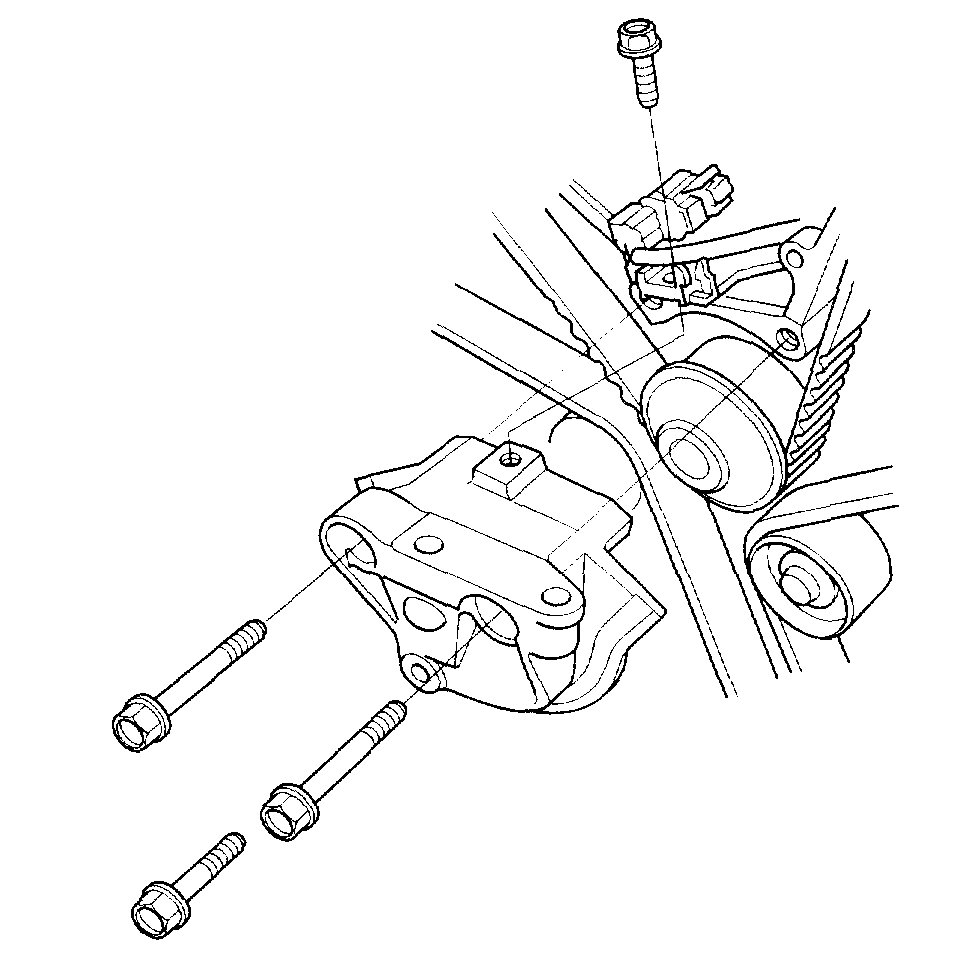

15. Remove the engine mount bracket.
Picture 39

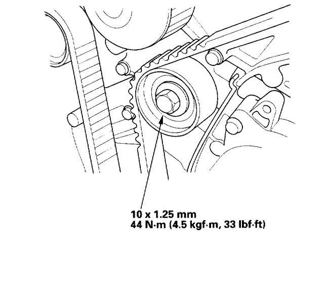

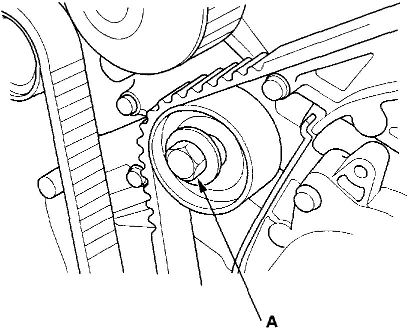

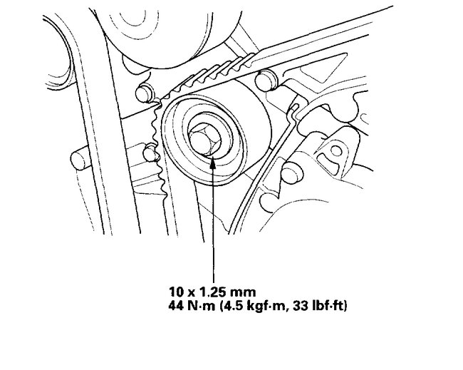

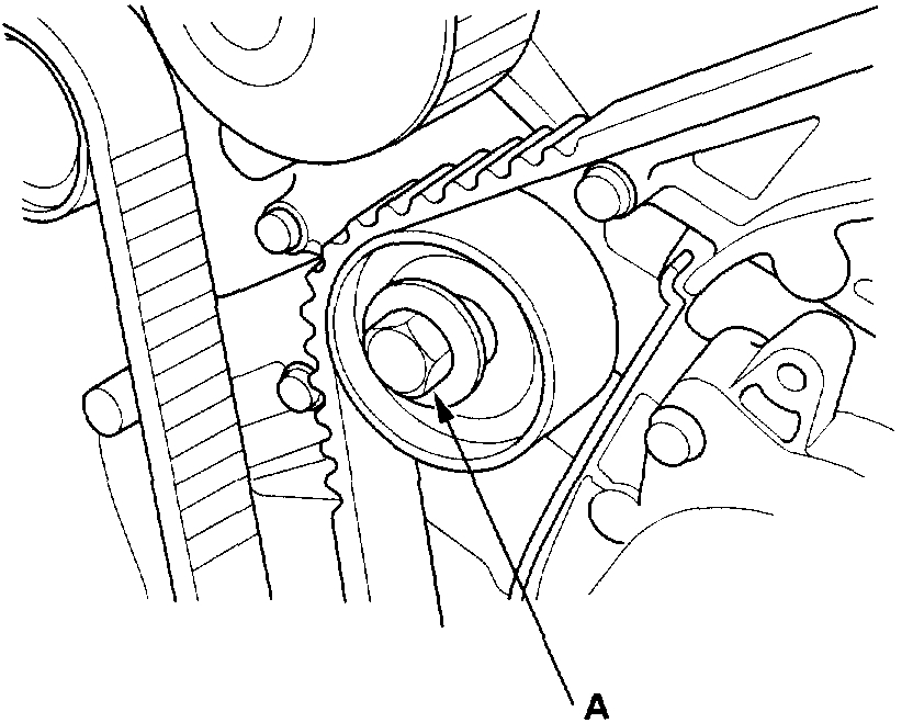

16. Loosen the idler pulley bolt (A) about five or six turns, then remove the timing belt.
____________________________________________________________________________________

2. Set the timing belt drive pulley to Top Dead Center (TDC) by aligning the TDC mark (A) on the tooth of the timing belt drive pulley with the pointer (B) on the pulley.

5. Remove the auto-tensioner.

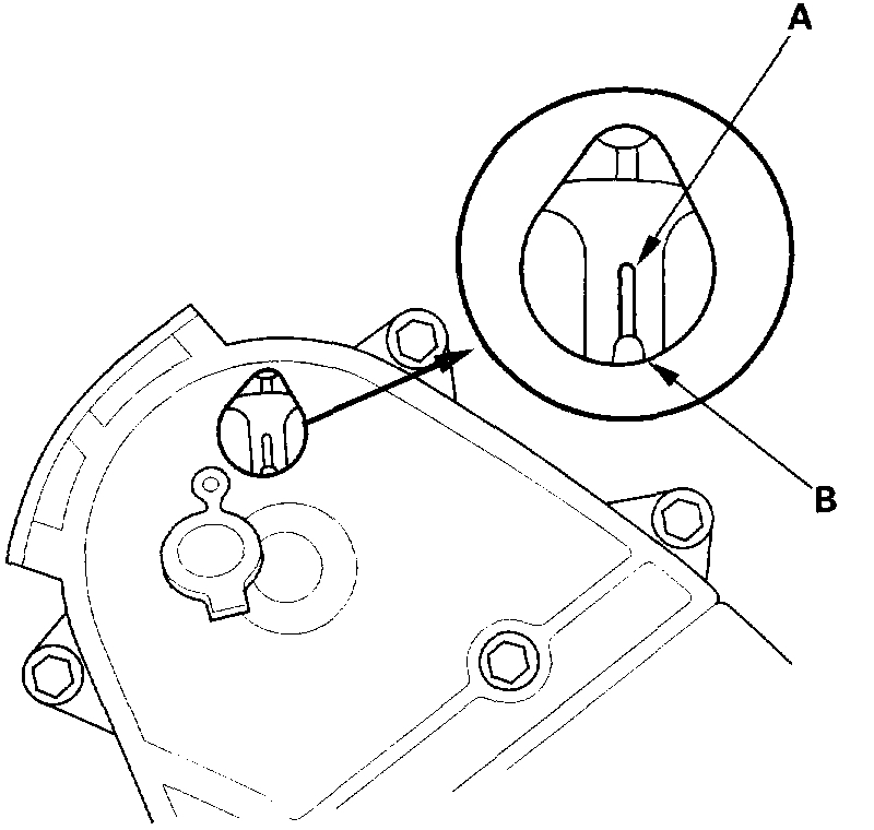

Picture 43
6. Hold the auto-tensioner (A) with the maintenance bolt pointing up. Loosen and remove the maintenance bolt (B) ('99 model).
NOTE: Handle the auto-tensioner carefully so the oil inside does not spill or leak. If any of the oil has spilled or leaked out of the auto-tensioner, refill it with 5W-30 motor oil. The total capacity is 6.5 ml (0.22 fl oz).
7. Clamp the boss of the auto-tensioner in a soft-jawed vise. Do not grip the housing of the autotensioner ('99 model).
Picture 44

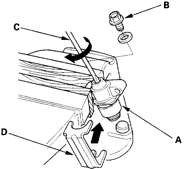

8. Insert a flat blade screwdriver (C) into the maintenance hole. Place the retainer (D) (P/N 14540-P8A-A01) on the auto-tensioner while turning the screwdriver clockwise to compress the bottom ('99 model).
NOTE: Take care not to damage the threads or the gasket contact surface with the screwdriver.
9. Reinstall the maintenance bolt (A). Always use a new casket (B) ('99 model).
10. Make sure no oil is leaking around the maintenance bolt.

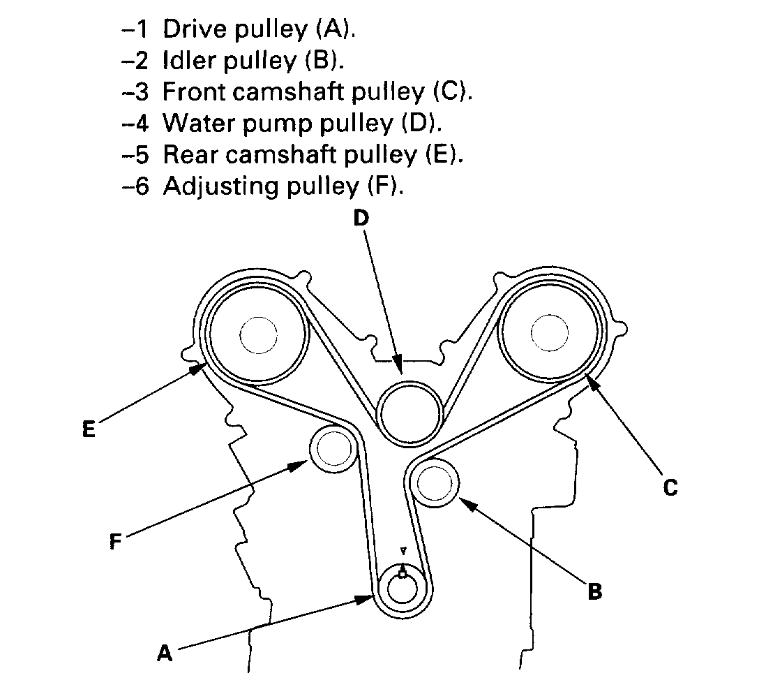

Picture 48
14. Install the timing belt in a counter clockwise sequence starting with the drive pulley.
Picture 49
15. Tighten the idler pulley bolt.
Pictures 50 and 51
16. Remove the retainer or pin from the auto-tensioner.
Picture 52

18. Install the lower cover (A), front upper cover (B) and rear upper cover (C).

23. Turn the crankshaft pulley so its white mark (A) lines up with the pointer (B).
Picture 56
Picture 57
24. Check the camshaft pulley marks.
^ If the camshaft pulley marks are at TDC, go to step 25.
^ If the camshaft pulley marks are not at TDC, remove the timing belt and repeat steps 2 through 21.

28. Install the side engine mount bracket, then tighten the mounting bolts in the numbered sequence shown.

5. Install the timing belt in a counterclockwise sequence starting with the drive pulley. Take care not to damage the timing belt when installing it.

6. Tighten the idler pulley bolt.
Picture 65
7. Remove the battery clamp bolt from the back cover.
Picture 66
8. Install the engine mount bracket.
Picture 67
9. Install the lower cover (A), front upper cover (B) and rear upper cover (C).

11. Clean any oil off the inside face (A) of the crankshaft pulley, and apply lubricant to the pulley bolt (B) and washer (C).
Picture 69
12. Install the crankshaft pulley, and tighten the bolt to 245 Nm (25.0 kgf-cm, 181 ft. lbs.). Do not use an impact wrench.

Picture 70
14. Turn the crankshaft pulley so its white mark (A) lines up with the pointer (B).
Pictures 71 and 72
15. Check the camshaft pulley marks.
^ If the camshaft pulley marks are at TDC, go to step 16.
^ If the camshaft pulley marks are not at TDC, remove the timing belt and repeat steps 2 through 11.

16. Install the dipstick and tube (A) with a new O-ring (B).

19. Install the side engine mount bracket, then tighten the mounting bolts in the numbered sequence shown.
