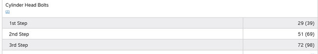

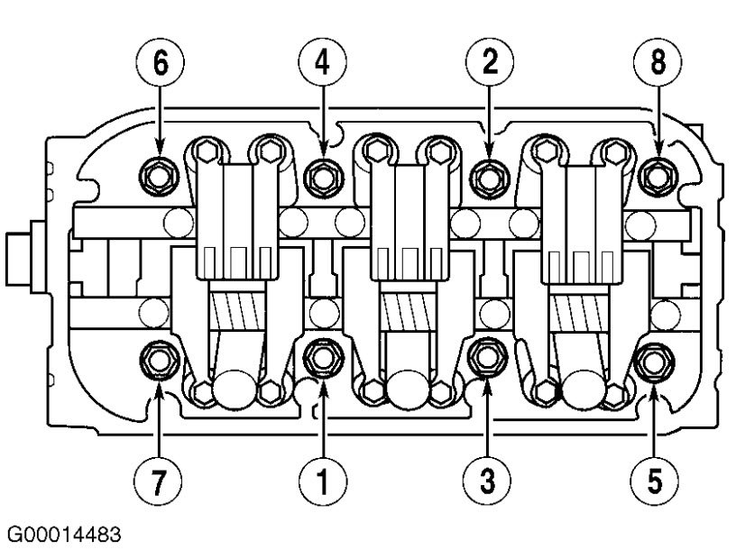

I need the cylinder head bolt sequence and torque.
May 20, 2016 at 10:52 AM
HMAC300
  • 48,601 POSTS
see pictures for torque and sequence. first columns in ft. lbs. second column numbers. Here is a video that show the correct way to use a torque wrench with diagrams and specs below.

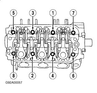

Engine Mechanical problem
1997 Acura TL 6 cyl Front Wheel Drive Automatic
head bolt spec
Apr 18, 2019 at 9:50 AM (Merged)
MHPAUTOS
  • 31,937 POSTS
Hi there, Tighten head bolts in 3 steps to 76 Nm. mark (mhpautos)
