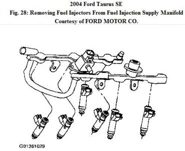

Ok so I'm sure it's me but I've followed the fuel from the filter at the tank to the rails and can't find a schrader to connect my fuel pressure guage to. I even took off the vacuum/sending unit on the foward rail pax side but I'd need an adapter to connect there.

Ford uses a smaller scrader valve than normal. The standard fitting on a fuel gause is larger for gm models and fod uses a smaller attachment

I wasn't able to find any valve big or small. My Haynes manual only goes to 2001 and where it shows a valve on the rail in the older models, this 2004 doesn't have one. It looks like I'll need an adapter to hook up.

https://www.2carpros.com/forum/automotive_pictures/139033_2carpros_5.jpg
Saturday, October 24th, 2020 AT 1:11 PM (Merged)
MASTERTECHTIM
  • 4,750 POSTS
To the top right of picture is where the schraeder valve is located on the fuel rail
