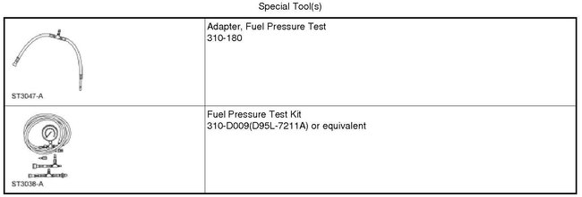

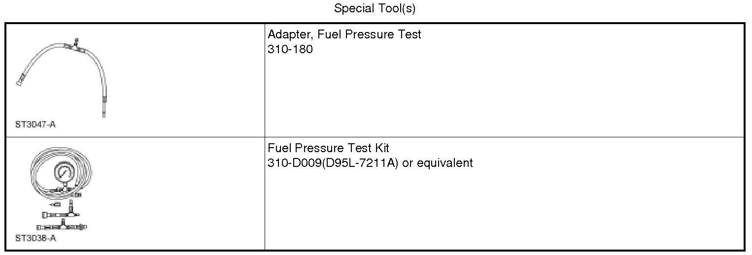

Here are the directions specific to your vehicle for testing fuel pressure. The manufacturer's specs are included in the directions. All attached pictures correlate with these directions.
Fuel System Pressure Test
WARNING: Do not smoke, carry lighted tobacco or have an open flame of any type when working on or near any fuel-related component. Highly flammable mixtures are always present and may be ignited. Failure to follow these instructions may result in serious personal injury.
WARNING: Do not carry personal electronic devices such as cell phones, pagers or audio equipment of any type when working on or near any fuel-related component. Highly flammable mixtures are always present and may be ignited. Failure to follow these instructions may result in serious personal injury.
WARNING: Before working on or disconnecting any of the fuel tubes or fuel system components, relieve the fuel system pressure to prevent accidental spraying of fuel. Fuel in the fuel system remains under high pressure, even when the engine is not running. Failure to follow this instruction may result in serious personal injury.
WARNING: Always disconnect the battery ground cable at the battery when working on an evaporative emission (EVAP) system or fuel-related component. Highly flammable mixtures are always present and may be ignited. Failure to follow these instructions may result in serious personal injury.
WARNING: When handling fuel, always observe fuel handling precautions and be prepared in the event of fuel spillage. Spilled fuel may be ignited by hot vehicle components or other ignition sources. Failure to follow these instructions may result in serious personal injury.
1. Release the fuel system pressure. For additional information, refer to Fuel System Pressure Release See: Fuel Pressure Release > Procedures > Fuel System Pressure Release.
2. Disconnect the battery ground cable. For additional information, Refer to 414-01 See: Battery > Removal and Replacement > Battery.
3. Disconnect the fuel tube-to-fuel jumper tube quick connect coupling. For additional information, refer to Quick Connect Coupling See: Fuel Line Coupler > Removal and Replacement > Quick Connect Coupling.
4. Install the Fuel Pressure Test Adapter and the Fuel Pressure Test Kit between the fuel tube and the fuel jumper tube.
5. NOTE: The Fuel Pump (FP) control module electrical connector was previously disconnected to release the fuel system pressure and must be reconnected to test the fuel system pressure.
Connect the FP (Fuel Pump) control module electrical connector.
6. Connect the battery ground cable. For additional information, Refer to 414-01 See: Battery > Removal and Replacement > Battery.
7. NOTE: Carry out an ignition ON engine OFF visual inspection for fuel leaks prior to completing the fuel system pressure test.
NOTE: After completing the fuel system pressure test, open the drain valve on the Fuel Pressure Test Kit and release any residual fuel into a suitable container prior to removing the tool.
Test the fuel system pressure to make sure it is within the specified range. For additional information, refer to Specifications.

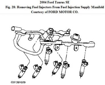

Interesting, I'm showing a vacuum operated regulator on this vehicle. See pic attached.
I want you to try something and tell me what happens. Before you start it, cycle the key to the run position 3 times. Each time, wait about 5 seconds before you turn it off and then back on. The 4th time, see if it starts.
Oct 24, 2020 at 6:10 AM (Merged)
  • 110,244 POSTS
Sorry, I forgot the pic of the regulator.

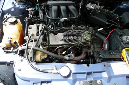

Ok so I'm sure it's me but I've followed the fuel from the filter at the tank to the rails and can't find a schrader to connect my fuel pressure guage to. I even took off the vacuum/sending unit on the foward rail pax side but I'd need an adapter to connect there.
https://images.2carpros.com/forum/automotive_pictures/218779_mattpeak_1.jpg
Oct 24, 2020 at 6:11 AM (Merged)
MASTERTECHTIM
  • 4,750 POSTS
ford uses a smaller scrader valve than normal. the standard fitting on a fuel gause is larger for gm models and fod uses a smaller attachment
MATTPEAK
I wasn't able to find any valve big or small. My Haynes manual only goes to 2001 and where it shows a valve on the rail in the older models, this 2004 doesn't have one. It looks like I'll need an adapter to hook up.
MASTERTECHTIM
  • 4,750 POSTS
https://images.2carpros.com/forum/automotive_pictures/139033_2carpros_5.jpg
MASTERTECHTIM
  • 4,750 POSTS
to the top right of picture is where the schraeder valve is located on the fuel rail
