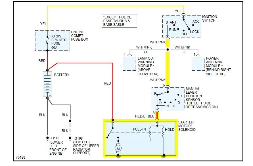

My car wont start and it has a new battery and alternator. When I go to start it it turns my electronics on but the starter makes a rapid clicking noise. I was wondering if theres any way to find out if its a short from the battery to the starter and how to fix it.
Sunday, October 25th, 2020 AT 11:28 AM (Merged)
  • 75,992 POSTS
Could be the battery itself or loose connections also the starter relay-start here
Sunday, October 25th, 2020 AT 11:29 AM (Merged)
HOWDYCRAWFORD
Okay. Thank you cause I just got a new battery Sunday and it started for about 3 days and now it won't start at all. My radio and lights and everything works but the starter just clicks until I stop trying to start it.

Wouldn't start when I came out of store. Started with a jump but when turned off wouldn't start again. I put new battery and alternator on and checked plugs and fuses but still wont start. Lights and everything work just wont start.
  • 52,797 POSTS
Good afternoon,
Does the engine crank over when it will not start?
RUBY DOSS SMITH
Doesn't do anything when trying to start.
