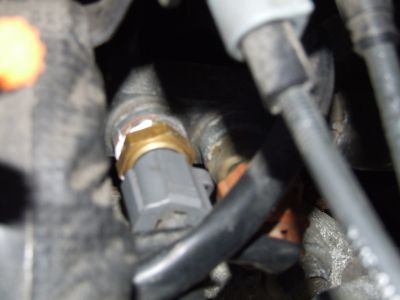

Have a 1996 taurus that has 200,000 miles and it is hard to start when cold but will start if you pump the gas pedal a few times. Other wise it runs fine :

Try replacing the ECT located as in the picture!
http://www.2carpros.com/forum/automotive_pictures/62217_ECT_2.jpg
