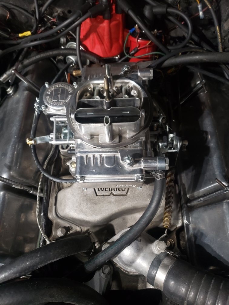

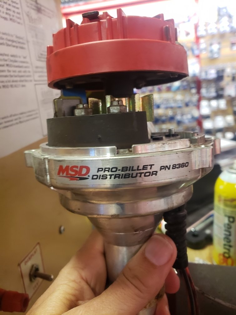

Just replaced distributor , coil , cap and rotor , plugs and wires. The car was starting and running great (actually started it over a dozen times) then after sitting for a few days; it tries to start but stumbles and shuts off.
It was having this problem before I replaced the items as stated previously , and after checking the cap and wires found them corroded (enough that it was lucky to be running on 4 out of 8 cylinders) , so an ignition tune-up was due , and after resetting the timing it fired right up and ran great , but it seems only for that day.
Any help would be greatly appreciated.

Have you checked to make sure the choke isn't stuck closed? Is it possible for you to record what it is doing and then upload it for me to hear?

Manual choke wired open (live in Vegas, so choke is rarely needed).

There could be a few things. Have you checked to make sure there aren't any larger vacuum leaks? Also, have you confirmed that the fuel pump is providing enough fuel?
I realize this is a 68, but has anything been updated as far as ignition? I'm just wondering what we are working with, HEI or points and condenser.

This is the only upgrade to the ignition system, and a Holley 4-barrel. And like I said , it was running great over the weekend - started it over a dozen times and then a few days later , it's like I never replaced anything. I replaced a few vacuum lines also.

Also, I believe that distributor has a built in ignition control module, is that correct?

Yes , and the control module checked out fine.

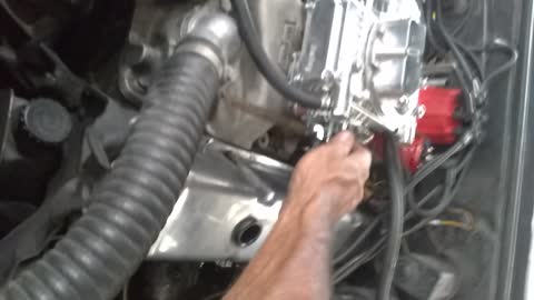

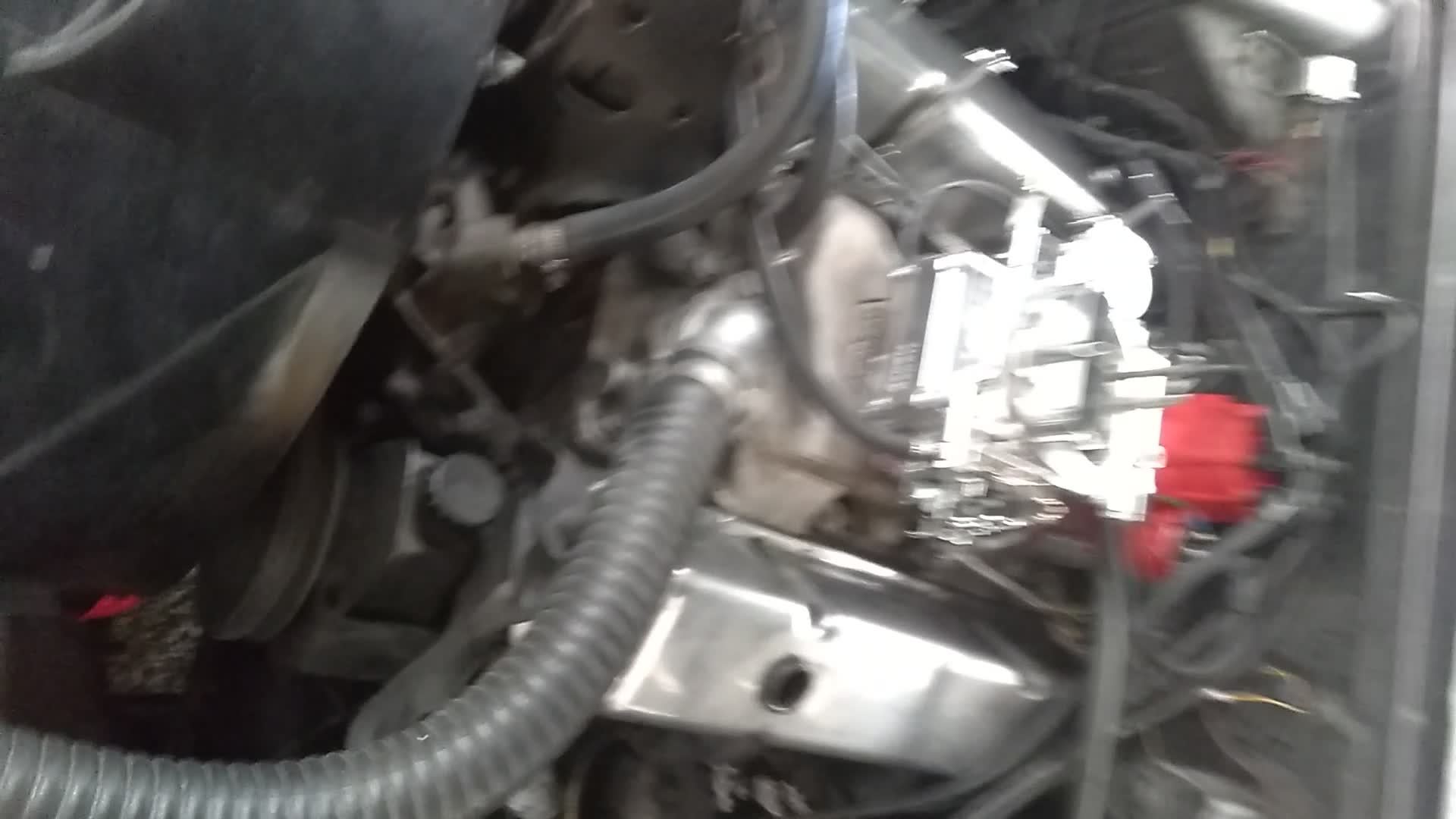

So re-checked everything today , reset timing even checked for timing chain play (pretty sure it was less than 10 degrees) and car still wouldn't run right. Then I replaced a connection on a wire leading to the coil , and it fired right up and ran better than it has for years after some fine tuning on the Holly. So after about a 10 minute drive, pull into the garage , start it a few more times to double-check - and then after 15 minutes it barely starts and runs like crap ( like a weak ignition I'm thinking ) ... The distributors been checked (MSD pro billet) coil , cap and rotor , plugs and wires all new. so what would cause this (what seems like an intermittent failure)?
If the timing chain was loose , it wouldn't have run great minutes previous , right?
Could it be a wiring issue that I'm going to have to dig deeper to find ??
I've included it video of it running , but the sound quality is not too good,but if you listen to the whole thing you can kind of hear I would seems to be missing a few cylinders , and dying whenever you give it some gas.
Thanks for any light anyone can shed.

What is the clicking I am hearing? Also, what wire was replaced? Have you checked the coil itself? And yes, I agree the chain wouldn't be good one minute and then bad the next.

It was one of the wires going to the coil (not the ones going to the distributor) .. not sure which one it was , did not want to dig through the harness to find out where it went (even though I believe that maybe my next option because that wire could be bad). As for the clicking , when I listen to the audio on the video , it did not sound like that live .. more like it's missing on all cylinders , or maybe getting barely enough spark to fire.

A coil can do this if it is going bad. Even though it's new, I have seen them bad. However, since the wire you replaced made a difference, I think you are on the right track. Can you take a pic of the wire so I can see which it is? There should be a + and a - for the coil.
