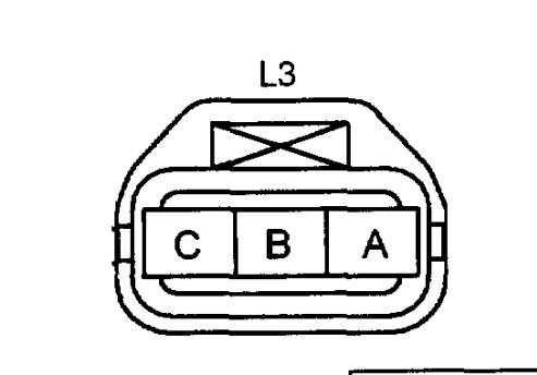

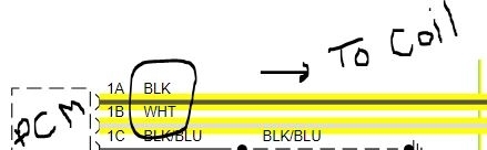

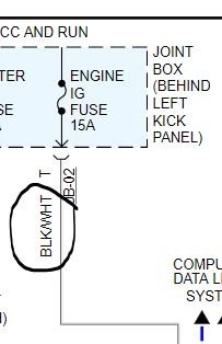

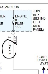

The first picture show the wire color at the coil. The next two shows where they go. The last picture shows the plug and letters identify each plug. You can see the letters on the schematic to identify color.
Let me know
+1

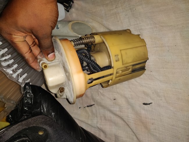

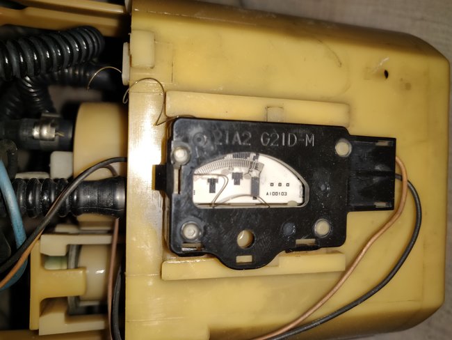

The fuel pump works fine and great, but I noticed one thing tonight and this is what I was afraid of. The fuel gauge doesn't work now and I'm sure I know the problem. The lever arm (float or whatever it's called) is too long. I still have the old fuel pump at the house to compare it to. I was thinking of bending it to shorten it and get it closer to the shape of the original fuel pump. Is that a good idea? One of my friends told me if I do that the gauge might not be accurate. Let me know what you think. I might just leave it and ride it out like it is.
Friday, August 23rd, 2019 AT 8:07 PM
  • 109,885 POSTS
Wow you aren't having much luck. If you change it and it is too short or longer than it should be, it may throw off the fuel gauge reading. The float is attached to what is called a rheostat. Basically, it is a resister that as the float chances level, it allows more or less power to be sent. If it isn't accurate as far as the float position, the gauge will be wrong.
Are you able to switch the float on the two?

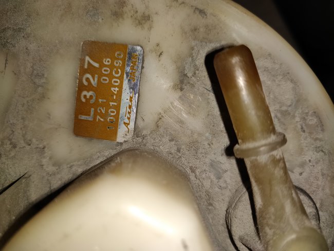

Hey Joe,

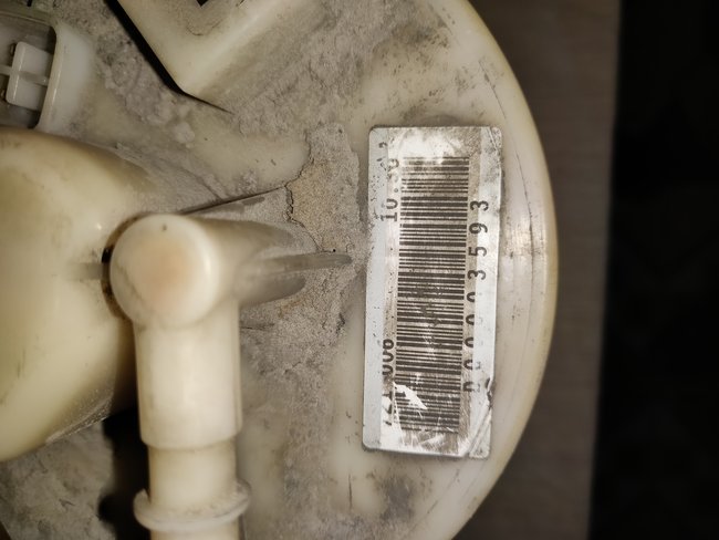

I wanted to ask. What is a 'Cut Off Assembly's in reference to the fuel pump picture I showed you?
Thanks
Sunday, August 25th, 2019 AT 3:57 PM
JEAND
  • 62 POSTS

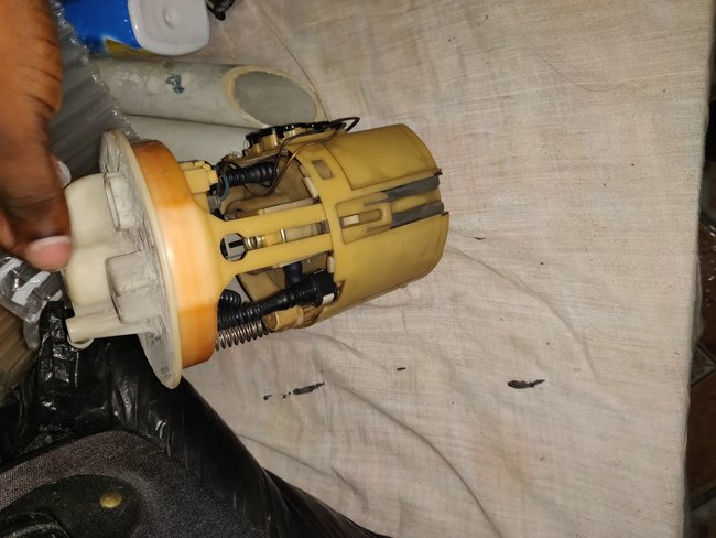

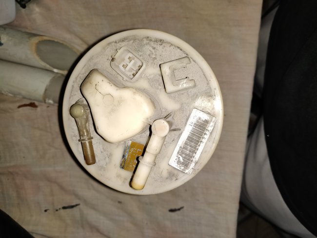

Hey Joe,

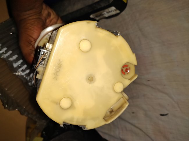

I figured everything out. I got the wrong fuel pump it seems. The one I took off the car has two openings at the top while the other has one. I thought I could just disconnect the cut off assembly and run it like that but I was so wrong, lol. Lots of gas came out from the hose leading from the cut off assembly.
I took pictures to show you the difference on them.
Do you know where I can buy the correct fuel pump assembly? I have looked everywhere and cannot find it. Some help would be greatly appreciated.
Thanks Joe.
Sunday, August 25th, 2019 AT 6:14 PM
JEAND
  • 62 POSTS
Here are the pictures. The yellowish looking one is the old one and the white one is the new one.
Sunday, August 25th, 2019 AT 6:18 PM

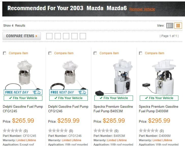

  • 109,885 POSTS
Welcome back:

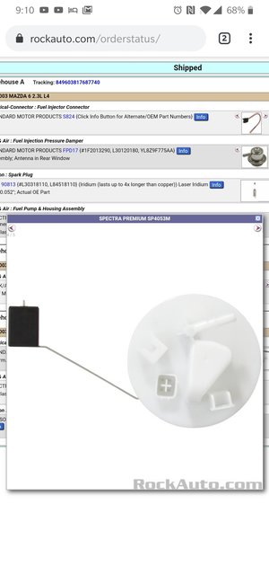

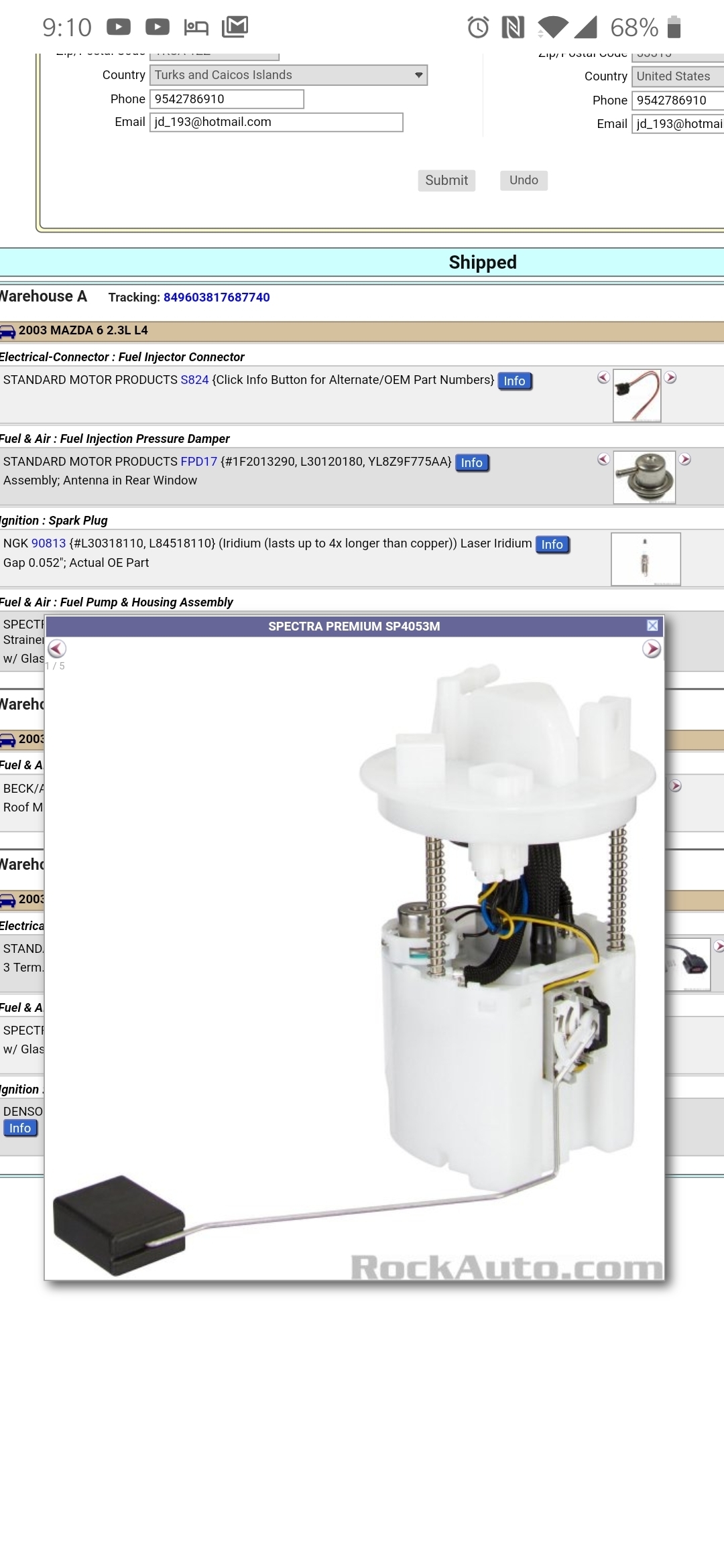

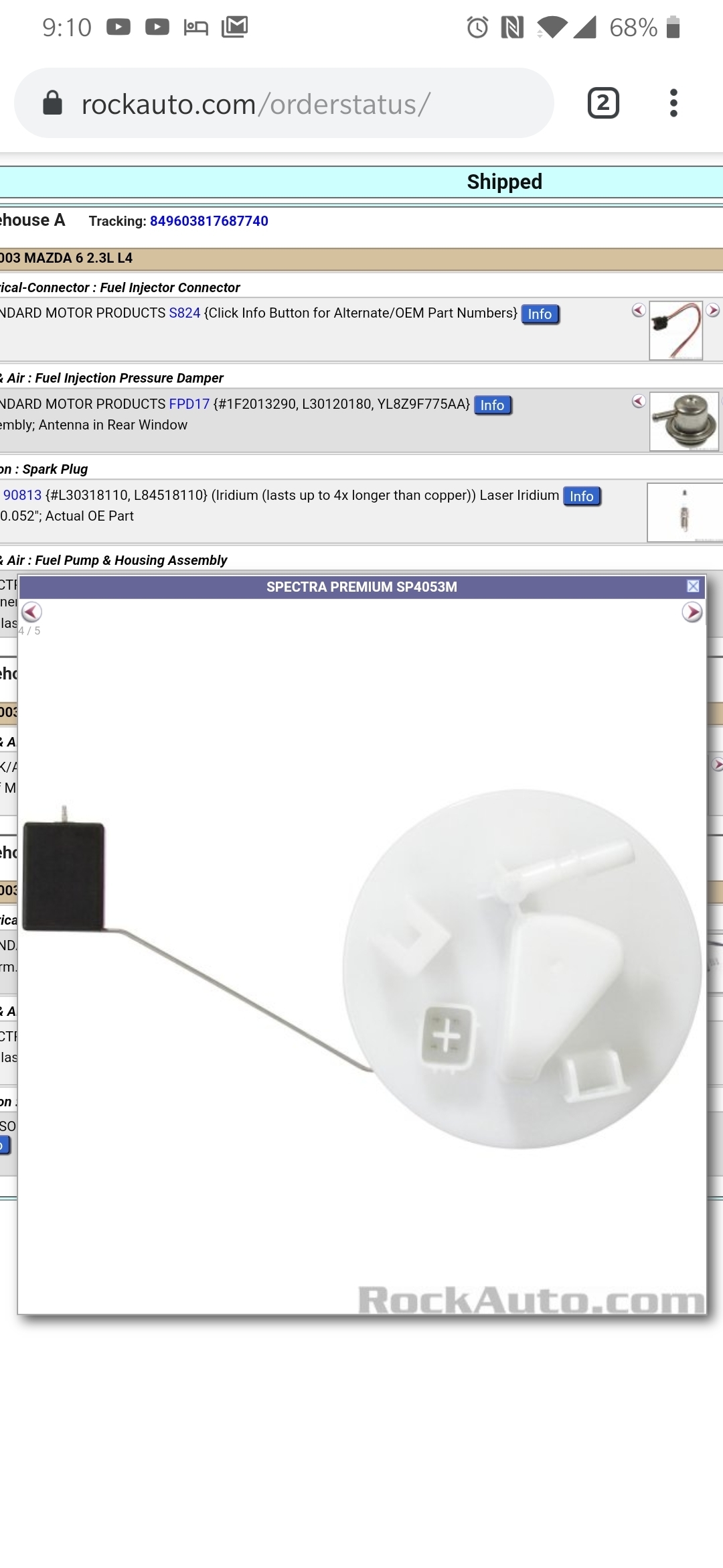

I just jumped on AutoZone's site. Here is what I found. See picture 1.
Not a cheap one is it.
Sunday, August 25th, 2019 AT 8:17 PM
JEAND
  • 62 POSTS
Doesn't have two spouts like the original. Seems there's no way I can find that fuel pump assembly.
Sunday, August 25th, 2019 AT 8:26 PM
  • 109,885 POSTS
Can you get just a pump and install it into your fuel module?
Sunday, August 25th, 2019 AT 9:10 PM
JEAND
  • 62 POSTS

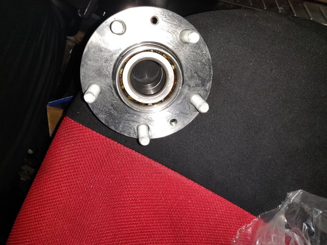

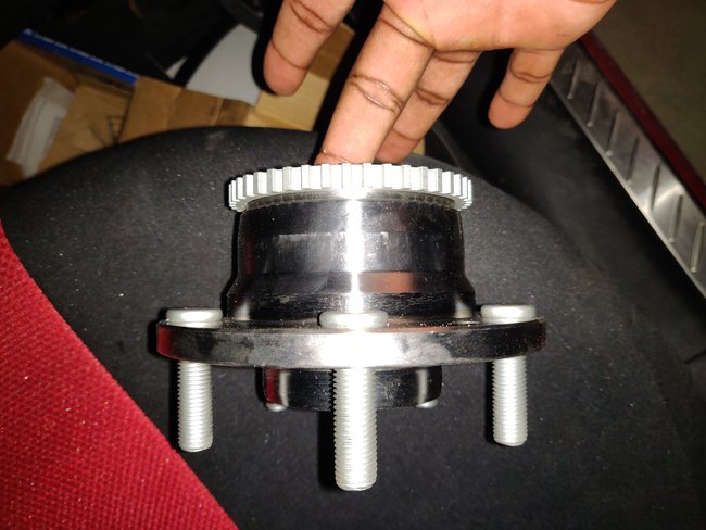

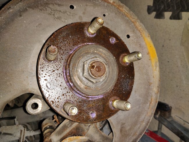

I switched the pump from the new fuel pump assembly I bought into my original fuel pump assembly.

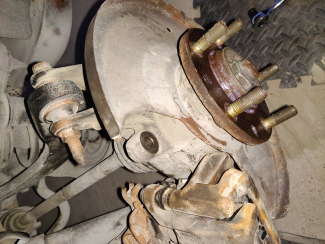

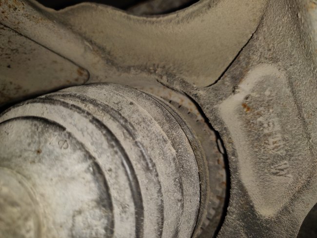

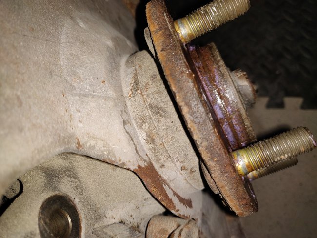

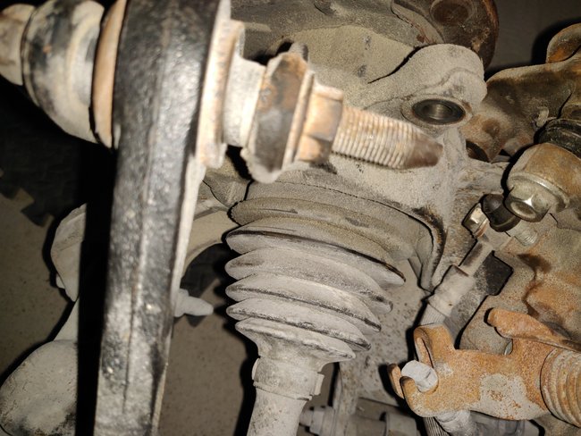

I went to remove the wheel bearing and noticed it doesn't look the same as what was in the manual I have. I think this might have been converted from a 4-wheel drive to a two wheel drive.
So I totally give up. I'm done Joe, lol.
Monday, August 26th, 2019 AT 5:15 PM
  • 109,885 POSTS

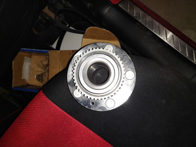

Did the fuel pump work? Also, can you provide a picture of the new bearings?
+1
Monday, August 26th, 2019 AT 5:38 PM
JEAND
  • 62 POSTS
It came as an assembly. So hub and bearings already together.
The pictures are below.
No I have not tested the pump as yet.
