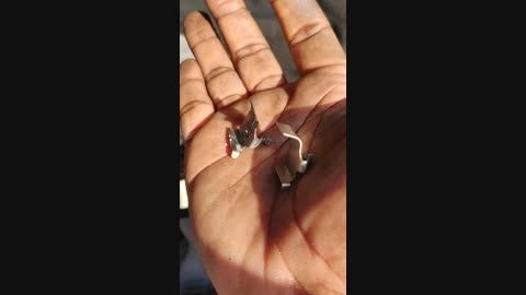

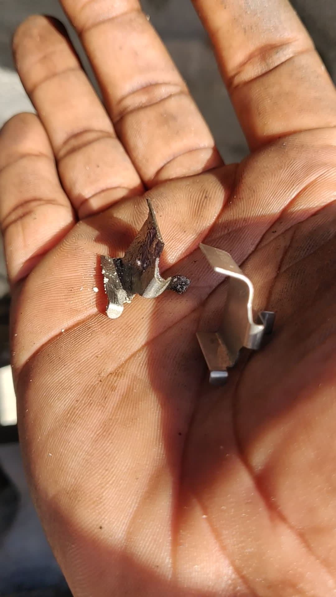

The only thing that was rubbing was the brake hardware Wich I remove and shortened with a dremel. Also, the pads on both the right and left side wheels would not go on without shortening the ends of the brake hardware.
If I lift the caliper the brakes are easily moved, and would just drop out of the bracket if I nudge them. I lube my brakes well.
I bought the *Power Stop Evo* rear brake pads. I think they were bout 17 or 19 bucks.

I'm not sure why the hardware needed shortened. Are you certain the are the correct brakes for the vehicle? And I'm not familiar with the brakes you used. If there is no noise with them off, that is the only thing I can think of. Is it possible to return them and get a different set or brand? Also, is it possible for you to record the noise you are hearing and upload it for me to hear?

Lol you are not in the least being a pain. Yeah, I have never had to shorten hardware before as well. Uhm, yeah I think I compared them.
I have another set of hardwares that came with the caliper I will try. The funny thing is that the other side isn't making any noise. That's what is weird to me.

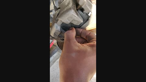

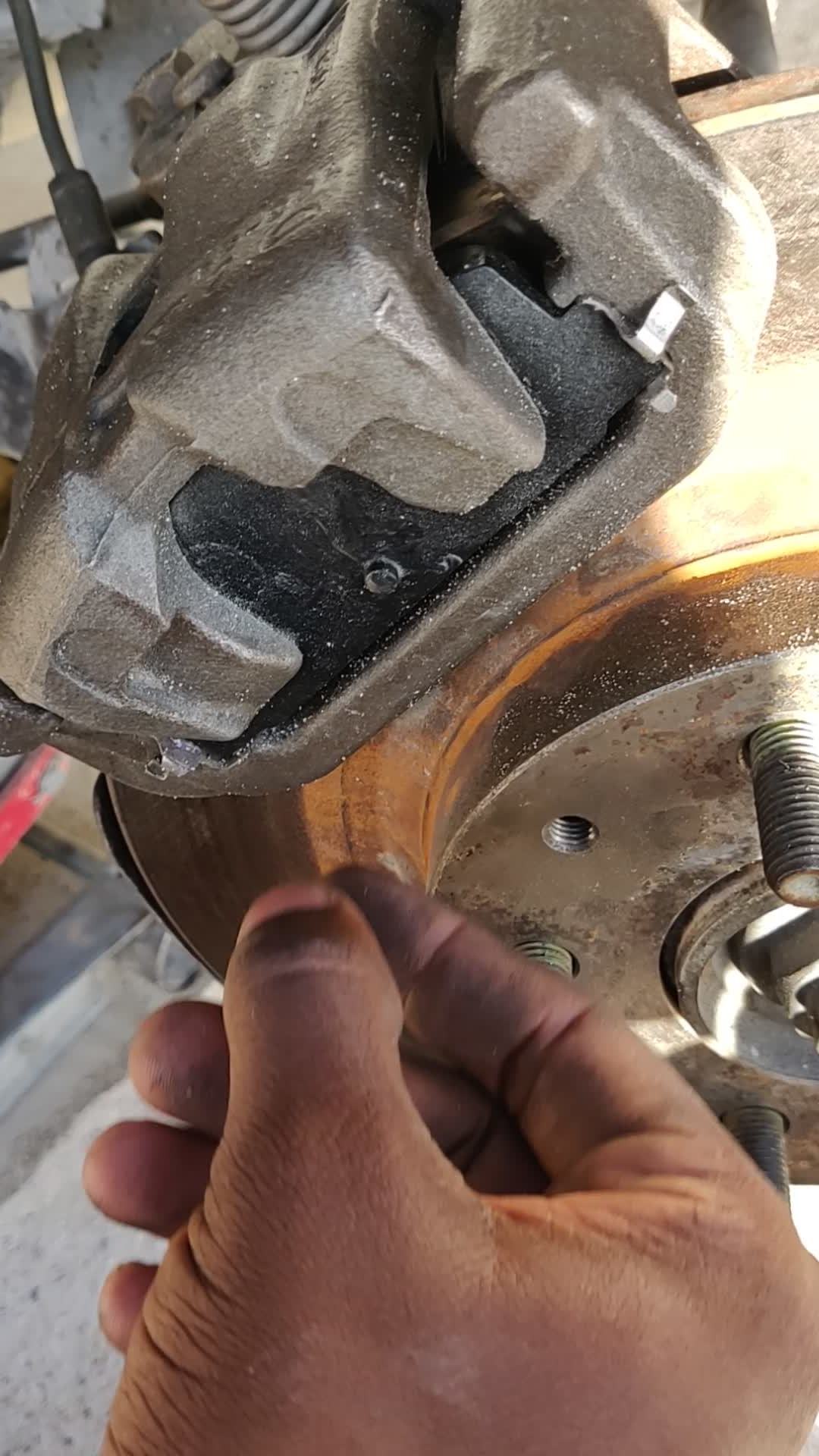

I just notice the the brake pad is loose in the caliper, as in I can easily wiggle it with two fingers. The other ones I cannot. They are tight. Could that be the culprit?

Yes, that could be the issue. Remove that brake pad and see if the sound is gone. I have to be honest, I question if something was mixed up in the packaging because you really shouldn't have had to modify the hardware.

So I think that the brakes are defective for one side. I put in the new brake hardware and it is still jiggling. The sound is there too. Since the sound is inconsistent it has to be the brake pad. When it moves it runs and then comes off then back on. I uploaded the video with the brake hardware modification. Turns out I was trying to put them on backwards like an idiot. I put on the ones that came with the caliper. The brake pad seems to be too small.

Here is the video of the brake wiggling.
Jul 20, 2019 at 5:13 AM
  • 110,251 POSTS
I agree with you. Something is wrong. I wouldn't expect to see that much play. It's good they are not stuck or frozen in place, but that seem excessive to me.
Honestly, I would start over with a different brand of brake pads. If you have the hardware that came with the caliper, just use those. Don't be surprised if the problem is the composition used in the brake pads themselves. I have experienced that in the past.

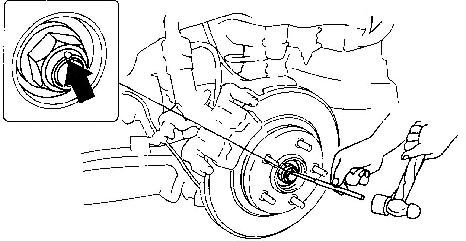

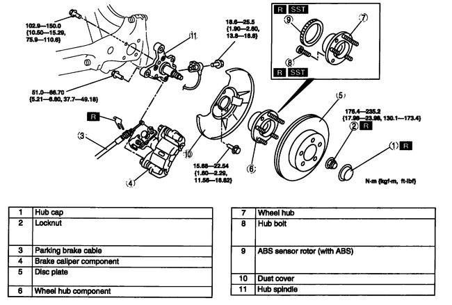

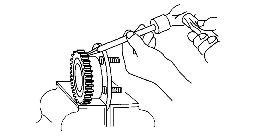

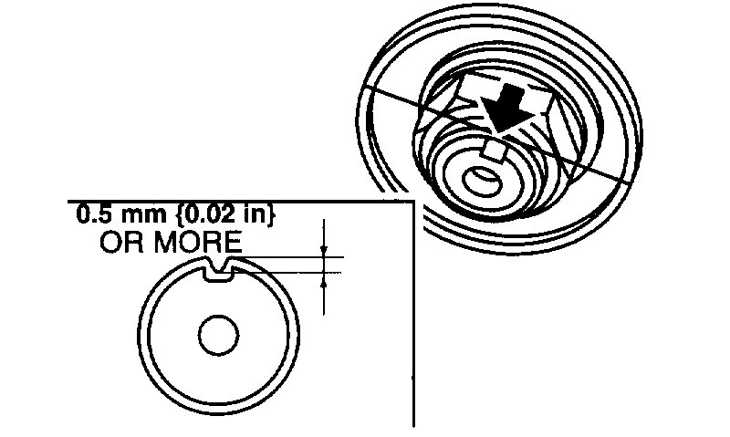

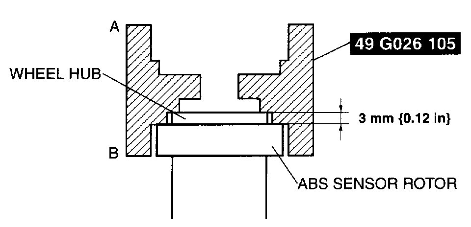

For the bearing, here are the directions for replacement. The pics attached correlate with the directions.
__________________________
REAR WHEEL HUB, HUB SPINDLE REMOVAL & INSTALLATION
WHEEL HUB, HUB SPINDLE REMOVAL INSTALLATION
Caution:
^ Performing the following procedures without first removing the ABS wheel-speed sensor may possibly cause an open circuit in the harness if it is pulled by mistake. Before performing the following procedures, remove the ABS wheel-speed sensor (axle side) and fix it to an appropriate place where the sensor will not be pulled by mistake while the vehicle is being serviced.
pic 1
1. Remove in the order indicated in the table.
2. Install in the reverse order of removal.
Locknut Removal Note
pic 2
1. Knock the crimped portion of the locknut outward using a small cape chisel and a hammer.
2. Lock the hub by applying the brakes.
3. Remove the locknut.

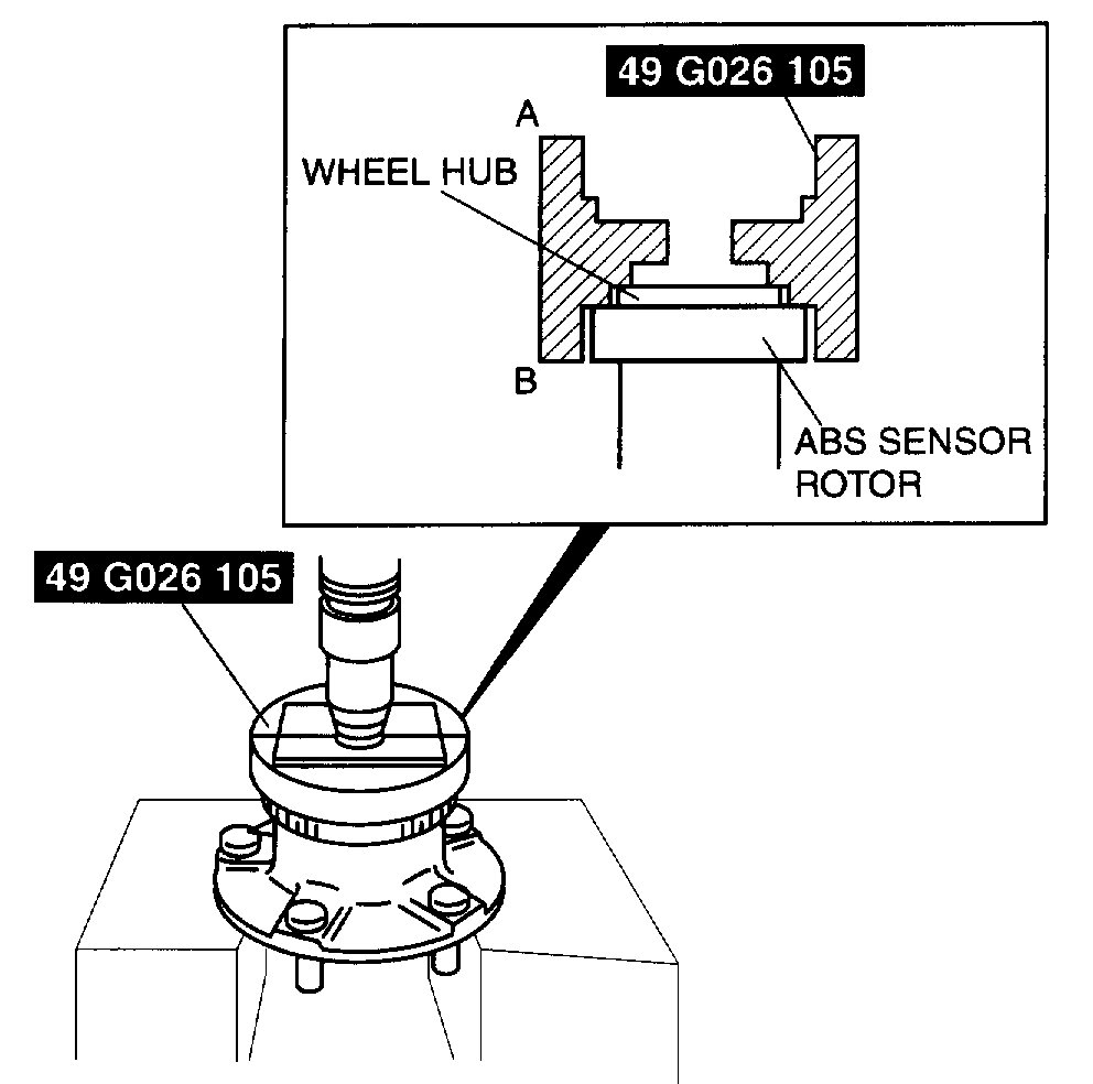

ABS Sensor Rotor Removal Note
Note:
^ The sensor rotor does not need to be removed unless it is being replaced.
pic 3
1. Remove the sensor rotor using a chisel.
ABS Sensor Rotor Installation Note
pic 4
1. Set the SST as shown in the figure.
Caution:
^ Position the SST so that marking B faces the bottom.
pic 5
2. Press on the new sensor rotor using the SST and a press.

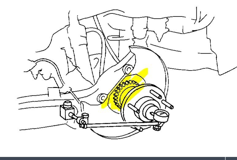

Locknut Installation Note
pic 6
1. Install a new locknut and stake it as shown.
I hope this eliminates the issue. Let me know how things turn out for you.

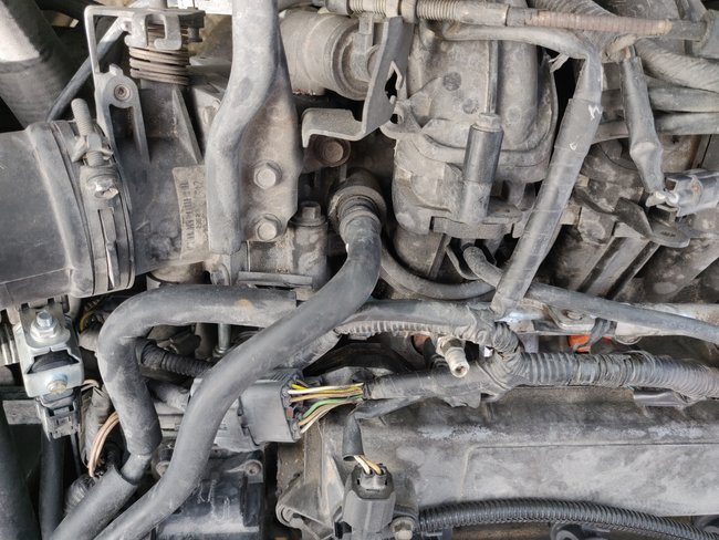

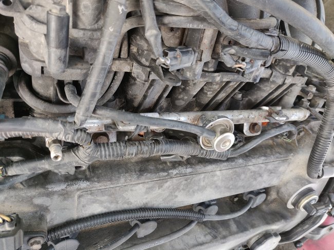

Thank you for all the information Joe, I really do appreciate it. Once the part reaches next week and I fit it on I will let you know how it went.
The Schrader valve for the fuel pressure test adapter is that the screw in valve on the right side of the fuel rail in the picture?
The picture is upside down for some odd reason.

If that is part of the fuel rail, yes. And I look forward to hearing from you on the noise.

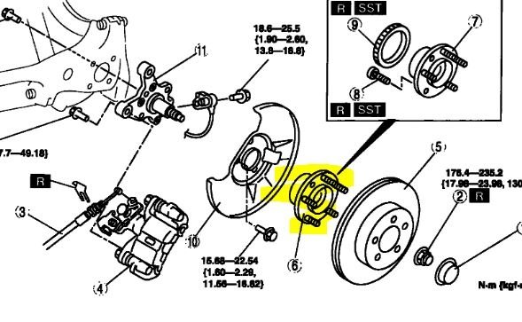

Hope all is well. Tried getting the hub off but it is stuck. Seems I might have to find a slide hammer to get it off.

That's an interesting fix. lol As long as it's working, that's all that matters. As far as the hub, if you are referring to the part I highlighted in the pic, a slide hammer can be used or they actually make a puller to get that apart.
Let me know if I can help.
Aug 2, 2019 at 12:48 PM
JEAND
  • 62 POSTS
Unfortunately I have to order the slide hammer..
So now I wait... Yes the highlighted part is what I was referring to.
