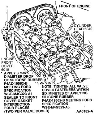

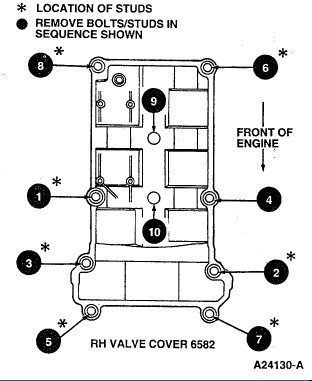

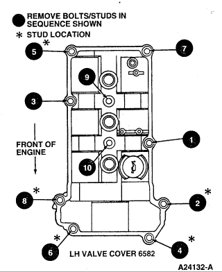

I drive this car everyday. It is the 3.0 24 valve Duratec. I used to have an oil leak where I needed to put in two quarts in every month. I replaced the pan gasket and the PCV valve, now I get rid of that much in about three months.
So what is next? I am going to replace my valve cover gaskets because I think I see a leak going down the rear side of the engine.
The Haynes manual is terrible in regards to the Duratec, I do not have hardly any pictures or diagrams for referencing. I see that a valve cover set comes with other gaskets for spark plugs and whatnot, how do I put them on?

Loosen valve cover retaining bolts and stud bolts following the removal sequence shown.

NOTE: Tighten all fasteners within six minutes of applying sealer or sealer will begin to cure and may not seal properly.
Install new valve cover gasket onto valve cover.
Apply 8 mm (0.31 inch) diameter bead of Black Silicone Rubber F4AZ-19562-B or equivalent sealant meeting Ford specification WSF-M4G323-A1 at two places on the valve cover sealing surfaces where the engine front cover and cylinder head contact.
Tighten valve cover bolts and stud bolts in sequence shown to 8-12 Nm (71-106 inch lbs.) within six minutes of applying sealer.
Follow removal procedure in reverse order to complete assembly.
I've attached pictures of the tightening sequence for you as well as what you will find once removed.

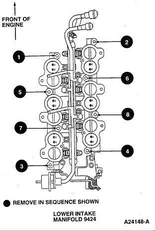

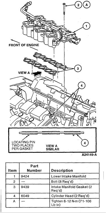

Once you have things apart, make sure to check the intake gasket for leaks as well. If you find a leak, here are the directions from alldata to remove and replace the components. I've also attached pictures for guidance.

REMOVAL
Relieve fuel system pressure. Refer to Powertrain Management.
Disconnect battery ground cable.
Remove upper intake manifold.
Disconnect fuel supply and return lines from fuel injection supply manifold. Refer to Powertrain Management.
Disconnect engine control sensor wiring from fuel injectors and wiring retainers. Position engine control sensor wiring out of the way.
Disconnect vacuum supply line from fuel pressure regulator.
CAUTION: Do not loosen or bend intake manifold runner control actuator cable retainer bracket. Bracket alignment is critical and potential damage to the intake manifold runner control actuator (IMRC) may occur.
NOTE: Use care when removing actuator cable from the IMRC Lever.
Disconnect the intake manifold runner actuator control cable from the lower intake manifold (IMRC) lever and bracket.
Disconnect the ignition wires from the LH cylinder head (cylinder numbers 4, 5 and 6). Position ignition wires out of the way.
If required, remove fuel injection supply manifold and fuel injectors from lower intake manifold (IMRC).
Remove lower intake manifold to cylinder head retaining bolts in sequence shown.
CAUTION: Do not loosen or damage intake manifold runner control actuator cable retainer bracket.
Remove lower intake manifold (IMRC) from cylinder heads.
Remove intake manifold gaskets from cylinder heads and discard intake manifold gaskets.
