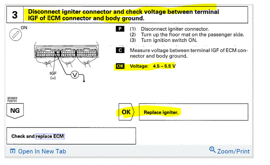

Okay. I've managed to check some things in the ignition circuit and here's what I've found:
1. Good spark when cranking.
2. Good continuity in igf wire from ECM to igniter.
3. IGF signal is 4.6V at ECM and igniter.
5. 12V power to igniter.
9. Good continuity in igt wire from ECM to igniter.
Not sure if this points towards a concrete problem, or if there are still things to test.
Tuesday, April 19th, 2022 AT 4:29 AM
  • 109,779 POSTS
Based on your findings the igniter is bad and needs to be replaced5. Take a look at pic 1 below and let me know your thoughts.

Yep, seems that way. Thanks for the confirmation. I'll try procure one and let you know what happens.

Hi, it has been a while. I had it at the mechanics for the past couple of months. Turns out it was a blown capacitor in the ecu causing problems. Sent the ECU over for repairs and now she runs like new. Thanks for all the help that I got along the way, its feels so good to finally have it running again.
