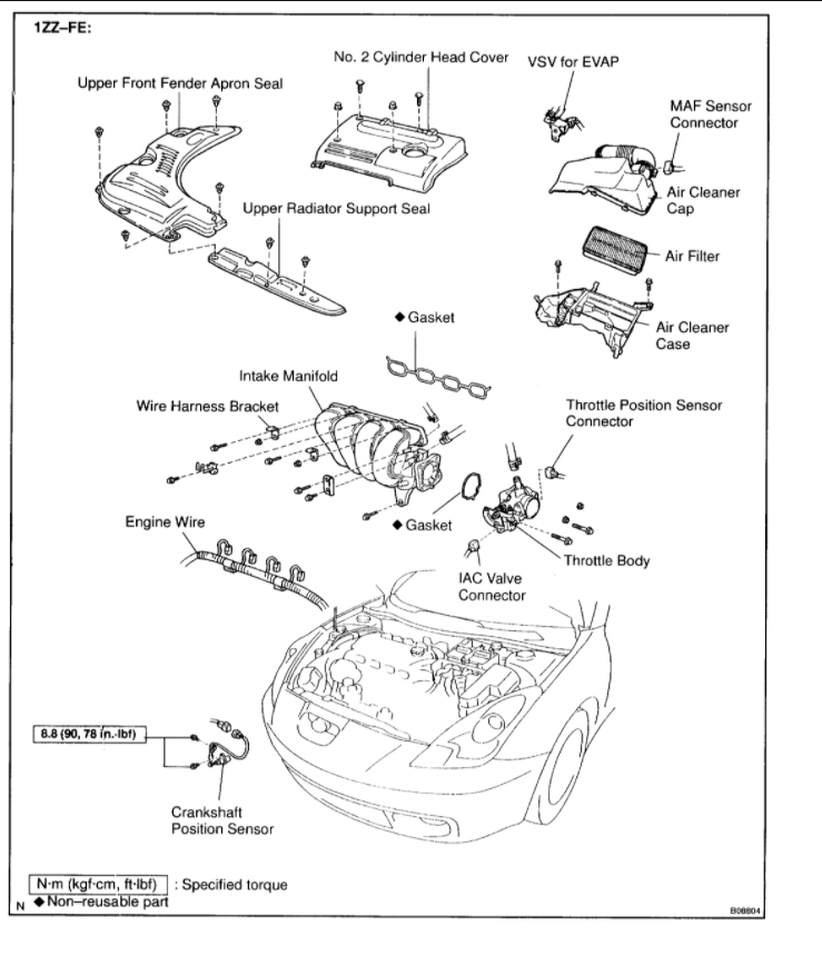

It wont start it gets petrol to the injector but not to the spark plugs. What can I do?

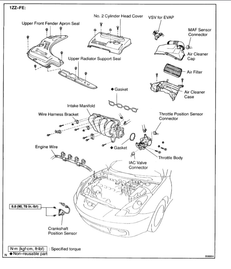

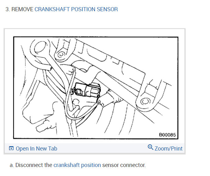

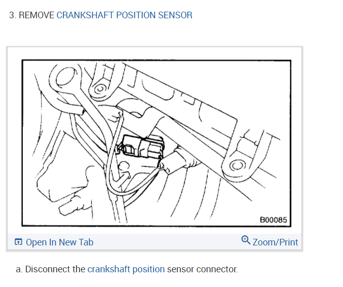

It sounds like the crankshaft angle sensor is out. To be sure lets go over this guide. Here is the location of the sensor and how you change it out in the diagrams below:

Yep, I had this problem and had to get a new sensor worked perfect started right up has not quit since.
