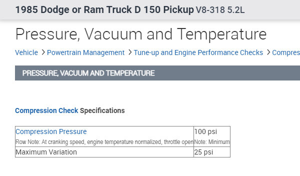

Is a gauge absolutely necessary? Do I need to know the exact PSI or am I just making sure there's compression?
Monday, June 5th, 2023 AT 3:27 PM
  • 109,885 POSTS
A gauge would help. Compression can be low enough to prevent it from starting, but enough to blow your thumb off the spark plug hole.
If you don't have one, oftentimes a parts store will lend one to you.
See pic below.

So, yeah, compression is s***. 100psi max, average was less than 90. Great times.
Tuesday, June 13th, 2023 AT 5:34 PM
  • 109,885 POSTS
Okay. That is a little lower than what we want. But, I want you to do a wet compression test. Before installing the gauge, add about 1 tablespoon of motor oil to the cylinder and then recheck the compression. See if it increases.
