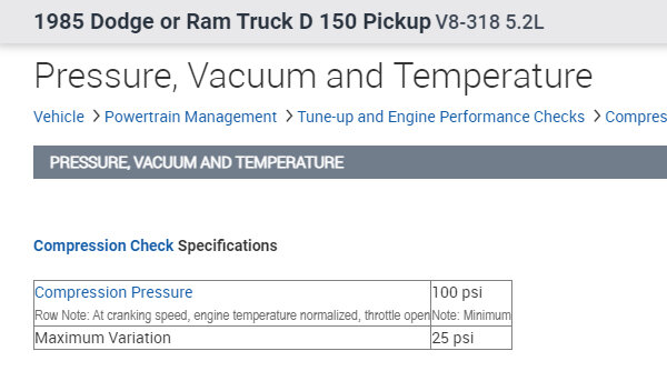

Is a gauge absolutely necessary? Do I need to know the exact PSI or am I just making sure there's compression?
Jun 5, 2023 at 8:27 AM
  • 110,248 POSTS
A gauge would help. Compression can be low enough to prevent it from starting, but enough to blow your thumb off the spark plug hole.
If you don't have one, oftentimes a parts store will lend one to you.

So, yeah, compression is s***. 100psi max, average was less than 90. Great times.
Jun 13, 2023 at 10:34 AM
  • 110,248 POSTS
Okay. That is a little lower than what we want. But, I want you to do a wet compression test. Before installing the gauge, add about 1 tablespoon of motor oil to the cylinder and then recheck the compression. See if it increases.
Jun 13, 2023 at 12:59 PM
GCROW
  • 57 POSTS
Okay, so I feel like I should start a new thread. lol
After re-reading the testing instructions, I retested the compression, and the results are as follows.
#1=160psi #2=140psi
#3=160psi #4=110psi (120 after adding oil to cylinder)
#5=150psi #6=160psi
#7=150psi #8=150psi
Jun 14, 2023 at 3:42 AM
  • 110,248 POSTS
Are those the readings after adding the oil? If so, I suspect the compression rings are worn. Did you try starting it after this test when the compression was higher?
