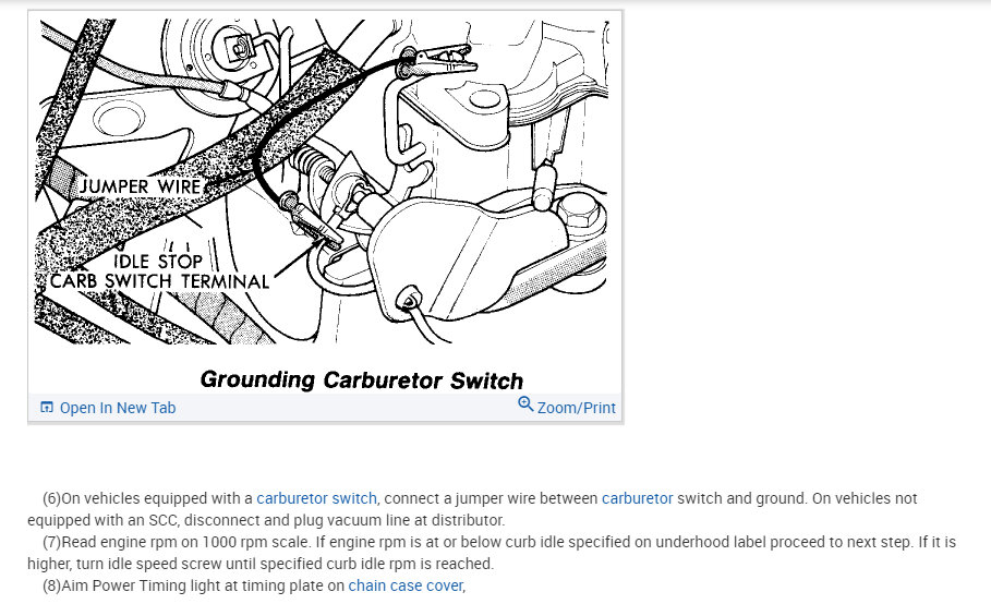

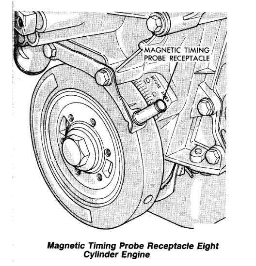

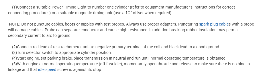

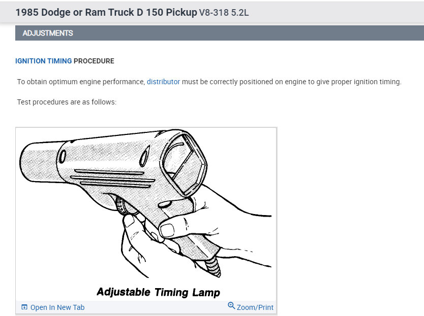

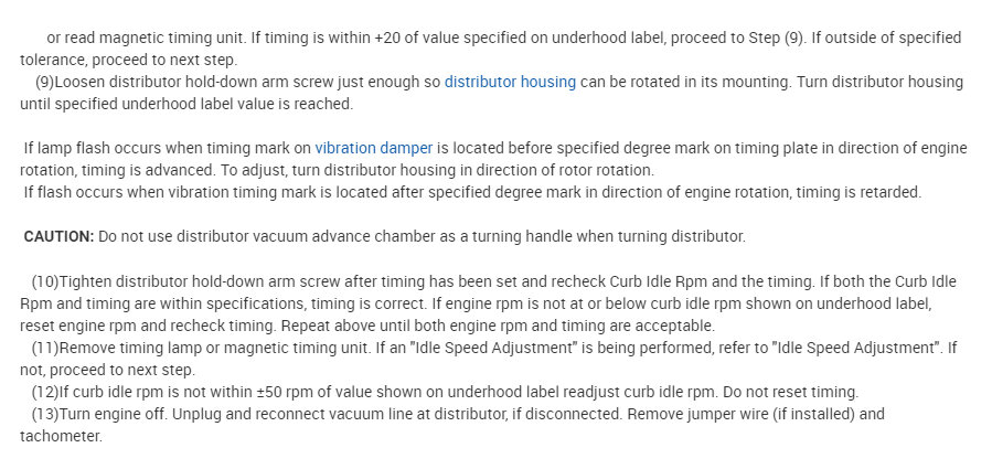

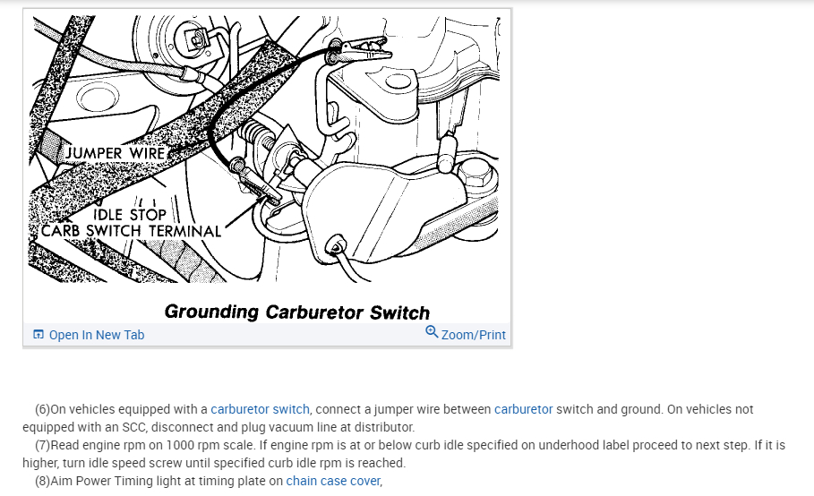

When you say you turned the distributor, that will change the ignition timing. Were you able to get it back to where it belongs using a timing light? Also, did you remove the reinstall the distributor?
Let me know. Also, I attached the directions below for setting ignition timing via the distributor. If there is no label under the hood indicating the degrees before TDC, start around 10 BTDC.
Note that the directions are with the engine running. You can do it while cranking the engine as well. Once you get it running, you can fine-tune the timing.

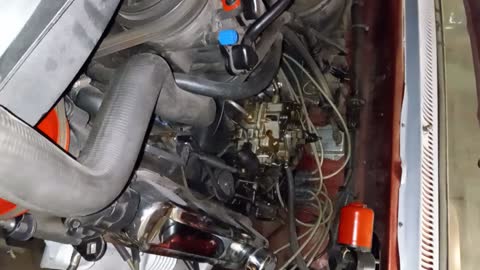

Is it possible for you to record it cranking and upload it for me to hear?
May 4, 2023 at 12:18 PM
GCROW
  • 57 POSTS
This is what she sounds like with distributor aimed at the #1 cylinder.
May 5, 2023 at 5:30 AM
  • 110,248 POSTS
Wow, that is turning fast. Before you had the fuel pump issue, was it running normally? It didn't even seem to fire at all. Are you sure it has spark to the plugs? If you use starting fluid, and nothing changes, it's likely there is no spark to the plugs. Check for spark and let me know what is found.

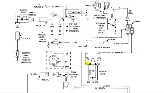

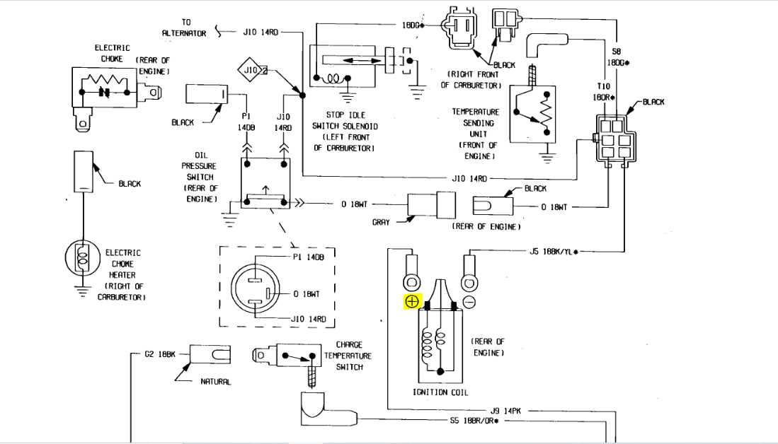

If there is no spark, the next thing I need you to check is for power at the coil. I found some old manufacturer's wiring schematics. I attached them below. Note that it was only one page in length. I had to cut it in half to make it readable. I did overlap them so you can follow from one to the next.

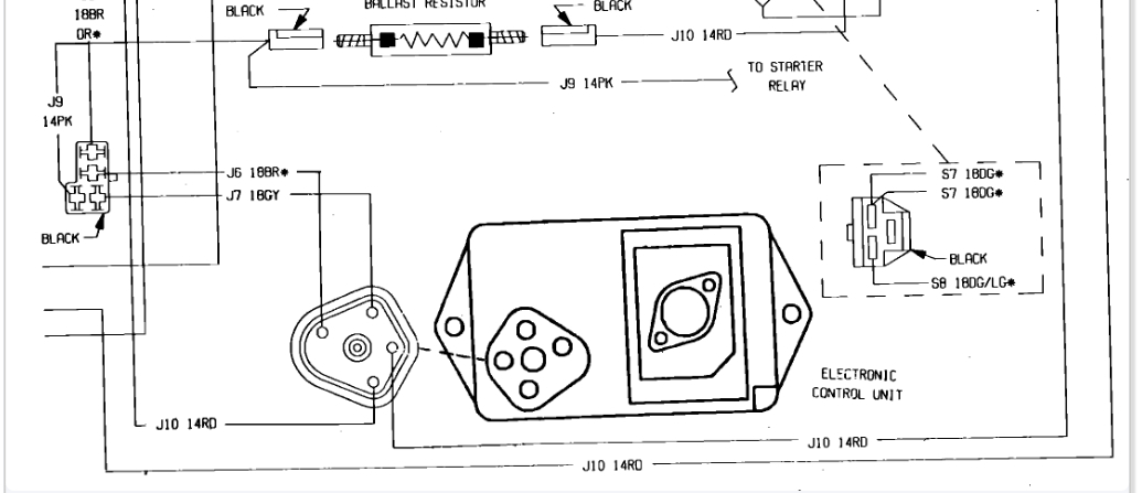

Check the coil for power. Also, confirm the ECU hasn't been slightly disconnected (pic 3). If you remember which wire your hand got caught on, let me know that as well.

Yeah, they had spark. When I checked for codes, the check engine light didn’t blink. The distributor incident happened when I was replacing the pigtail on top of the transmission. The distributor got turned by me trying to squeeze my arm around it. I appreciate the schematics; I have been considering doing some wire inspection and I am sure these will help. I have already run my multi-meter throughout the entire wiring harness. Don’t guess it could hurt to do it again. Unfortunately, I am a tad on the disabled side, so any amount of DIY proves to be a bit more difficult that it should be. I will keep you posted on any progress or lack there of.

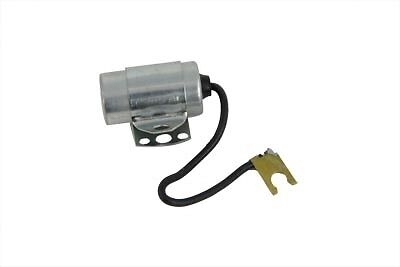

There is a lot of backfire. It occurred to me (after coming across it), I didn't put the capacitor back in place when I put the coil back in. Had to remove the coil to make room to get my hand through. Is there any way it could be that simple?
May 8, 2023 at 3:50 AM
  • 110,248 POSTS
Capacitor? Can you upload a pic of what you are seeing? There really isn't a capacitor in the ignition system.
Also, if it is backfiring, were the spark plug wires removed and replaced? If so, are you sure the wires are in the correct firing order? See pic below.
When I heard it cranking, I didn't notice any backfiring. Let me know what is happening.

I call it a capacitor. Normal people call it a condenser, wire to positive lead and mounted between the coil and firewall. I will check the wire order again. Couldn't hurt. The noise of cranking may have drowned out the backfiring.
May 8, 2023 at 12:26 PM
  • 110,248 POSTS
Have you replaced it? That could be causing an issue.
May 8, 2023 at 1:32 PM
GCROW
  • 57 POSTS
Not yet, I wanted to get your thoughts first.
May 8, 2023 at 1:41 PM
  • 110,248 POSTS
In the old days, that is what was used with points in the distributor. It prevented arcing by absorbing power when the points opened. (electric always takes the easiest way out). If that is tied into the ignition system, that could be allowing spark to be jumping around. I would give it a try.

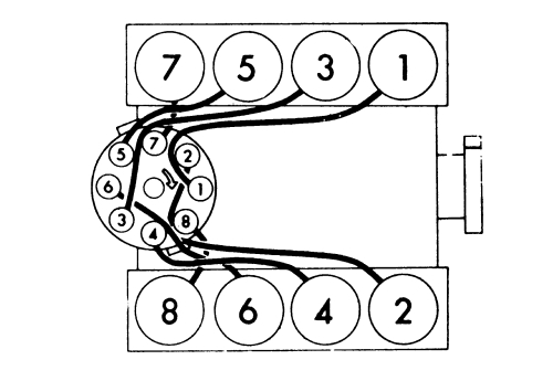

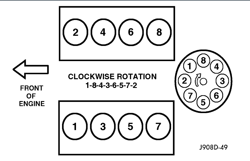

Hey Joe, I was comparing the firing order you sent to what is in the pickup. The image shows #1 towards the 7 o'clock position. I have it with the #1 wire at approximately the 5 o'clock position, more or less aimed towards piston #1.
May 11, 2023 at 2:02 AM
GCROW
  • 57 POSTS
I guess I'm asking which of the 3 is correct. Aimed towards the #1 piston, the example you sent me or the example from my Chilton manual. See pic below
May 12, 2023 at 1:55 AM
  • 110,248 POSTS
The pic I attached above is correct. You need to align the TDC mark on the crankshaft pulley with the indicator. Once that is at TDC, the rotor should point to the front of the vehicle. Is that what you have?

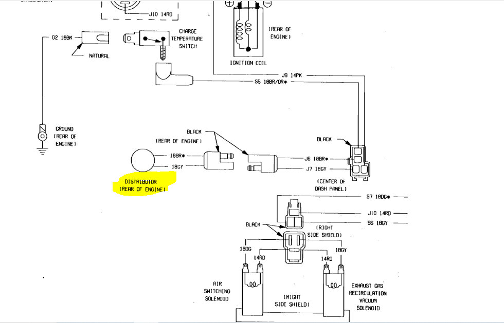

Hey Joe, would you happen to know where I can find a better wiring diagram/schematic than what's in my manuals? There are a lot of wires not shown in these.
May 28, 2023 at 2:01 AM
  • 110,248 POSTS
Which ones are needed? Let me know. Although my manual is somewhat limited, there are a lot of schematics for specific things. Other than me, you can purchase a Hynes or Chilton manual from most parts stores.
May 28, 2023 at 1:19 PM
GCROW
  • 57 POSTS
I actually have both manuals. I tend to get both manuals for all my vehicles. The connection point to the inside wiring at the firewall doesn't seem to be represented, nor do all the colors of different wires i am finding.
May 29, 2023 at 2:44 AM
  • 110,248 POSTS
I'm not sure why they would be different. Is there a chance the wiring may have been changed at some point?

Ya know, knowing the previous owner, that would not surprise me in the least. For example, the EGR system and cruise control were both completely eliminated.

for the most part, yes. Only a few wires i am have trouble with. I will see if I can get some pics of them to show you.

Okay, so I tried to get a pic or three of the wires. Couldn't tell some colors from the others. What I found was that one set went to the eliminated EGR time delay, another to a solenoid that doesn't exist in a light duty truck. Still tracing wired to make sure no breaks or fraying and such. Meanwhile, darn thing still will not start.
