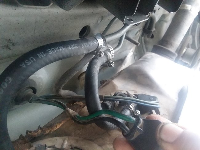

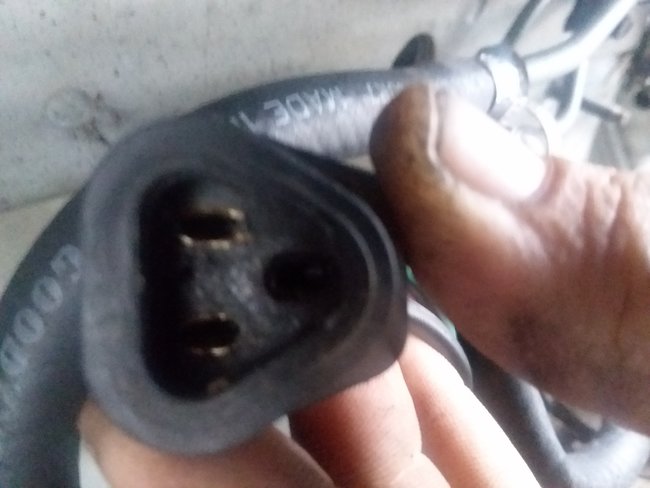

Fuel pump replacement

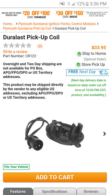

It comes with that bottom piece?
Nov 6, 2018 at 11:29 AM
Yes, that is correct.
Nov 6, 2018 at 6:26 PM

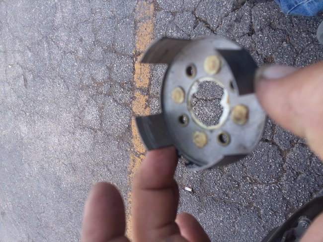

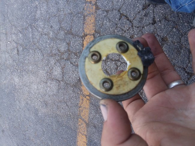

It comes with the sbuttwt wheel usually?
Nov 6, 2018 at 9:19 PM
What wheel?
Do not understand what you posted.
Nov 6, 2018 at 9:39 PM

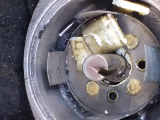

Sorry. The shutter wheel. Those white pieces broke of the shutter wheel.
Nov 6, 2018 at 9:55 PM
Yes, the replacement piece is complete. It just drops in and you plug it in.
Nov 6, 2018 at 10:06 PM
The reason I ask is cause the part from AutoZone does not show the shutter wheel in the picture it just shows the pick up coil.
Nov 6, 2018 at 10:43 PM
When you go to the parts store, take the old one with you to match it up. It should have everything with it.

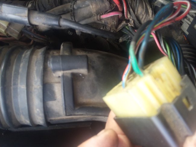

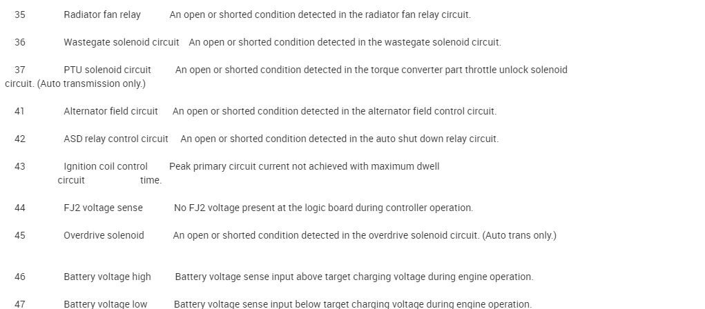

Got it running. Drove about thirty miles the had to pull over on side of highway. Now the motor is not turning just hear the starter cranking. Got code 42.
Nov 8, 2018 at 5:21 AM
I swapped the relay with another relay nothing changed. Will check wiring but did not do anything once I put the new distributor in. It was working fine then got about half way to Austin then it just kind of lost power. Checked oil it is low, but car not even cranking just hear the starter spinning. New starter and timing belt and of course the distributor. Will check the ASD relay wiring. If I do not find anything wrong any other suggestions?
Nov 8, 2018 at 5:40 AM
Can you hear the fuel pump run? Do you have spark?
Check the fuse for the ASD relay.
Nov 8, 2018 at 5:43 AM
Took starter off it is not engaging the flywheel so not sure how to fix that or even if I could.
Nov 9, 2018 at 1:35 AM
Think the flex plate is broken.
