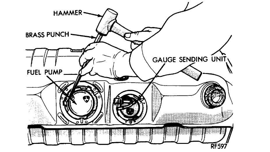

Can I get directions for replacing fuel pump please?
Nov 1, 2018 at 7:47 AM
Good afternoon.
I attached the procedure below for the replacement. Make sure you remove as much fuel as you can.
Removal
It is necessary to remove the fuel tank from the vehicle to replace the fuel pump. Follow fuel tank removal procedure.
See: Fuel Tank > Procedures
Removing Fuel Pump - Typical
1. Using a hammer and a non metallic punch carefully tap lock ring counter clockwise to release pump.
2. Remove fuel pump and 0-ring seal from tank. Discard old seal and pump inlet filter.
Installation
1. Wipe seal area of tank clean and place a new 0-ring seal in position on pump.
2. Before installing pump always install a new filter on the end of suction tube.
3. Position fuel pump in tank with locking ring.
4. Using a hammer and non metallic punch drive ring around clockwise to lock pump in place.
CAUTION: Extreme care should be exercised not to overtighten pump as it could leak.
5. Install tank.

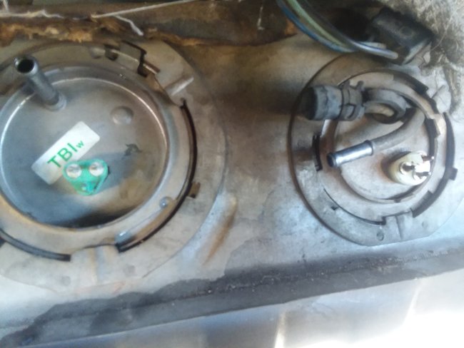

Took tank off but nothing under tank where it meets the car only two spots on back off tank where fuel lines connect to. Attaching images need help which one is it in and how to get it off.
Nov 2, 2018 at 12:56 AM
MARC WOODS
  • 53 POSTS
Which one is the fuel pump in and how to get it out? Thank you.
Nov 2, 2018 at 1:01 AM
In your picture, the one on the right.
If you look at the picture I sent you a while back, you need to use a hammer and chisel or screw driver to walk the lock ring around until it releases.
Nov 2, 2018 at 1:17 AM

Got it put in it was the one on the left. Car still will not start though. It has been sitting for a little over a week so the battery is low will that cause the fuel pump to not turn on?

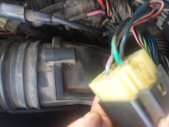

Pump in a new pump today swap the ASD relay and tried to jump the car still nothing. Sprayed starter fluid started far a couple of seconds then shuts off. What could be my problem?
Nov 3, 2018 at 8:23 AM

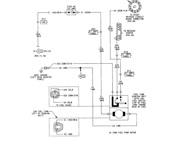

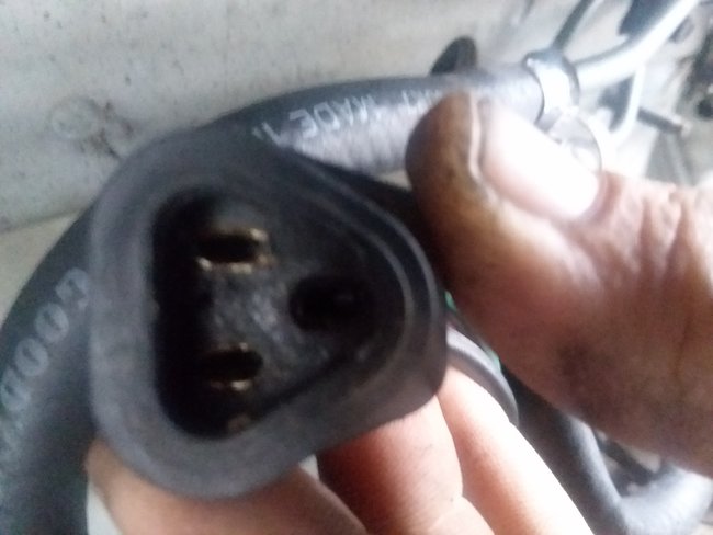

Can you hear the pump turn on when you turn on the key?
Check for power to the fuel pump at the connector.
Check fuse in the diagram I attached for power on both sides with a test light or voltmeter.
Nov 3, 2018 at 8:47 AM

I unplugged all the relays and car still cranks tried bypassing the relays with a paper clip put still do not hear the pump coming on. Could it be the battery is too low? I know I already asked you about the low battery. But just trying to figure it out until I have a way to get a test light.
Nov 4, 2018 at 8:33 AM
Yes, as I stated way back, it needs to be charged to 12.6 volts. Jumping is not the correct way. You need a battery charger or take it to a parts store and have it charged. that is also a free service.
Lets start there.
I am worried about the jumping with a paper clip. You may have blown fuses as that is not a good thing to do without knowing what you are jumping out.

It was the ASD relay I will get the battery charged. Terminal 87 and 30. Did it to the fan relay and the fan came on but not when I tried it on the ASD relay did not hear the pump come on. I will charge battery first and get a test light and check for power and get back to you.

Getting power to the relay but not the pump.
Nov 5, 2018 at 2:59 AM
Okay, how many powers do you have at the relay?
Does it click with the key on?
Did you look at the diagram the other tech sent you?

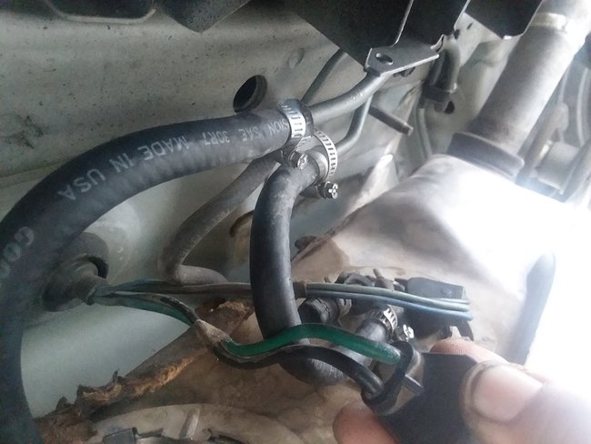

Using a test light do not hear it click when key on. Tried checking for power at green and black wire that goes to pump had helper turn key on while checking no power to pump. Will double check the diagram.
Nov 5, 2018 at 4:33 AM
MARC WOODS
  • 53 POSTS
Caradiodoc, expert, said;
Cranking has nothing to do with the ASD relay. If you do have spark, we know the ASD relay is turning on, so the cause of the bad pump has to be after that. You will need to check for 12 volts on the dark green/black wire in the fuel pump's connector, but you have to do that while a helper is cranking the engine. As an alternative, you can unplug the ASD relay, then use a stretched-out paper clip, or piece of wire, in the socket to jump the red wire to the dark green/black wire. The ignition switch does not have to be on for this. The jumper will put 12 volts on the dark green/black circuit so you can test for that at the pump's connector
Nov 5, 2018 at 5:02 AM
Okay, I read that on your other post.
He is correct but I would not have jumped the ASD. I would go right to the fuel pump relay.

When I did that I can hear the pump running while I am under the car at the pump does that mean the relay is bad?
Nov 5, 2018 at 5:54 AM
MARC WOODS
  • 53 POSTS
I thought the fuel pump relay was integrated with the ASD relay.
Nov 5, 2018 at 5:55 AM
You are right. It is part of the ASD relay.
It feeds injectors and the coil. As he said, if you have spark, then it is not the ASD relay. It has to be wiring from the relay back to the pump connector.

Replaced pump and relay fuse is good but not getting power to the fuse. I think used test light on fuse and terminals but no indication of power to the test light. Took fuse out and tried to start car does same thing as when it is in. What is my next step?
Nov 5, 2018 at 2:03 PM
It sounds like you have an issue at the fuse box if you have no power to the fuse. inspect the fuse box carefully for any damage.

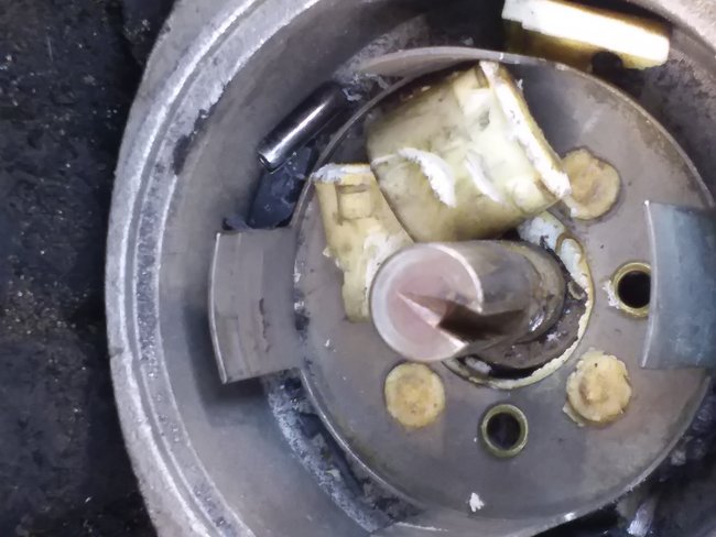

How this all started was; I was driving down the road then the car lost power and I got out checked under hood and the alternator belt was off and the accessory belts but I put them back on. Could it be the time belt came loose too. That is when I did not hear the fuel pump come on anymore and sprayed starting fluid and it started and shut off so I thought the fuel pump went out. Need to get the car back on the road been stranded for two weeks already. Thanks for all the help so far Roy.

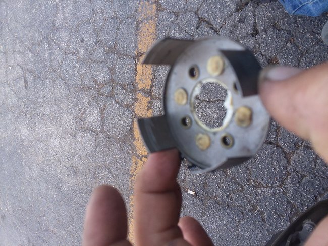

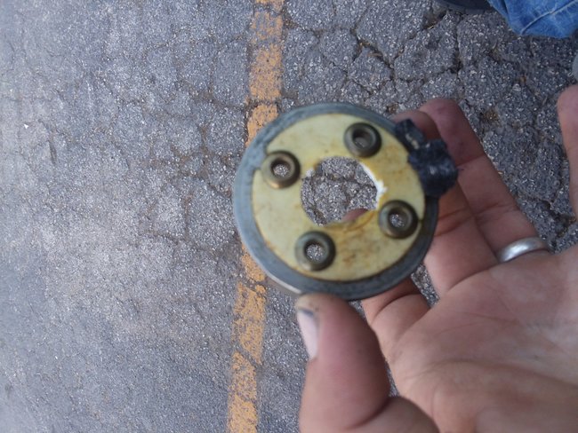

Took off distributor and found this under the pick up assembly.
Nov 6, 2018 at 9:56 AM
MARC WOODS
  • 53 POSTS
Not sure what this part is called but need to know so I can replace it tonight. Stuck in parking lot at autozone.
Nov 6, 2018 at 9:59 AM
That is what is left of the pick up coil. Replace it. You can get it at a parts store.
