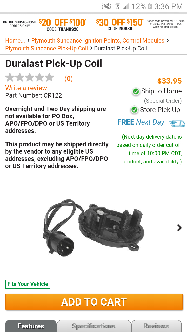

This is what I need?
Tuesday, November 6th, 2018 AT 7:24 PM
MARC WOODS
  • 53 POSTS
It comes with that bottom piece?
Tuesday, November 6th, 2018 AT 7:29 PM
  • 52,797 POSTS
Yes, that is correct.

MARC WOODS
  • 53 POSTS
The reason I ask is cause the part from AutoZone does not show the shutter wheel in the picture it just shows the pick up coil.
Wednesday, November 7th, 2018 AT 6:43 AM
  • 52,797 POSTS
When you go to the parts store, take the old one with you to match it up. It should have everything with it.
Wednesday, November 7th, 2018 AT 7:40 AM

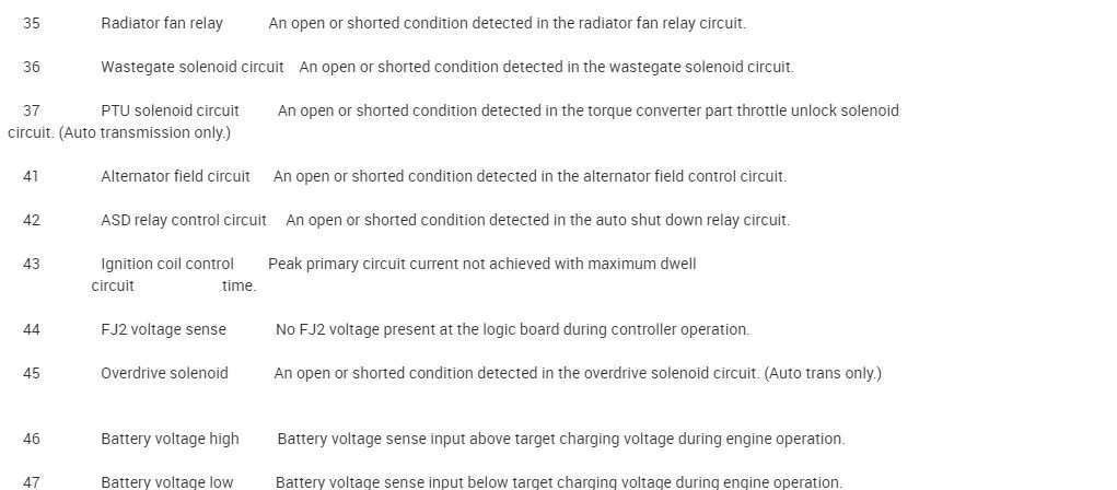

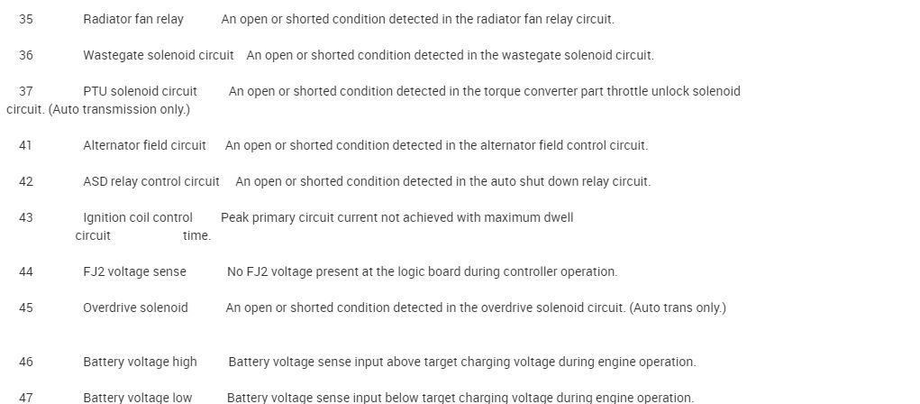

Got it running. Drove about thirty miles the had to pull over on side of highway. Now the motor is not turning just hear the starter cranking. Got code 42.
Thursday, November 8th, 2018 AT 1:21 PM
  • 52,797 POSTS
I attached the code description.
It looks to do with the ASD relay or wiring.
