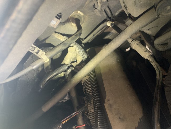

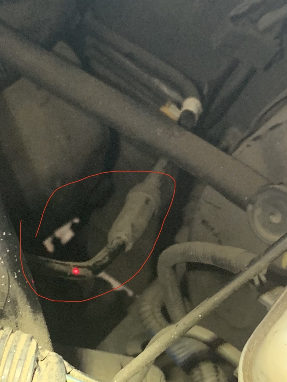

I circled where those 4-550 temperatures were coming from. Temperatures all around and below that area was normal. That elbow further up the circled area in the picture is where it looked like the smoke was coming from
Monday, July 27th, 2020 AT 10:47 PM
4DRTOM
  • 467 POSTS
Hmm, very interesting. Can you see where it's coming from and going to?

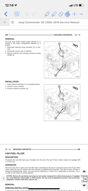

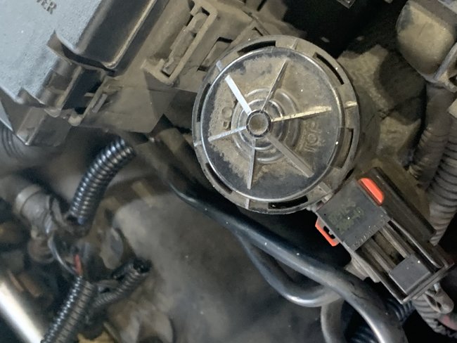

It comes from this part here in the pic. I think this is the vapor canister purge solenoid from what I was able to see online. I apologize if I’m wrong. It located in this Jeep up front by the battery and there’s a couple of tubes running from it, including the one getting the high temps. It looks like it runs to the elbow and into the firewall (attached pic) not sure where it goes from there. I checked temperature through the rest of this line from start to finish and those 4-500 temperatures only came from that one section.

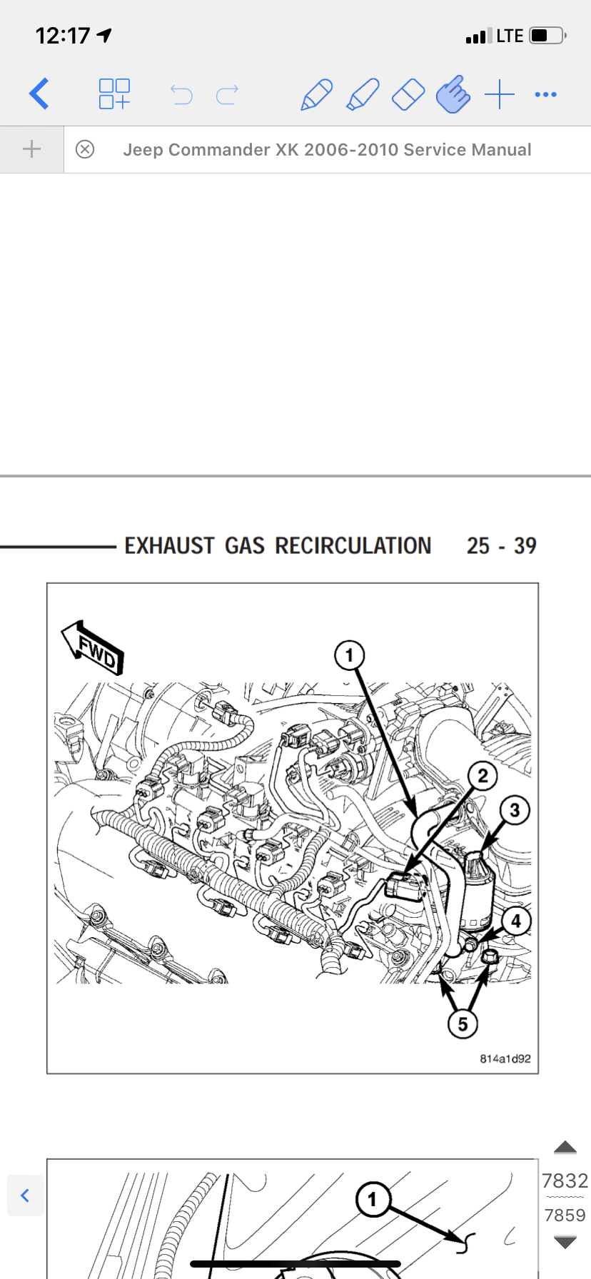

From what I’ve found, the EGR is also on this same side. Supposed to be on the back of the left cylinder head.

Is that the fuse box I see its attached to and the tubes are running by? In the first pic.
Thursday, July 30th, 2020 AT 7:01 PM
NYC2NC82
  • 96 POSTS
Yes. It just slides on and off. And thinking about it, I remember that part just laying on its side and I put it back on there.

Okay, so if its the tube that getting super hot then EGR has failed. Its a mechanical and electrical unit and when it starts to fail the gate sticks either open or closed. When this happens the car will start to through the codes that your seeing and run rough. That's the part in the picture. I think that's going to take care of the problem.

Everything I’m pulling up, that’s the purge valve pictured not the EGR. The EGR is supposed to be on the rear of the left cylinder head.

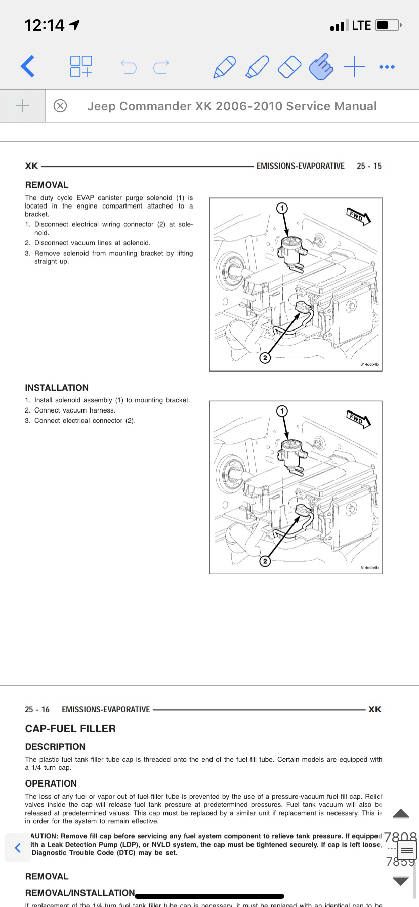

EVAP canister purge solenoid is what I’m finding for that part.

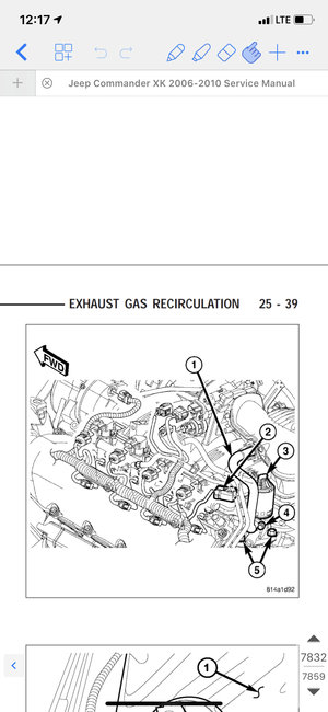

And this is what I’m finding as far as where the EGR is. It is in the general vicinity where smoke was coming from, just not sure if it was from there or not.

You are correct the picture is showing a purge valve and when it goes bad it throws a code for it most of the time. It's not the codes you are getting and its symptoms are not what you have, It's recirculating fuel vapor from the tank to the intake to burn off the fumes, it's an emission control component. The EGR failing has all the issues you are having both the running aspect and the code aspect. It sticking can explain the slight smoke you are getting as well. The EGR can be bad and not send a code for it too. Something is very odd having the tube from the purge valve being so hot and it has fuel vapor and plastic? The EGR is a recirculating operation which might be creating the other part to heat up. I suggest doing the EGR.

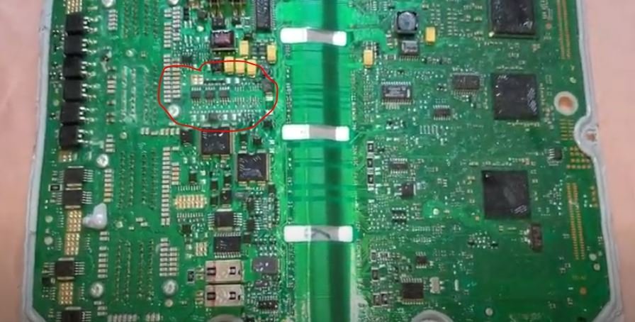

As far as the EGR it’s located on the back of the left cylinder head and it’s very possible the smoke was coming from there since it’s that general area. Also as far as the wiring harness goes, it runs from the PCM on the passenger side to over the top on the cylinder heads.
Sunday, August 2nd, 2020 AT 4:09 PM
4DRTOM
  • 467 POSTS
Good morning,

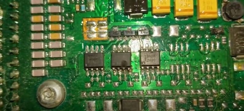

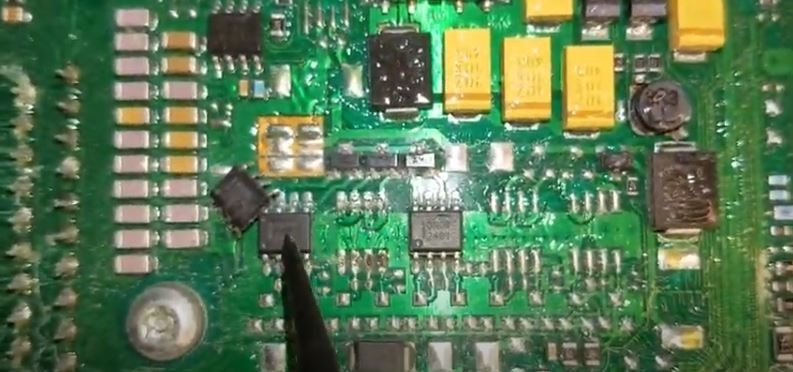

With such random changes, inconsistencies with the codes with the parts that are now new. Besides the heat the ECU is the other commonality. A good visual inspection of the ecu's circuit board is in order. I'm uploading the jeep ECU showing the injector IC on the board notice the circled chip which is an example of a burnt chip. The 3 chips circled are the ones that run the injectors each chip runs two injectors. A cheap junkyard ECU may be in order.
