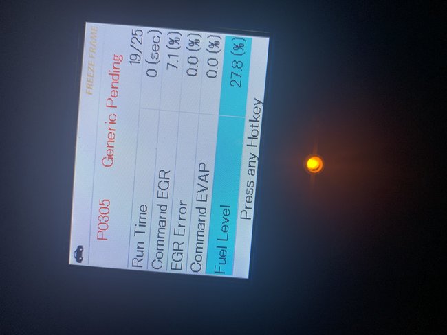

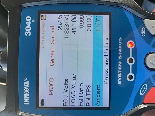

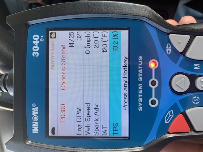

It only popped up once and never popped up again. The most constant codes I’m getting is 300 and 305. Would one injector cause a misfire in another cylinder or a random cylinder?
Jul 10, 2020 at 1:53 AM
NYC2NC82
  • 96 POSTS
Also from what I understand, a 305 is not cylinder 5 but the 5th in the firing order. Is that correct? If so from everything I’ve found the firing order is 18436572.
7 and 5 are next to each other on the same bank and firing order but it would be cylinder 6 that’s actually 5th in firing and setting the 305 on the opposite bank.
So if that’s correct and sorry if I’m confused, I’m getting codes on random cylinders and on both banks. I’m open to just getting new injectors, there’s a lot of miles on the truck and not sure if they have ever been done before.

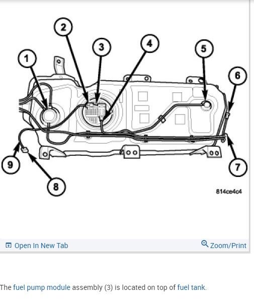

Okay, if the pump is new then the gate is fine. This would point to the pressure regulator which is attached to the fuel rail and is run by vacuum. Give me a minute and ill get a diagram of it.
Tom
Jul 10, 2020 at 2:39 AM

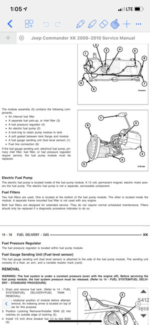

NYC2NC82
  • 96 POSTS
The diagrams I have say the regulator is inside the Fuel Pump assembly itself. Would there be 2 on a Commander?
Jul 10, 2020 at 2:42 AM
4DRTOM
  • 467 POSTS
There usually is one on the rail. I'll verify that here in a minute. Is this a flex fuel ride?
Jul 10, 2020 at 2:44 AM
NYC2NC82
  • 96 POSTS
Yes, it’s Flex Fuel.
4DRTOM
  • 467 POSTS
Okay, so there is a fuel pump module located on the top of the fuel tank not part of the pump. The module controls the pressure. It's number 3 on this diagram.
Jul 10, 2020 at 2:53 AM
4DRTOM
  • 467 POSTS

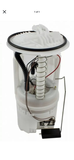

I think we should do a leak down test again now that the pump has been replaced. Did you get the pump alone or the whole assembly? I'm leaning towards the module if it wasn't part of the new pump.
Jul 10, 2020 at 3:00 AM
NYC2NC82
  • 96 POSTS
I replaced the entire assembly. I’ll see if I can post the part.
Jul 10, 2020 at 3:01 AM
NYC2NC82
  • 96 POSTS
That’s a picture of the part. Looks like everything is together in one unit. Filters, pump, regulator and fuel level.
Jul 10, 2020 at 3:07 AM
4DRTOM
  • 467 POSTS
Okay, looks like that's handled. Didn't you say you occasionally smell fuel?

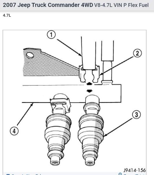

4DRTOM
  • 467 POSTS
Here is a pic of the injector.
1. Remove fuel rail.
2. Disconnect clip(s) that retain fuel injector(s) to fuel rail (2).
Jul 10, 2020 at 3:18 AM

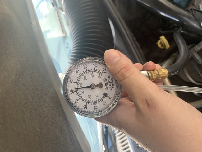

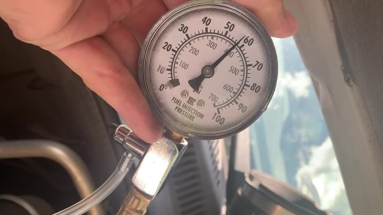

The post where I said the fuel pressure was slowly dropping after I turned the key off was after the new pump was put in. And yes I have smelt fuel. My daughter has smelt fuel while riding before but it has been a while and that was before the pump. I had a buddy of mine that helps me with repairs also mention he’s smelt it as well.
NYC2NC82
  • 96 POSTS
I can hook the gauge back up and double check as well. What are your recommendations so that I know I’m doing it correctly?
Jul 10, 2020 at 3:21 AM
4DRTOM
  • 467 POSTS
Okay, that's serious. This is what I need you to do: Run the car a bit pop the hood get a flash light and inspect the injectors at the rail and see if it looks wet. follow the fuel line to the rail and look there as well. If you are smelling fuel like that we need to find it right away. actually you shouldn't drive the car until that's handled.

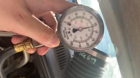

Jul 10, 2020 at 3:55 AM
NYC2NC82
  • 96 POSTS

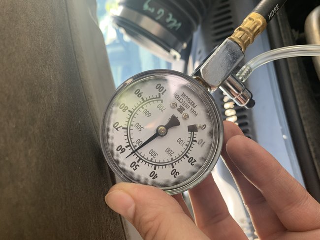

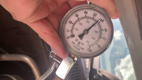

So just hooked up the fuel gauge and everything seemed to hold steady.
NYC2NC82
  • 96 POSTS
Key on engine off.
Jul 10, 2020 at 3:56 AM
NYC2NC82
  • 96 POSTS
Engine started up and idling, needle shook as rpm was dropping but stayed steady.
Jul 10, 2020 at 3:57 AM
NYC2NC82
  • 96 POSTS
After shutting down the engine. And it’s still holding the same pressure a few minutes later.
Jul 10, 2020 at 3:58 AM
NYC2NC82
  • 96 POSTS
I have seen video online of and injector failing after it gets hot. Think maybe situation happening here? Seems to always start or get progressively worse with heat.
Jul 10, 2020 at 3:59 AM

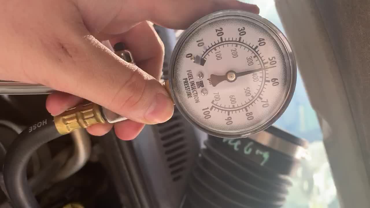

NYC2NC82
  • 96 POSTS
Just restarted and the fuel pressure went back to right at 58. Although this time when I turned off the fuel pressure is higher than the first time. And holding there now.
It did smell a little rich to me when it was running. Not like raw fuel but definitely can smell something.
Jul 10, 2020 at 4:03 AM

The pressure from being off should go no lower that 35psi.
Jul 10, 2020 at 4:52 AM
NYC2NC82
  • 96 POSTS
The pressure held perfect this time. Is the receipt paper getting sucked into the exhaust a valve issue?
Jul 10, 2020 at 4:54 AM
4DRTOM
  • 467 POSTS
And water coming out the tail pipe is good when you have a good burn it creates water. that is why exhaust systems rust from the inside out. I going with the injectors. I think one or more of them does not have a good spray pattern.
