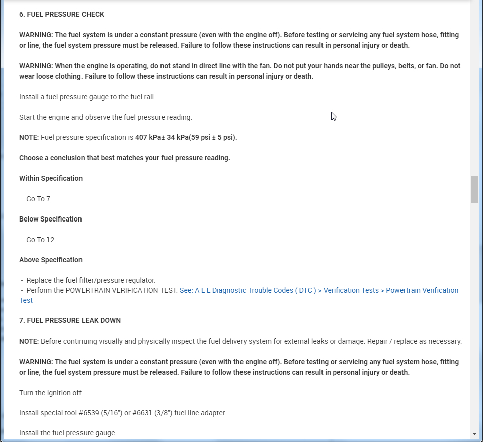

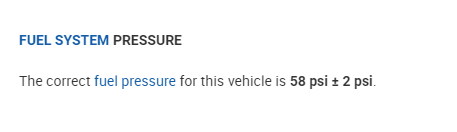

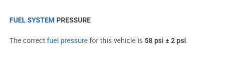

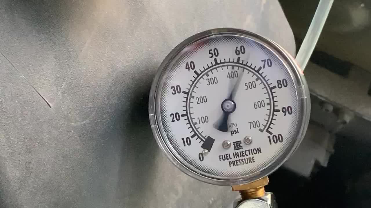

I have some ideas on what this could be but we need to address the fuel pressure first. At key on with 55 PSI is just about perfect. However, when you start the vehicle and it jumps 100 PSI does not sound possible. This pump is a low pressure pump so we have to be missing something.
Are you testing this with a gauge or looking at a scan tool? Here is a guide on how we need to do this with a gauge:

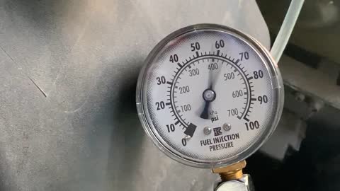

If you are using a gauge can we get a video of the gauge when this happens? Next we may need to try another gauge because it may be the issue.

I am so sorry, that was a typo. It is jumping between 55-65.
Jun 26, 2020 at 4:37 AM
NYC2NC82
  • 96 POSTS
I think I got the video to upload this time.
Jun 26, 2020 at 4:39 AM
Okay. that makes more sense. As for the fluttering, that is not uncommon to flutter a little bit but that seems pretty large.
Let's try monitoring the fuel pressure and rev the engine and see if the gauge stops bouncing when you rev the engine. If it does the fuel pump is failing.
The other possible cause is a leaking injector which would make more sense with the misfire that you are getting.
Lastly, we should monitor live PCM data when the engine is running to see if it is rich. If it is running rich then we can feel better about going after an injector or other fuel issue. This would require a scan tool capable of doing this. Any chance you have one?

I do have one. Been trying to keep and eye on it without crashing, lol. I took a peak at it when it was doing some sputtering at idle the other day. I’ll post the picture.

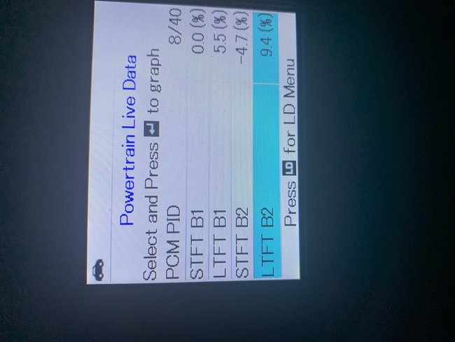

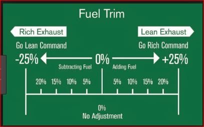

Drove the vehicle today. I’ll post a pic of the fuel trims at startup. While driving I noticed they would go up and down both short term and long term. The long terms would briefly get to mid to upper terms positive then come back down pretty quickly. Seemed to go higher when coming off the gas or braking and also seemed like they were higher when feeling some sputtering.
Jun 29, 2020 at 7:22 AM
That sounds pretty normal. The short term fuel trims should be bouncing up and down around 0 and long term should be more consistent and not bounce as much.
I think the sputtering is related to the pressure bouncing so erratically. Let us know what happens after the pump is replaced. Thanks

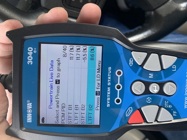

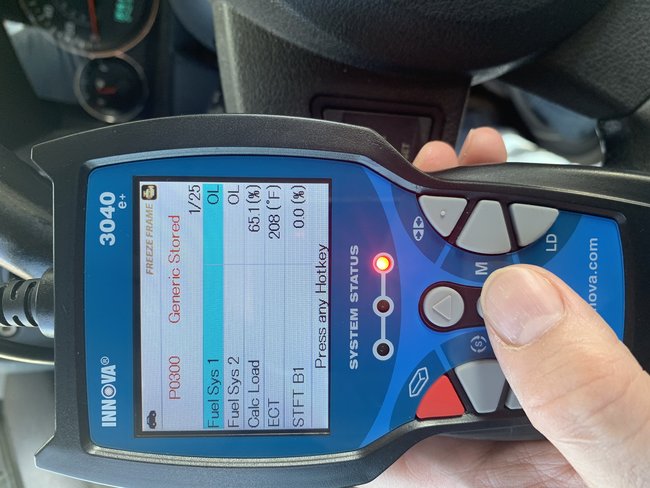

I plugged my scanner in to look at fuel trims at idle. I’ll post the pics but my long terms were +13.3 and +9.4 and stayed at those numbers pretty much the whole time. I would give it gas and they would move a little and immediately go back to those numbers.
I also went in the test part of the scanner to see misfire counts and went in the O2 heater monitor test. This is after it was idling for a bit. B1S1 was at 77 F which was outside temp. B1S2 was 95F. B2S1 was 113F and B2S2 was 59F. Not sure if that’s even important but found it strange the temps would be so different. The live data always shows both my Cat converters at the same temperature.

The short term at that time were -7.0 on B1 and -5.5 on B2. They would fluctuate as I gave gas in idle and the long term numbers would drop as well but immediately go back to the same numbers as before when letting off the gas. I do not believe my scanner has the ability to reset adaptive numerator. Not sure what it is honestly. How can that be done?
Jul 5, 2020 at 1:18 AM
The adaptive numerator is the long and short fuel trims. It is how it is calculated and resetting it, will basically wipe its memory. This adaptive so it will adjust the fuel trims over time but it is not immediate.
I believe you have what is called a GPEC controller on that vehicle which means this process may work to reset it.
Disconnect the battery positive terminal and touch the positive terminal to the negative battery post. This is called a capacitive discharge. Basically that means it depletes the keep alive memory the PCM so that it forgets all its learned data like the adaptives.
If this doesn't work then it is okay. Just drive the vehicle and it will bring those numbers closer to 0.
As for short term fuel trims, that makes sense that they are slightly negative and that is because the long term are positive. It is basically trying to bring those down.
Long story short, I think you fixed it and it will run better as those numbers are relearned.

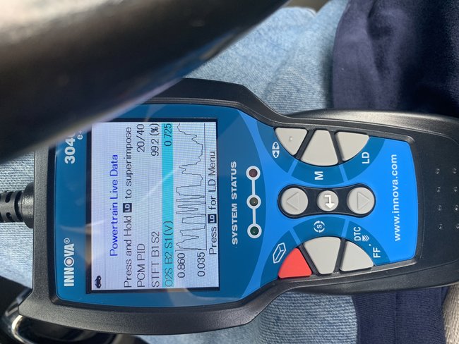

Okay, so drove it around today. Really hot day so running A/C. At first no issues at all start and stopped about 3 times. Soon as I got it on the highway you can feel a few stumbles. After about 10 miles and getting back into stop and go and then parking and keeping it running I am getting the sputtering again. Not as bad as before and seems to kind of go away when I turn off the A/C. Ran the scanner and have pending p0305 and p0300 again. Not sure where to go next.
Just got back, had quite a few big stumbles and had my scanner running, the short term trims on both banks would jump up to +20’s and +30’s while it’s happening. They are also jumping up almost as high while it’s sputtering in idle. I did notice the long term was moving up and down like a short term trims while giving it gas or driving. Thought the long terms are supposed to be slow moving. CEL is back on for p0300.

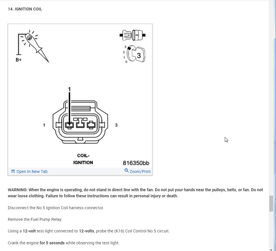

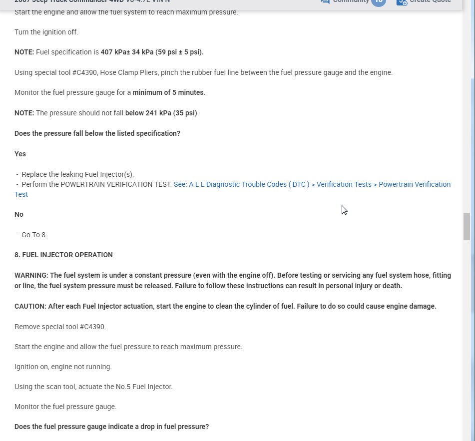

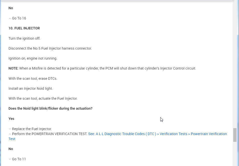

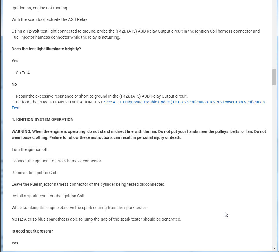

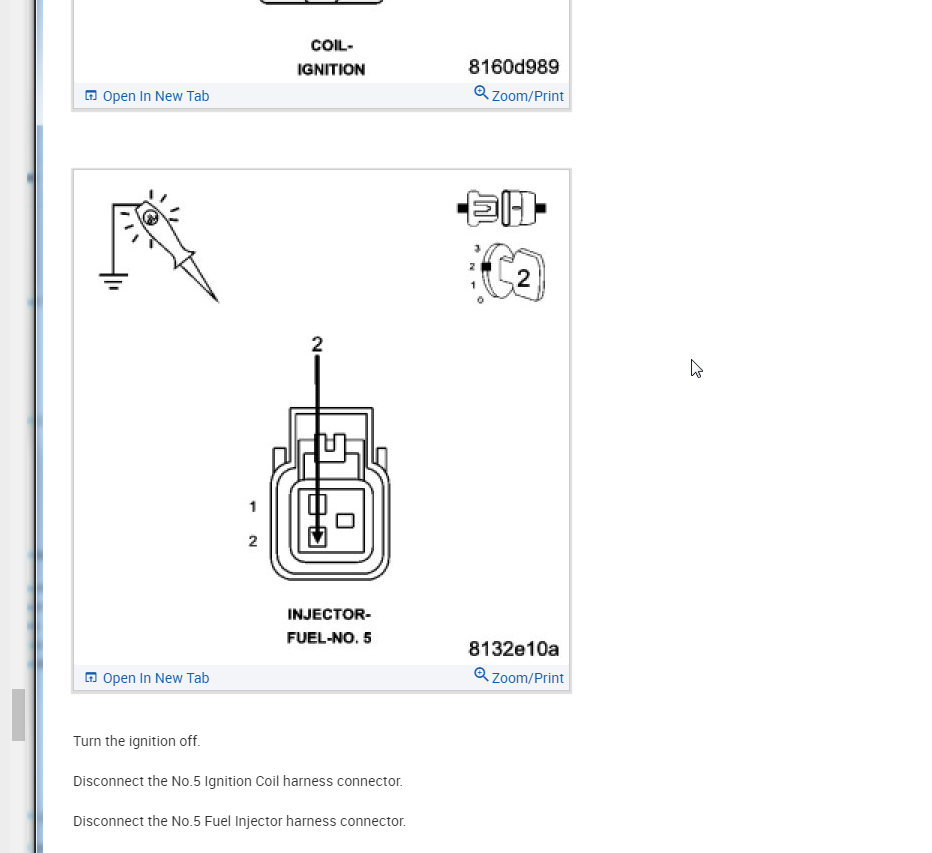

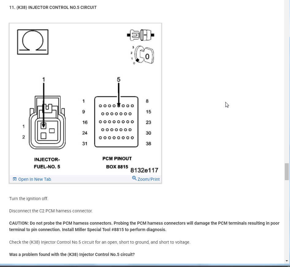

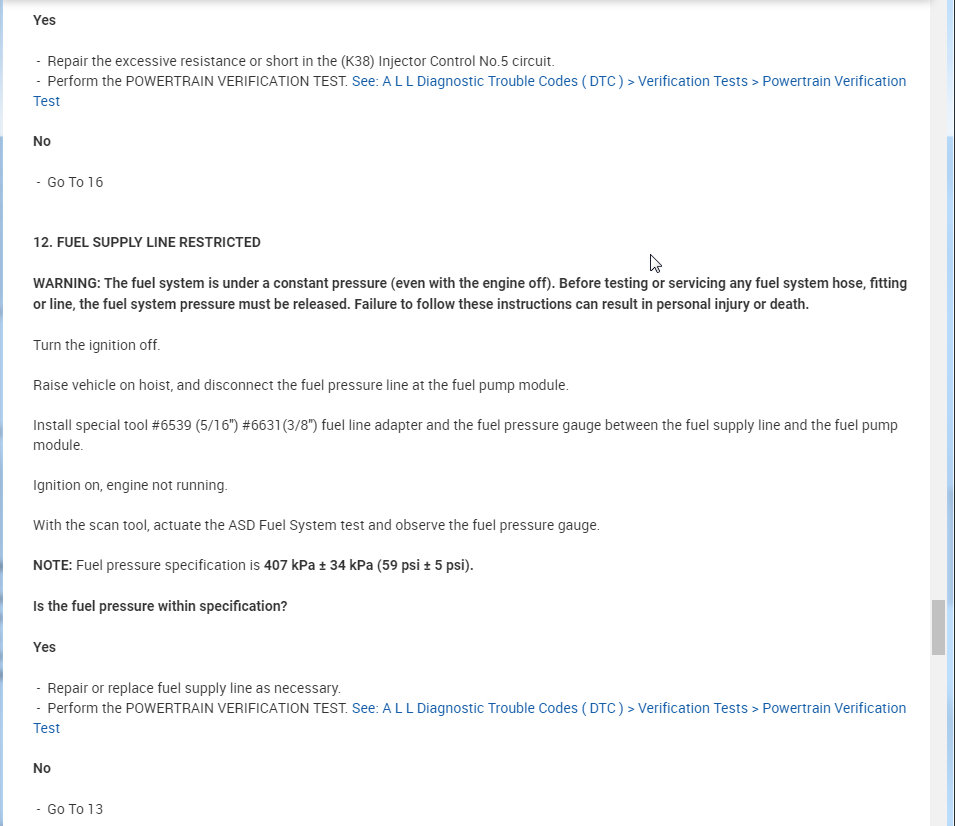

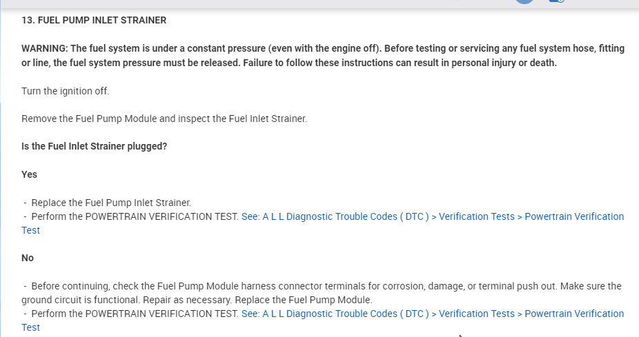

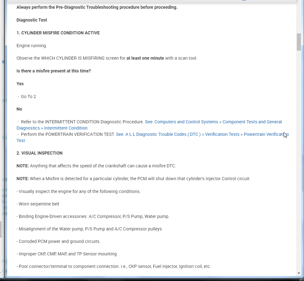

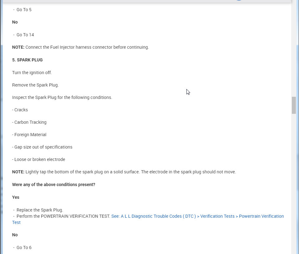

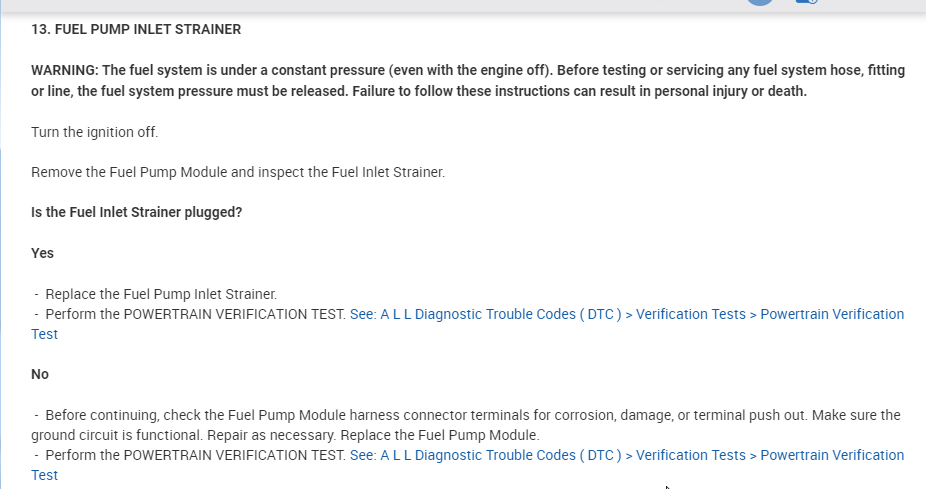

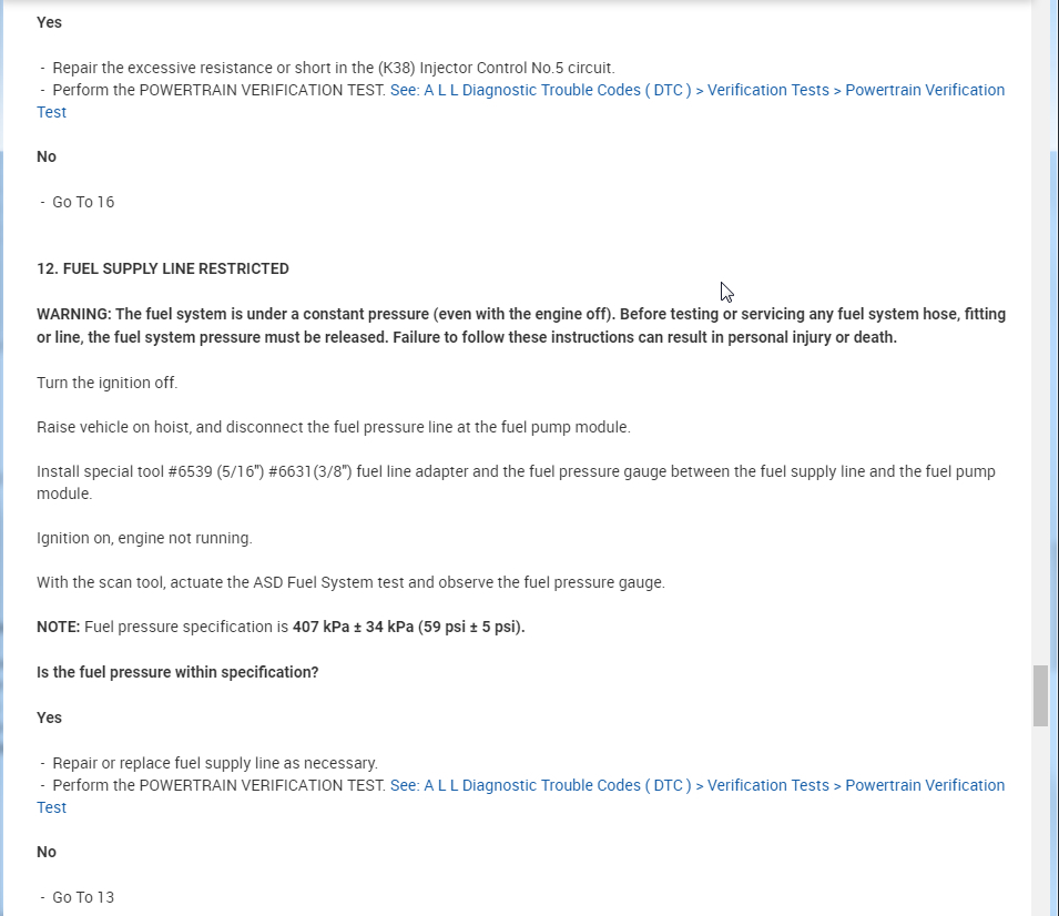

Jul 6, 2020 at 7:40 AM

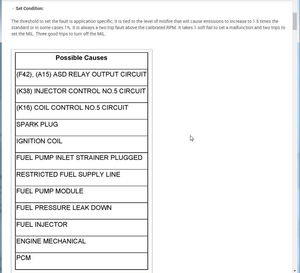

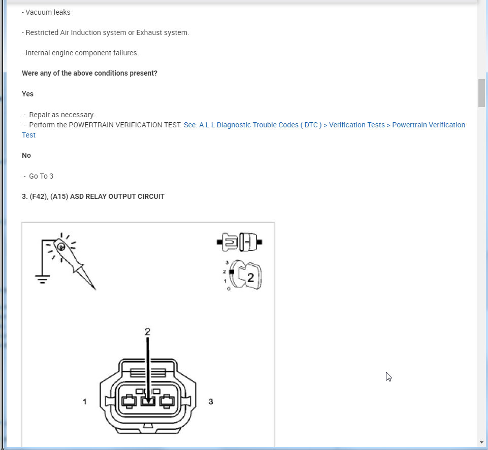

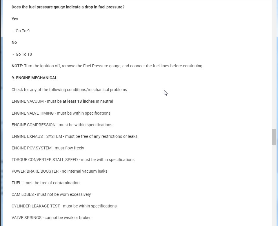

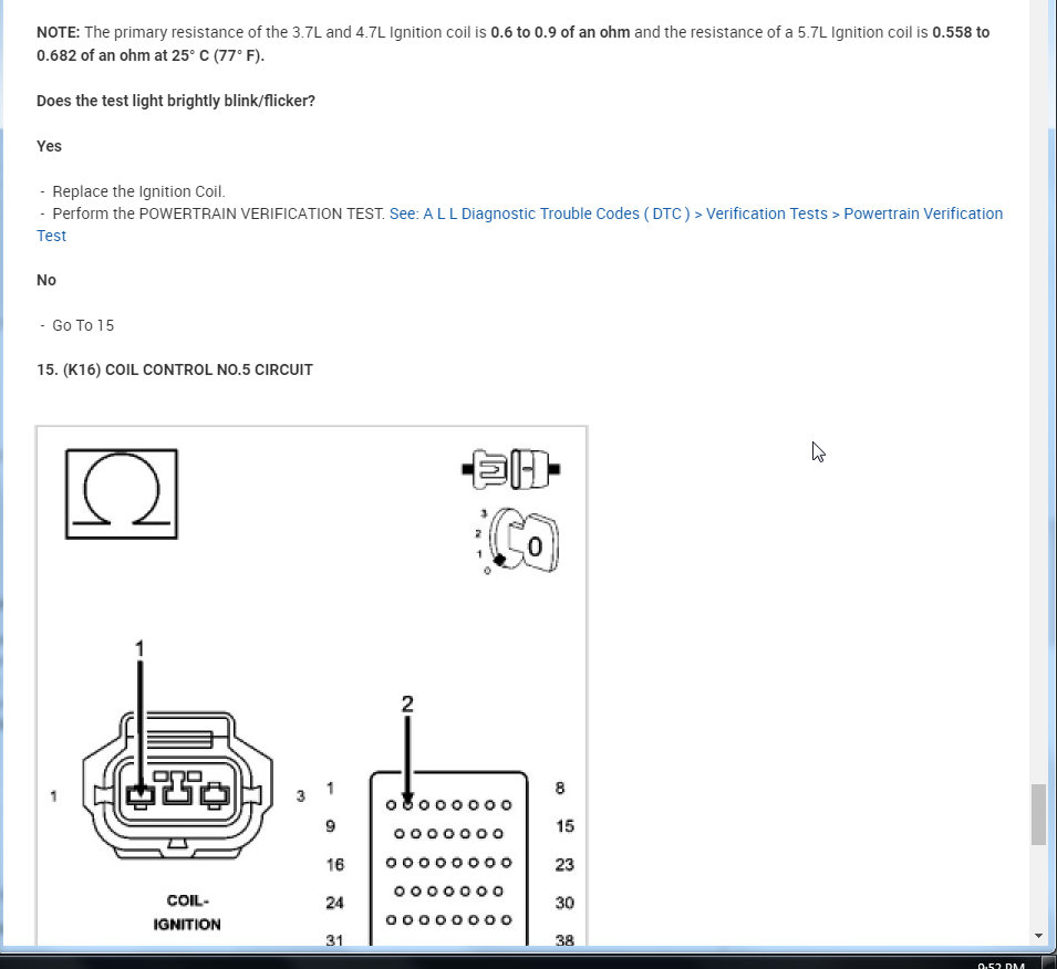

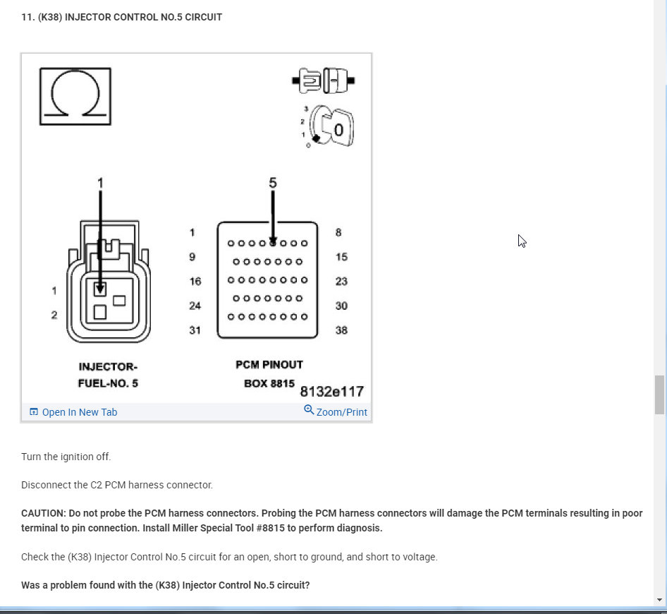

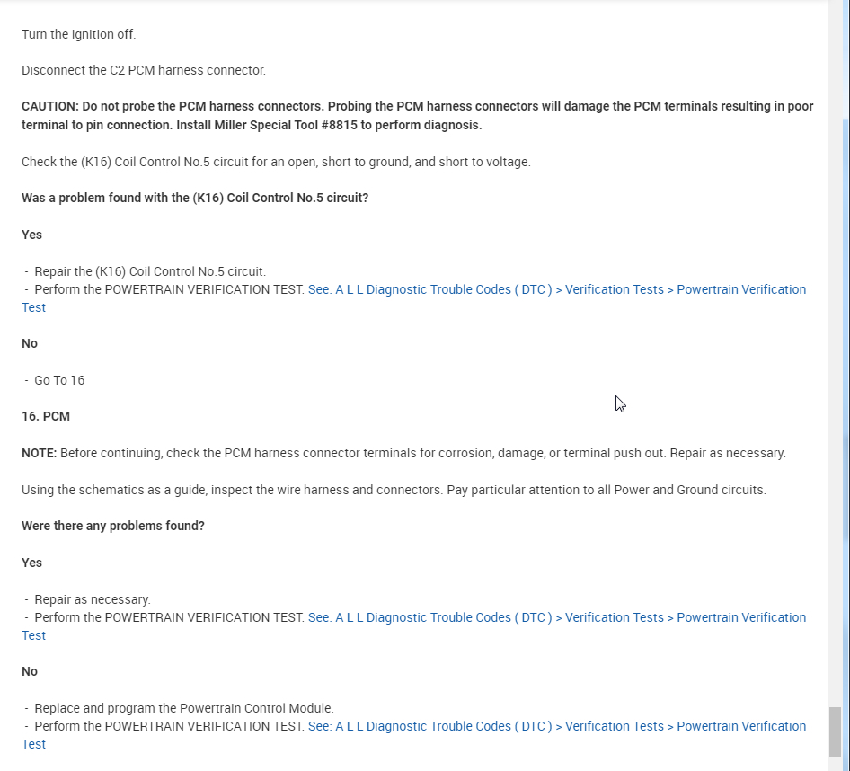

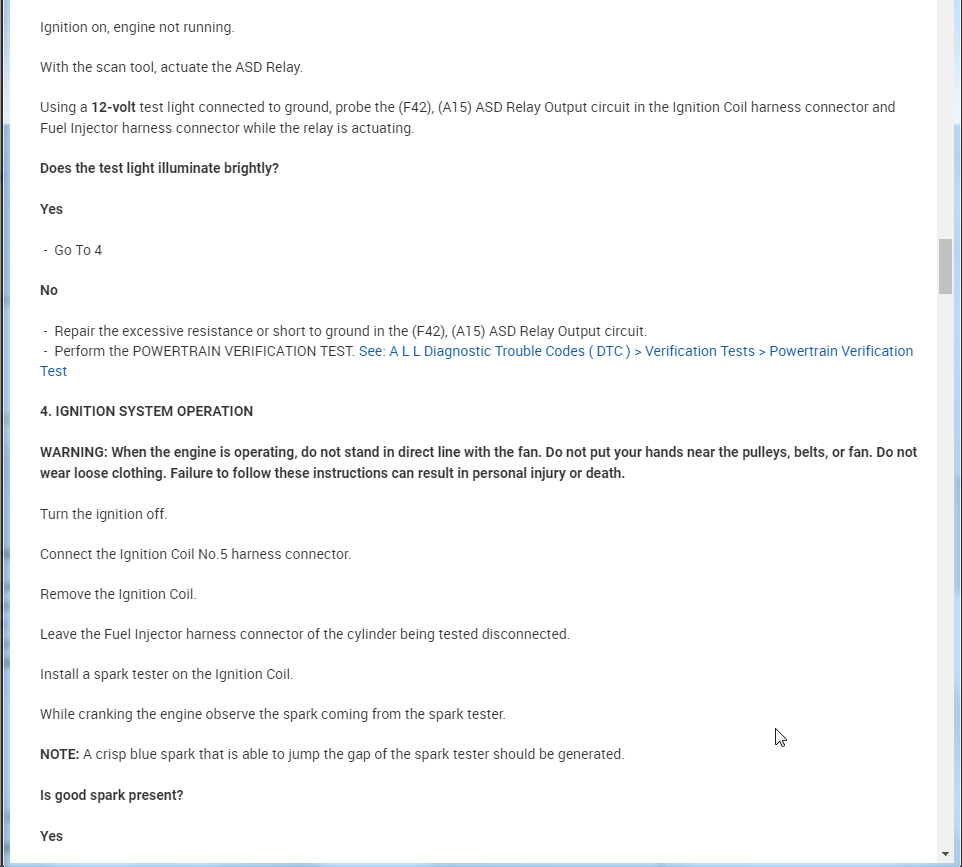

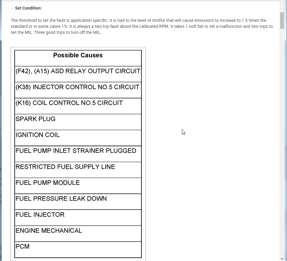

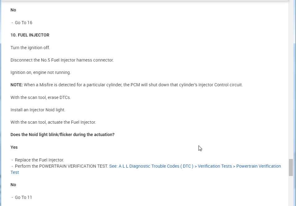

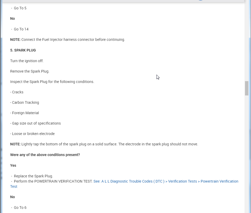

Okay. We need to run through this complete testing for number 5 misfire. We need to suspect an issue with the base engine. Number 9 of this testing is where we need to make sure we cross all these off the list. I suspect a vacuum issue so if you have a vacuum gauge, we need to make sure the needle stays steady. Due to the fuel gauge jumping, we may have a valve spring issue which will show up on a vacuum gauge as well if it is the intake valve.
Take a look at this testing and let me know what you find. However, we are looking for something causing that cylinder to go lean so that is increased oxygen or decreased fuel. Valve spring not sealing would make sense.
We may just want to run a compression check on number 5 and compare it with a couple other cylinders.

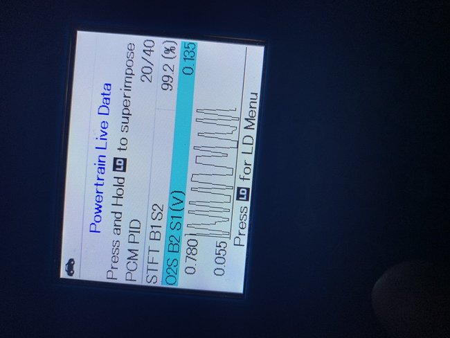

Also today I drove it. Cleared the codes, it rode good first trip not much issue I noticed. Did have a pending 305 Afterwards though. When I drove it back it was pretty much perfect, no issues. Was keeping an eye on the o2 sensors the whole time. After I got back home (25 miles or so) I let it idle as I kept looking at the data and the o2 graphs. It started sputtering finally and it actually stalled once as well. It fired right back up no issue. I will post some pictures of the sensor graphs as well.
Also I did a fuel pressure test with the new pump. At key on it was actually at 52-53 and at idle the needle was jumping upper 50’ and 60. I did notice the fuel pressure would start dropping as soon as I turned it off. Even from key on to off it would start to drop almost immediately. Not too fast but noticeable.
Jul 7, 2020 at 12:21 PM
NYC2NC82

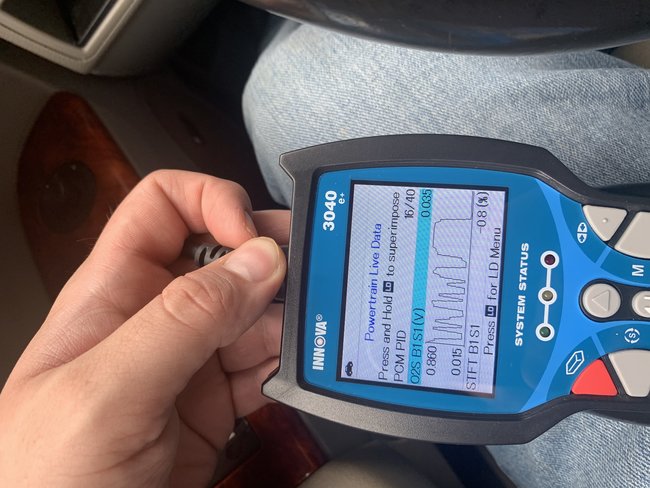

  • 96 POSTS

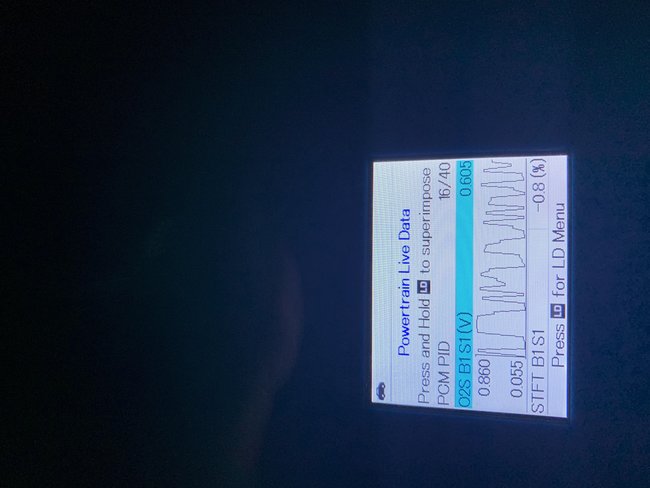

These are what the sensors looked like when it started sputtering after getting back.

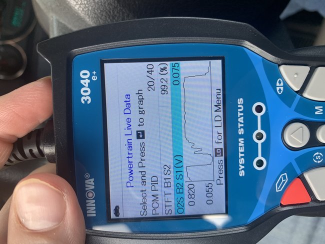

Jul 7, 2020 at 12:31 PM
NYC2NC82
  • 96 POSTS
This is what one looked like after first trip earlier in the day (idling).

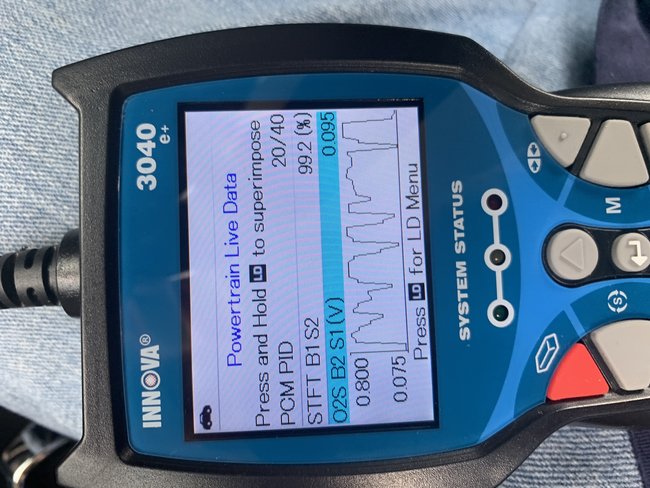

Jul 7, 2020 at 12:32 PM
NYC2NC82
  • 96 POSTS
Here’s what they looked like right after starting in the evening. Cold start.

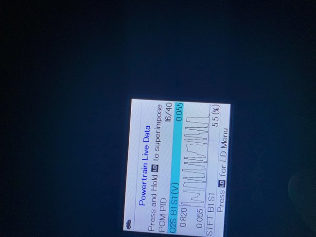

Jul 7, 2020 at 12:34 PM
NYC2NC82
  • 96 POSTS
And these are some while driving on the highway.

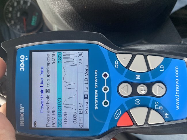

Jul 7, 2020 at 12:37 PM
NYC2NC82
  • 96 POSTS

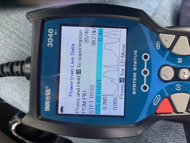

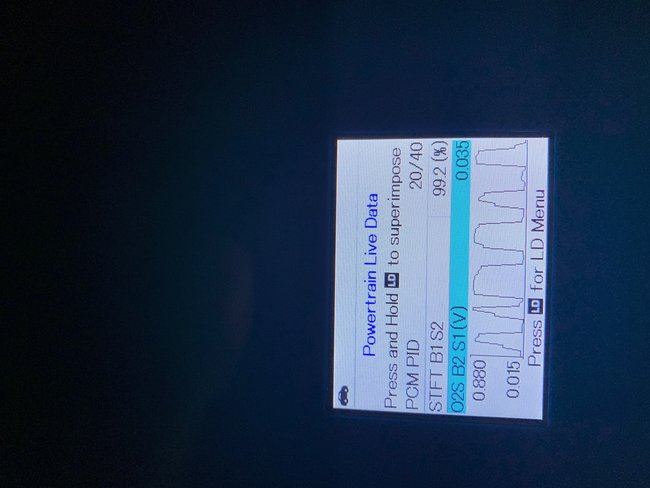

I don’t know if it’s just a coincidence or a reaction to what’s happening but I see the sensors oscillating a lot more rapid at a cold start then after it gets hot.
Trying to get you as much information as possible.
Jul 7, 2020 at 12:39 PM
NYC2NC82
  • 96 POSTS
These are graphs of both upstream o2 sensors while holding 2,000 rpm's.
Jul 8, 2020 at 4:43 AM
Do you have a vacuum gauge? That is good that we have good compression but we need to make sure we don't have a valve sticking while running. The gauge will tell us if the intake is hanging open or sticking. The way to check the exhaust is to actually take a dollar bill and hold it over the exhaust pipe. If it feels like it is being pulled into the pipe then the exhaust valve is sticking on cylinder 5.
Your o2 sensors are reacting to the misfire on 5 so I figure we have a mechanical issue on that cylinder. So we need to eliminate valves and go from there.

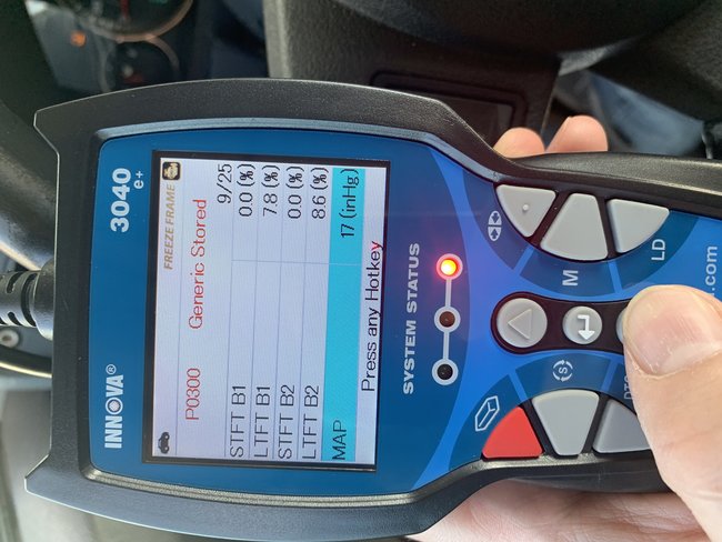

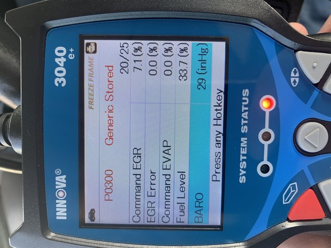

No sir, when I started it was pretty much in closed loop immediately. For example I took picture of the freeze frame data (I’ll post them) while key on engine off today. Cleared the codes then started the engine. I went right into live data and it was already in closed loop. I saw where the 300 code that I deleted was in open loop on the freeze frame and the pending 305 is as well.
Jul 9, 2020 at 1:01 PM
NYC2NC82
  • 96 POSTS

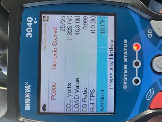

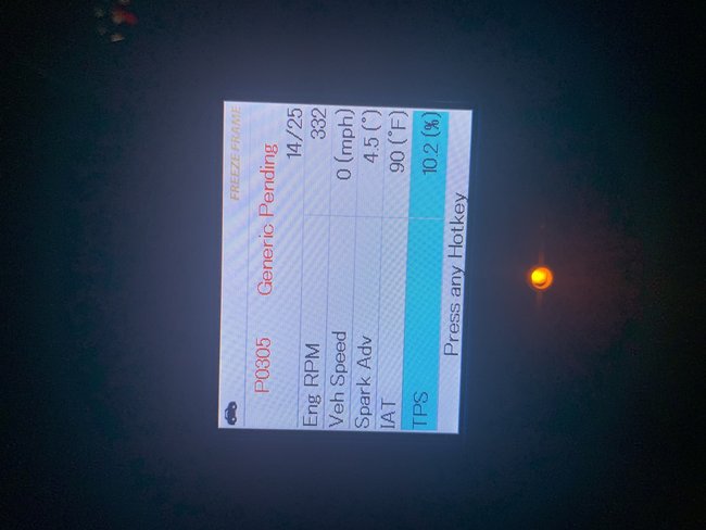

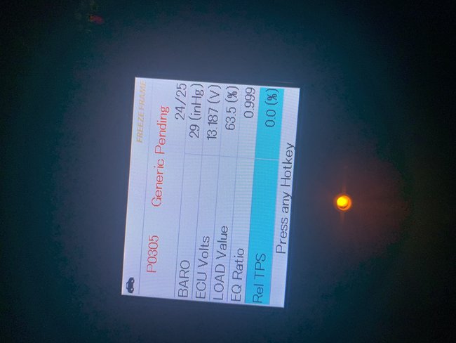

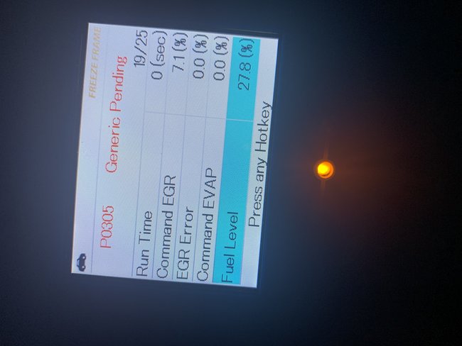

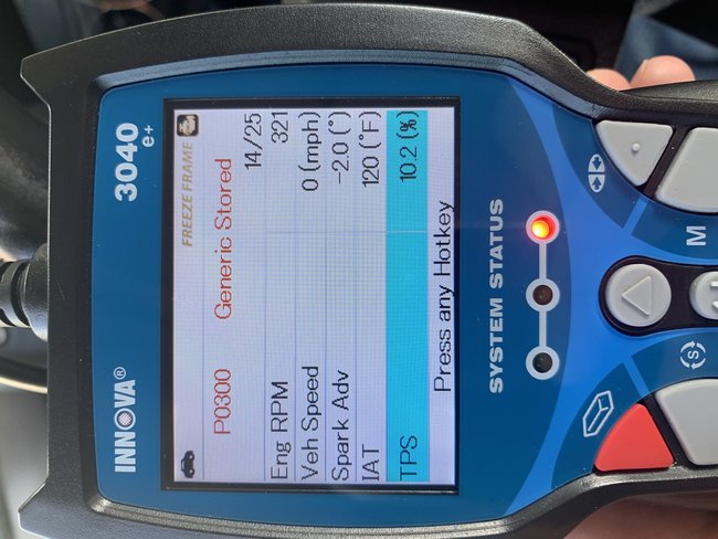

These pictures are all the freeze frame data from the stored 300 code I deleted earlier.
Jul 9, 2020 at 1:05 PM
NYC2NC82
  • 96 POSTS

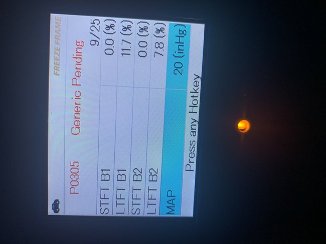

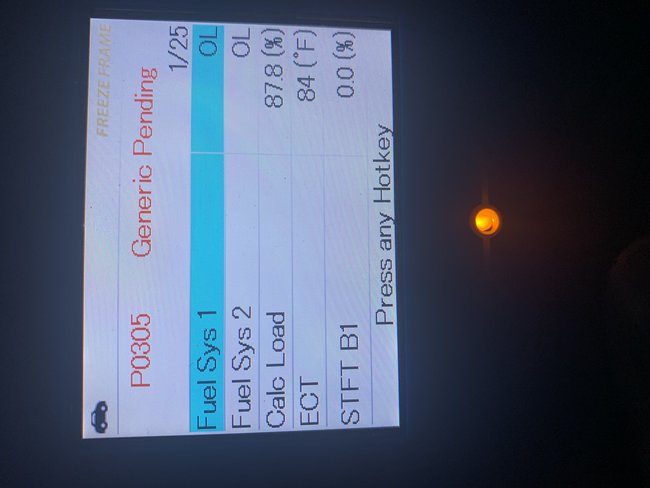

And these are the freeze frames for the pending 305 code. It has not set the light on yet in about 40-50 miles with of driving.
