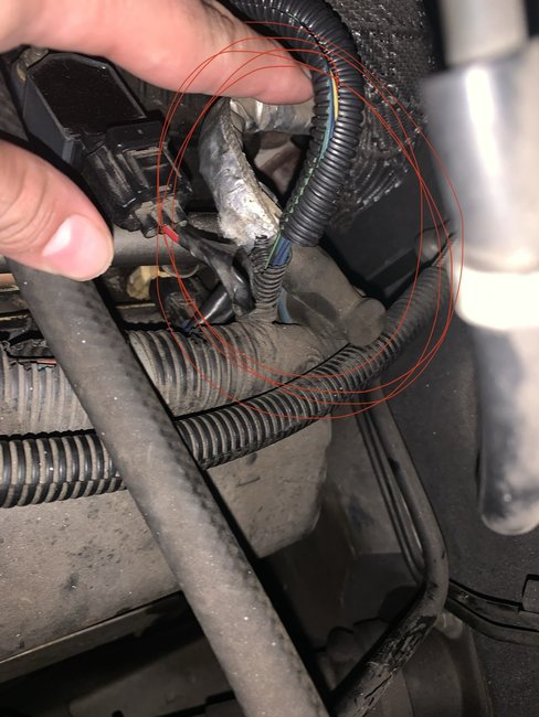

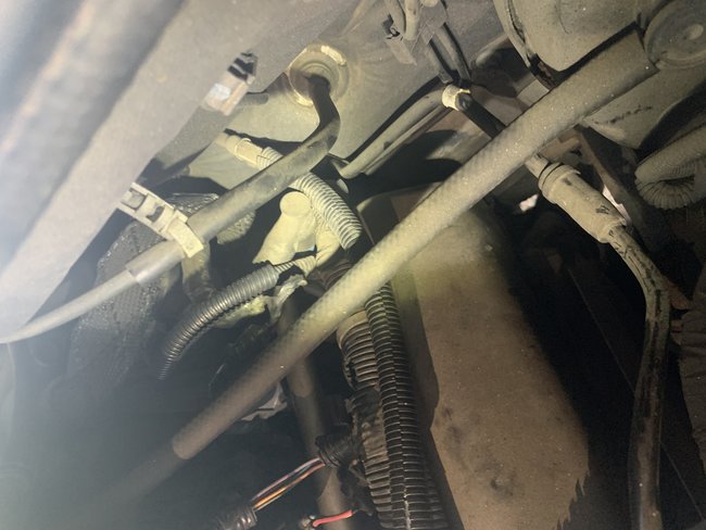

I circled where those 4-550 temperatures were coming from. temperatures all around and below that area was normal. That elbow further up the circled area in the picture is where it looked like the smoke was coming from
Hmm, very interesting. Can you see where it's coming from and going to?

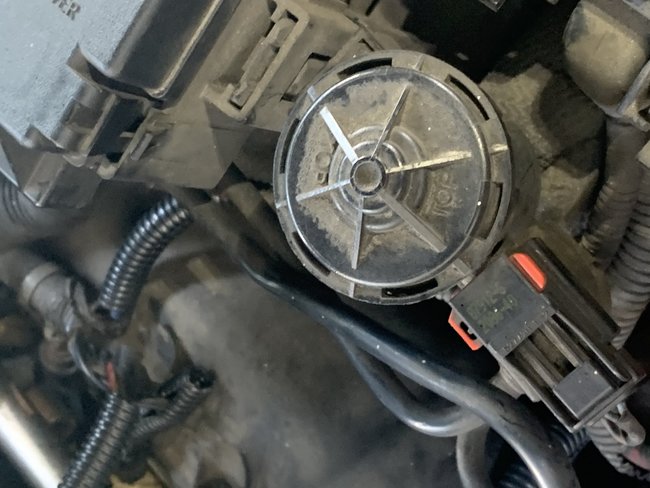

It comes from this part here in the pic. I think this is the vapor canister purge solenoid from what I was able to see online. I apologize if I’m wrong. It located in this Jeep up front by the battery and there’s a couple of tubes running from it, including the one getting the high temps. It looks like it runs to the elbow and into the firewall (attached pic) not sure where it goes from there. I checked temperature through the rest of this line from start to finish and those 4-500 temperatures only came from that one section.

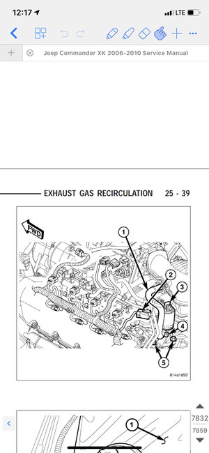

From what I’ve found, the EGR is also on this same side. Supposed to be on the back of the left cylinder head.

Is that the fuse box I see its attached to and the tubes are running by? In the first pic.
Jul 30, 2020 at 12:01 PM
Yes. It just slides on and off. And thinking about it, I remember that part just laying on its side and I put it back on there.
Jul 30, 2020 at 12:08 PM
Okay, so if its the tube that getting super hot then EGR has failed. Its a mechanical and electrical unit and when it starts to fail the gate sticks either open or closed. When this happens the car will start to through the codes that your seeing and run rough. That's the part in the picture. I think that's going to take care of the problem.

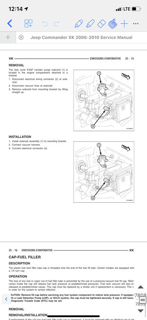

Everything I’m pulling up, that’s the purge valve pictured not the EGR. The EGR is supposed to be on the rear of the left cylinder head.

The unit connected to the hot tube I believe is going to be the issue. I too will double check that part and the one your speaking of at the other location. I may be mistaken on its name. Can you make out the part number on it somewhere?

Good morning,
You are correct the picture is showing a purge valve and when it goes bad it throws a code for it most of the time. It's not the codes you are getting and its symptoms are not what you have, It's recirculating fuel vapor from the tank to the intake to burn off the fumes, it's an emission control component. The EGR failing has all the issues you are having both the running aspect and the code aspect. It sticking can explain the slight smoke you are getting as well. The EGR can be bad and not send a code for it too. Something is very odd having the tube from the purge valve being so hot and it has fuel vapor and plastic? The EGR is a recirculating operation which might be creating the other part to heat up. I suggest doing the EGR.

Yes it would get worse as the temperature increases like you have going on. It's very interesting that a plastic tube would read those numbers and it hasn't melted down.

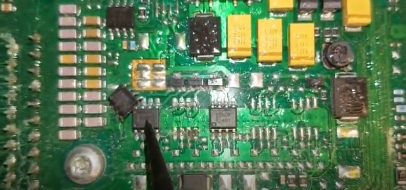

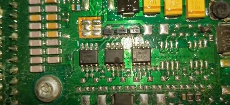

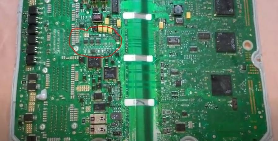

Would that explain the smoke? If I got a PCM from junkyard it would need to be programmed right?
Aug 4, 2020 at 1:16 AM
Well, I'm thinking the smoke is relates to the EGR. there is a distinct odor that would be associated with electronics burning up I think you would have mentioned it and yes a new PCM will need to be flashed by a dealer or a place with the special scan tool. That's why looking at the circuit board should be done and the EGR should be ruled out beforehand. If a chip has burned up you will see it. If this was the case I don't think it would run at all. If a junk yard PCM was installed I believe it would run and the issue would go away verifying that it is the problem then going though that expense would be justified. Then a new one could be flashed returning the proper mileage and so forth.
Tom
Tom
Aug 5, 2020 at 3:43 PM
I have smelt a burning rubber type smell before, but that was before I did the alternator.
Just to clarify, are you saying that if a chip was burnt up that the Jeep wouldn’t run at all?
Aug 6, 2020 at 10:55 AM
Well, depending on which one but pretty much yes. Some integrated circuit fail only when heated or cooled though. You can get whats called freez-it and it will instantly freeze whatever you spray it on to sub zero. If it was in my shop I would take the PCM cover off and shoot the chips with it with the car running if I didn't see any melting evidence. A partially failing chip will completely fail if frozen. If the EGR proves to be working properly or is replaced that is the next thing I would do. Here is a pic of what I'm talking about.

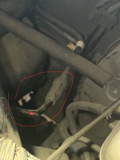

It doesn't look like one if I'm seeing it correctly . If it had an effect then we need to look closer at it though. Does it have any vacuum lines or wires coning from it? If so, how many pins are in the wire connector for it. It looks like part of the evap system to me.
Let me know And I'll try to ID it.Look, for a part number on it.

So from what I’ve pulled up in forums and online that is the crankcase vent to intake manifold tube. That rubber plug at the end is attached to the PCV valve. (It’s not on the oil filler tube on this model) That tube would be a vacuum line right?

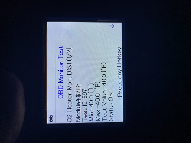

I went ahead and looked at the O2 sensor heater test as soon as I stopped after a good 25 minute drive. All of my sensors up and down stream and both banks showed min and max of -40 degrees and a test value of -40 as well. I pulled up pictures from July 4th where each sensor was a min of -40 and a max of 536 and each sensor had a different temp. B2s1 was at 113 that day and B1S1 was at 77.
Not sure if this means anything at all but thought it would be worth mentioning just in case.

Decided to go ahead and check the same O2 sensor heater test and this time they were showing readings. Min -40 Max 536 with a temp of 113 for b1s1 and 122 for b2s2.
I didn’t have an engine light on but went ahead and ran a scan and I had p0131 pending. O2 circuit low voltage b1s1
Can the sensors be causing all these issues?

Well, if the O2's were messing up the code would be there. What about the PCM have you been able to look at its PCMs circuit board yet?
