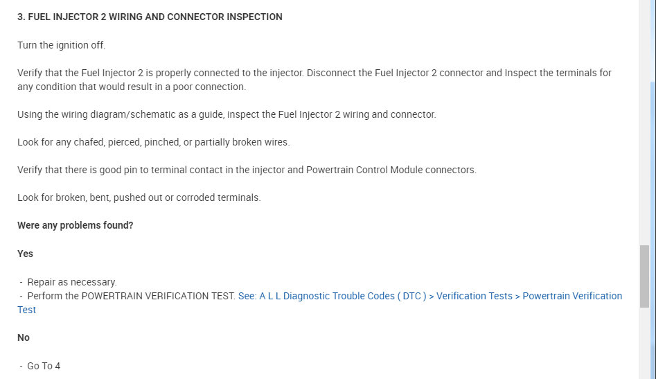

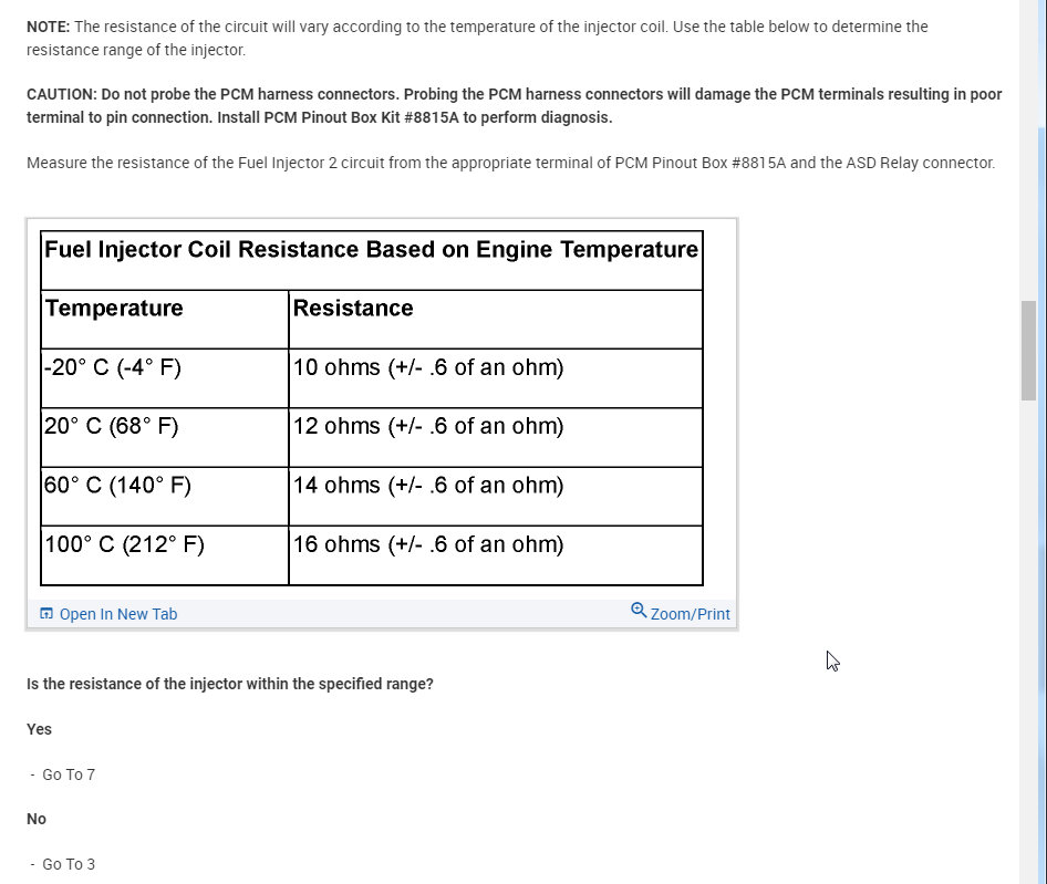

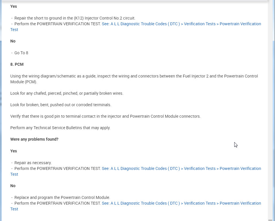

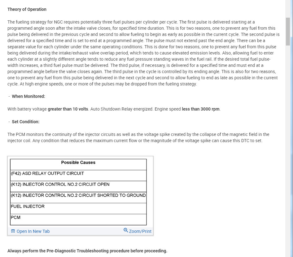

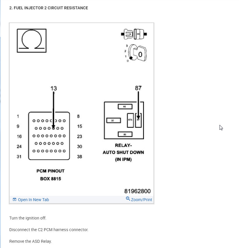

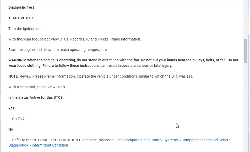

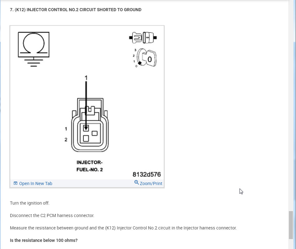

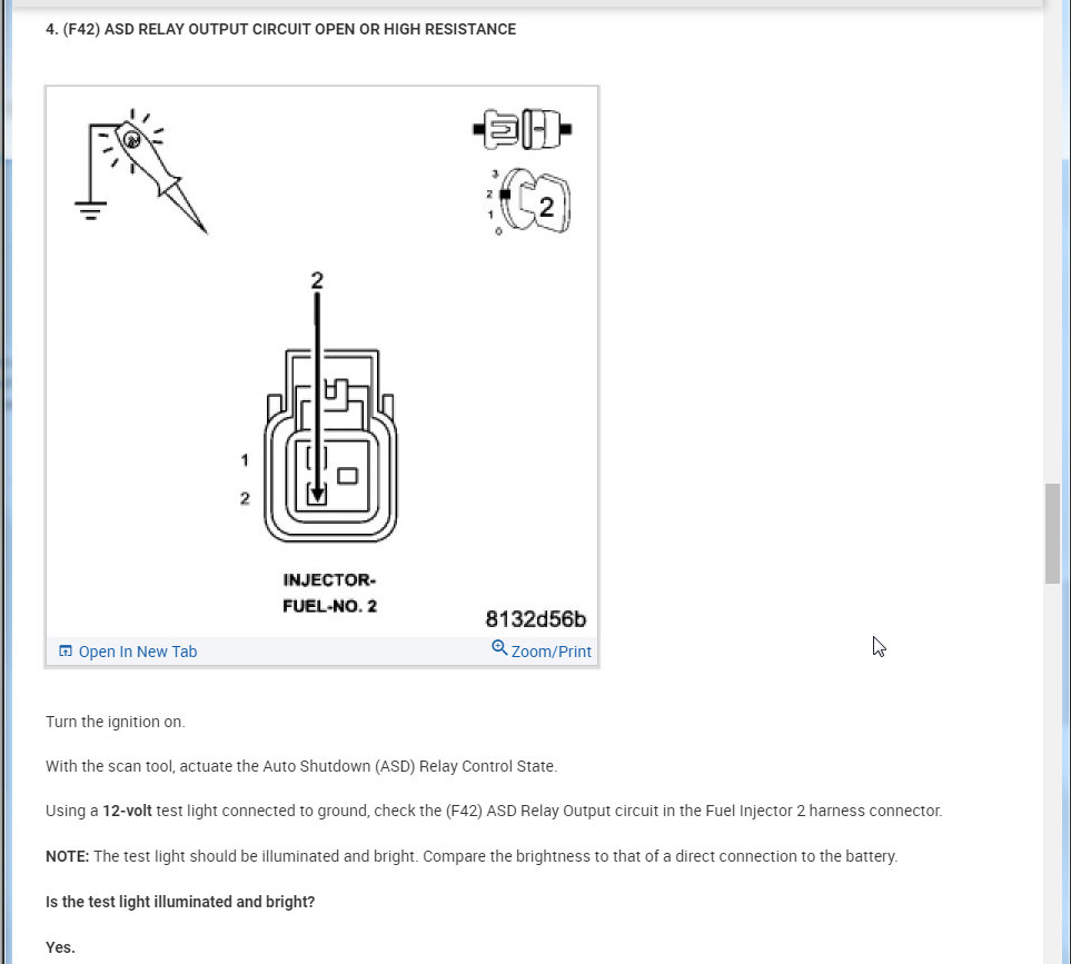

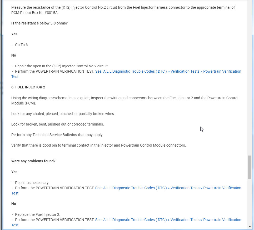

I think we might have a clue. Just had p0202 come back up and p0300 was also triggered with bank 2 open loop-drive on the freeze frame data.
Jul 21, 2020 at 9:05 AM
Well that is a clue. Here is all the info on this code. If this is a pending code then it may just be the injector. However, we need to run through all the wiring tests just to make sure the wiring is good.
Jul 21, 2020 at 11:21 AM
NYC2NC82
  • 96 POSTS

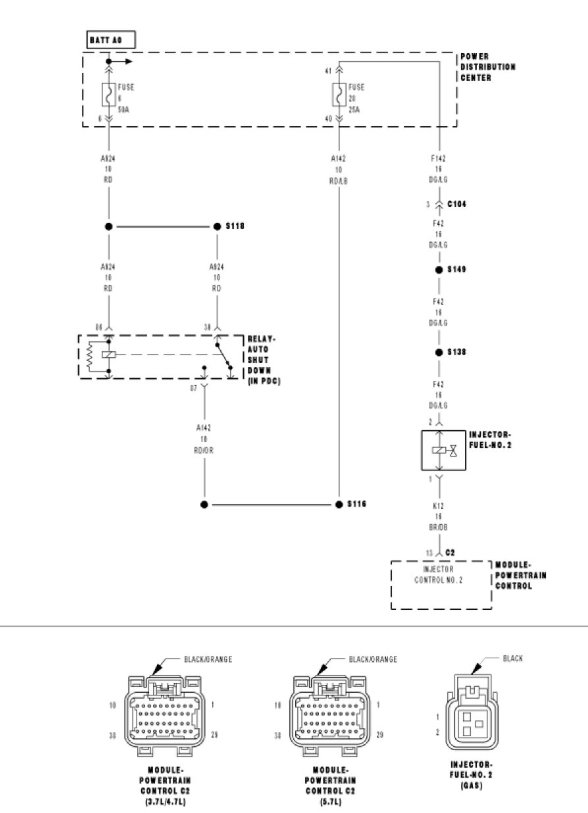

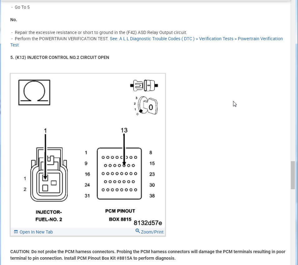

It’s p0204 not 02 sorry. It’s a stored code as well. The p300 is pending. We just replaced all the injectors, not saying it’s not possible it’s still bad but this is actually the third p200 code since the change along with p200 and p205.
Jul 21, 2020 at 11:35 AM
Okay. Clearly if the code for the injector comes back then we have a circuit issue but this matched with the P0300 would make sense if we have some leaking injectors. So replacing all of them was probably a good call.
Jul 22, 2020 at 10:14 AM
NYC2NC82
  • 96 POSTS
Well, all I’m getting is the injector circuit code and p0300 now. Have not had the 305 come back since the change. I start off pretty good, at this point it’s happening when it pretty hot out and after driving for a bit and stopping. I’m guessing I have something shorting when it gets hot but not sure where to start looking.
Jul 22, 2020 at 10:28 AM
Agreed. If the injector circuit code is back then we need to run through that testing and find it but I would not be surprised if the injector harness is the issue as I have seen that a number of times on 4.7L.
Jul 22, 2020 at 11:40 AM
NYC2NC82
  • 96 POSTS

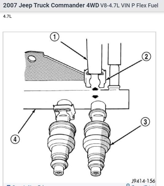

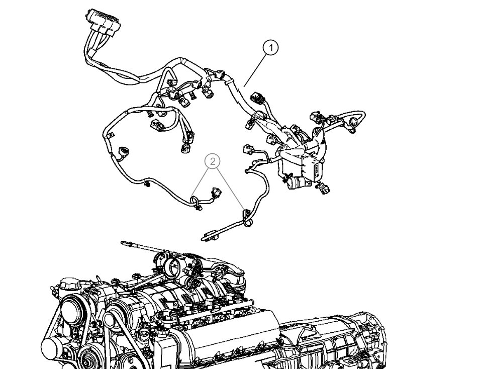

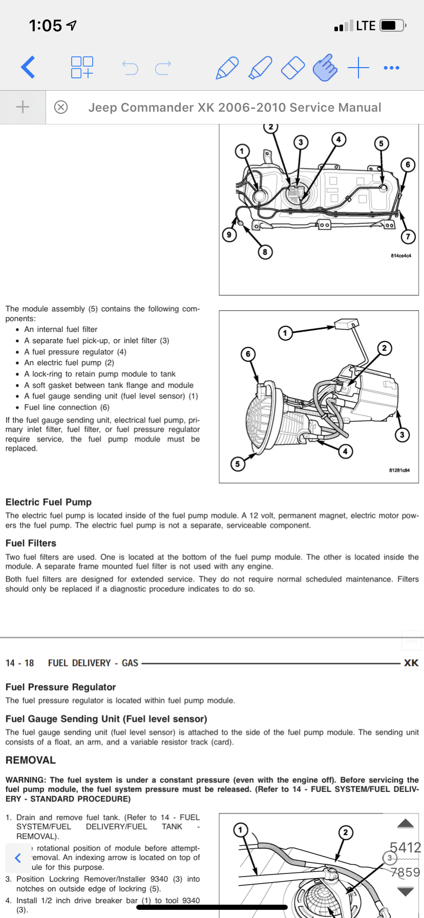

I was thinking about the harness in general since I’ve have the codes on different cylinders. How bad is it to get that done?
Jul 22, 2020 at 11:46 AM
It is not bad. The manuals don't actually list a process for this however I attached the illustration of it. Just follow the harness from the PCM down over the engine to the injectors. Not much has to come off to remove it as it has the wiring cradles that hold it in place.
Jul 22, 2020 at 12:05 PM

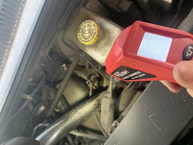

Okay, picked up my infrared thermometer. Didn’t drive a lot but hotter day and got some
sputtering going. Car was sputtering a little when I parked and let it idle and started taking temperatures all over the engine bay. Hottest temperature reading was about 180 and that was the spot in between the alternator and A/C compressor at the top. The injectors and fuel rail were about 150-175 at various points. Pretty much everywhere I could get close and point the beam around the block and manifold it was 150-180 range. Radiator was 95-100 most places I pointed. PCM area got as high as 120. I will say shortly after opening the hood the sputtering stopped and I would guess the temperatures should be higher with the hood shut.
Jul 26, 2020 at 6:19 AM

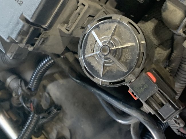

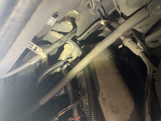

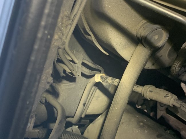

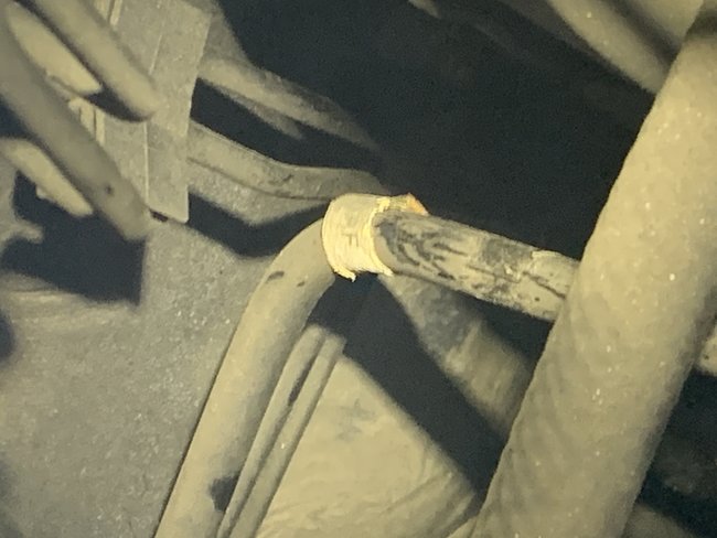

Okay, so I drove for a bit and really let it idle for a good bit while looking under the hood and taking temperatures. Same readings as yesterday for the most part.
I noticed some smoke coming from the driver side close to the firewall. Was hard to tell but looks like it was coming from a hose or wire that connects to what I believe is the purge valve solenoid. I will post pics. Furthermore I took temperatures from the line on one end to the other and it was about 150-160 except for the area that looks like a connector (will post pic as well). The temperature there was reaching up to 400+ degrees. Seemed like it was spiking when I was getting sputters but not 100% sure.
Jul 27, 2020 at 6:51 AM
NYC2NC82
  • 96 POSTS
Right about where that dot is and on that connector is where the temperatures were spiking into the 400's.

NYC2NC82
  • 96 POSTS
This is where it seemed like the smoke was coming from:
Jul 27, 2020 at 6:55 AM
NYC2NC82
  • 96 POSTS
That connects to this:
NYC2NC82
  • 96 POSTS
This was the other spot smoke was possibly coming from, but after a looking for a while it looked like the other spot was most likely.
Jul 27, 2020 at 6:57 AM

Just got back home. Checked that area again and the temperatures were as high as 560 degrees. Only on that section right before that connector area that connector (if that what it is) itself. Seemed like the temperatures would go up and down. It was as low as 170 at some points and jump right back up. Past the connector and before that small section The temperatures were about 150 range. Also getting p0307 now.
Jul 27, 2020 at 12:26 PM
4DRTOM
  • 467 POSTS
Okay, well there is something going on there, 400-500 degrees is pretty hot. Is there any sound like a possible exhaust leak? there might be somewhere in that area an exhaust gas circulating tube that could get that hot, but it would emit enough to make the area hot unless it was leaking. I'm going to see if I can get an image of what I'm talking about. Still though 400-500 degrees is hot. We might be onto something here. From the pic looks like you getting smoke up against the fire wall, Am i seeing that right?
Tom
Jul 27, 2020 at 2:54 PM
NYC2NC82
  • 96 POSTS
Could not tell if there was a sound or not. Yes, the smoke was by the firewall? drivers side. It looked like it was coming from that second pic I posted. Those high temperatures see only coming from a small section of that tube.
Jul 27, 2020 at 3:46 PM
