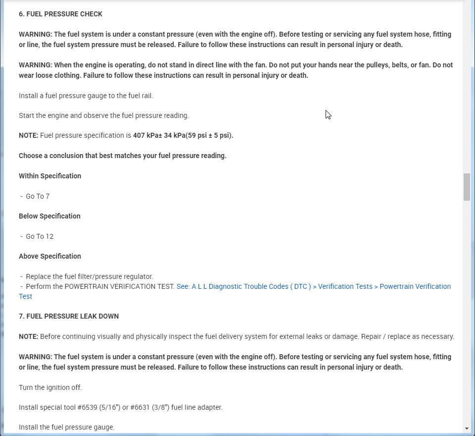

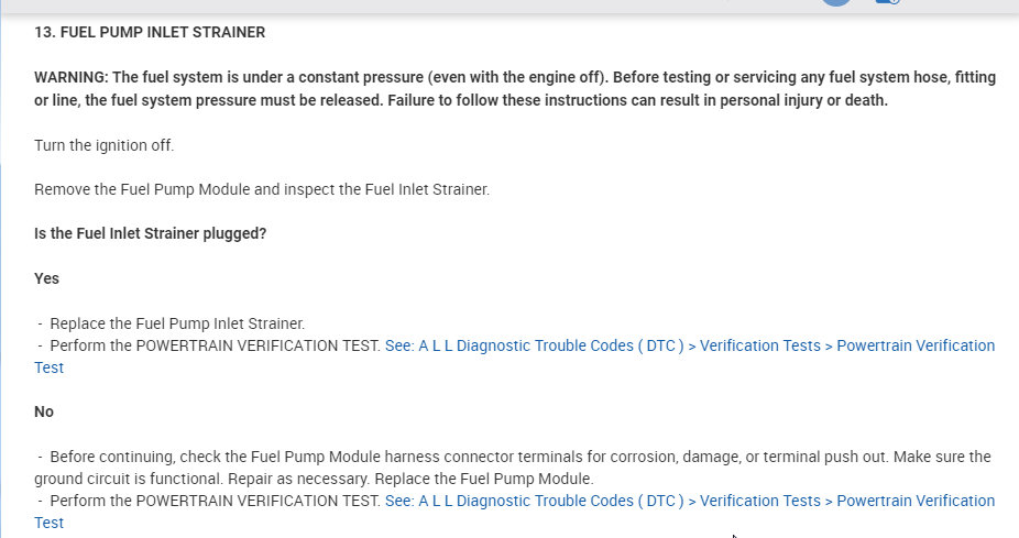

I have some ideas on what this could be but we need to address the fuel pressure first. At key on with 55 PSI is just about perfect. However, when you start the vehicle and it jumps 100 PSI does not sound possible. This pump is a low pressure pump so we have to be missing something.
Are you testing this with a gauge or looking at a scan tool? Here is a guide on how we need to do this with a gauge:
If you are using a gauge can we get a video of the gauge when this happens? Next we may need to try another gauge because it may be the issue.

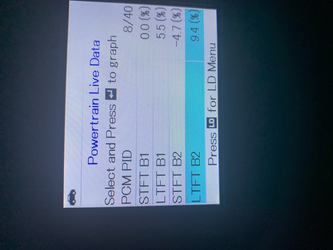

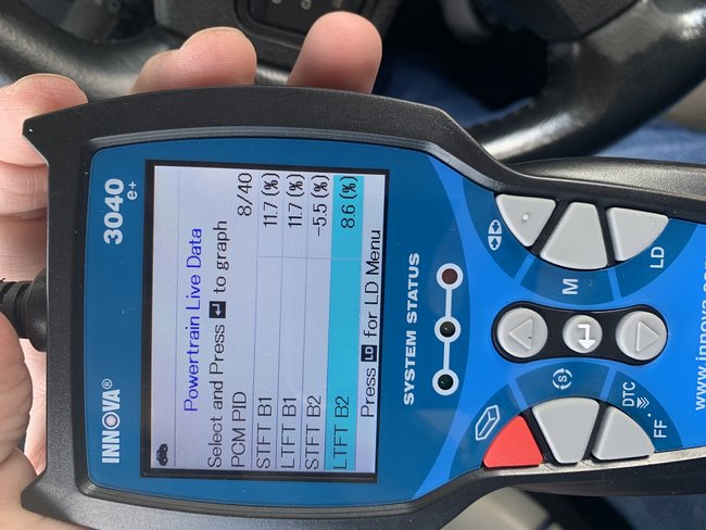

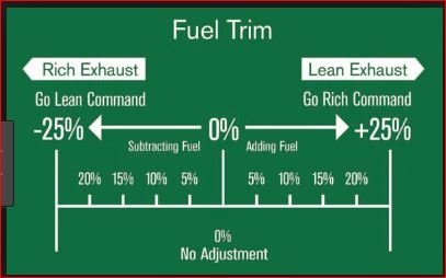

Drove the vehicle today. I’ll post a pic of the fuel trims at startup. While driving I noticed they would go up and down both short term and long term. The long terms would briefly get to mid to upper terms positive then come back down pretty quickly. Seemed to go higher when coming off the gas or braking and also seemed like they were higher when feeling some sputtering.
Jun 29, 2020 at 7:22 AM
That sounds pretty normal. The short term fuel trims should be bouncing up and down around 0 and long term should be more consistent and not bounce as much.
I think the sputtering is related to the pressure bouncing so erratically. Let us know what happens after the pump is replaced. Thanks

Got the fuel pump swapped last night. It was running pretty rough before the change and after it started up and idled smooth. Felt good driving, no hiccups and acceleration seemed better. Didn’t run the AC at first but did when got closer to home. Didn’t seem to have any issues though it was in the mid 70's out.
Got home, stopped and restarted. I let it idle for at least 20 minutes. It did good at first then would start getting smaller sputters but not as bad as before and not as frequent. I’ll see how it does when it’s hotter out.
I plugged my scanner in to look at fuel trims at idle. I’ll post the pics but my long terms were +13.3 and +9.4 and stayed at those numbers pretty much the whole time. I would give it gas and they would move a little and immediately go back to those numbers.
I also went in the test part of the scanner to see misfire counts and went in the O2 heater monitor test. This is after it was idling for a bit. B1S1 was at 77 F which was outside temp. B1S2 was 95F. B2S1 was 113F and B2S2 was 59F. Not sure if that’s even important but found it strange the temps would be so different. The live data always shows both my Cat converters at the same temperature.
I also noticed that my thermometer in the car was reading 76F but my ambient temperature sensor on the scanner was reading 115F. Are these supposed the same?

The sensor could be an issue but let's do as you suggested first. Let's let it run for a little bit and see how it does because those long term fuel trims should begin to change. What were the short term trims? On a properly running engine they will go negative and positive. Kind of bounce around 0 as the engine runs.
Also, does your scan tool have the ability to reset the adaptive numerator? This will reset the long term fuel trim so the PCM will run the engine based off of current numbers vs old numbers. That may be why you are getting the stumble because it is still running off the lean exhaust numbers so it is dumping more fuel causing the stumble when it doesn't really need the fuel now because the pump is supplying the proper amount of fuel now.
Let me know and we can go from there. Thanks

The short term at that time were -7.0 on B1 and -5.5 on B2. They would fluctuate as I gave gas in idle and the long term numbers would drop as well but immediately go back to the same numbers as before when letting off the gas. I do not believe my scanner has the ability to reset adaptive numerator. Not sure what it is honestly. How can that be done?
Jul 5, 2020 at 1:18 AM
The adaptive numerator is the long and short fuel trims. It is how it is calculated and resetting it, will basically wipe its memory. This adaptive so it will adjust the fuel trims over time but it is not immediate.
I believe you have what is called a GPEC controller on that vehicle which means this process may work to reset it.
Disconnect the battery positive terminal and touch the positive terminal to the negative battery post. This is called a capacitive discharge. Basically that means it depletes the keep alive memory the PCM so that it forgets all its learned data like the adaptives.
If this doesn't work then it is okay. Just drive the vehicle and it will bring those numbers closer to 0.
As for short term fuel trims, that makes sense that they are slightly negative and that is because the long term are positive. It is basically trying to bring those down.
Long story short, I think you fixed it and it will run better as those numbers are relearned.

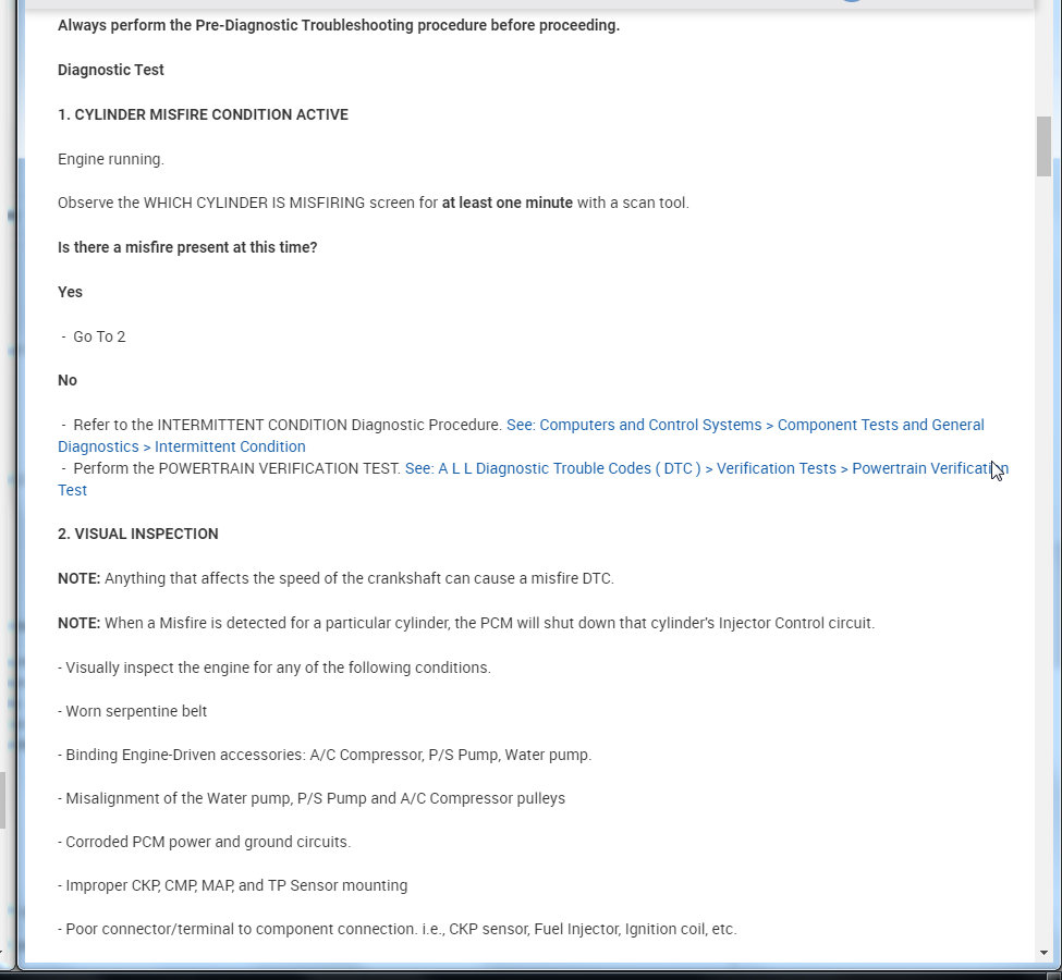

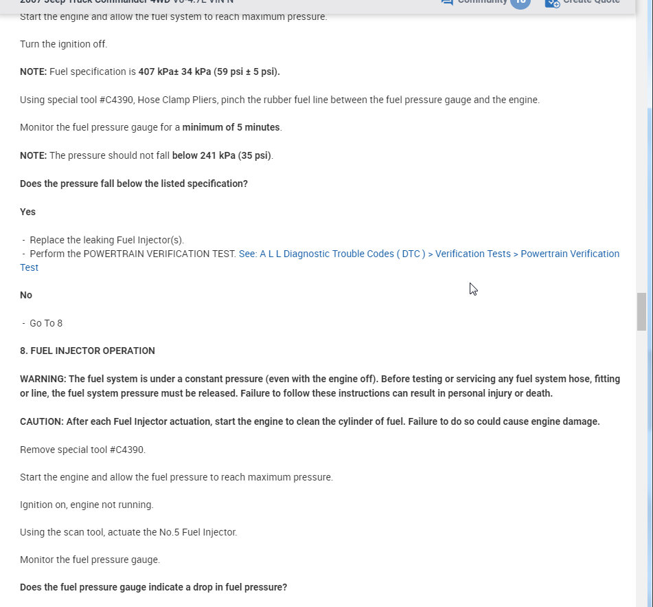

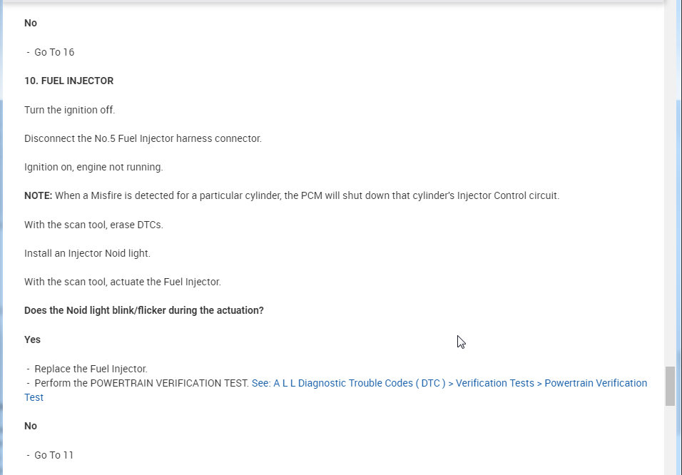

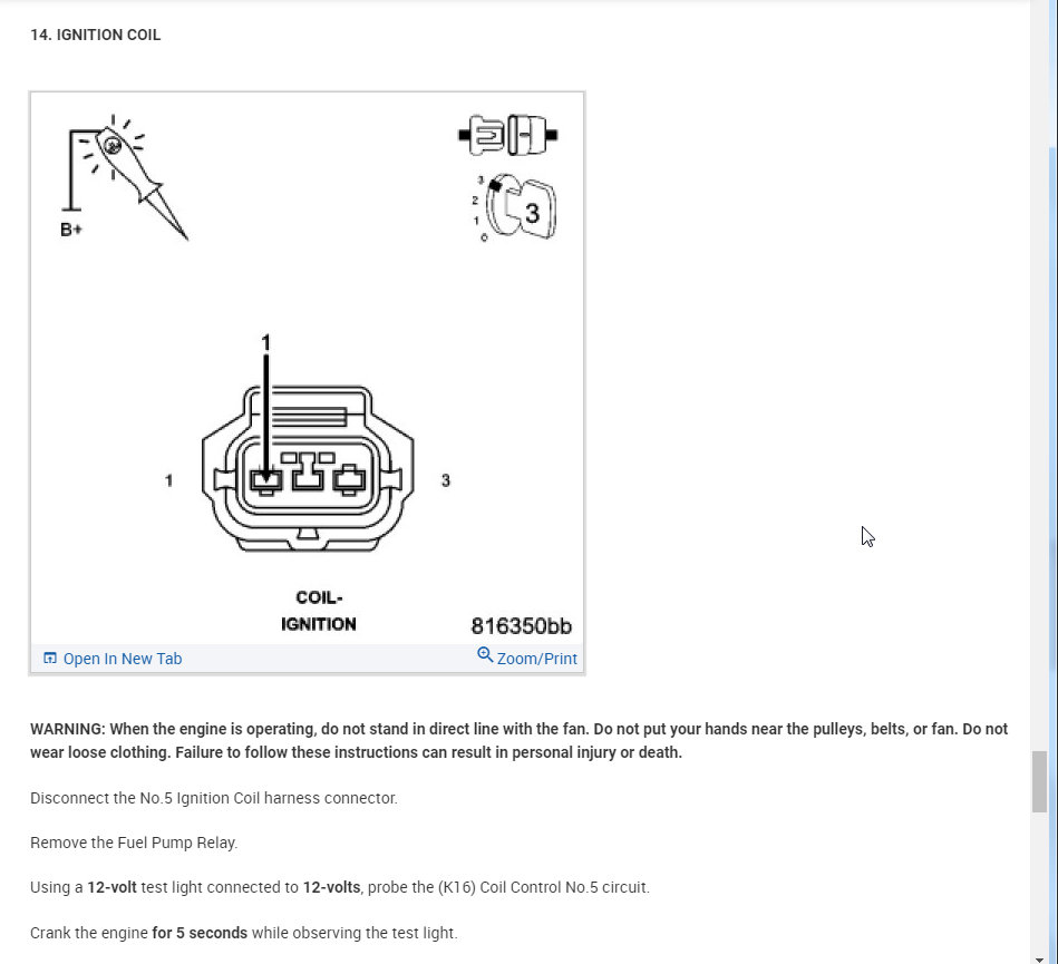

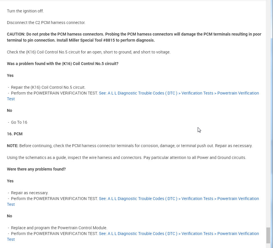

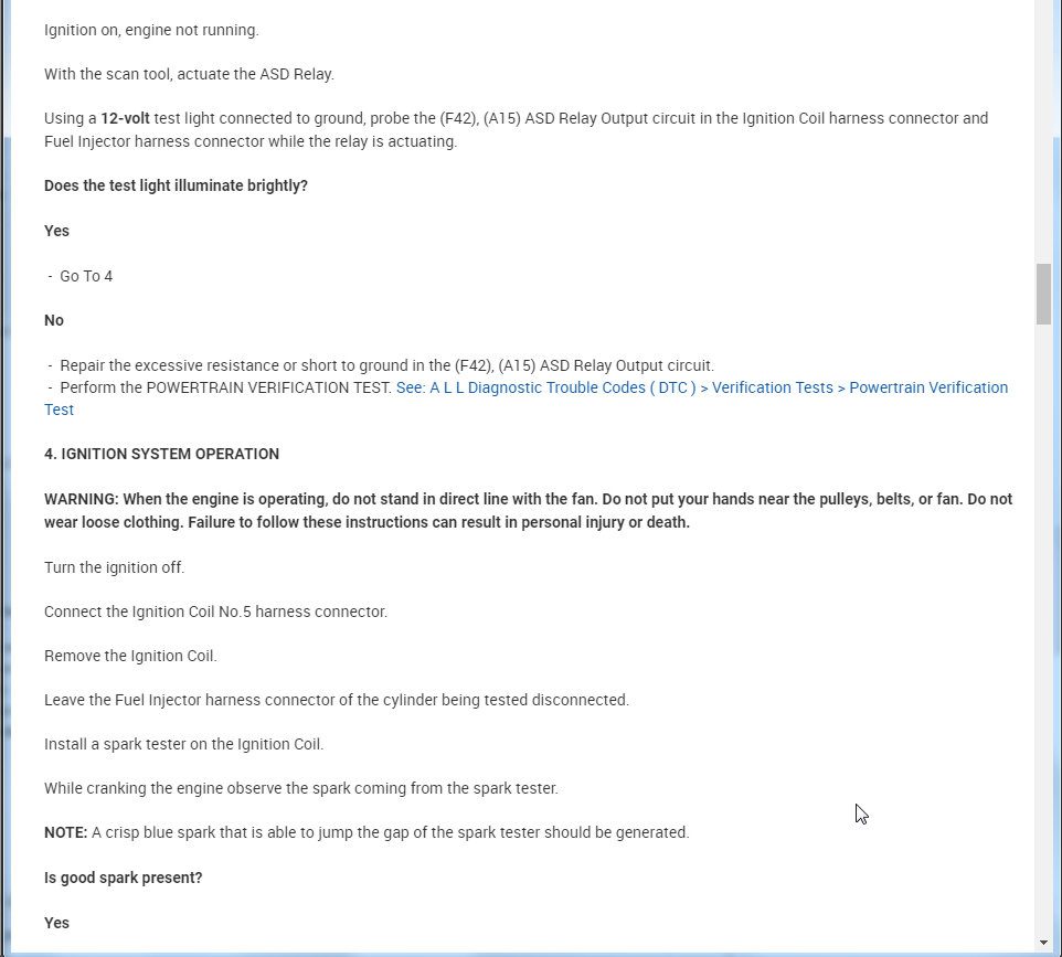

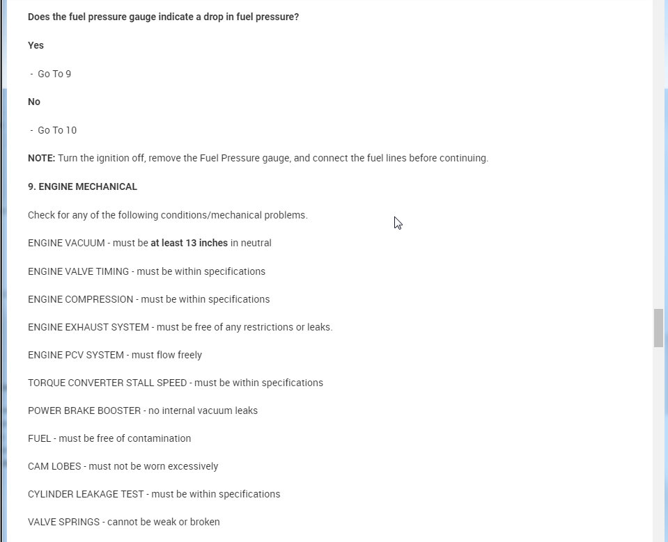

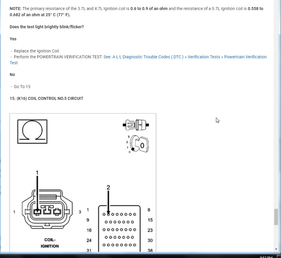

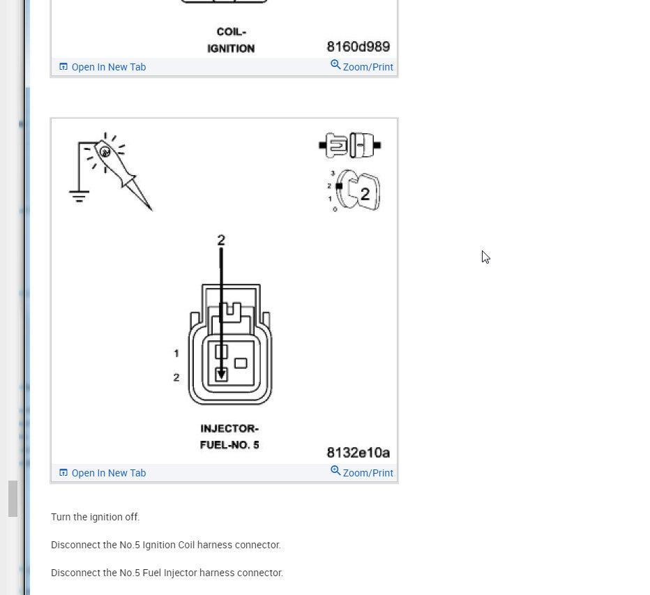

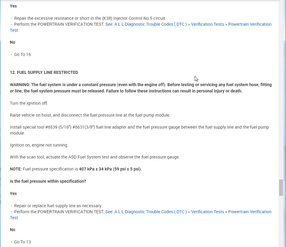

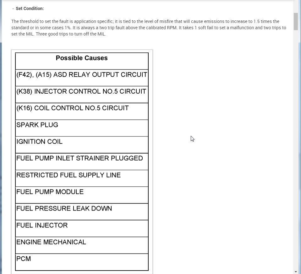

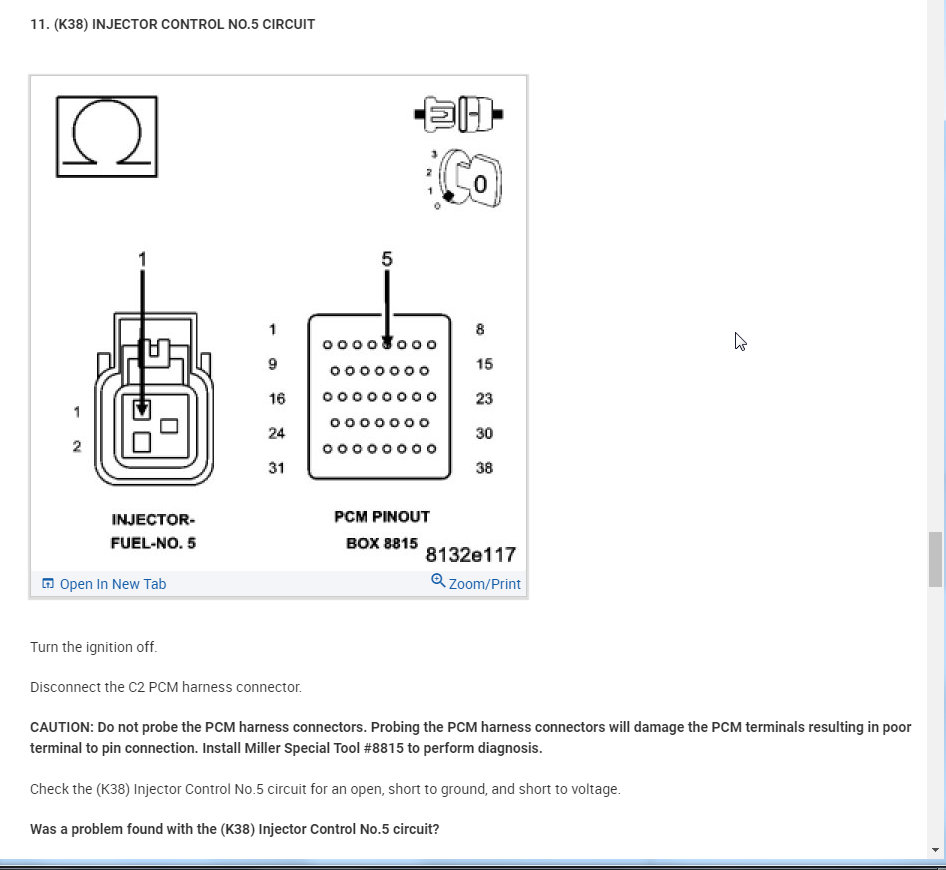

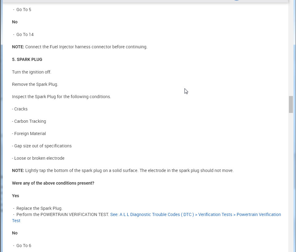

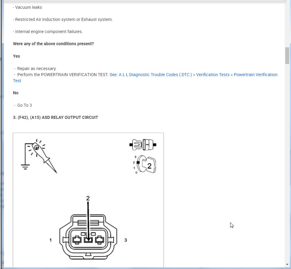

Okay. We need to run through this complete testing for number 5 misfire. We need to suspect an issue with the base engine. Number 9 of this testing is where we need to make sure we cross all these off the list. I suspect a vacuum issue so if you have a vacuum gauge, we need to make sure the needle stays steady. Due to the fuel gauge jumping, we may have a valve spring issue which will show up on a vacuum gauge as well if it is the intake valve.
Take a look at this testing and let me know what you find. However, we are looking for something causing that cylinder to go lean so that is increased oxygen or decreased fuel. Valve spring not sealing would make sense.
We may just want to run a compression check on number 5 and compare it with a couple other cylinders.

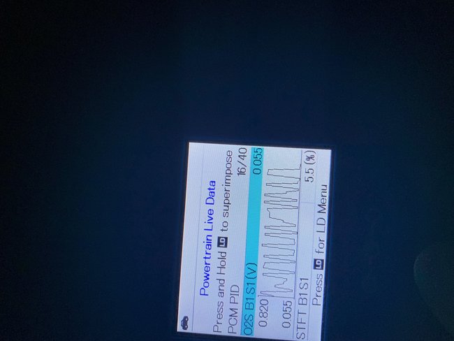

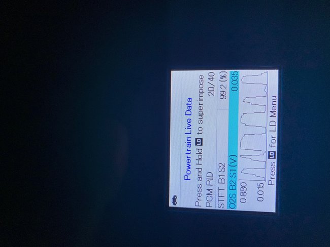

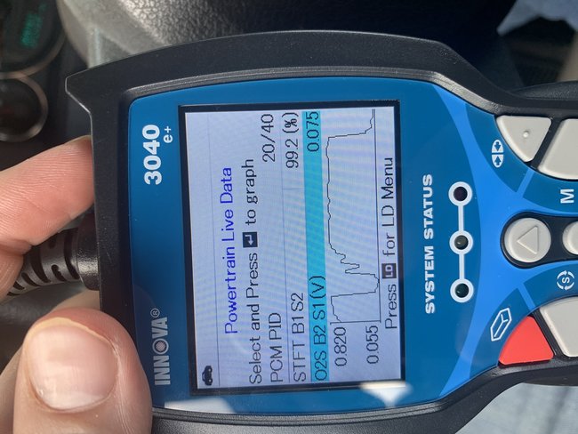

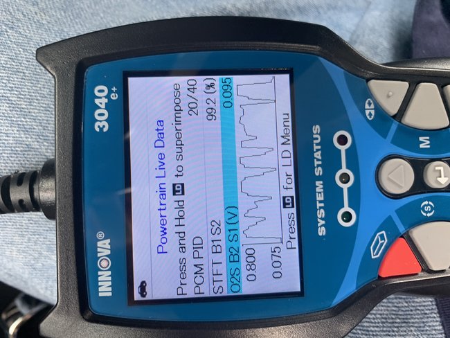

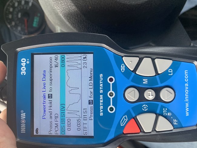

These are what the sensors looked like when it started sputtering after getting back.
Jul 7, 2020 at 12:31 PM
NYC2NC82
  • 96 POSTS
This is what one looked like after first trip earlier in the day (idling).
Jul 7, 2020 at 12:32 PM
NYC2NC82
  • 96 POSTS
Here’s what they looked like right after starting in the evening. Cold start.
Jul 7, 2020 at 12:34 PM
NYC2NC82
  • 96 POSTS
And these are some while driving on the highway.
Jul 7, 2020 at 12:37 PM
NYC2NC82
  • 96 POSTS

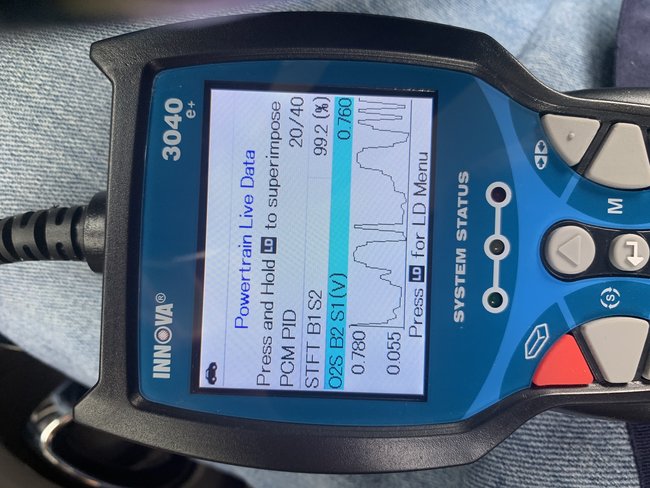

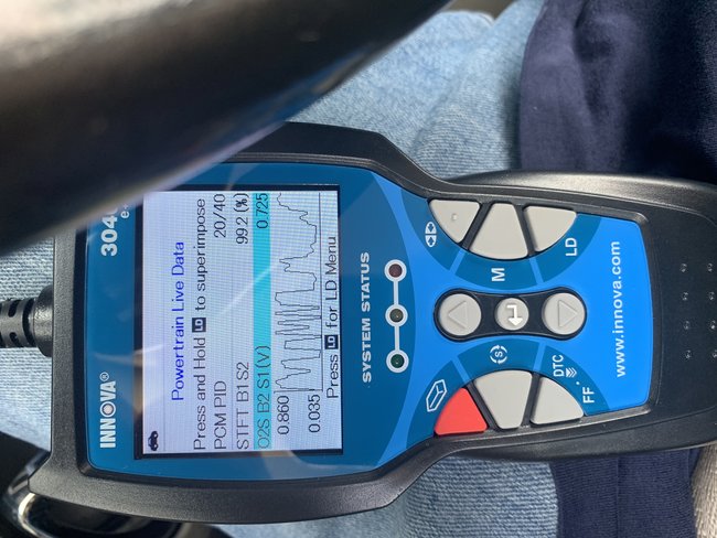

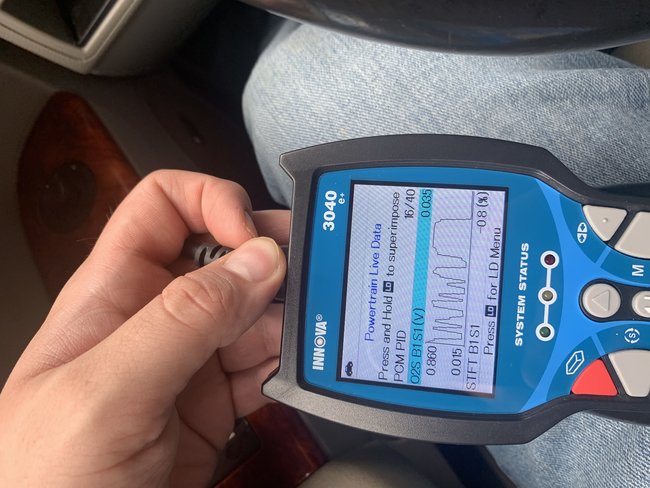

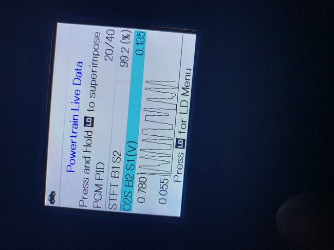

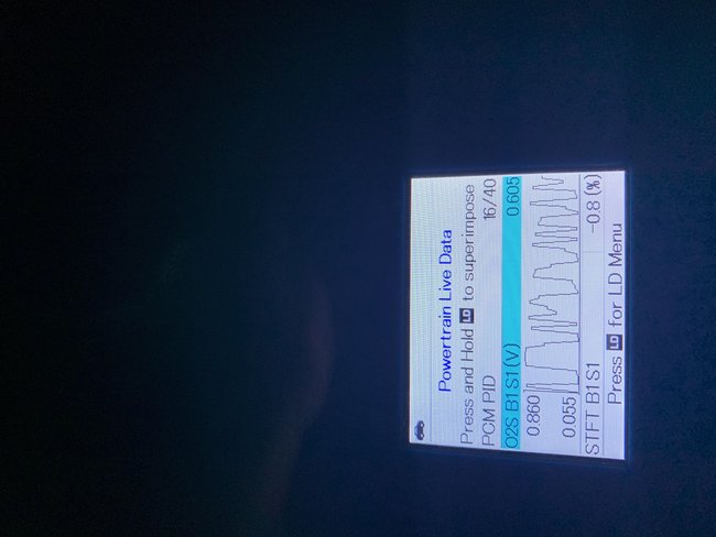

I don’t know if it’s just a coincidence or a reaction to what’s happening but I see the sensors oscillating a lot more rapid at a cold start then after it gets hot.
Trying to get you as much information as possible.
Jul 7, 2020 at 12:39 PM
NYC2NC82
  • 96 POSTS
These are graphs of both upstream o2 sensors while holding 2,000 rpm's.
Jul 8, 2020 at 4:43 AM
Do you have a vacuum gauge? That is good that we have good compression but we need to make sure we don't have a valve sticking while running. The gauge will tell us if the intake is hanging open or sticking. The way to check the exhaust is to actually take a dollar bill and hold it over the exhaust pipe. If it feels like it is being pulled into the pipe then the exhaust valve is sticking on cylinder 5.
Your o2 sensors are reacting to the misfire on 5 so I figure we have a mechanical issue on that cylinder. So we need to eliminate valves and go from there.

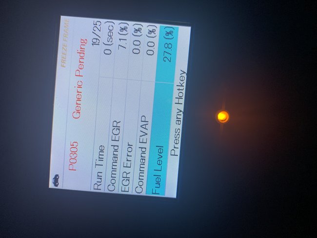

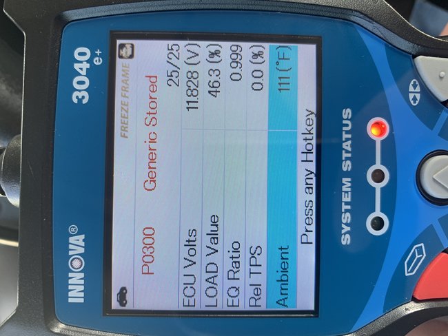

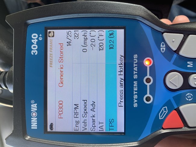

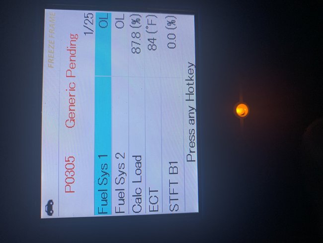

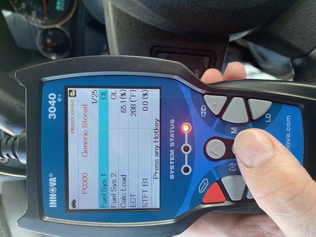

These pictures are all the freeze frame data from the stored 300 code I deleted earlier.
Jul 9, 2020 at 1:05 PM

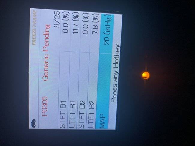

NYC2NC82
  • 96 POSTS

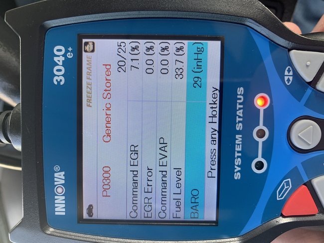

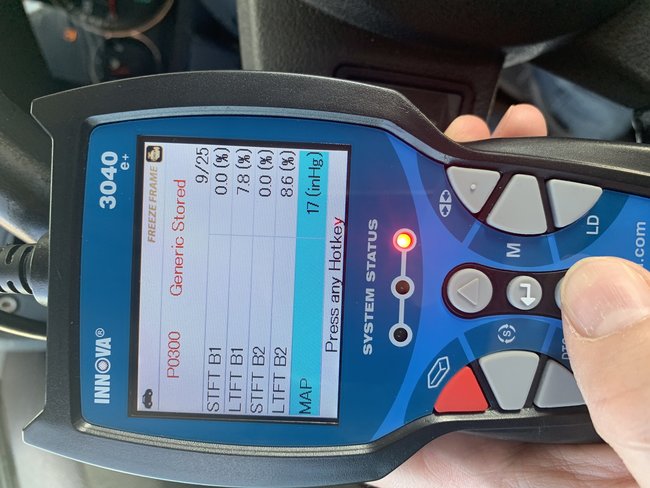

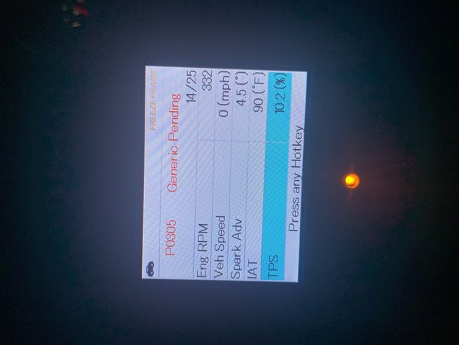

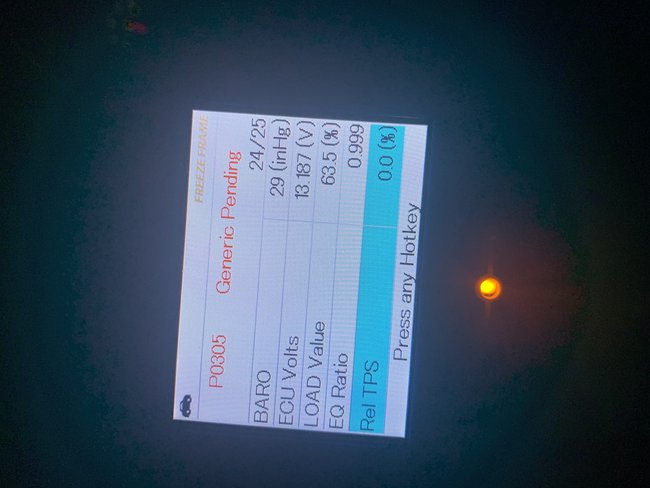

And these are the freeze frames for the pending 305 code. It has not set the light on yet in about 40-50 miles with of driving.
Jul 9, 2020 at 1:08 PM
NYC2NC82
  • 96 POSTS
And this is what the fuel trims looked like as soon as I got back home after 25 miles or so. Didn’t have much issue, a couple of stumbles here and there on the highway but nothing crazy and no rough idle when I stopped.
I hope I’m not over doing it with the pics and info. Thank you so much for your help! I hope we can get this fixed and the info can help someone else having this type of issue.
