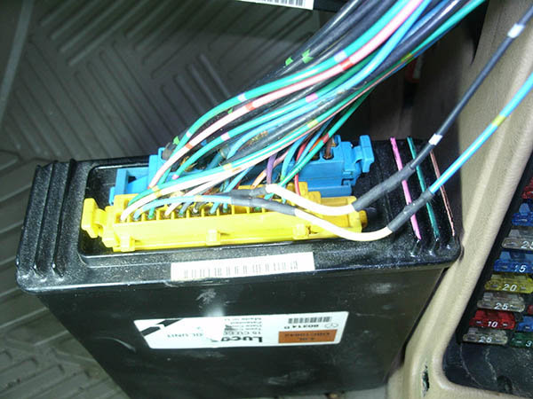

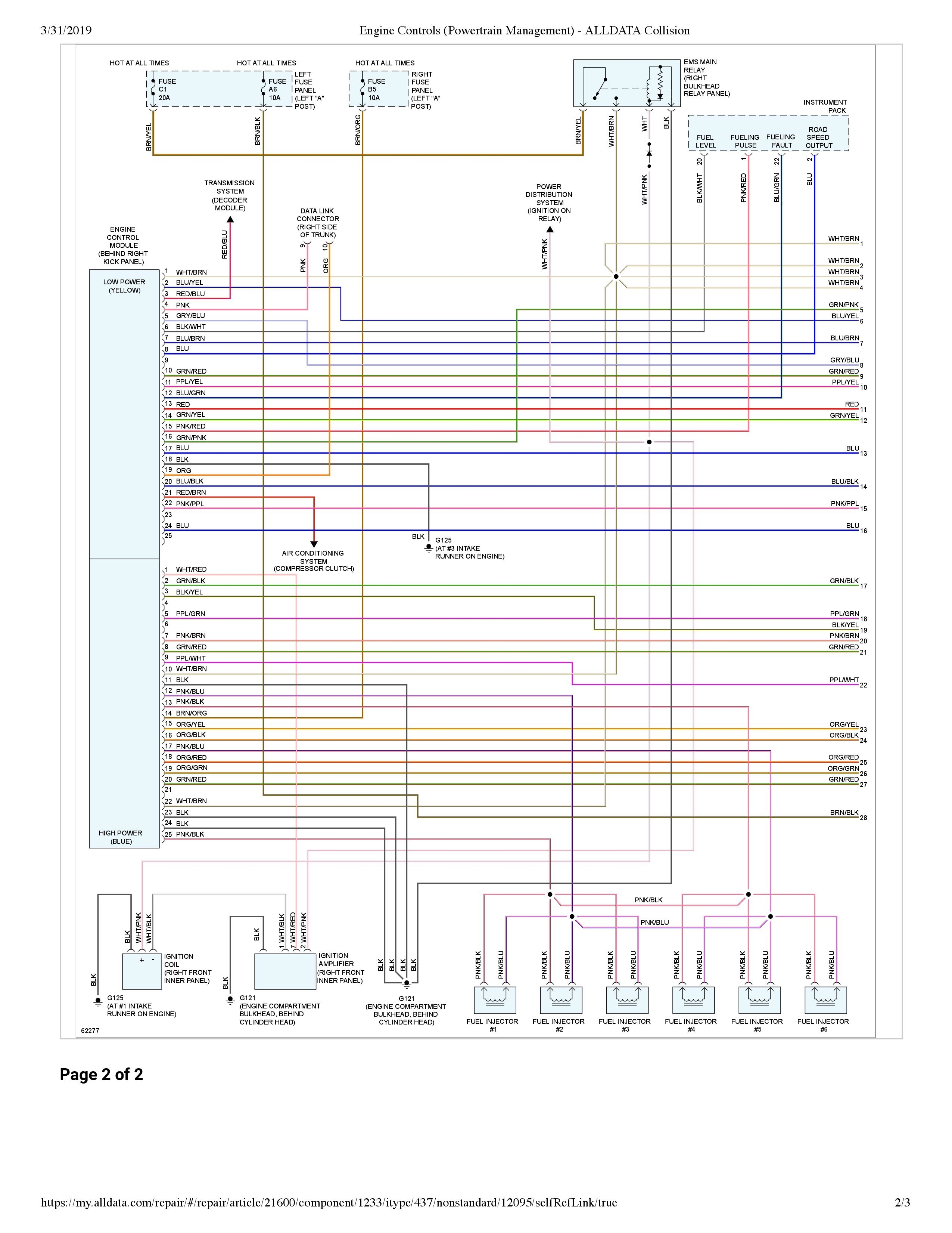

I have a no start problem with my car listed above XJ40/XJ6. I have good fuel pressure to the rail and good spark to the plugs. I have verified and re-verified that no gas is getting into the cylinders. I have checked all fuses and main relay, along with the other relays against the firewall.
I have another ECM (DBC10642) by LUCAS which I swapped out with no change to the no start condition. The blue connector to this is supposed to control the injectors, etc. I Checked pins 12, 13, 17, and 25 at the above ECM and found good continuity and condition.

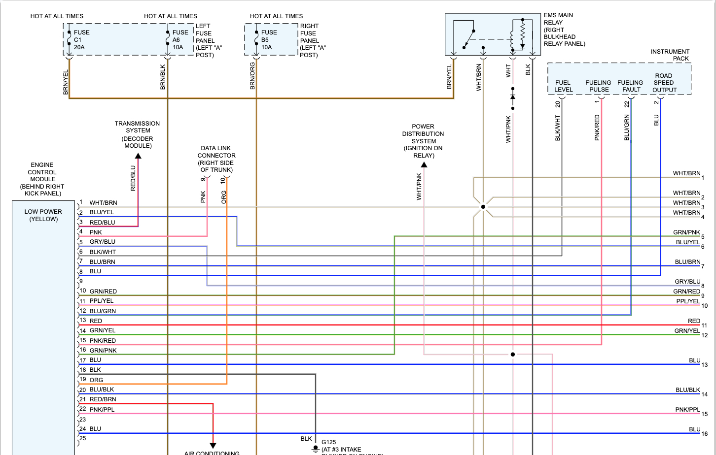

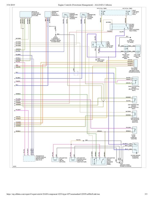

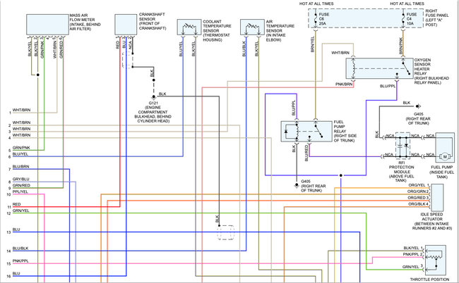

Hey WAYNEMERTZ,
Looks like you are making a good start on this issue.

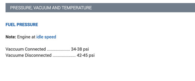

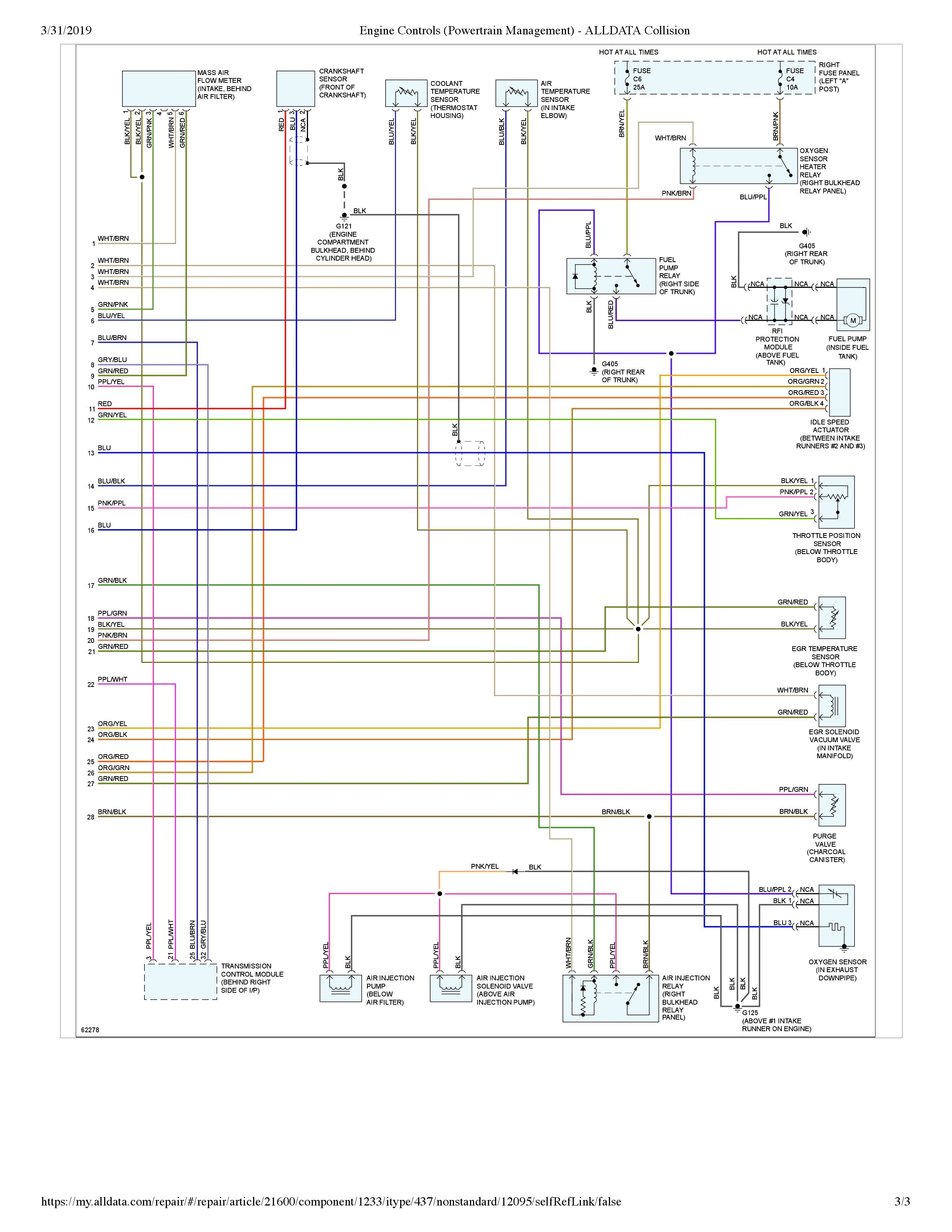

I have attached the wiring diagrams for engine controls below.

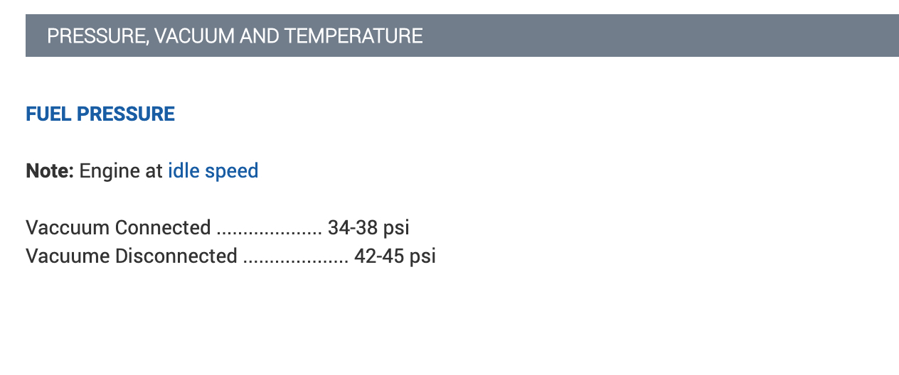

I have also attached the information for fuel pressure specs.
How did you check fuel pressure?

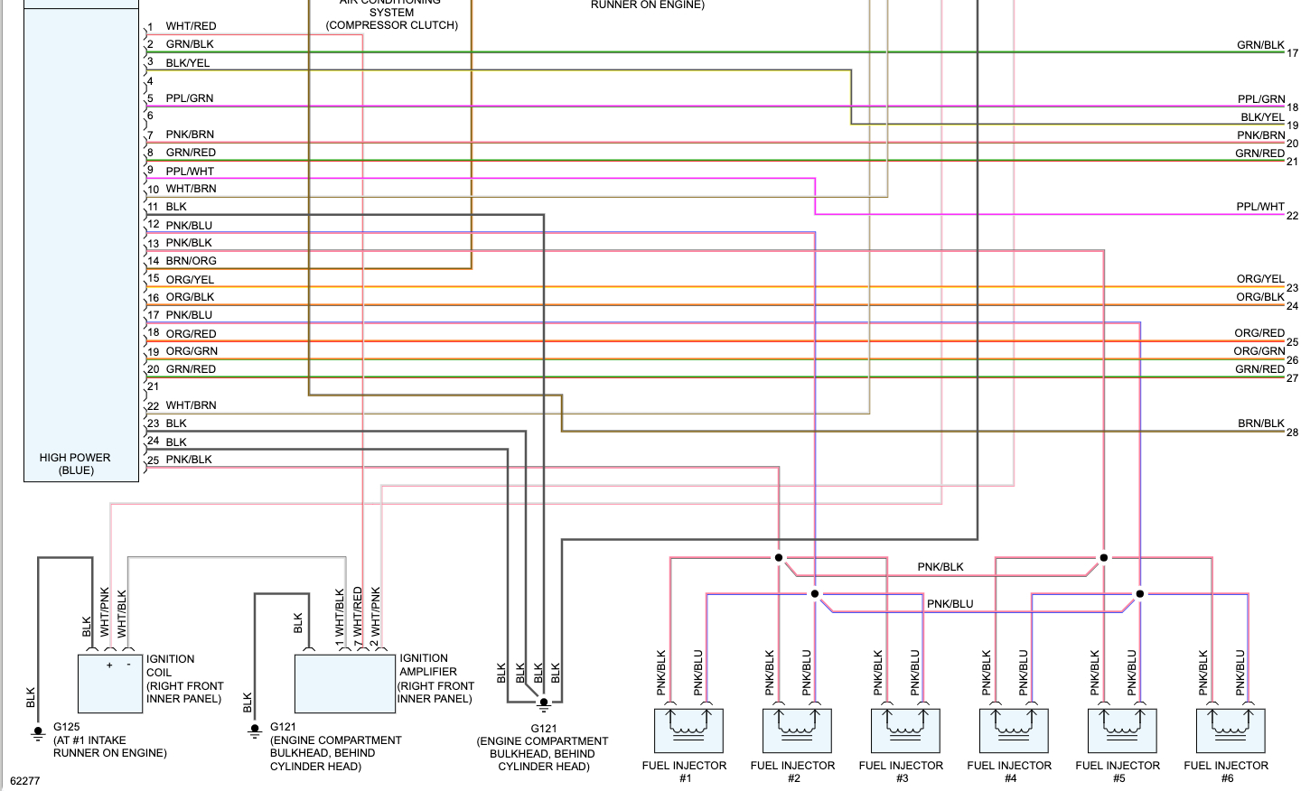

From the diagram it looks like all injectors are controlled from pins 12 and 25 at the blue connector on the PCM.
I would start by unplugging PCM and injectors and checking resistance from the PCM connector to each of the injectors for the PNK/BLK (pink/black) and PNK/BLU (pink/blue) wires. You should have a low number (less than 3 ohms, should be close to 0)
Also with everything still disconnected check resistance from the blue PCM connector pin 12 to ground and from the blue PCM connector pin 25 to ground. This should be open or you have a short to ground.
You can also check for voltage between the same pins and ground to ensure you are not shorting to positive.

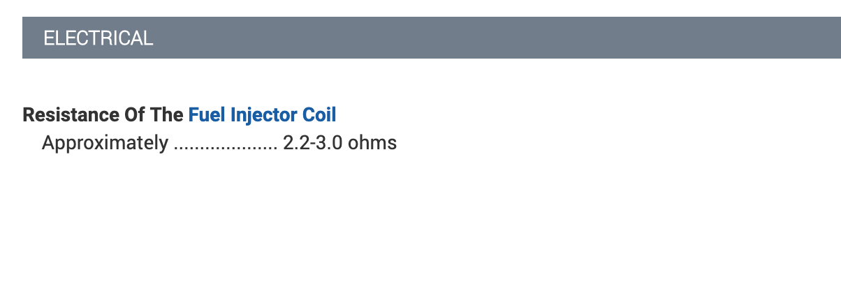

If this checks out then check the resistance of the injectors, between the two pins of the injector you should have 2.2-3ohms - spec sheet attached.
Hope that helps
Regards, Joe

Joe, thanks for the reply.
I used a fuel pressure gauge to check the fuel pressure at the rail.
I have checked the PCM and the pins in question as I stated above.
On my engine some idiot at the factory used black/green and black/blue wires to the injectors.
Just makes tracing and following the electrical diagrams in the manuals interesting.
The diagram attachments that you sent are all a blur.
I have clicked on them to enlarge, but even with a magnifier it is all a blur.
Do you have a higher resolution copy of these attachments?
I sure hope they detail the input/outputs of the blue connector.
Thanks again for your help,
Wayne

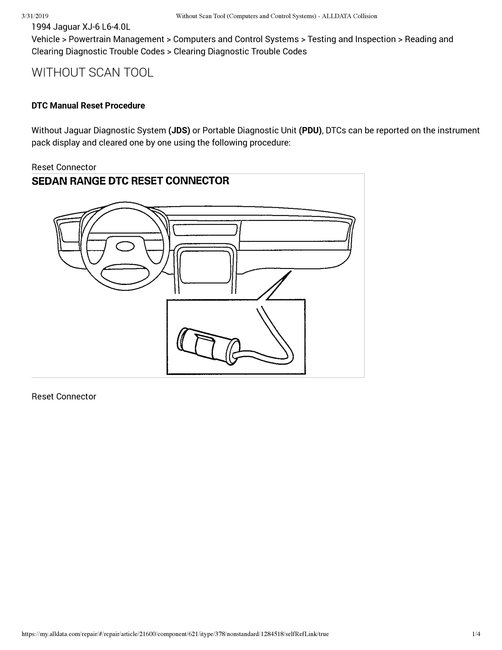

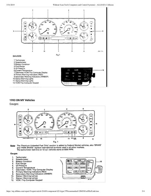

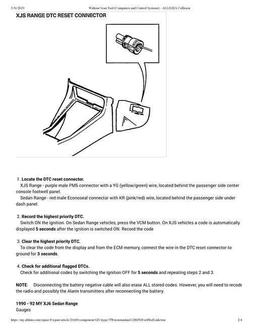

Hey WAYNEMERTZ,
Sorry I will try and work out the diagrams, they show all the engine controls.
I have found a procedure to check for DTC'c (diagnostic trouble codes)
Guide attached below.
Let me know if that is better resolution.
Regards, Joe
Sunday, March 31st, 2019 AT 7:42 PM

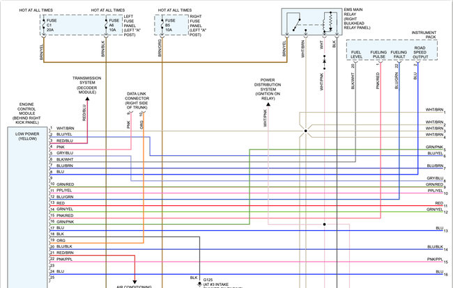

JOETECHPRO
  • 705 POSTS
Hey WAYNEMERTZ,
Try these diagrams below. You can right click and the open in new tab or save the files and try opening them that way.
Let me know if that still isn't any better.
Regards, Joe
Sunday, March 31st, 2019 AT 7:44 PM
WAYNEMERTZ
  • 57 POSTS

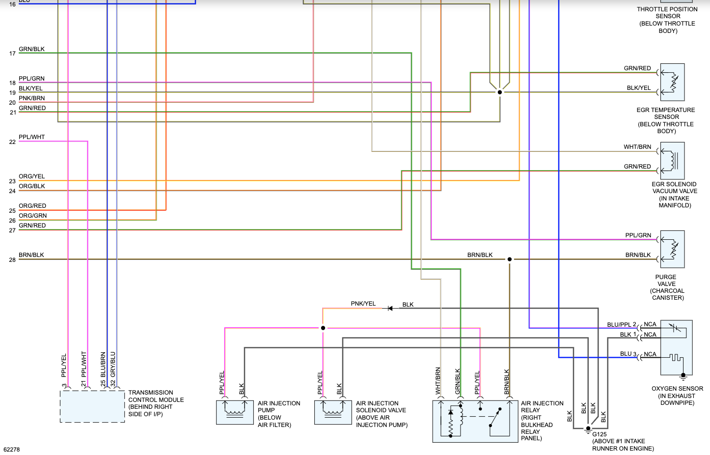

The first two were okay, but the third with the dials, etc was too low.
Sunday, March 31st, 2019 AT 7:48 PM
JOETECHPRO
  • 705 POSTS
Hey WAYNEMERTZ,
Sorry let me try one more.
That should work and give you the parts you need.
Please also ensure all the fuses for the ECM are good.
Regards, Joe
Sunday, March 31st, 2019 AT 7:56 PM

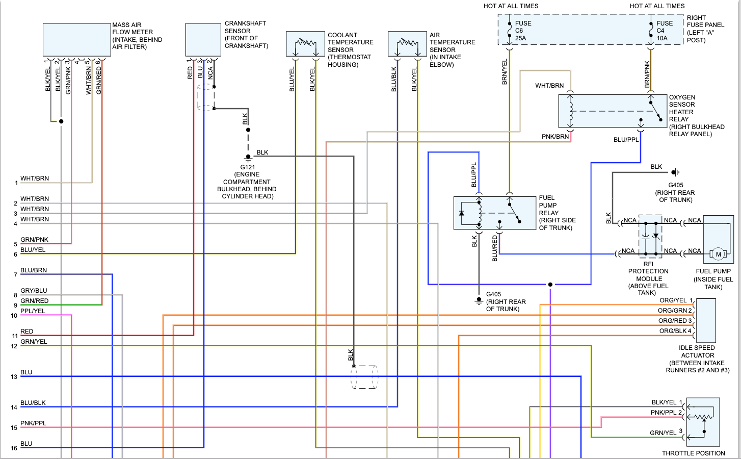

WAYNEMERTZ
  • 57 POSTS
Joe,
They still are at a too low resolution for me to make out any type on the diagrams.
Let me ask you this.
At your end, do the diagrams look good (resolution)?
If they do, something is happening in the upload.
Is there a way you can put them into a drop box and send the link, or send to my email?
In the meantime, I will try to improve them in photoshop if I can.
Thanks,
Wayne

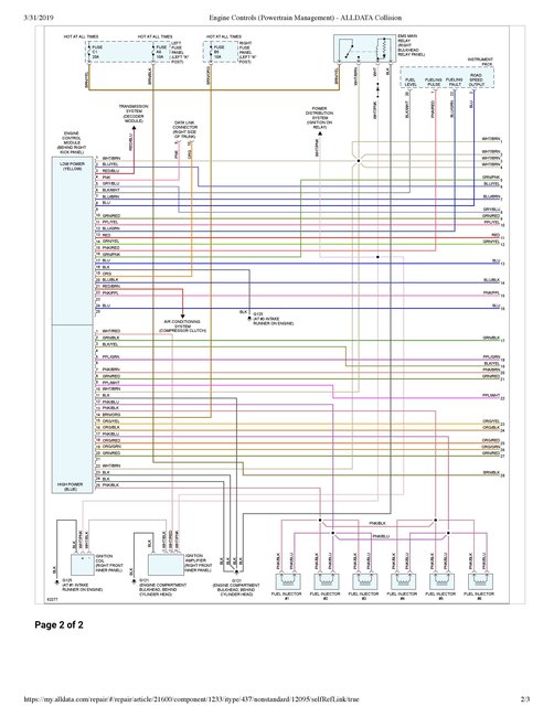

WAYNEMERTZ
  • 57 POSTS
The last ones worked great.
Thanks,
I will take time and review.
Thanks again,
Wayne
Sunday, March 31st, 2019 AT 7:59 PM
JOETECHPRO
  • 705 POSTS
Hey WAYNEMERTZ,
Perfect, sorry about the mess around with the uploads it's not working properly my end.
Also can you please check the voltage you have between the 2 pins on each of the injector connectors. Unplug the connector and test. With ignition on you should have 12V.
Regards, Joe

WAYNEMERTZ
  • 57 POSTS
I better wait until tomorrow to test again. I wasn't able to get a reading tonight.
I believe we had nearly 12 volts to both wires last weekend when we did the latest tests.
I guess the pulse to make the injectors work is a signal that grounds one of those wires.
I will have to keep you posted.
Of the diagrams you forwarded, did you send 3 pages? It looked like one of the pages said 3/3 on it?
Thanks again,
Wayne
Sunday, March 31st, 2019 AT 9:51 PM
JOETECHPRO
  • 705 POSTS
Hey WAYNEMERTZ,
Yes the ECM switches the ground side to pulse the injectors.
If you have 12V with the ignition on then for some reason the ECM is not pulsing the injectors when cranking.
If you do not have 12V then I would head back to the checking of fuses and power/grounds for the ECM.
The diagram was only 2 pages, the other page was blank.
Let me know what you get tomorrow.
Regards, Joe

If you are not getting an audible tick from the injectors when cranking then It is worth checking the resistance of all injectors (2.2-3 ohms is the spec)
