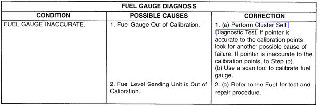

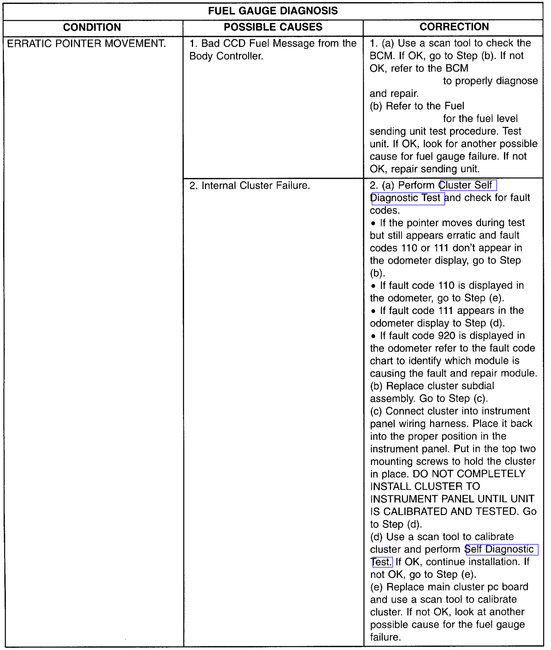

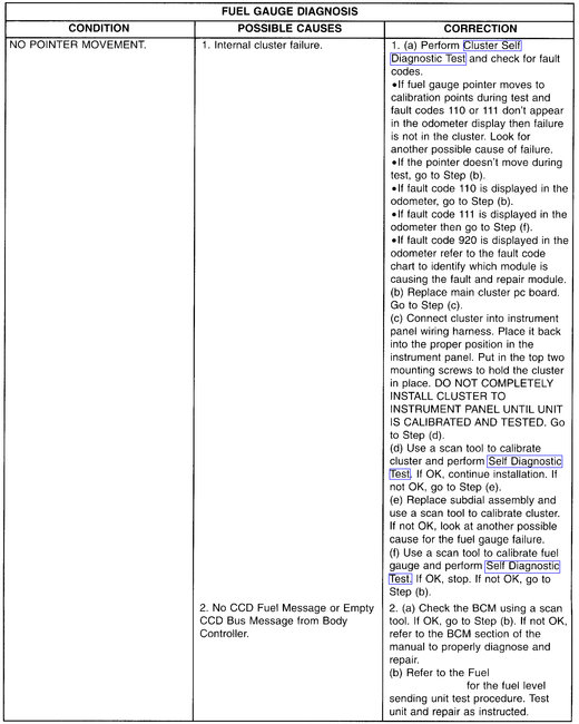

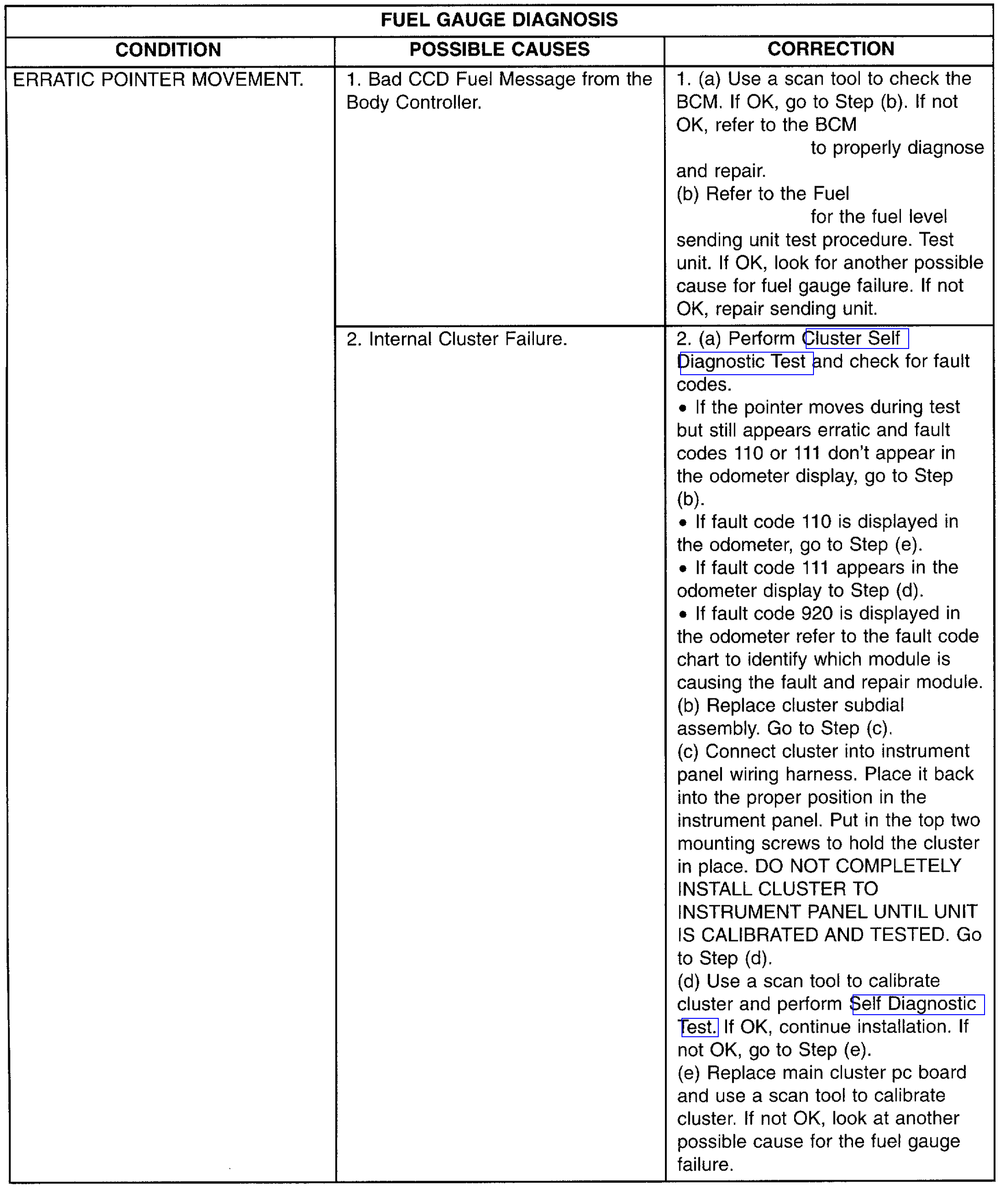

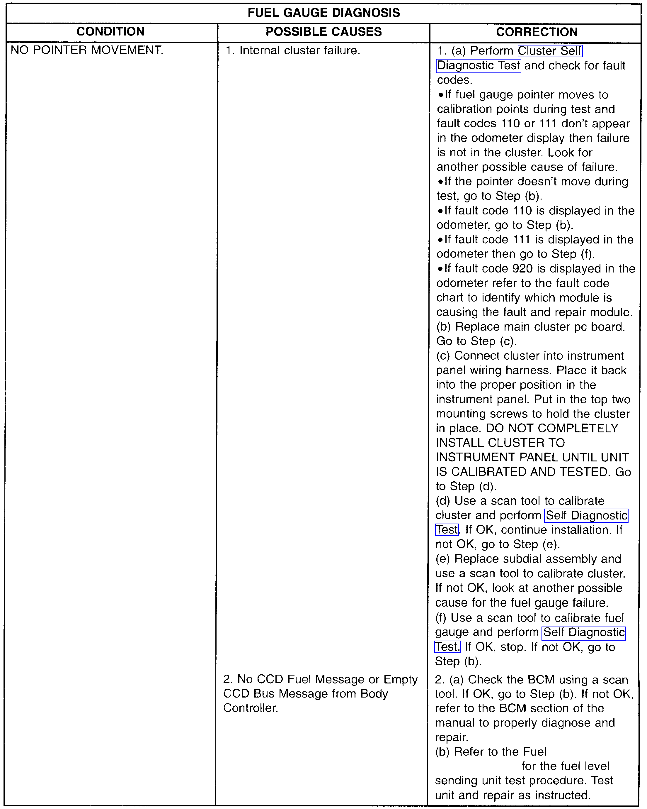

Since that is the only code that showed, the instrument cluster isn't the problem. Next, since you replaced the fuel module in the tank and checked wiring, that leaves the body control module.
If you look at the three attached pics, they are a diagnostic flow chart for fuel gauge problems. Take a look through them. I have a feeling the body control module is the issue, but you make your determination based on the charts.
If the text in the charts is too small, let me know and I'll try to enlarge them for you.
Take care and let me know what you find or if you have other questions.

If the fuel light comes on, I have to assume the BCM is working. I have attached 3 pictures below that show a flow chart for testing the gauge. Try going through it. Since it sweeps, it should be okay.
If there is something there you can't read, let me know.

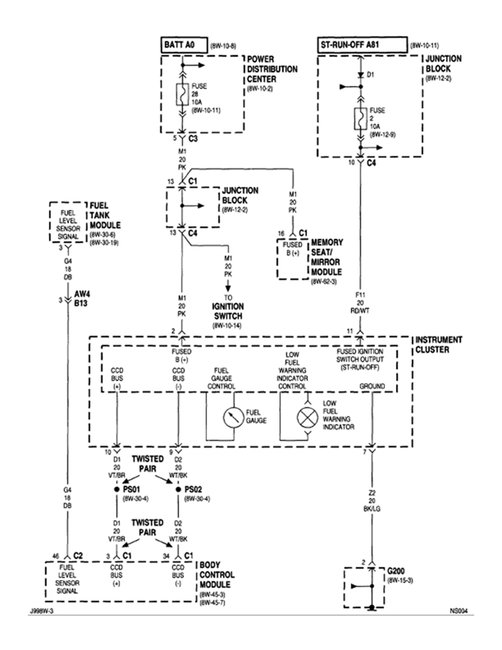

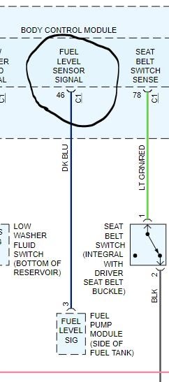

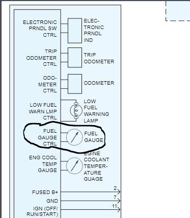

When you put it in self test mode, does the gauge sweep? If it does, it should be fine. However, I'm starting to feel the same as you. As far as applying power, looking at the schematic is extremely vague. I can tell you that the sender goes to the BCM via a dark blue wire. It doesn't show the signal out from the BCM. If you look at the cluster specifically, again, extremely vague.
See pictures 1 and 2.
Aug 27, 2019 at 12:45 PM

thanks for telling me that, because I have studied that same diagram repeatedly! I always have stranger than normal issues, lol ! I searched for a cluster and not one to be found locally, and looking like a hundred dollar bill for another used one online, which i'm not sure will get it fixed. I bought the cam and crank sensors and a PCM only to find that wasn't the problem, I think it was the ASD rely, put in a new one so far has worked. do you think just the gauge itself could be gotten from a dealer? or is the cluster a whole unit always?
There are 7 wires going into the cluster:
pink m1
org e1
blk/lt gr z2
wht/blk o2
vio/br o1
red/wht f11
blk z1
any guess as to which feeds the gauge? I am going to remove the cluster yet again and see which has voltage. shouldn't the gauge feed be variable voltage according to fuel level? would that also confirm the system is working correctly up to the cluster?

looks like pins 9 and 10 feed gauge? should those read 2.5 volts? or variable? on BCM, what should pin 42 read? are there fuses here that might be the problem? or is it just the gauge needs replacement?
Aug 28, 2019 at 5:42 AM
  • 110,248 POSTS
Welcome back:

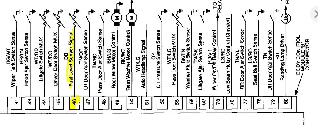

The pins to the gauge will vary. As far as the one from the BCM, that will be low voltage. At this point, what I suggest is to check for continuity between the BCM and the sending unit. You may have an open circuit the two

so that is pin 42 on the BCM?
Aug 28, 2019 at 6:24 PM
  • 110,248 POSTS
Welcome back:
I attached a picture of the pin in question. It shows pin 46. See the attached picture.
Let me know if that helps.

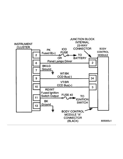

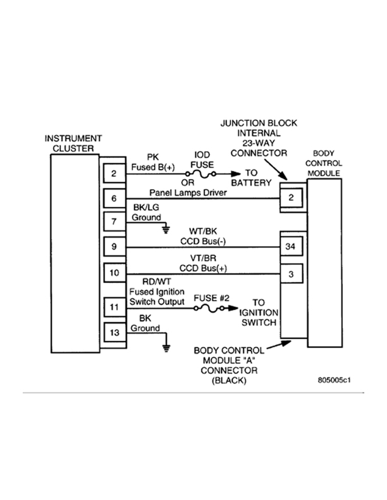

I will check that tomorrow. i took the cluster out and switch the fuel and temperature gauge thinking it might be the gauge its self, nope fuel gauge worked in the temp spot and temperature gauge didn't work in the fuel gauge spot! i ordered another cluster! waiting on it to get here. while i had it apart, i checked the voltage reading at the cluster (red) plug. pink wire #2 pin 12.30 volts, orange wire #6 pin 11.34 volts, white/black wire #9 pin 2.47 volt, vt/br wire #10 pin 2.50 volt, rd/wt wire # 11 pin 11.50 volt. i have no idea what that means...lol...other than pin 9 and 10 feed fuel gauge and come from pin 3 and 34 in BCM...which also read 2.5 volts. i checked voltage at the 4 connectors on the gauge its self and got these readings ...upper left 1 volt, lower left 11.44 volts, upper right 7.82 volts and lower right 5.75 volts...again not sure what those should be?
Aug 29, 2019 at 12:12 PM
MARK COCHRAN
  • 16 POSTS
diagram i have for the cluster says #2 pin fused B+, #6 pin panel lamps driver, #9 pin CCD BUS -, #10 pin CCD BUS +, #11 pin fused ignition switch output... almost ready to order BCM and drop tank back down to check float.. will check BCM pin 46 first and get back with you on that. more gray hairs!
