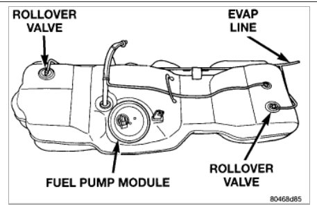

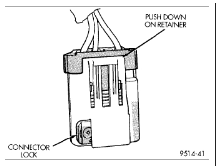

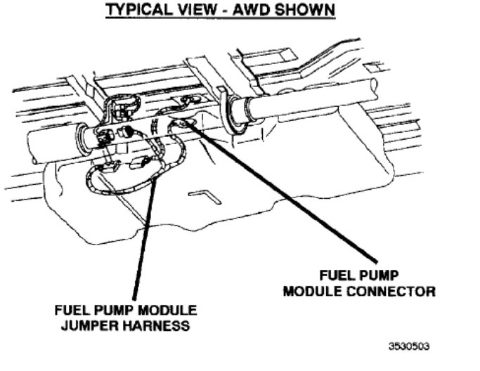

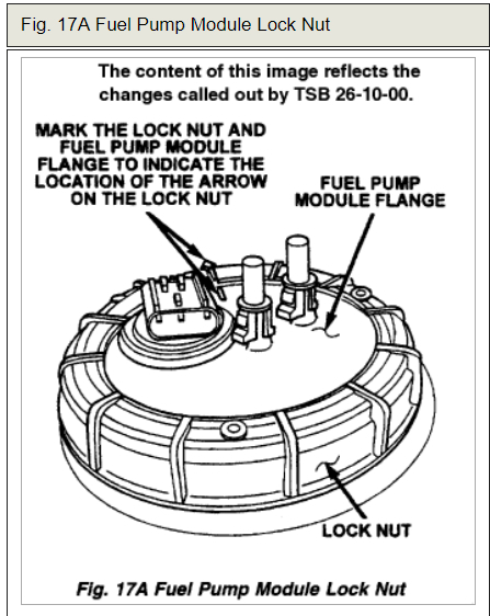

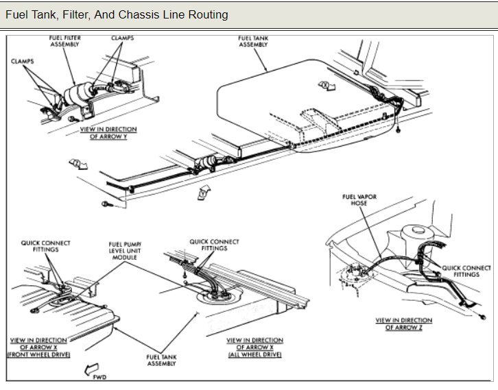

My gas gauge swings wildly after it reaches 3/4 tank or less, and constantly sets off the alert chime. Is there a way to turn off the chime until I can get the fuel sensor replaced?
Monday, August 18th, 2008 AT 7:46 AM
KEN L
  • MASTER CERTIFIED MECHANIC
  • 48,363 POSTS

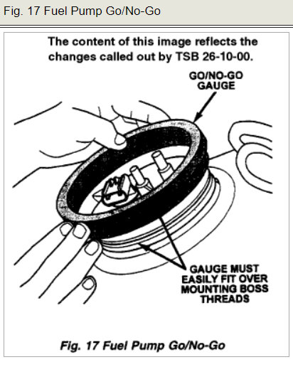

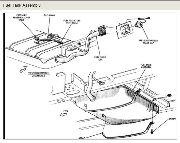

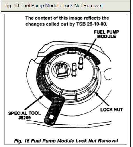

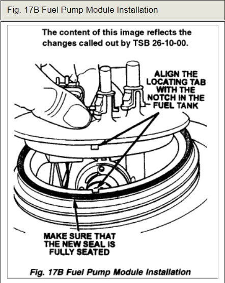

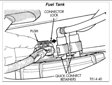

There is no way to remove the chime warning you will need to replace the sender and fuel pump module which is causing the problem.
Here is a guide to give you an idea of what you are in for when doing the job.
https://www.2carpros.com/articles/how-to-replace-an-electric-fuel-pump
Here is how it will be on your car (below)
