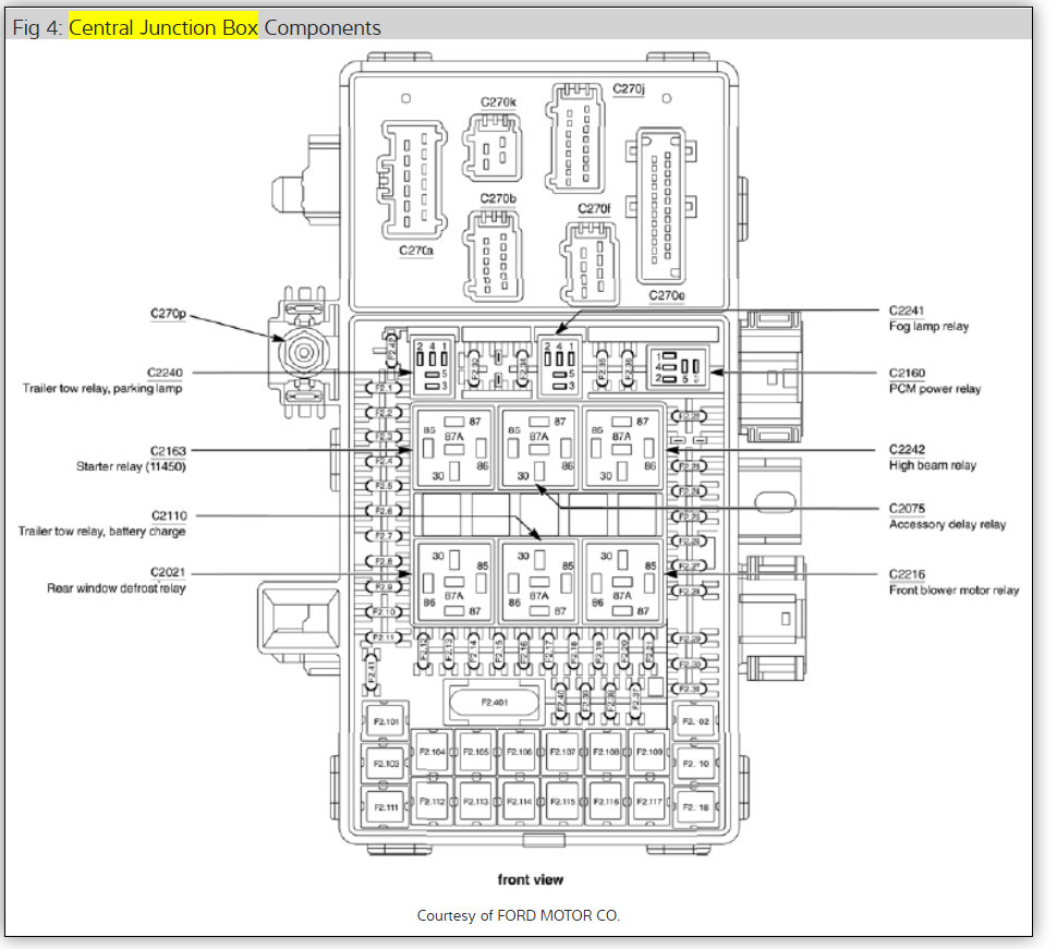

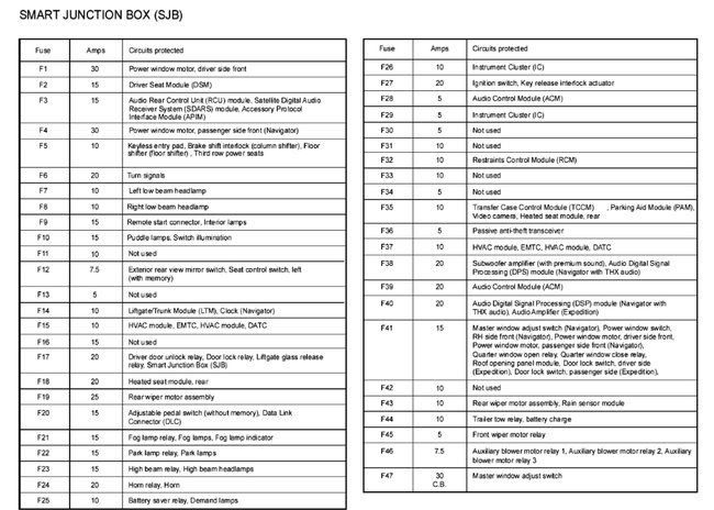

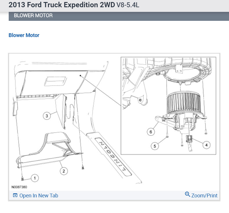

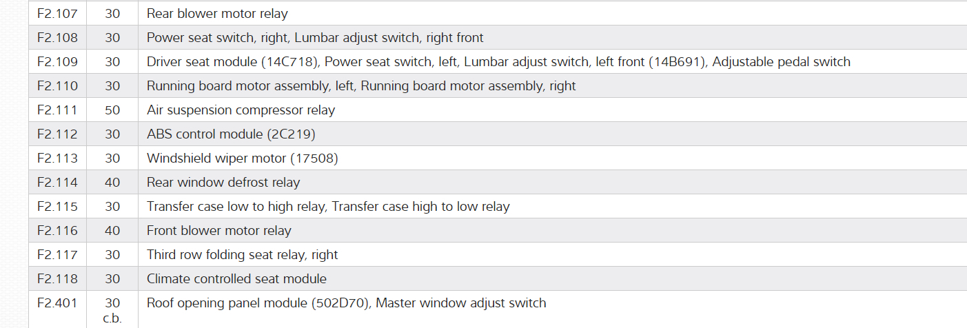

The front AC/heater is not blowing any air on any setting. The rear unit is working fine. The dash controls have power but nothing is happening when I turn it on.

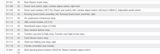

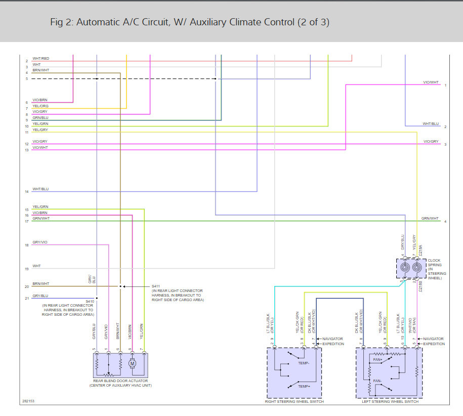

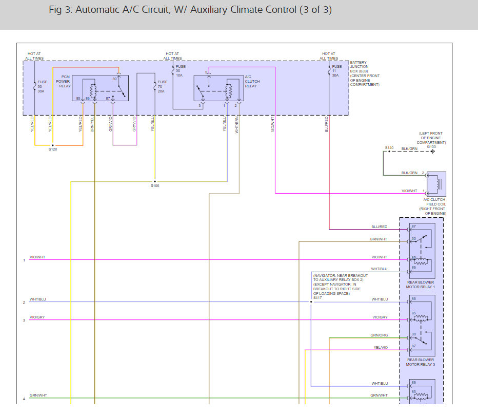

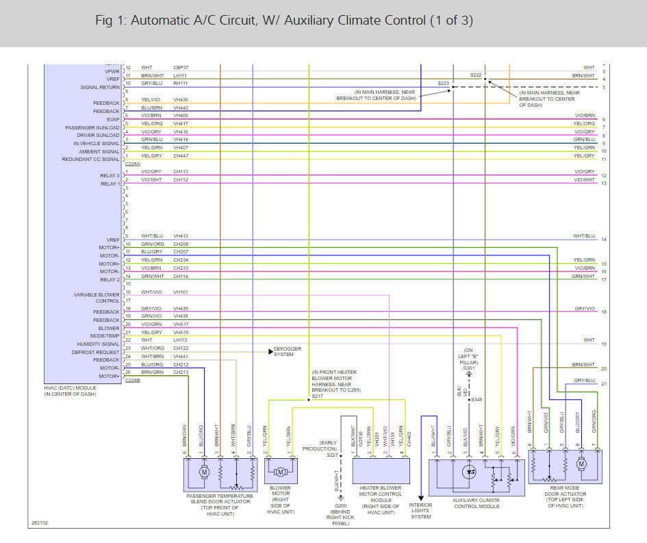

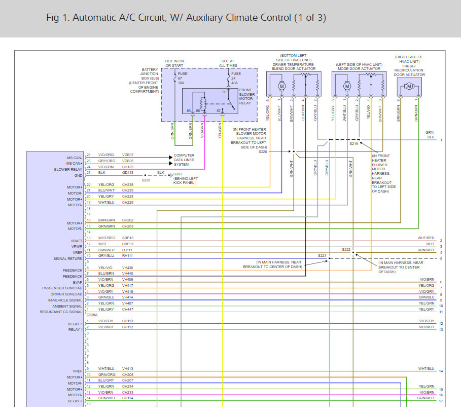

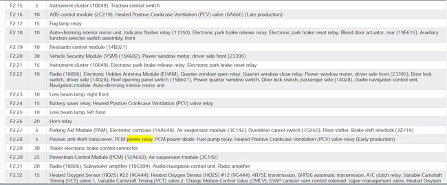

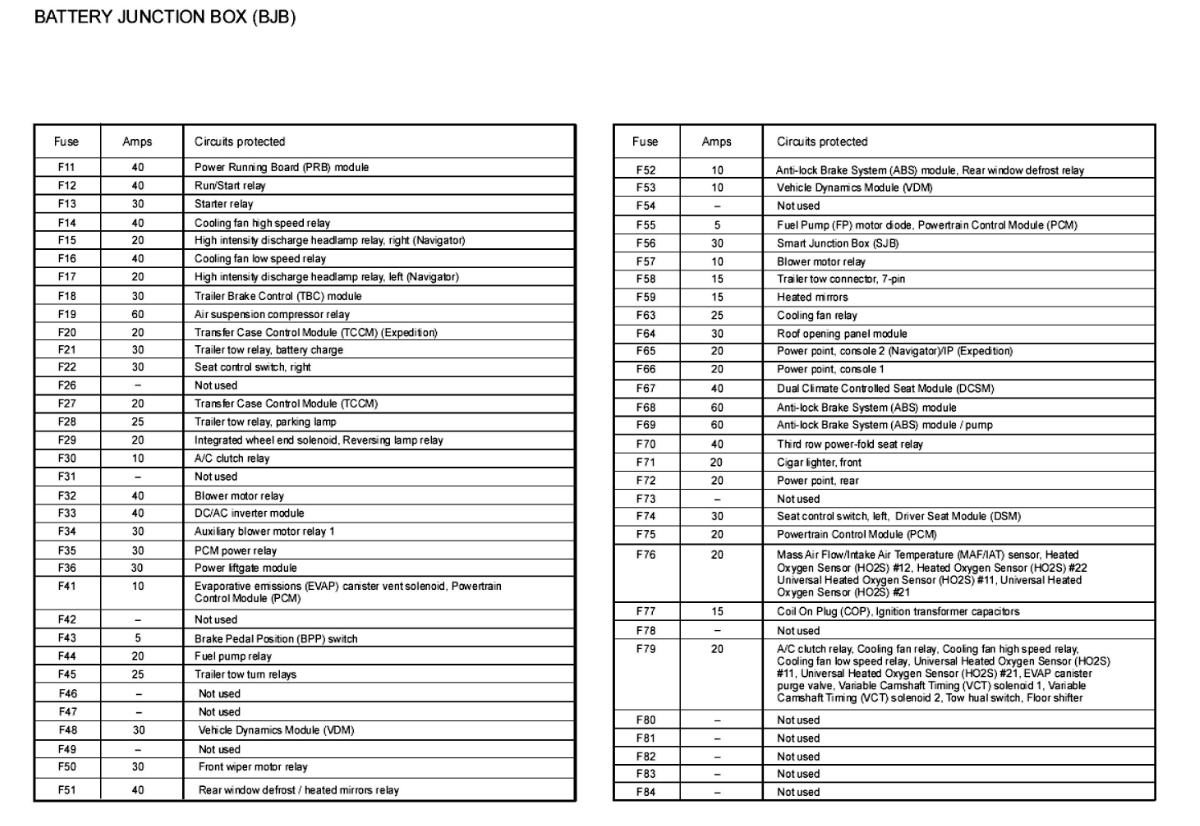

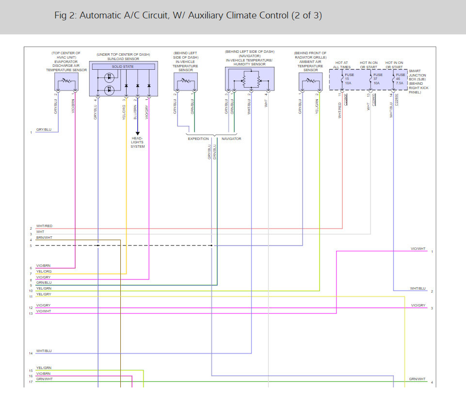

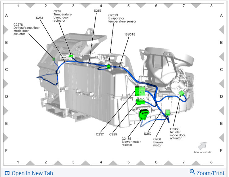

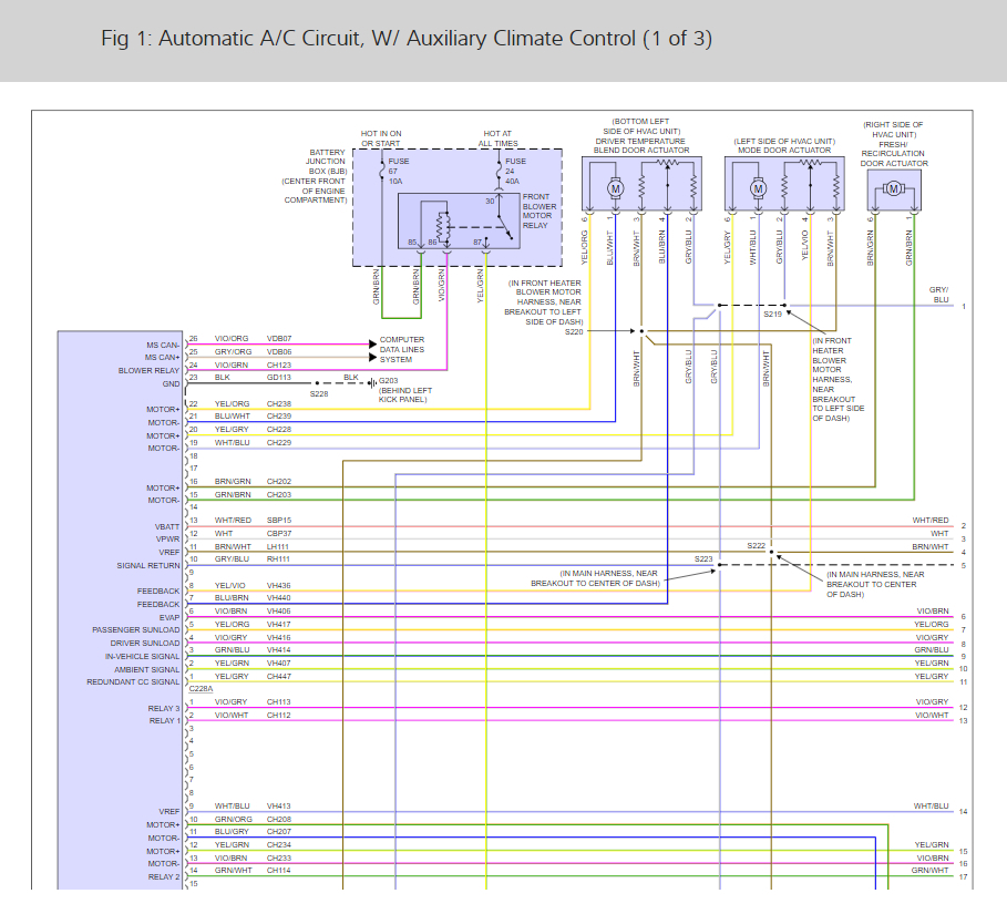

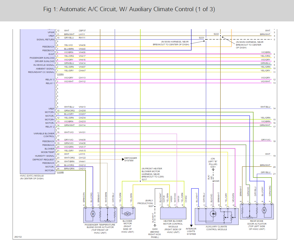

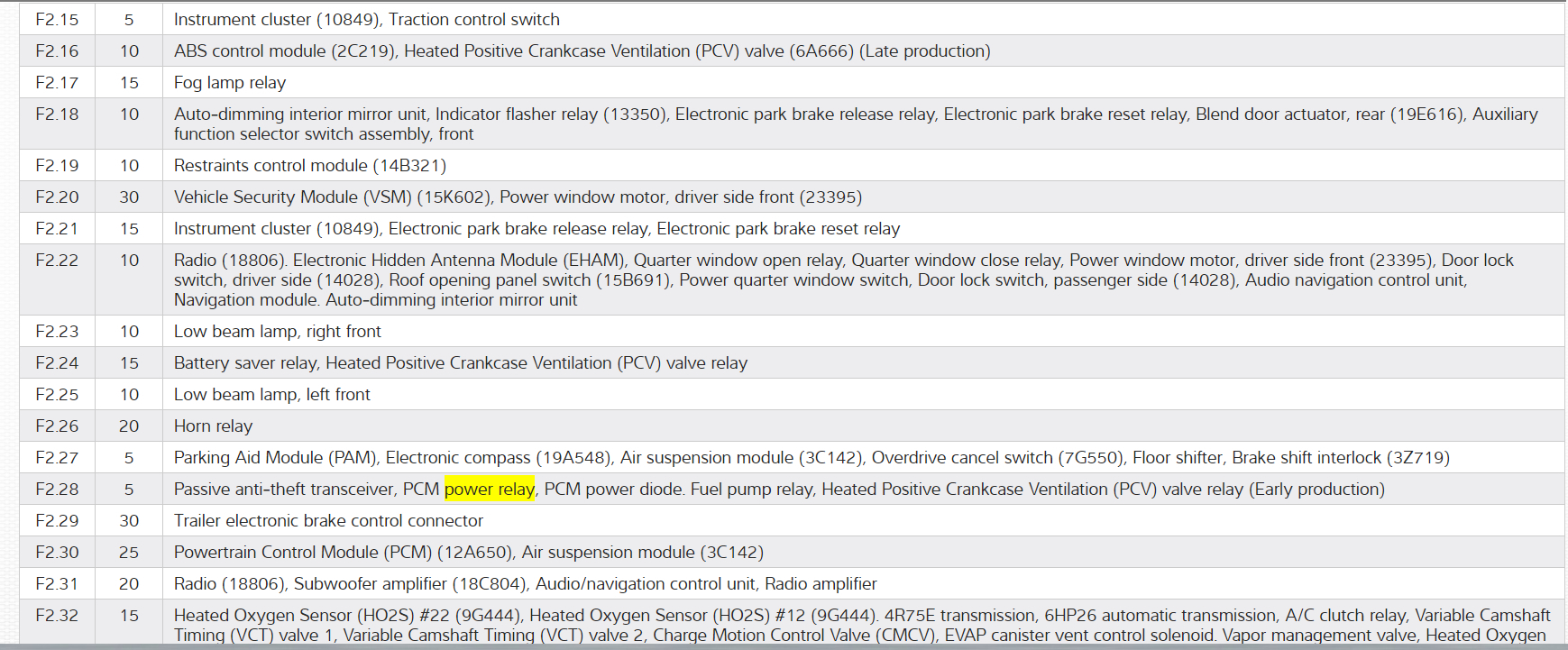

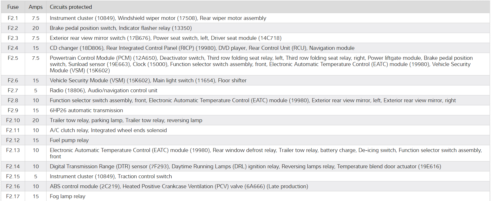

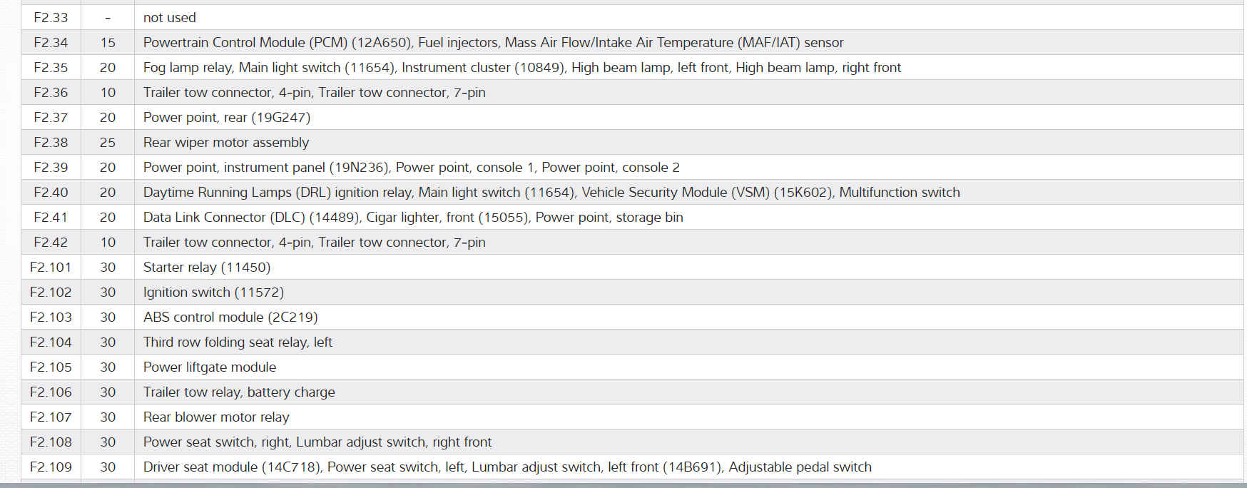

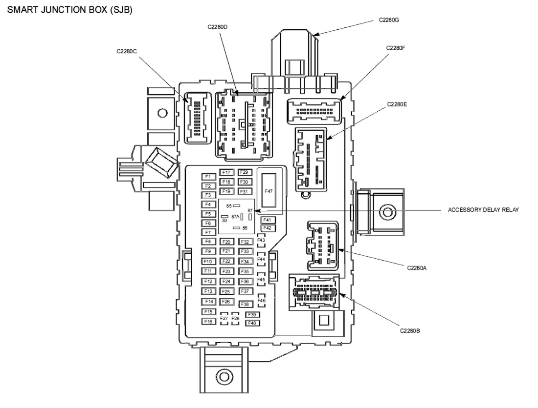

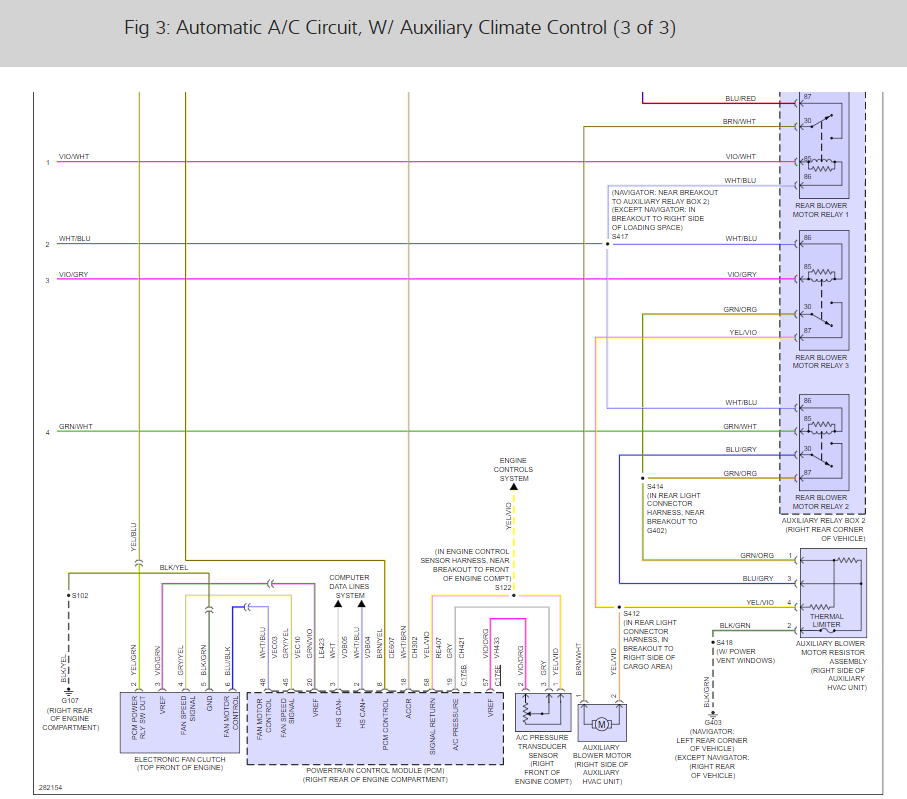

It sounds like the blower motor or the blower motor relay or fuse has gone out but to be sure here are two guides to help walk us through the testing and the relay with fuse locations in the diagrams below as well.
https://www.2carpros.com/articles/blower-fan-motor-works-on-high-speed-only
and
and

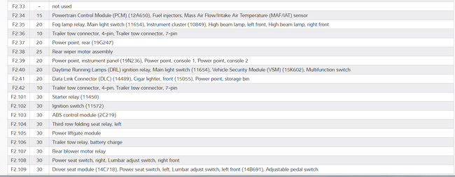

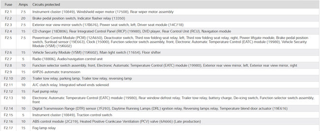

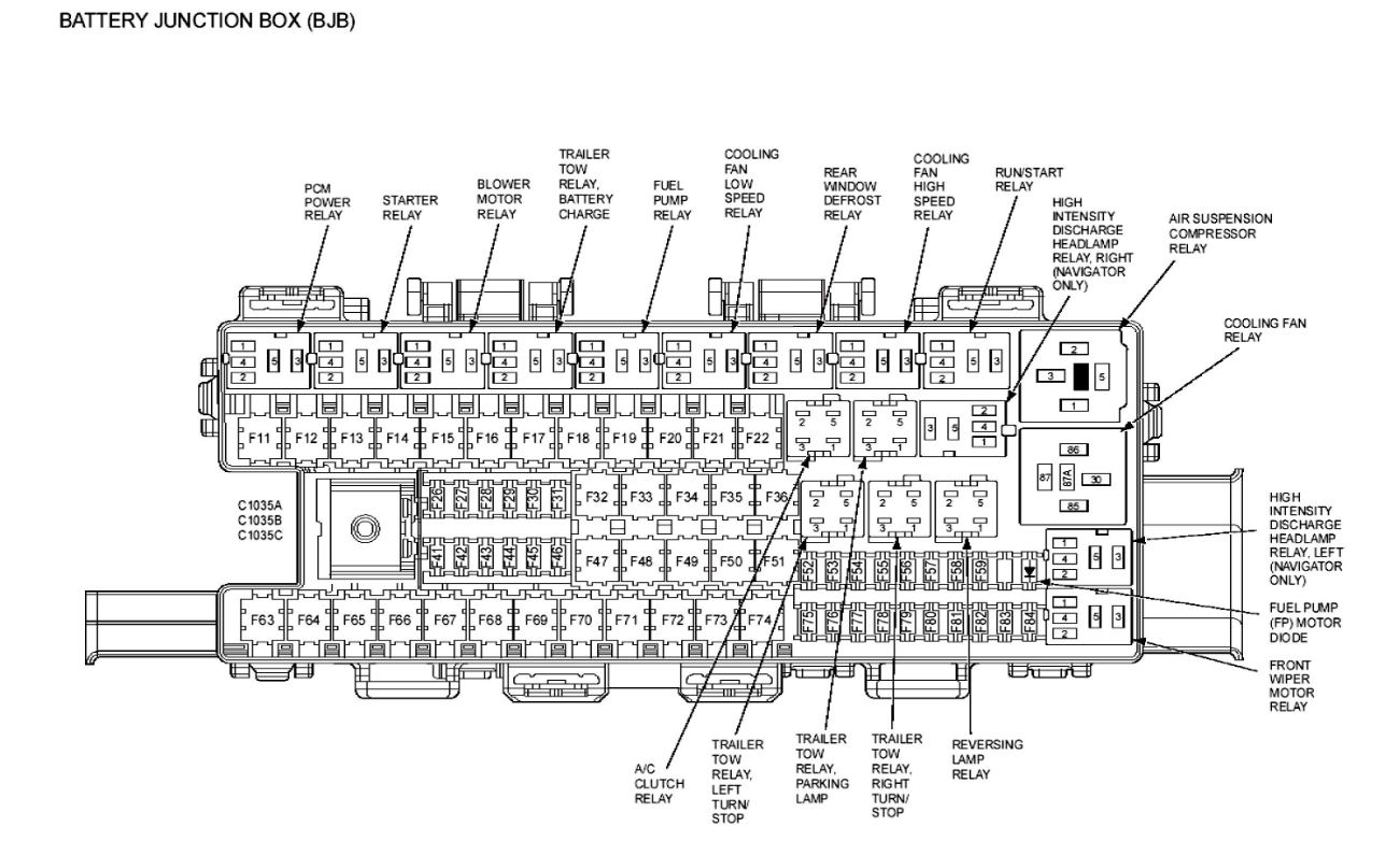

First thing to do is check the fuses, the f32 and f57 both in the battery junction box. Plus f15 and f37 in the smart junction box. Then if all fuses okay, try swapping in or a new blower relay.
Check out the diagrams (Below). Please let us know what you find. We are interested to see what it is.

I had this problem and had to replace the blower relay cost me $34.00.

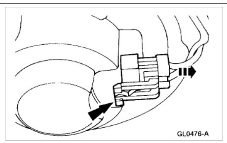

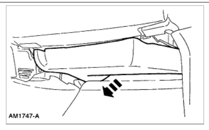

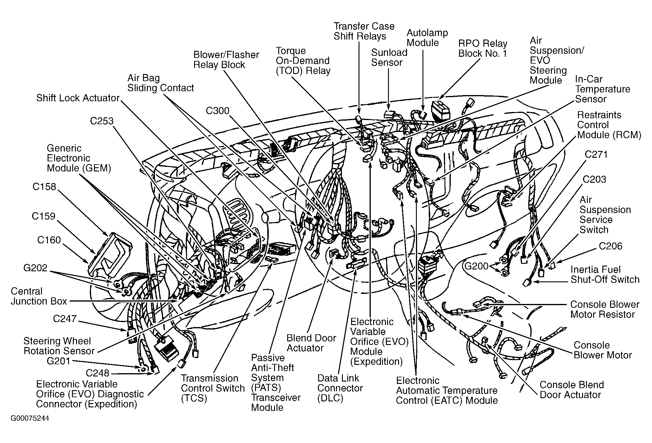

my heater blower dont work in front of my 2001 ford expedition i got a new blower put it in the same help. I went over the train tracks and I had the a/c on. The blower motor stopped working in the front. I got a new blower and its still not working. Would you be able to send me a diagram of the electrical system to the blower assembly with your response.
Jun 25, 2020 at 6:56 AM (Merged)

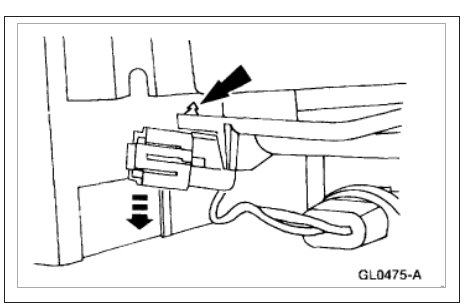

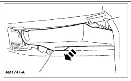

DAN_K
  • 213 POSTS

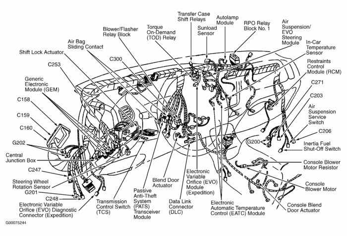

Have you checked the blower motor relay?
I've attached a picture of a component locator. Hope it helps.
RAYRAY16
  • 6 POSTS

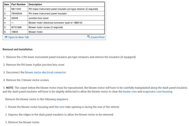

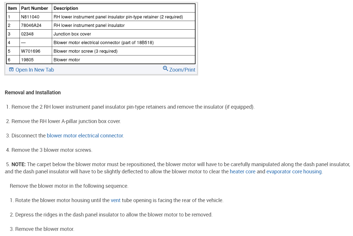

My blower motor does not work in car I can run 12v to it and it will run good but in the car it does not work at all .i look at all the relays and fuse and all is good can that be that the motor is no good .
  • 75,992 POSTS
Yes the blower can be bad here is a guide that will show you how to test and find out whats going on.

RAYRAY16
  • 6 POSTS
Yep the blower motor was bad thanks for the guide it worked perfect.

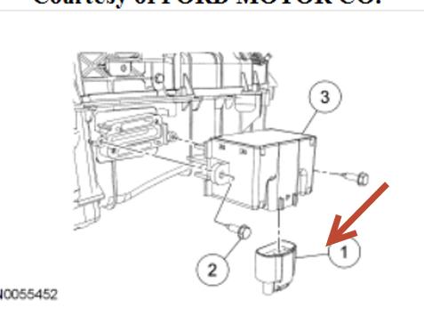

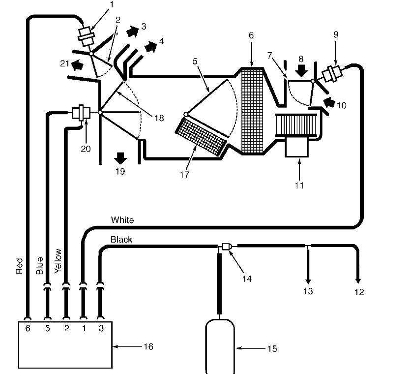

BIGMILO
My front dash vents do not blow any air unless im driving over 35 mph and its a soft air blowing out. i changed the motor and a relay. not sure what to check next.

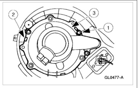

HMAC300
  • 48,601 POSTS
check for a vacuum leak first it may be on your control head or the vacuum motor (item 1 in pic) then if vacuum motor works ok check to see if door is opening (item2) either one may not be. If a leak start from engine and work your way back to control etc.

BOOTDOG
  • 665 POSTS
look under the hood for a power distribution box. it'll have other fuses and relays in there. make sure all your relays and fuses are good, if the problem still exists, then you need to chase the wires from the switch on back. look for broken or pinched wires, loose connections, including loose grounds. hope this helps
