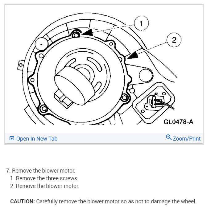

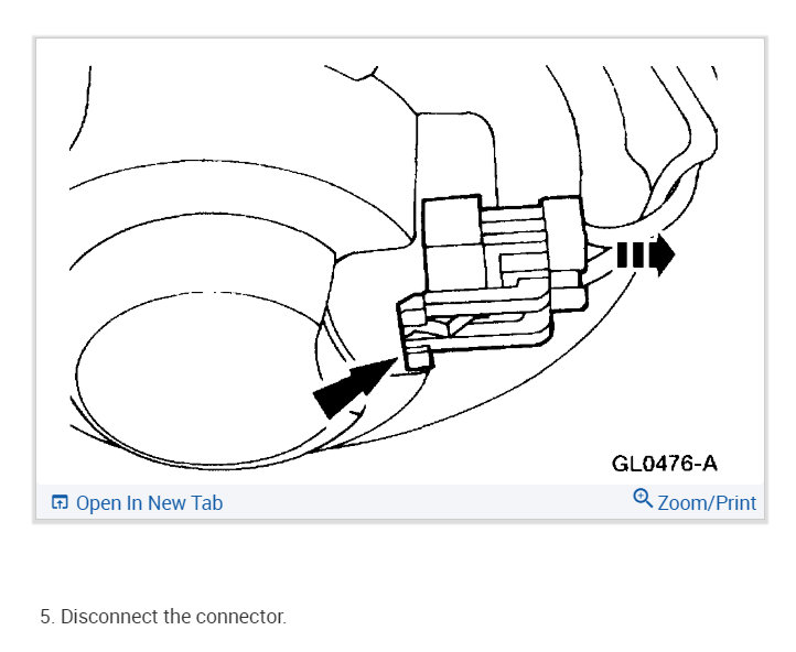

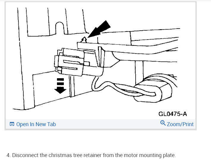

My heater/AC does not blow any air but when I tap on the blower motor that sits behind the glovebox it will work but is noisy. I want to replace this but am not sure how to remove it. I dont see or feel any screws or nuts. Can you please help?

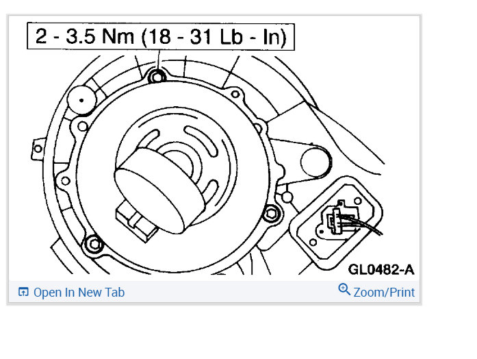

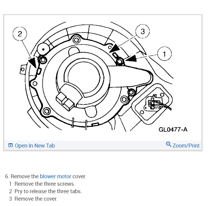

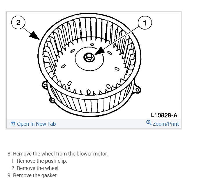

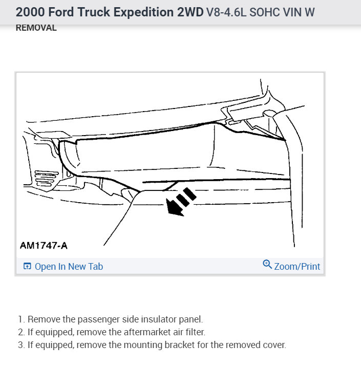

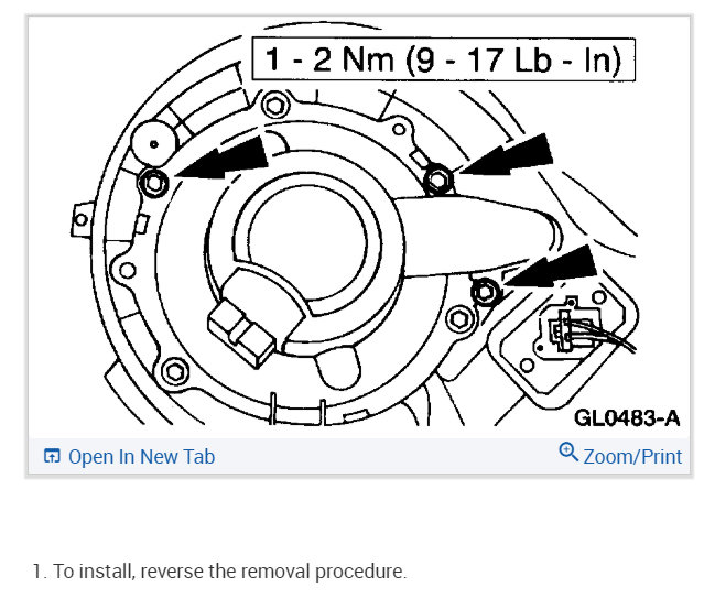

It's under the dash and will require somework to get to it. On 5.4L and 6.8L engines, perform the following: DISCONNECT THE BATTERY AND ALLOW THE CAR TO SIT FOR APROX 10 MINUTES BEFORE STARTING. Disconnect the speed control servo connector. Remove the bolts and remove the speed control servo. Disconnect the connector. Remove the blower motor ventilation tube. WARNING Carefully remove the blower motor so as not to damage the wheel. Remove the screws and remove the blower motor. WARNING: If the wheel is to be reused, clean the corrosion from the shaft end prior to removing the wheel otherwise it may break when removed. Remove the wheel from the blower motor. Remove the push clip. Remove the wheel from the blower motor. Installation is the reverse of the removal procedure. Tighten the blower motor screws. Remove the RH lower instrument panel insulator. For Expedition models: Remove the RH scuff plate. Remove the RH lower A-pillar trim panel. Position the carpet aside. Remove the blower motor, as follows: Disconnect the electrical connector and position the wire harness aside. Remove the screws, then remove the blower motor. Detach the electrical connector (1), remove the screws (2) and remove the blower motor (3) Installation is the reverse of the removal procedure
