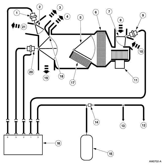

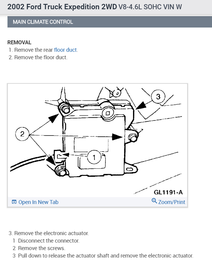

The air only blows through the front defrost vents, the back air works fine. What could that be?
Jun 8, 2016 at 11:52 PM
HMAC300
  • 48,601 POSTS

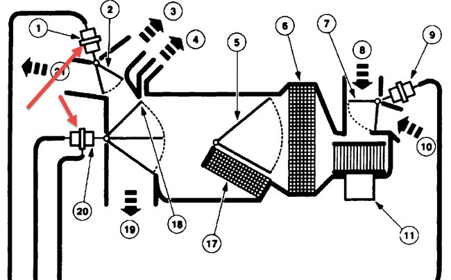

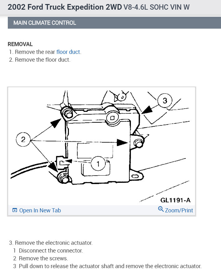

check for a vacuum leak see picture and look at the vacuum motors see if they are getting vacuum when put on defrost/floor etc.. It cold be a bad control as well. Also the main HVAC blend door actuator could be out here are two guides to help with and diagrams below to show you the location on your car.

Thank you. I will let you know what I get. I did look at the lines and did not see any broken or cracked, but I will go out and try to find the motor.
Jun 9, 2016 at 3:05 AM
HMAC300
  • 48,601 POSTS
see if the motor gets vacuum, it may have easier access from driver's side.

Okay sir I see the motor now how do see if it is vacuuming?
Jun 9, 2016 at 5:56 AM
HMAC300
  • 48,601 POSTS
turn the air conditioner on or what ever is not working and pull line off and put your finger over it to see if it has vacuum if it does then reinstall line to see if vacuum motor will move the door.

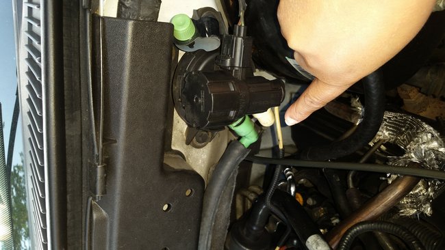

Okay i turned the air conditioner on max and I pulled this line off (skinny yellow one) and it has really good suction (vacuum) I also put it on defrost and still really good suction. Still no air coming through vents only defrost vents on top of dash.
Jun 9, 2016 at 9:21 AM
HMAC300
  • 48,601 POSTS
Make sure to see if the vacuum motor is working the linkage or it may be a broken door and not moving.

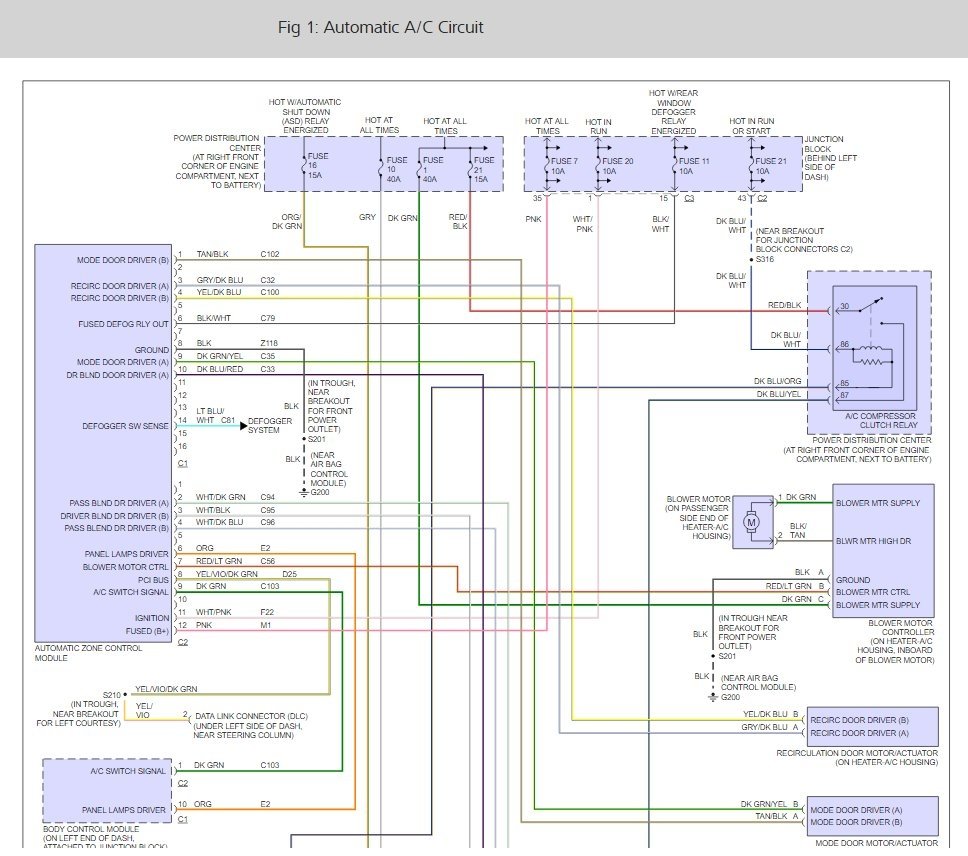

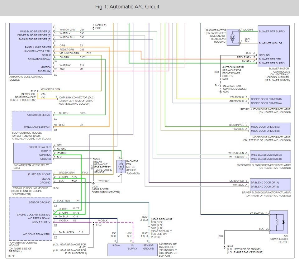

I have a 2003 Grand Cherokee Laredo. The air conditioner blows cold air but switches from front vent 2 floor 2 defrost vent simultaneously. None stay on very long they just keep switching back and forth. Do I need to get AC checked or what?
Jun 17, 2017 at 11:42 PM
  • 55,766 POSTS
This sounds like a problem with the automatic zone control has gone bad and needs to be replaced. Here is a wiring diagram (below) so you can see how it is wired.
It might be good to check the ground wires for the system and the fuses.
and
Please let us know what happens, we are interested to see what it is.

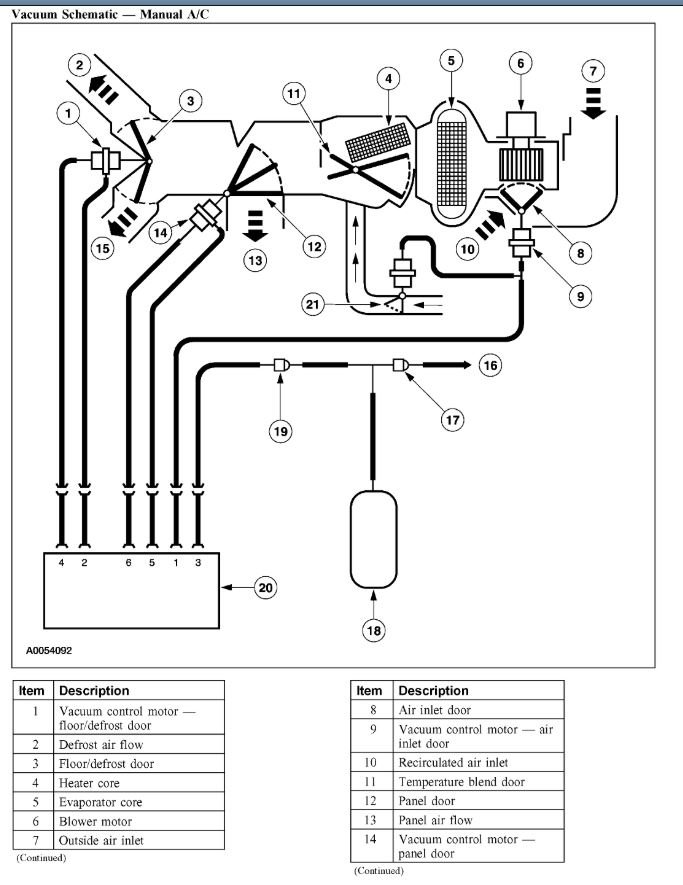

In default mode controls are vacuum operated may have lost vacuum check reservoir under battery see if hose connected and holding vacuum. if good maybe master select switch or servo faulty.Removal of control panel is needed to check operation of master switch. if servo instrument panel removal maybe needed.
Hope this helps
Heres a couple guides for you to read, they will help
https://www.2carpros.com/articles/low-or-no-air-flow-from-vents
https://www.2carpros.com/articles/air-vents-stay-in-the-defrost-position
Attached below you will find the vacuum diagram and actuator locations for you HVAC system

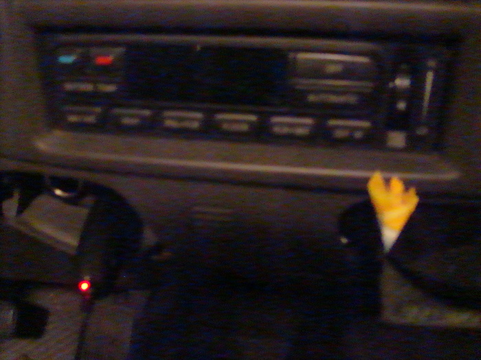

Not getting air out of the front or back vents, only from the defrost vents.
Mar 27, 2019 at 10:36 AM (Merged)
BMRFIXIT
  • 19,053 POSTS
check vacuum
Item Part Number Description
1 18A318 Vacuum Control motor — panel/defrost door
2 18A478 Panel/Defrost door (full vacuum position)
3 — Defrost airflow
4 — Side window demister airflow
5 18B545 Temperature blend door (full heat position)
6 19860 A/C evaporator core
7 19A813 Air inlet duct door (full vacuum position)
8 — Outside air inlet
9 18A318 Vacuum control motor — air inlet duct door
10 — Recirculated air inlet
11 19805 Blower motor
12 — Vacuum to emission control
13 — Vacuum from the engine intake manifold
14 19A563 A/C vacuum check valve
15 19A566 A/C vacuum reservoir tank and bracket
16 19B888 A/C-heater function selector switch
17 18476 Heater core
18 18A559 Floor/panel door (full vacuum position)
19 — Floor airflow
20 18A318 Vacuum control motor — floor/panel door
21 — Panel vent airflow
