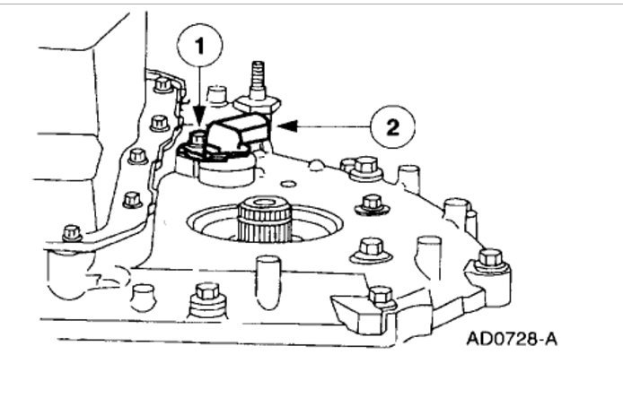

It sounds like you have a vehicle speed sensor that has gone out and needs replacement. You will need to jack the car up to replace it.
Here is a VSS location diagram (below) for the sensor you may find it on Amazon or Rockauto

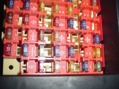

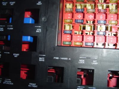

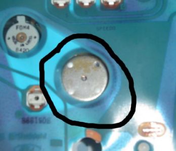

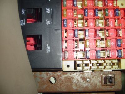

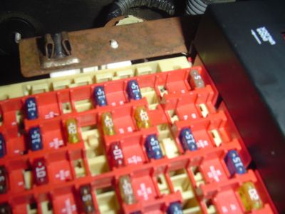

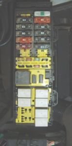

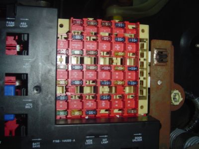

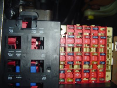

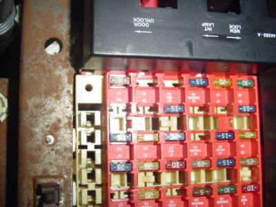

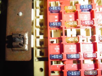

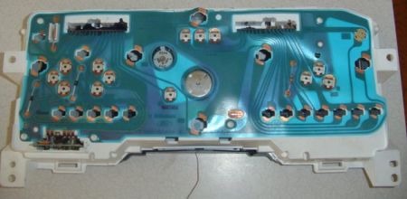

SCOTRIANI
  • 11 POSTS
OK - first thing, no fuse at 35 - owner's manual shows it as not used. There is a fuse (15A) at 25 that is OK. So then I checked the cluster connections and I have voltage on all of the right places and a good ground on it. Here is a pic of the back of the cluster that I removed...
https://images.2carpros.com/forum/automotive_pictures/79456_DSC02308_1.jpg
And a closeup of where I think the speedo cable should be:
https://images.2carpros.com/forum/automotive_pictures/79456_DSC02310_1.jpg
My concern is that I don't see any evidence that a cable used to be in there... but I looked at the back of a digital cluster from a 97 and the connections seem different than the two clips I have there. Any thoughts?
Jun 5, 2017 at 10:04 AM (Merged)
SCOTRIANI
  • 11 POSTS
Build date 6/98... engine 3.8L v6

SCOTRIANI
  • 11 POSTS
F78F-10C956 - B
That looks like the part number (right on the PCB)
As far as an accident... I bought the van used. No serious accidents from what I could tell. It does look like at one point there was a minor front end impact which required a replace and respray of the front bumper.

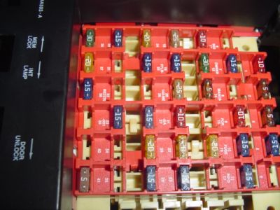

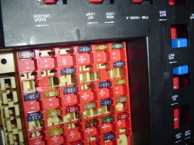

SCOTRIANI
  • 11 POSTS
https://images.2carpros.com/forum/automotive_pictures/79456_DSC02313_1.jpg
https://images.2carpros.com/forum/automotive_pictures/79456_DSC02314_1.jpg
https://images.2carpros.com/forum/automotive_pictures/79456_DSC02315_1.jpg
SCOTRIANI
  • 11 POSTS
It's hard getting a clear picture... all of these were taken with the camera sitting on the floor so I can't get a good wide angle. I hope these help. If not, let me know more specifically what you're looking for and I can see what I can do. Thanks!

SCOTRIANI
  • 11 POSTS
Wow... OK - so that worked. I have no idea why because my chilton's book, my alldata, and my haynes as well as the owner's manual mention 35 as not used. So, now can I ask what that fuse controls so I can make a note in my stuff?
On a side note, you have no idea how relieved I am. I have been messing with this for three days. Four different Ford dealers have told me that I needed a speedo cable, needed to replace the VSS (even though I was getting speed info from the computer), and needed to replace the cluster with a new one. I did replace the cluster (boneyard part) because the last one looked pretty bad (black tar type substance in it) but I have been at wits end and testing each connection, etc.
:D
