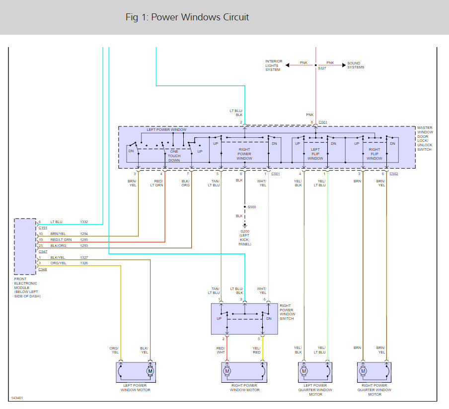

Passenger side window does not work. All the other windows work. What should I check? Where can I get an electrical diagram?
Apr 20, 2010 at 12:19 PM
  • 110,194 POSTS
I would start by checking for power to the P/W motor. If there is no power, move to the switch to see if power is there...

Yes here is the power window wiring diagram and a guide to help you do some testing in case you need it.

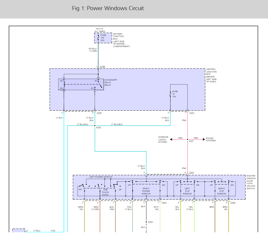

power window will not operate. i hear a clicking sound under dash when switch is operated. this began last summer. window would operate when outside temperature approached 70 degrees. nothing all fall and winter. recently on the warmest day this year it began operating, only to stop as it has cooled off. forecast is for 70+ weather next week. i have my fingers crossed. i'm not making this up.
Jan 8, 2018 at 1:57 PM (Merged)
  • 110,194 POSTS
It sounds like either a bad relay or the motor itself is bad. Have you checked to see if the motor is getting power? Have you tried switching out the relay with a known good one?

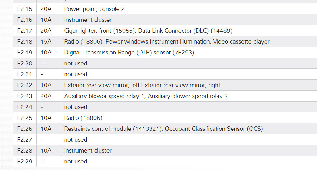

Power windows don't work as well as the radio, Ac, Blowers and Gauges. Checked all fuses I think seem ok! Fred
Jun 6, 2019 at 2:57 PM (Merged)

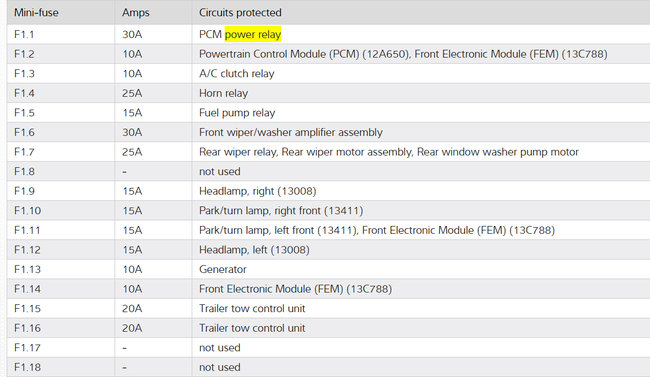

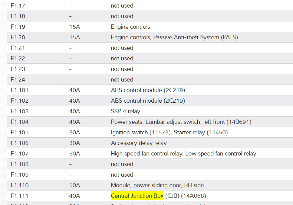

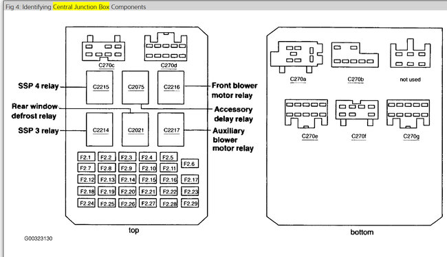

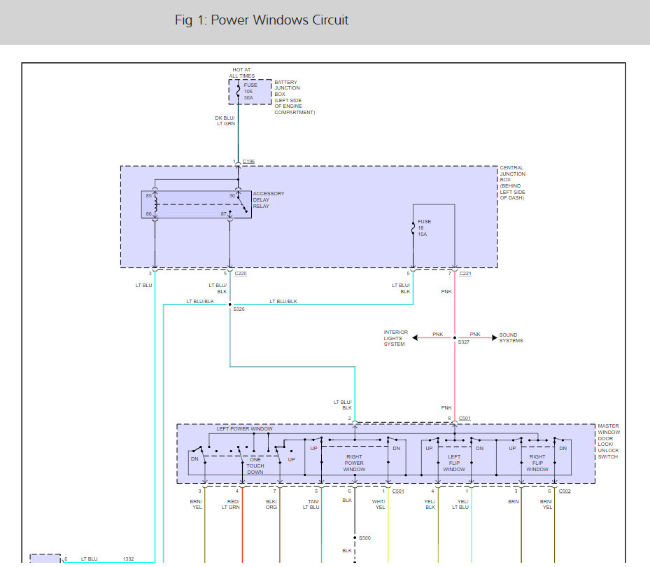

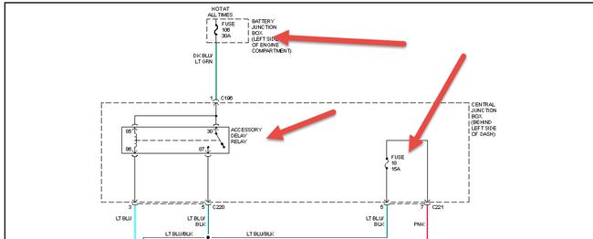

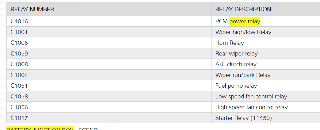

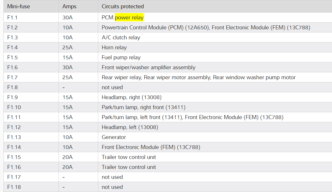

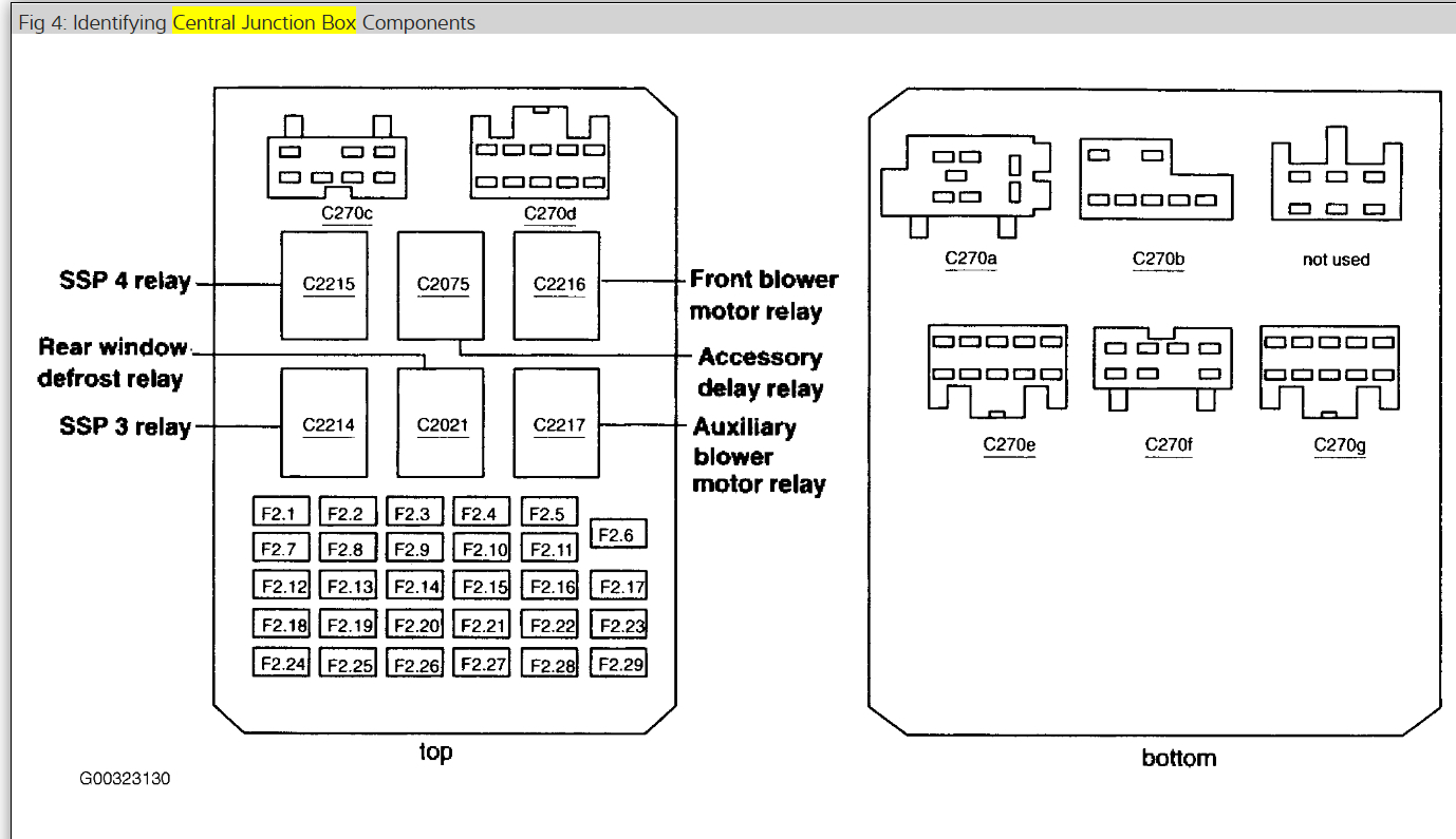

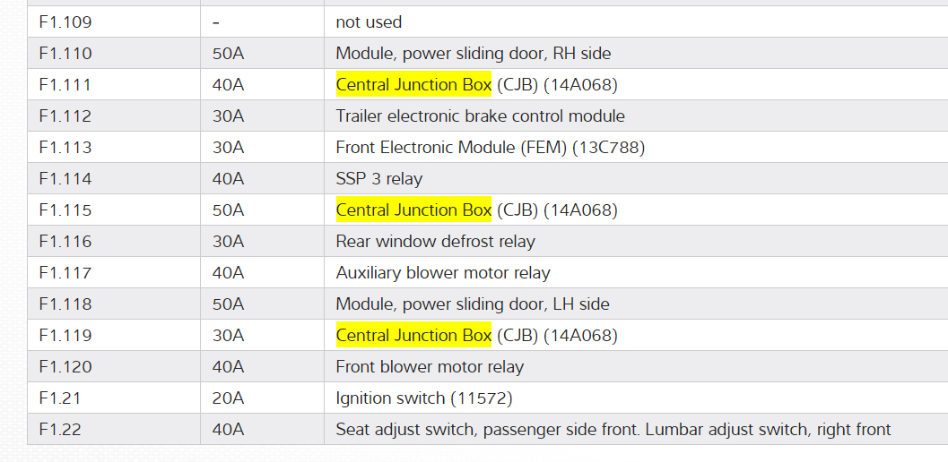

WRENCHTECH
  • 20,761 POSTS
This sounds like the accessory delay relay is bad which is common here is the location so you can change it out with a guide to confirm the failure.
Check out the diagrams (Below). Please let us know what you find. We are interested to see what it is.
FREDALS

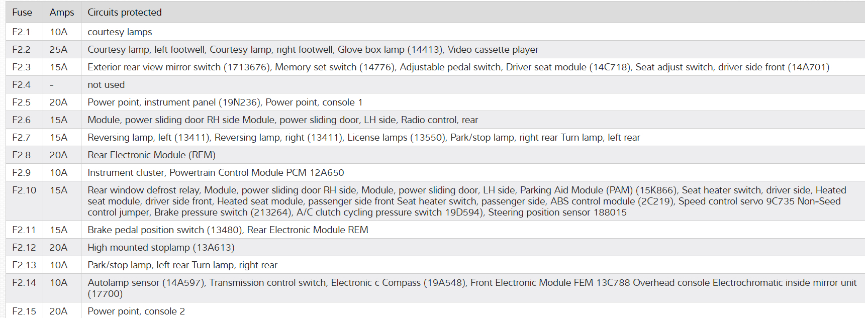

Checked both sides of fuses all have power! All the inside lights work and so do the power supplies or cigarette lighter Fred
WRENCHTECH
  • 20,761 POSTS
Yep, I would check the relay can you find it?
FREDALS
Yep you nailed it, I got a new relay and plugged it in and BAM all fixed, I love this site.

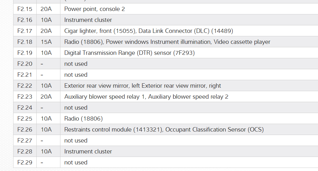

push buttons for auto windows and they dont go down or up checked the fuses and still not working
Jun 6, 2019 at 2:58 PM (Merged)
HMAC300
  • 48,601 POSTS
I tmay be the switch for it check items in pic then have it scanned because it may be the front electronic module
