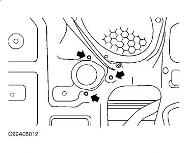

THE DRIVERS SIDE FRONT WINDOW IS NOT WORKING ON MY 2001 FORD WINDSTAR LX. HOW DO I TELL IF IT IS THE MOTOR AND/OR THE REGULATOR HAS FAILED? FUSES ARE GOOD.

FRONT DOOR WINDOW REGULATOR MOTOR WARNING:Window regulator motor has counterbalanced spring. Window must be up to remove motor or blocked to prevent window from suddenly raising. Failure to follow these instructions may result in personal injury. NOTE:Check interior of door, ensure front window regulator wiring is not in line with holes to be drilled into door inner panel. Removal & Installation Remove front door trim panel and water shield. Disconnect window regulator motor harness connector. Using 1/2-inch drill bit, drill out drill dimples located opposite of unexposed window regulator motor retaining screws. See Fig. 15 . Remove 3 bolts retaining window regulator motor to regulator and remove motor. To install, reverse removal procedure. Fig. 15: Front Door Window Regulator Motor Drill Locations
https://images.2carpros.com/forum/automotive_pictures/266999_win_1.jpg
