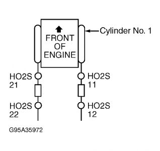

BMRFIXIT
  • 19,053 POSTS
https://www.2carpros.com/forum/automotive_pictures/99387_02_V6_8.jpg
you need to clear the codes
you can do so by disconnecting the battery
then drive car for good 50 to 100 miles
2 ,3 ,4 days what every it take
and or till check engine light return on
then scan for codes and fix what you have for codes
since you have a slow o2 sensor I would do that before the catalytic converter
replace both sensors before and after the cat .
Friday, July 17th, 2020 AT 10:16 AM (Merged)
