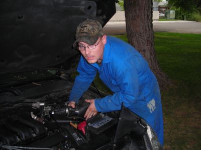

JTHORUSEN
I have a 2001 Ford Taurus with 68,000 miles on it's 3.0 DOHC motor and about a month ago it started to get hard to start. Since then it has begun to rev to about 2,000 rpm when first started then idles badly between 500 and 800 rpm. It sputters and lurches when in drive with the brake pushed to the floor. It only does this when it is cold outside or if the motor it cold. The check engine light only recently came on and the code says banks 1 & 2 running lean. I have replaced all spark plugs, the mass air flow sensor and I am about ready to give up. I don't have a ton of money to get a diagnostics test done as my wife is due any day with our first child and I am working two jobs. Please help me figure this out. I just got back from having the check engine light read again, here are the results: TPS/Pedal position sensor, switch "A" circuit low input (P0122), System too lean bank 1 (P0171), System too lean bank 2 (P0174), Cylinder 3 misfire detected (P0303) Hopefully this might help someone with more experience than me.
https://images.2carpros.com/forum/automotive_pictures/102227_DSCN0391_1.jpg

BMRFIXIT
  • 19,053 POSTS
You have vacuum leak most likely the intake manifold gasket
