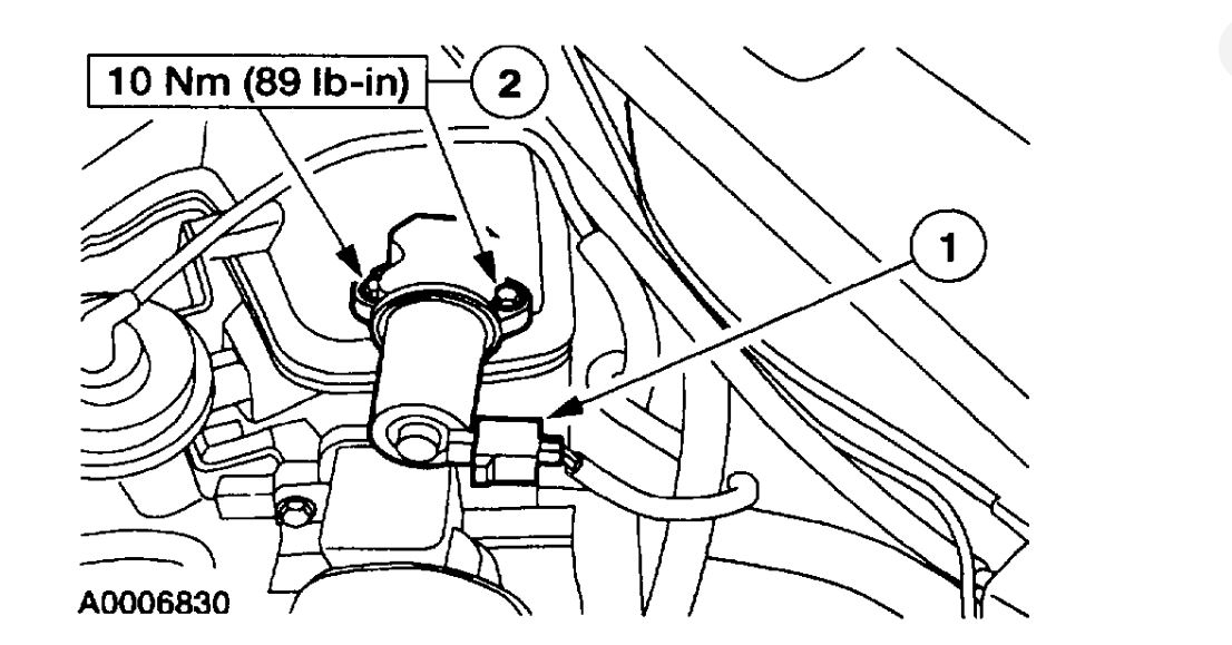

Disconnect the battery cables and short them together, that will clear all learned data from the ECM.
Then try a test, Disconnect the IAC and see if the idle drops.
If it idles down and the throttle responds when you pull the IAC connector off, verify that you have the correct IAC valve, there are a couple out there that are supposed to be correct but actually are the wrong part. One with a brass insert and spring and one with no insert. You want the one without the insert.

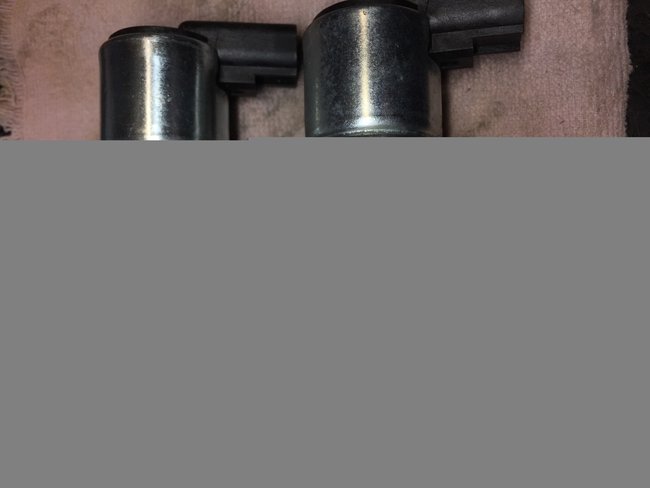

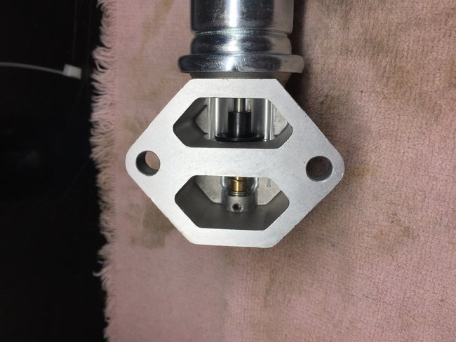

The brass insert is inside the valve opening. The issue is that there are two 3 liter engines, used and the valves will physically interchange. Then there are two different designs of one of the valves as well.

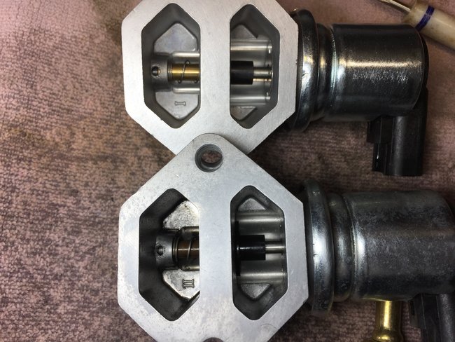

DAVID JIMENEZ2
  • 16 POSTS

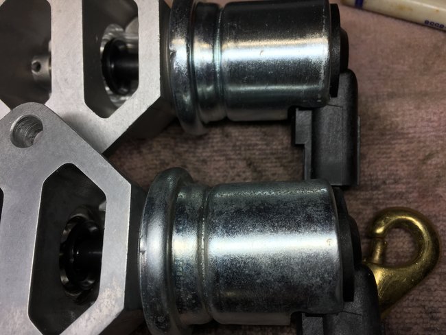

Here is a side by side comparison after cleaning the one without the brass.
Aug 21, 2020 at 1:55 PM (Merged)

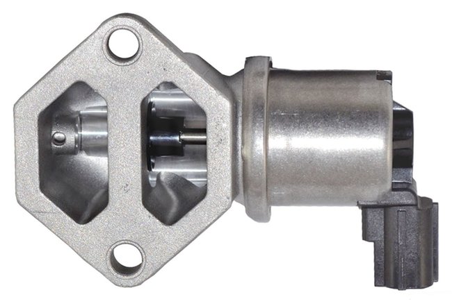

STEVE W.
  • 15,200 POSTS
There is the problem; Both of those are the other design with the spring loaded valve.
This is what it should look like. Notice no spring or bushing. Ford # 1F1E-9F715BA
When it is at idle that valve stays really close to closed with the ECM sending a pulsed signal to it to open it sort of like this (Closed = _ open = ^) __^__^__^__^^^__^^^^__ ). The more "open" pulses the more air the valve lets in and the idle goes up.
In your case the spring is holding the valve open and the ECM still pulses the valve once you let off but with the spring there the valve isn't actually closing until the constant pulse from the ECM sort of hammers the valve closed.
I would be very tempted to visit the parts store, buy a new one, open the box to verify it is correct, bring it home. Then take a pair of needle nose pliers and remove the spring on the current valve, put it back on and see if the sticky throttle goes away. I am betting it does. Then return the new part for a refund.
Once you get the valve fixed, reset the idle to correct spec and you should be good.
Then you can be like the rest of the mechanics in the world when you discover that the "right part" is sometimes the wrong part, thanks to a minor revision, or an "improved" part that is not.

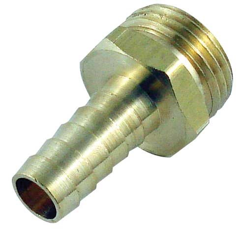

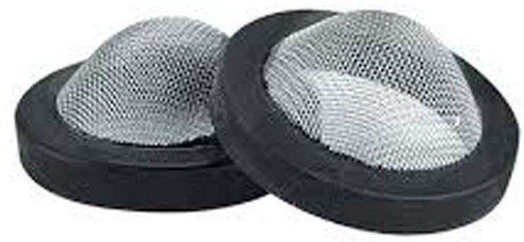

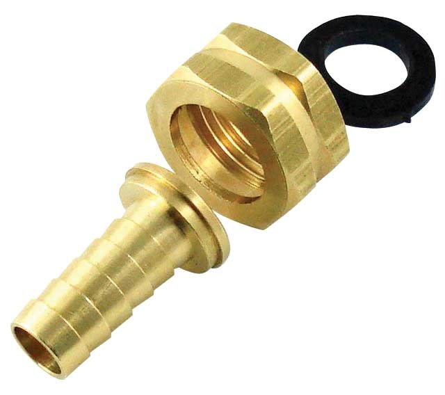

Oh, forgot the heater core issue. A way to fix that is to clamp off the heater lines, remove them, flush the core both ways, then install a coolant filter in the line that sends coolant to the heater. There are a few out there. I like the cheap way myself. Get a set of solid brass garden hose ends (male and female) in 1/2" or 5/8" (to match the heater hose size) and a few of the filter screens like you put in a pressure washer hose. Add those to the line with a couple good clamps. They will catch the larger crud that likes to block the core. For folks who want the ready made version google
RF002 - Universal Heater Core Coolant Filter Set
Or you can get the "fancy" version from these folks.
http://www.ganofilters.com/
One other option I did on another vehicle is to install the fittings in both lines. (one set reversed from the other) This allows the option of bypassing the core if it starts leaking and you can easily flush the core or cooling system in both directions with a garden hose.

When you do the flush, do it in the reverse of the way the water flows through it. I made a core flushing machine because I got really fed up with heater cores.

The new OEM IAC works great! Just need back off the throttle stop screw a little bit (it's nearly flush now}, as the deceleration is still a little too sluggish for my likes.
Aug 21, 2020 at 1:56 PM (Merged)
STEVE W.
  • 15,200 POSTS
Do another battery cable ECM reset with the new valve. It will need to re-learn the idle characteristics of the new valve.

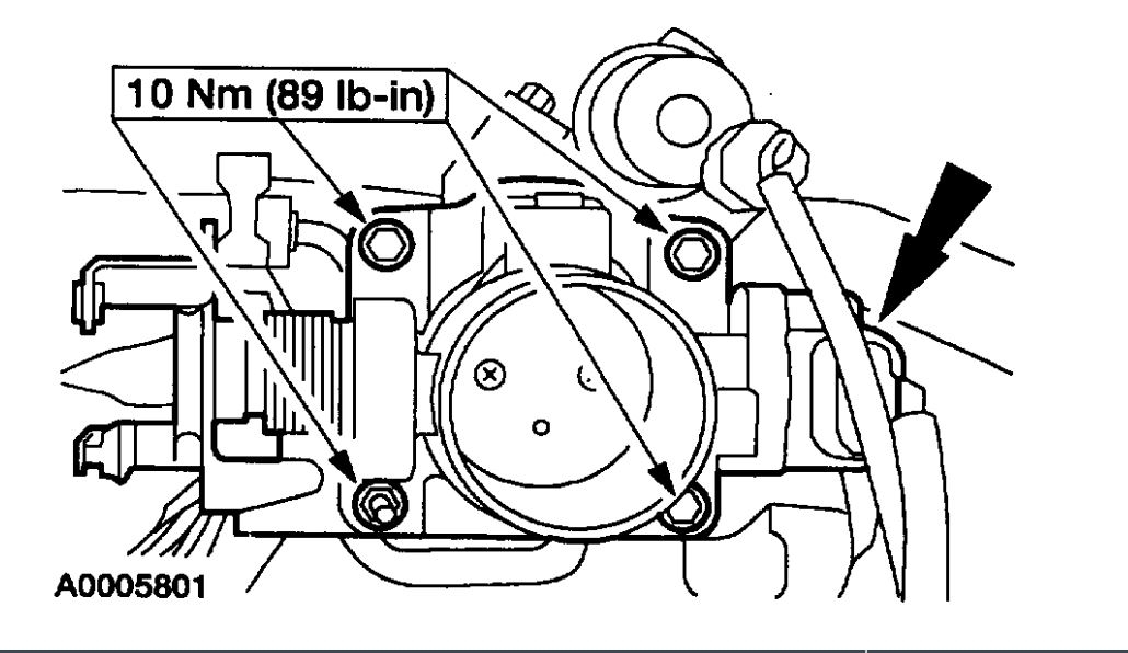

OK, So maybe I spoke too soon. The idle is fine, but when I take my foot off the gas when in gear going down the road, the car still doesn't slow down immediately like it should. It does start to slow down, but it really takes its time. I have a scan tool hooked up and am looking at the TPS reading and it goes back to 16.1% (closed throttle) when I let off the gas. There is no dead spots and it seems to read smoothly throughout the travel. I checked at parked idle closed throttle and it reads 16.1%. Is this normal? Shouldn't it read closer to 0%, as I have the throttle stop screw backed almost entirely out of the threads. I understand that when I put the TPS on, I have to tilt it into position and back down again so that the lobes mesh properly, so there may be a greater than 0% reading due to that. I just thought the ECM would adjust for that after an ECM reset and display a "corrected" % reading to show a more usable reading to the scan tool, but maybe not.... Any ideas? I can't seem to find any other vacuum leaks that may cause the excessively slow return to closed throttle speeds. Thanks!!
STEVE W.
  • 15,200 POSTS
TPS should read lower than 16% at idle. Sounds like it's a bit out of adjustment.
You won't see 0% because the sensor always passes some voltage even at fully closed throttle but 5% or so is about normal with a vehicle that has an IAC valve.
