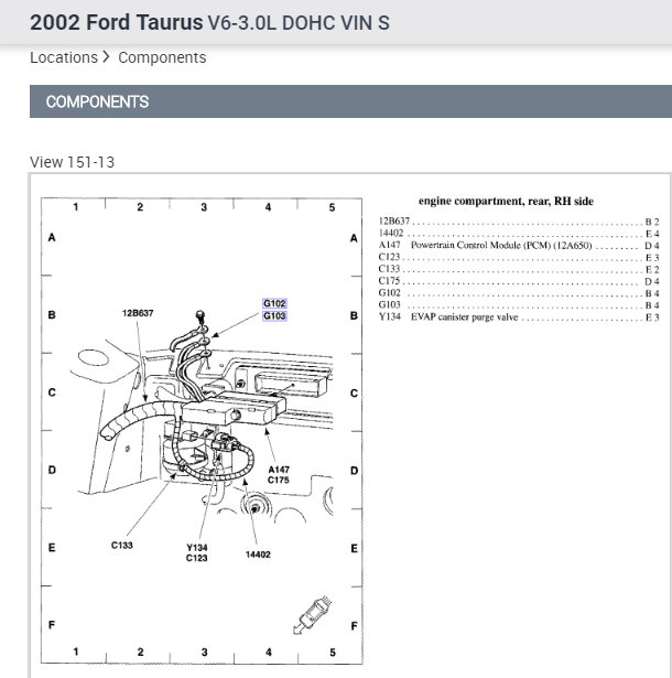

SBABYGIRL
It got into a wreck almost two years ago so it's been sitting in my yard since. I
recently have been driving it for the past week. I noticed when I first drove it a really bad gas smell. Then I started noticing it trying to jerk while going into gear on the highway. My foot would get warm through my shoe while accelerating. Two days ago I stopped driving it because it got to where it won't go past 20 mph or go past first gear. I checked the diagnostics and one code popped up for p1633. I have put on a new camshaft sensor, new fuel line, and new fuel filter. Could anyone tell me what could be wrong with my car?
Aug 22, 2020 at 2:53 AM (Merged)
DANNY L
  • 5,648 POSTS
Hello, I'm Danny.
I've attached two pictures below of what to have checked and the PCM location with description. Hope this helps and thanks for using 2CarPros.
Danny-
