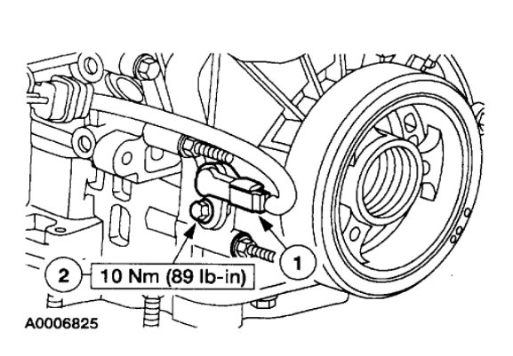

I have the car listed above and I took it to AutoZone and had it put on the code because the check engine light was on and it was running rough. It came back as a bad crank sensor. Would that make the car run rough and if I change the sensor will it stop running rough?
Monday, November 9th, 2009 AT 2:14 PM
DANNY L
  • 5,648 POSTS
Hello, I'm Danny.

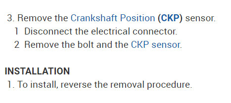

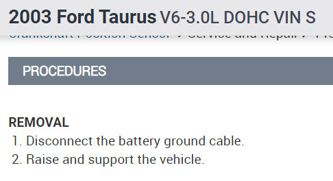

Yes, a faulty crankshaft position would cause your car to run roughly and turn the check engine light on. Here are tutorials showing operation, testing, and replacement:
https://www.2carpros.com/articles/how-a-crank-shaft-angle-sensor-works
I've attached picture steps below for the replacement of the crankshaft position sensor on your car. Hope this helps and thanks for using 2CarPros.
