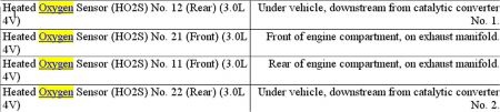

The price for the O2 sensor replacement sounds reasonable. Keep in mind your paying for not only labor and parts but an additional mark up on the part by the shop...Which is necessary for them to sta in business. IF your going after them, the front two would be the ones I would expect.
You'll need an oxygen sensor socket to replace them. Without knowing you and your capabilities or having the car in front of me I don't know how easy this would be for you. You'll certainly stand to save a fair amount of money if you can.
DON'T BUY UNIVERSAL SENSORS.
https://www.2carpros.com/forum/automotive_pictures/30961_o2loc_1.jpg
The O2 sensors produce a waveform pattern that can be evaluated with a quality scan tool, if the shop did this on their recommendation of the sensors replacement, then it would be a fair guess.
