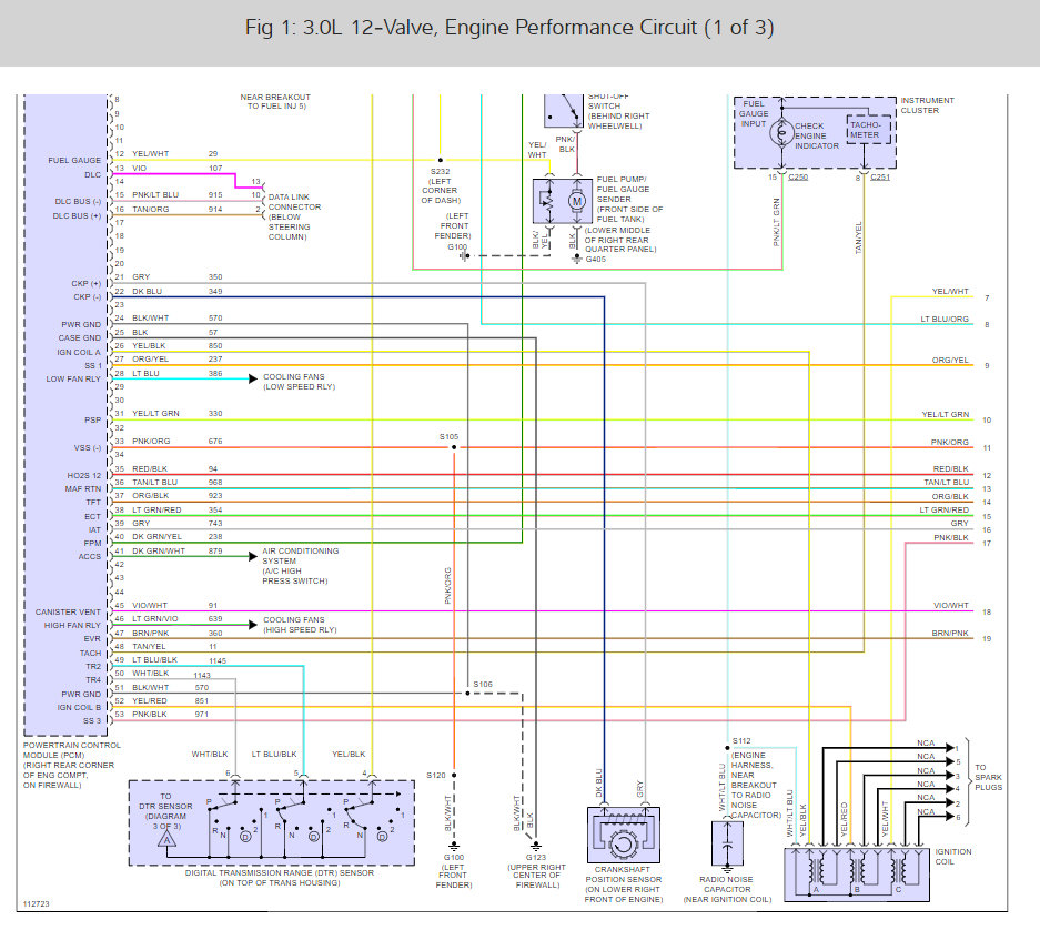

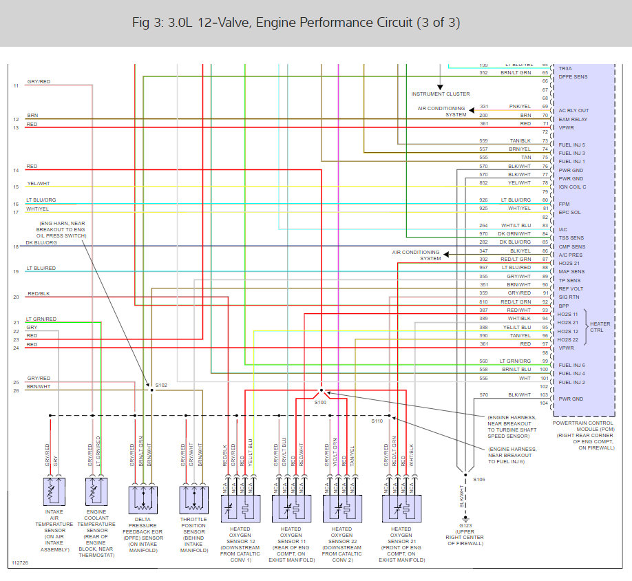

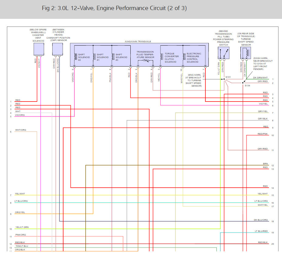

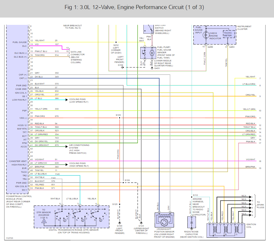

I have a 99 Taurus, w/3.0l overhaed valve (U code).
The engine turns over fine yet i have no spark wile the engine is cranking over, there is a quick spark after letting the key ruturn to the run position. I have replaced the coil pack (old one showed low resistance for all 3 secondary windings), ignition switch, CKP, CMP and MAF sensors, as well as the PCM pre-calibrated (AA). The car Does not have a PATS or RAP module. I have been checking for bad wires at this point, I started with the main power and grounds to the PCM, in hopes that during the crank cycle I would loose power or ground, I'm not all main, memory power and grounds are strong. The car was sent to a local garage (for 3 weeks) they couldn't figure it out, I have had it for 4 weeks.
ANY HELP????
Dec 3, 2007 at 5:14 PM
2CARPRO JACK
  • 11,533 POSTS

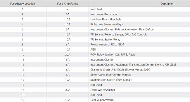

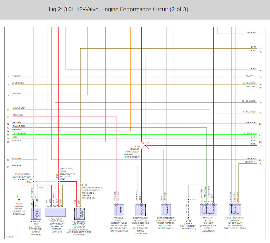

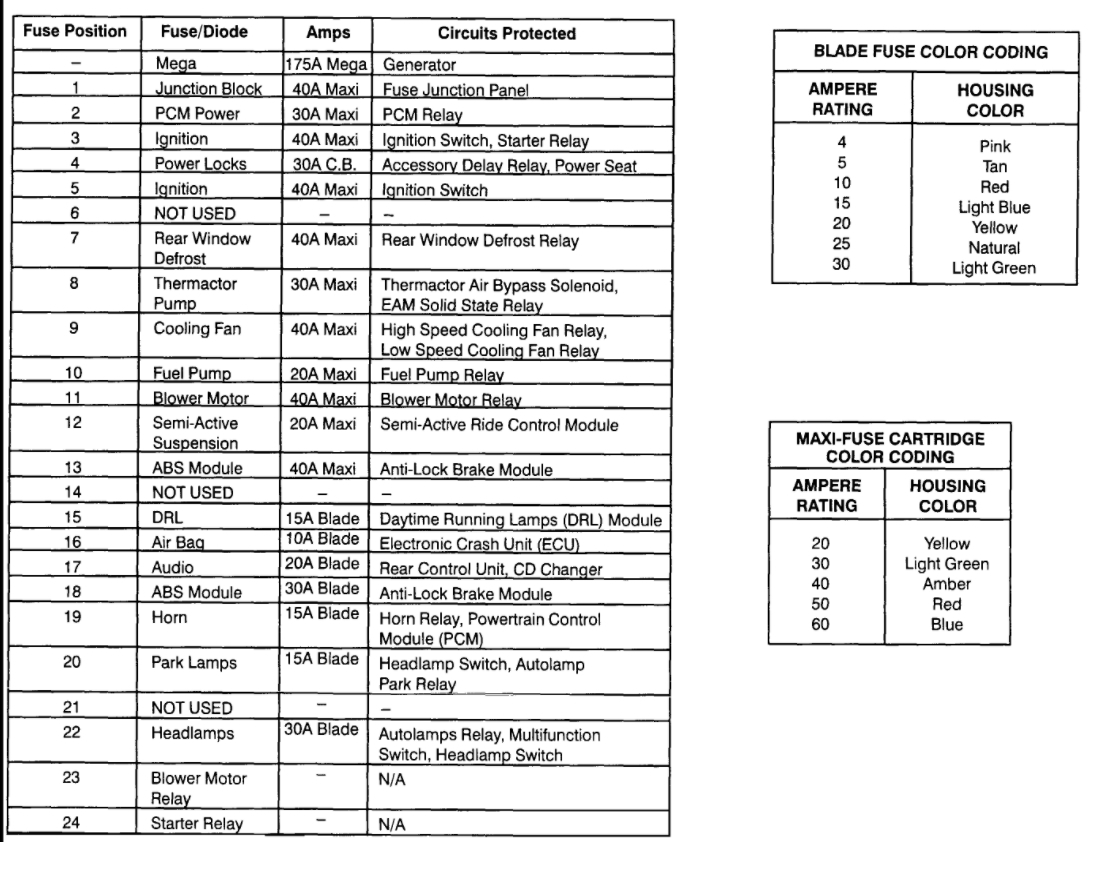

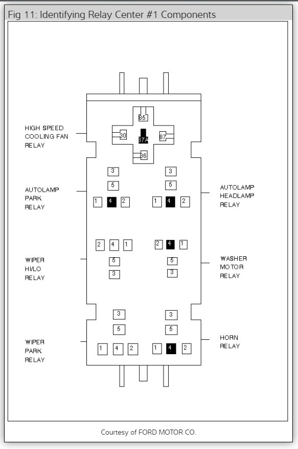

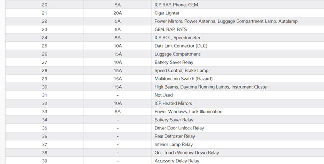

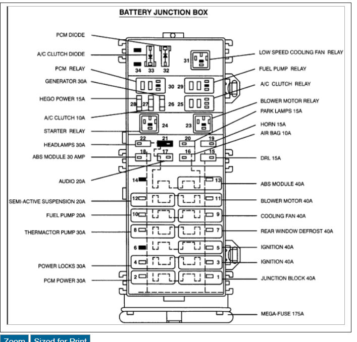

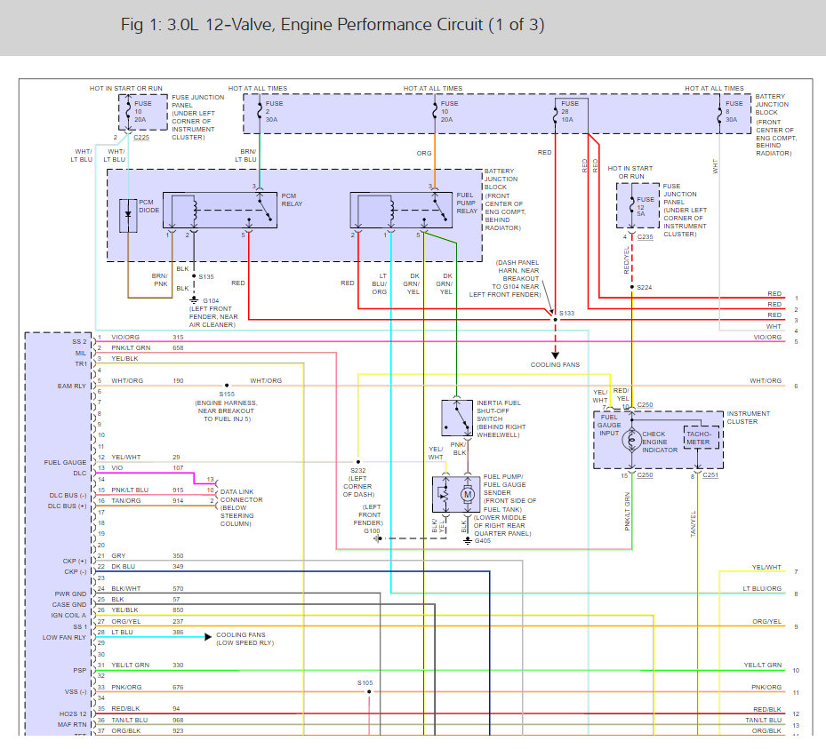

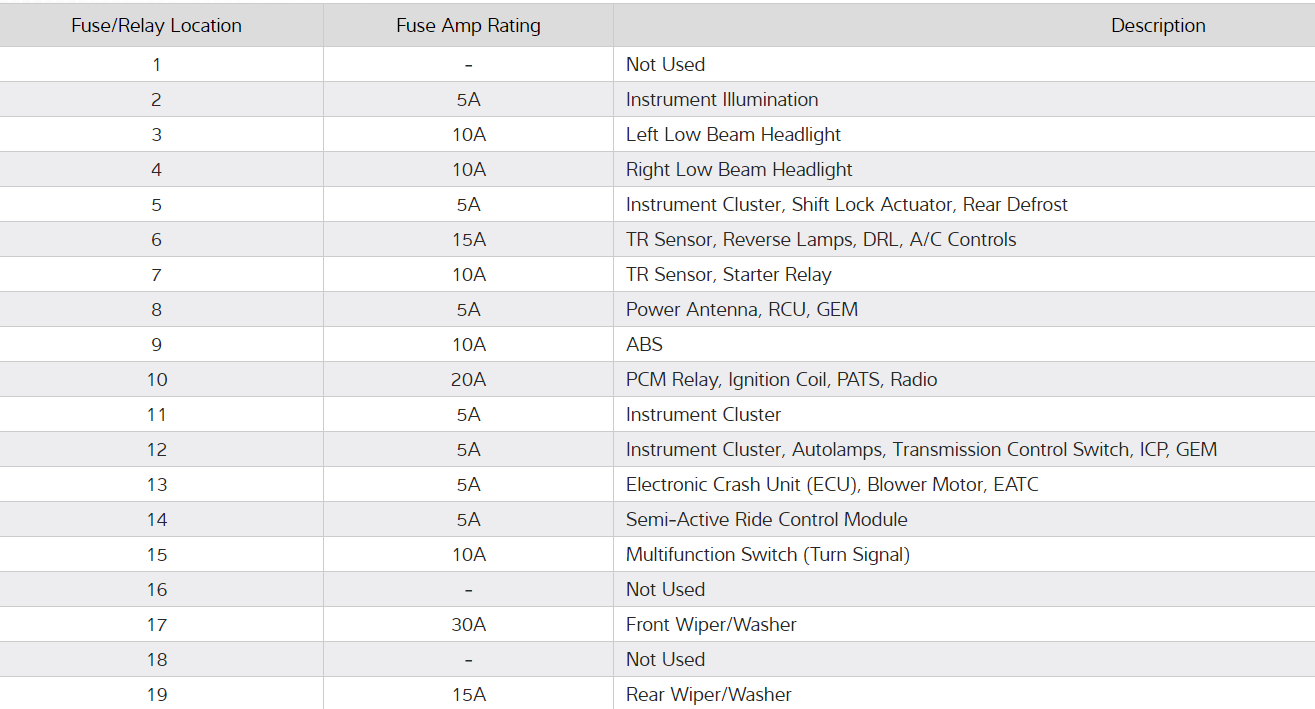

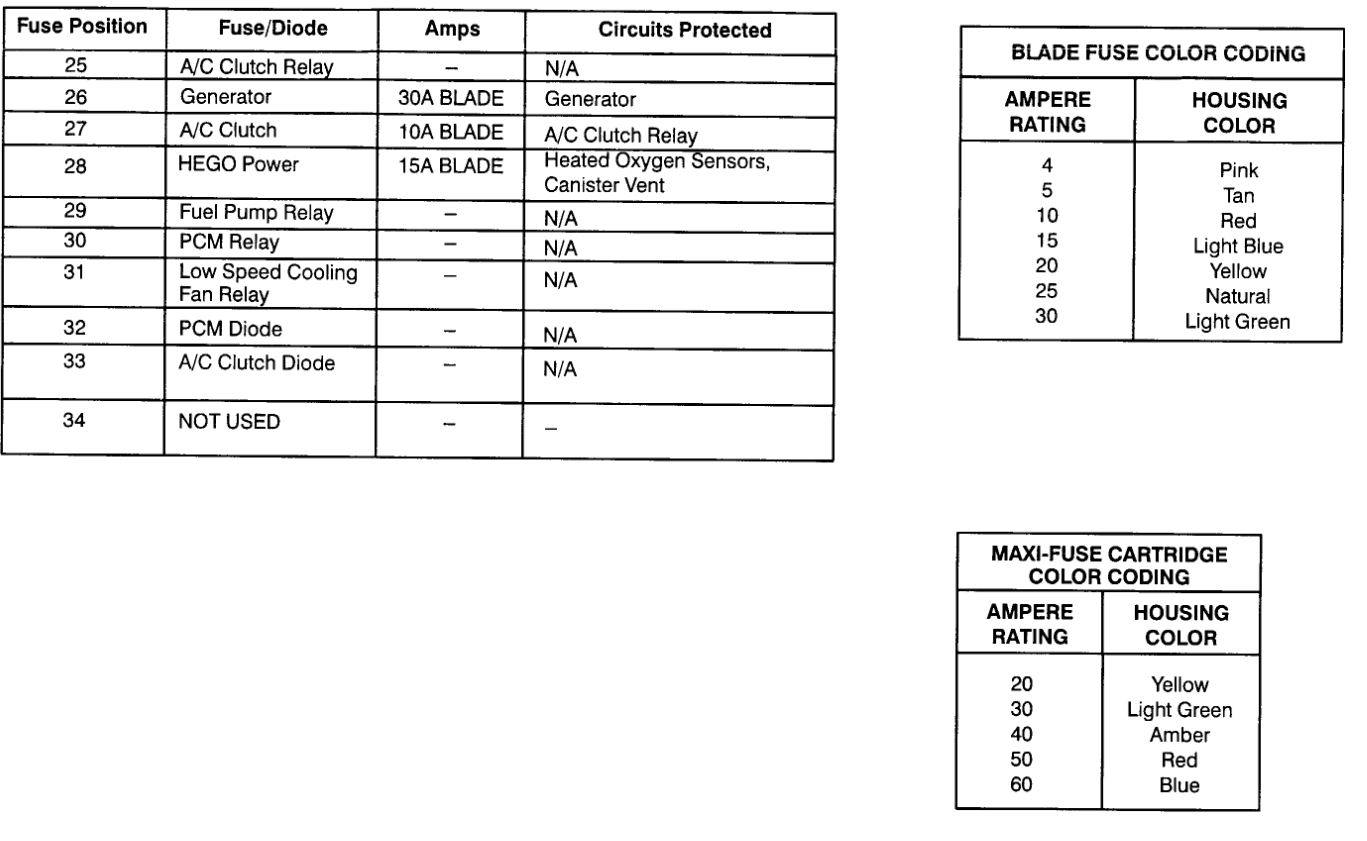

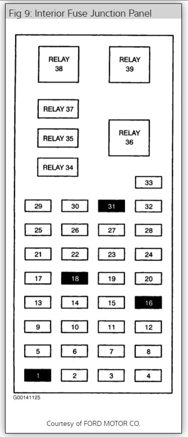

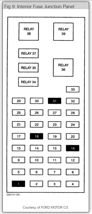

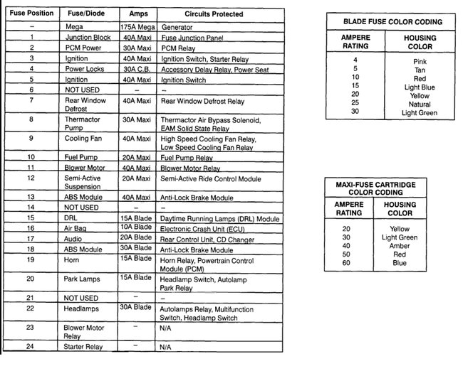

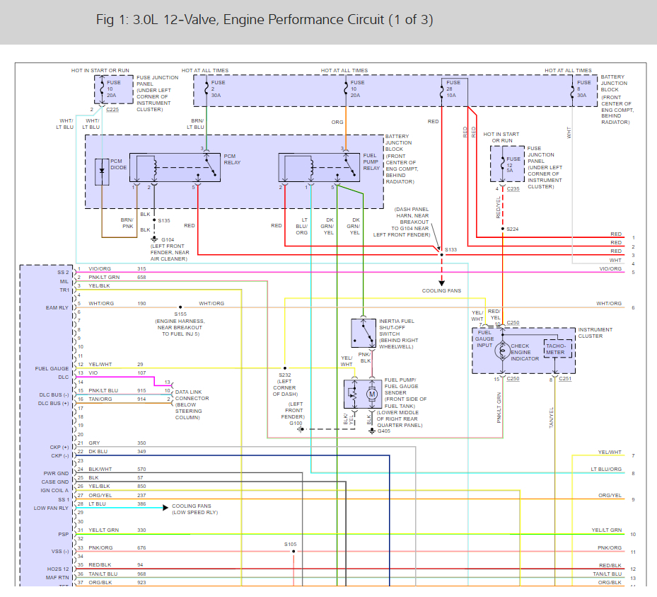

The clue is when you get one spark and then nothing. This is telling us the ECM is spending its capacitor energy and not getting recharge. This is due to a power issue like a relay or fuse. Here is the engine wiring diagrams so you can test the fuse power feed and PCM relay.
Here are some guides and diagrams (Below)
and
and
Cheers
Feb 27, 2019 at 10:50 AM
JB41073
The injectors pulse, I've also checked the EEC relay along with the EEC diode and they both check fine, just to humor myself I swap both with the A/C relay and diode. Still no spark during the crank cycle, only time I'm getting spark is when I'm letting the key go back to the run position, then it is only a single plug at random (I take it from the exciter ring making another or partial rotation). I've also checked the AC voltage for the CKP at the PCM during the crank and it is within specs. The3n I changed out the PCM relay and bam! the car started, Nice work 2Carpros you really know your stuff.

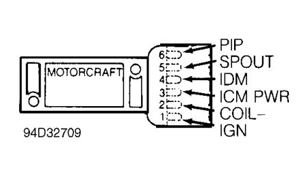

BMRFIXIT
  • 19,053 POSTS

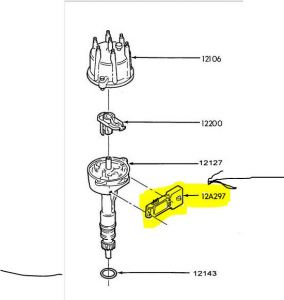

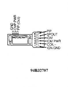

Ignition Control Module
https://images.2carpros.com/forum/automotive_pictures/99387_Capture1_6.jpg

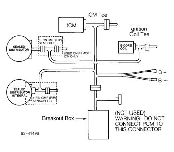

I went back and redid my tests. I disconnected the wire coming up to the coil. That particular connector has two terminals (female) and of course, the coil has the male connectors. I took a DC test light and put a probe into one of the terminals on the female connector and turned the key on, and proceded to ground the other end of the DC test light and the light went on. I turned the key off and the light went out. I'm assuming that there is the proper current coming up to the coil via that connector. I proceded to reconnect the connector to the coil hooked up the DC test light again connected one end of the light to the terminal on the coil and turned the key on grounded the other end of the light and it did not go on. Should I assume from this that the coil is not good? PS thanks for the diagram of the distributor, but my car does not have that type of distributor. Mine is described as a Universal distributor that has a diescast housing with a Hall effect distributor stator.
Dec 2, 2020 at 8:54 AM (Merged)
BMRFIXIT
  • 19,053 POSTS
IGNITION COIL RESISTANCE Application Primary (Ohms) .8-1.68 Secondary (Ohms) 700-11,500 Check for PIP at the coil Use the test light ground one end of the coil and use the other to check wire at the coil Coil connected back prop the ground wire and turnkey on light should come on Crank engine light should blink
https://images.2carpros.com/forum/automotive_pictures/99387_Graphic_68.jpg
https://images.2carpros.com/forum/automotive_pictures/99387_Graphic1_714.jpg
https://images.2carpros.com/forum/automotive_pictures/99387_Graphic2_328.jpg
