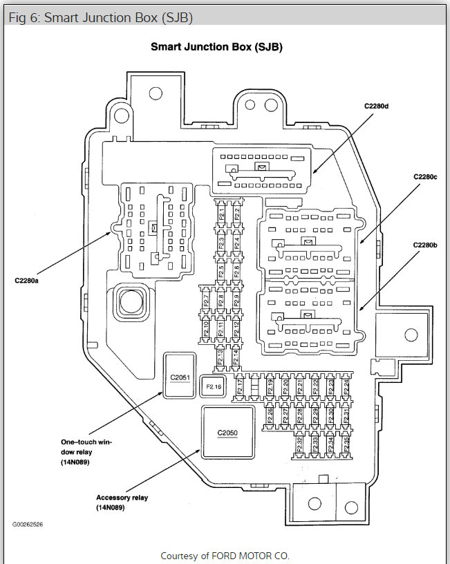

I had issues with my '04 Ranger XLT, where both driver and passenger windows would intermittently stop working. Now, with one completely down, and the other half way down, they both stopped working. I've read about a power window lockout (relay?), but not sure if that has anything to do with it. I changed the fuse, but it didn't help.
Any ideas?

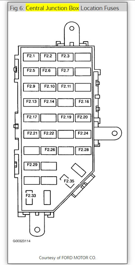

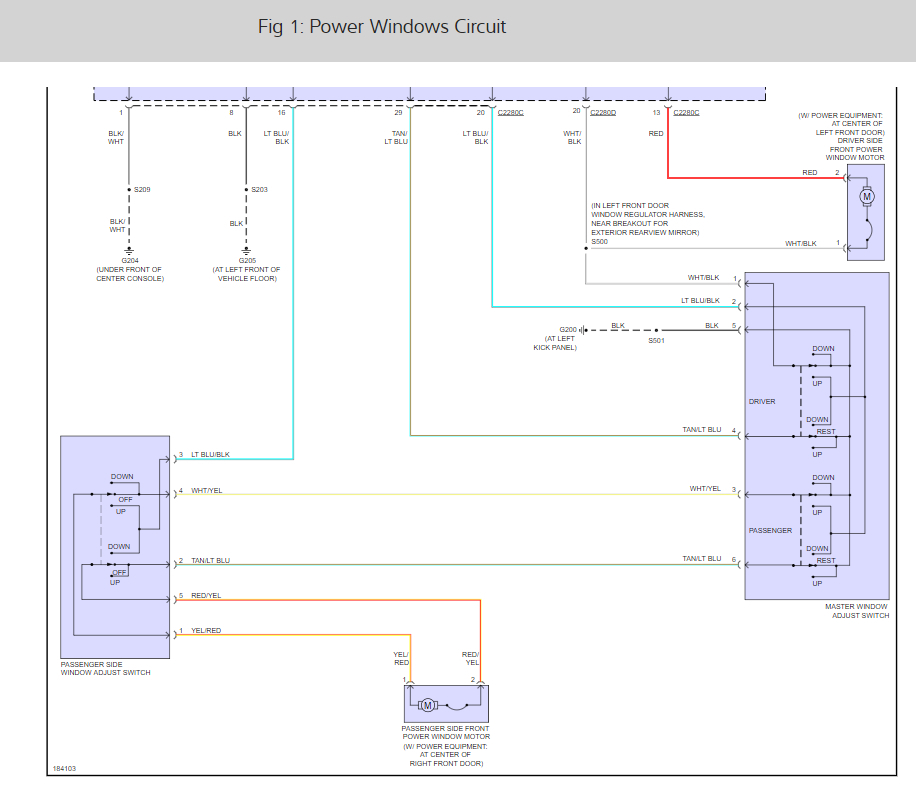

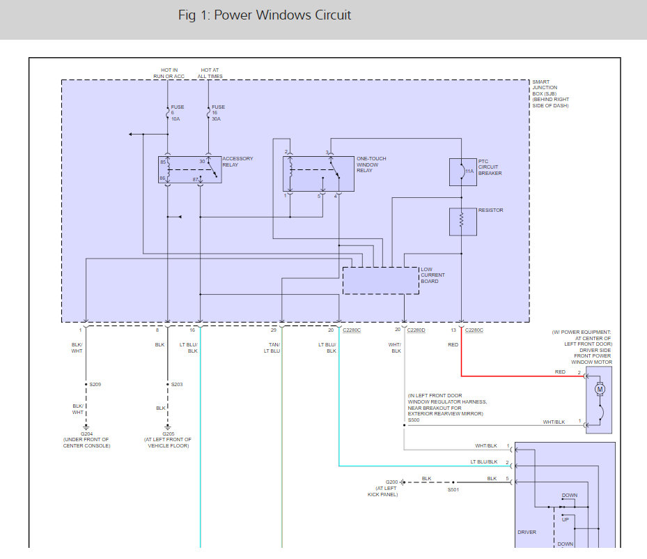

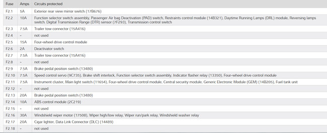

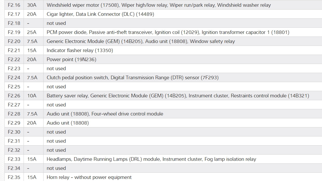

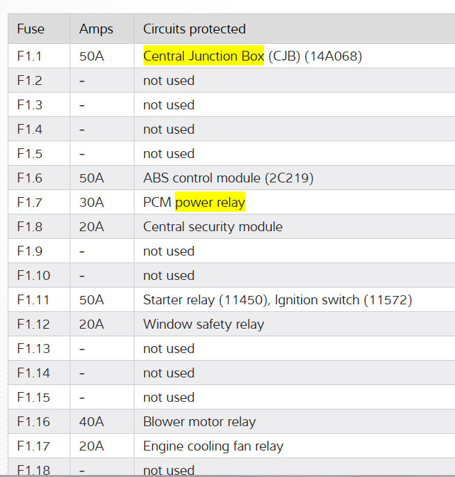

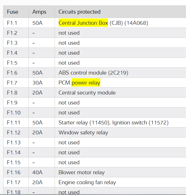

Here is a guide that will help you test to see if it is the switch (that's what is sounds like) and the window wiring and fuse diagrams so you can see how the system works below.
https://www.2carpros.com/articles/electric-window-repair
Check accessory and one touch relay and check fuse # f1.16 (30A) and # 6 (10A)

There are two wires to the motor. All the switch does is changes the polarity. Therefore, you have power in one wire when it goes down, and the other when it goes up. Check to see if that is happening.

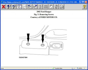

BILL THE FORD GUY
How do you remove the door panels to access the
power window mechanisms?
Jan 2, 2020 at 11:09 AM (Merged)

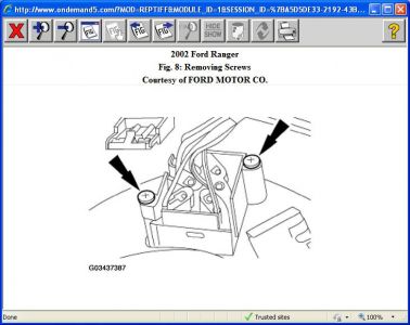

SATURNTECH9
  • 30,869 POSTS
https://images.2carpros.com/forum/automotive_pictures/416332_2002_ford_ranger_door_panel_removal_part1_1.jpg
https://images.2carpros.com/forum/automotive_pictures/416332_2002_ford_ranger_door_panel_removal_part2_1.jpg
https://images.2carpros.com/forum/automotive_pictures/416332_2002_ford_ranger_door_panel_removal_part3_1.jpg
https://images.2carpros.com/forum/automotive_pictures/416332_2002_ford_ranger_door_panel_removal_part4_1.jpg
https://images.2carpros.com/forum/automotive_pictures/416332_2002_ford_ranger_door_panel_removal_part5jpg_1.jpg
First of all thank you so much for your donation.I posted the instruction's on how to remove your door panel's for you.

When you say you by-passed the motor, do you mean the switch? Also, to get the window back up, you need to reverse the polarity to the motor. Basically, there are two wires running to the motor. Power to one of them puts the window down. Power to the other wire puts the window up. As far as a ground, the motor is grounded through the door.
