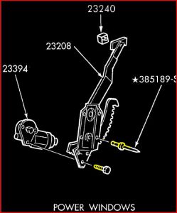

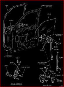

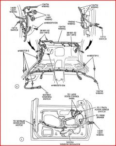

Is there anyplace I can see a manual of this door? It looks like someone has been in here before.
Jan 2, 2020 at 11:10 AM (Merged)
BMRFIXIT
  • 19,053 POSTS
https://images.2carpros.com/forum/automotive_pictures/99387_Capture_14.jpg
https://images.2carpros.com/forum/automotive_pictures/99387_Capture1_7.jpg

BMRFIXIT
  • 19,053 POSTS
https://images.2carpros.com/forum/automotive_pictures/99387_Capture2_2.jpg
