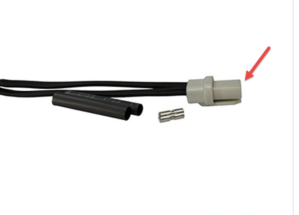

Need diagram and information as to how to disconnect the power window harness from the door switches.
Oct 24, 2016 at 4:35 AM
HMAC300
  • 48,601 POSTS
they have connectors inside the doors and switches. actually it is one big connector for locks and windows at switches. picture shows connector at motor/latch.

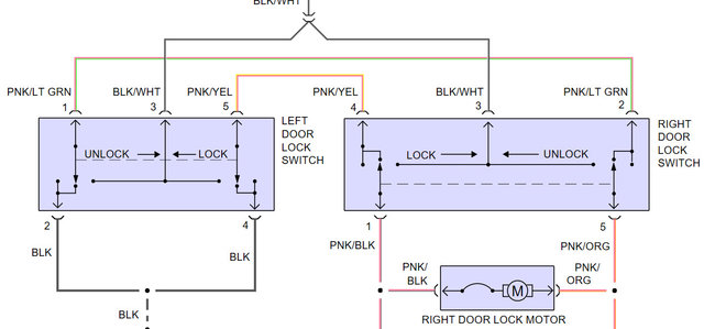

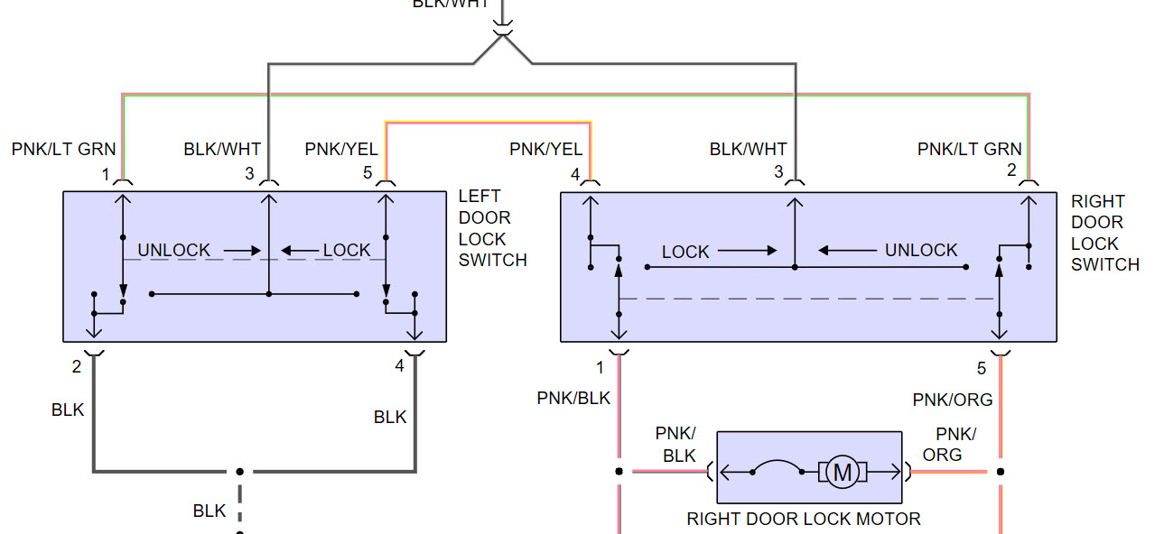

forgot diagram of door lock switches .......
