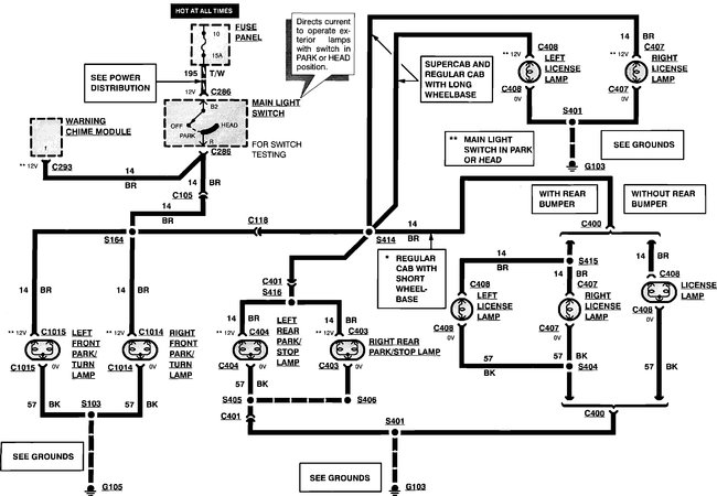

Headlights don't come on, hazards and turn signals are fine. Fuse not blown. What could be wrong? Could it have anything to do with my screwdriver ignition? The key setting is turned to on though.
Wednesday, June 2nd, 2021 AT 1:55 PM (Merged)
BMDOUBLE
  • 1,139 POSTS
Check the brown wire out of the headlight switch for 12 volts, also verify that grounds are good at the bulb sockets. I'll include the wire diagram to help you with this. Your screwdriver ignition shouldn't have anything to do with this because this circuit's fuse is hot at all times.
