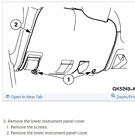

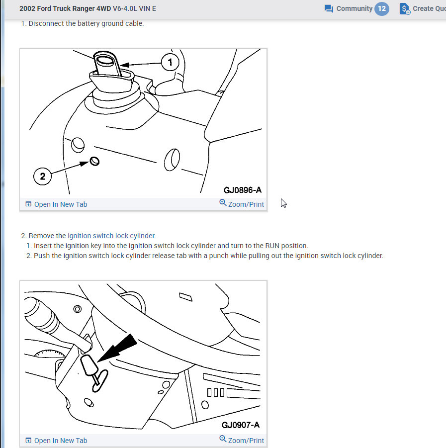

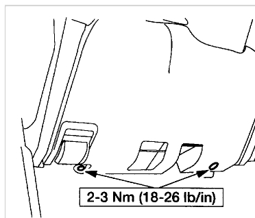

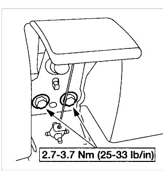

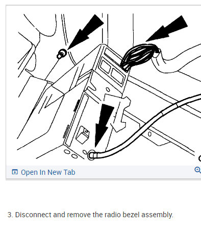

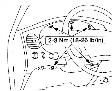

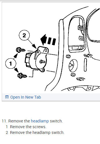

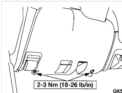

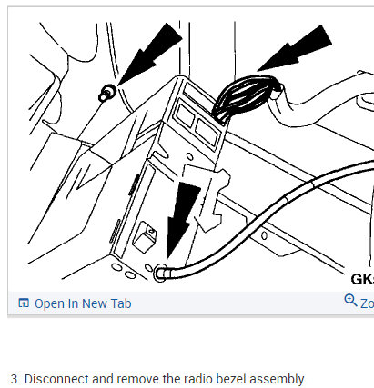

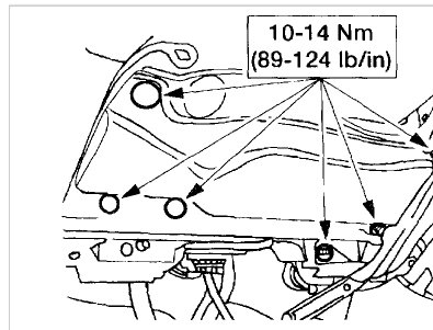

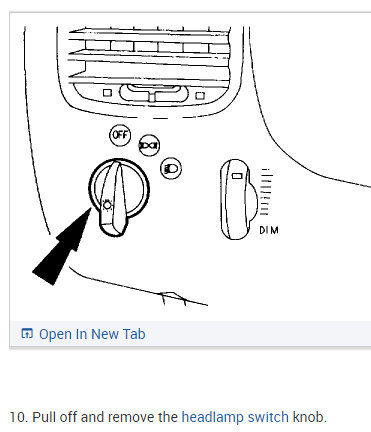

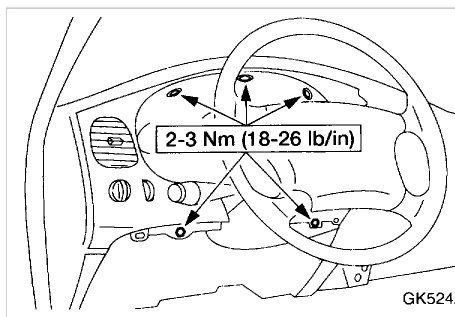

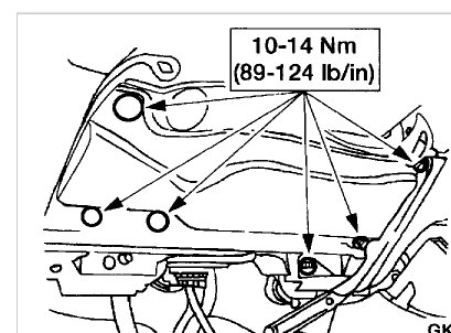

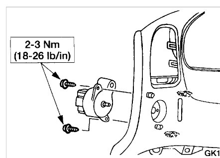

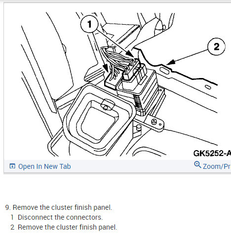

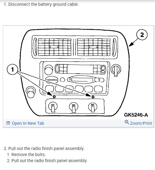

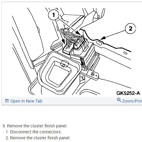

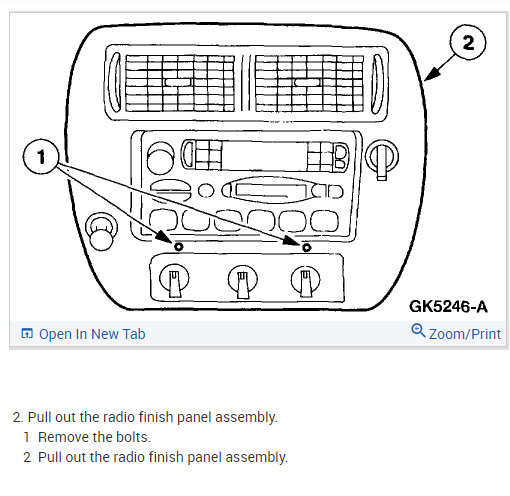

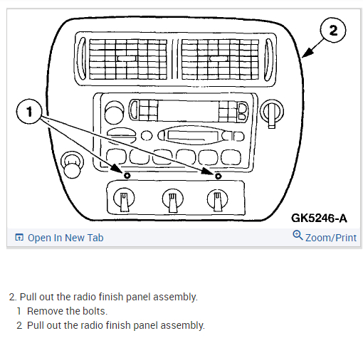

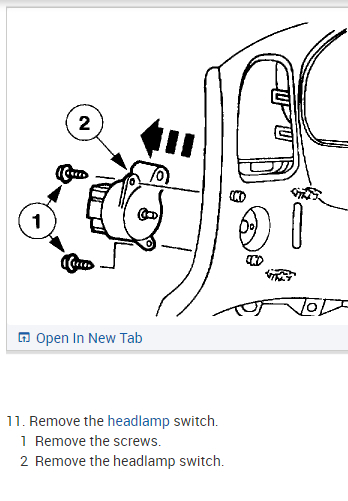

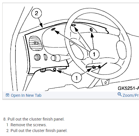

A few days ago I went on a short trip and it became night and my headlamps did not come on when turning on the switch. What did happen is the high beam indicator light stays on when the lights are in the on position. Using the high beam activator does not turn it off and the head lamps never come on low or high.
Aug 3, 2010 at 9:29 AM
DANNY L
  • 5,648 POSTS

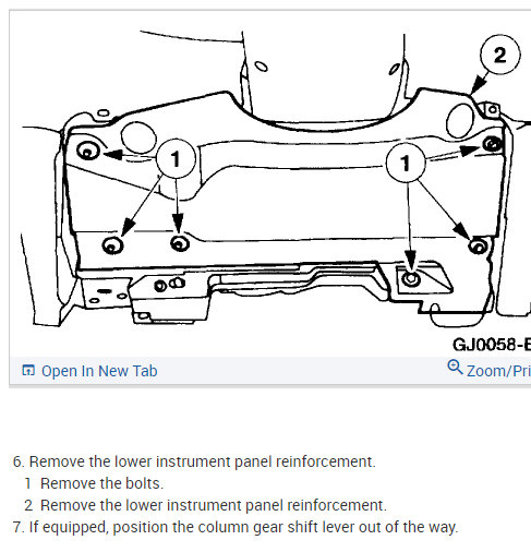

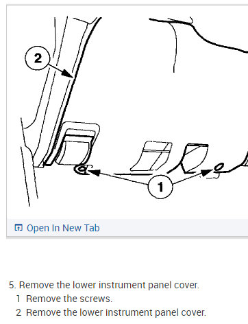

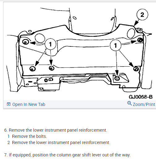

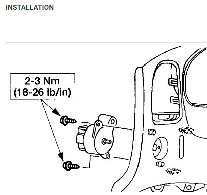

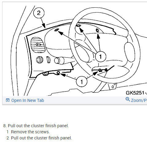

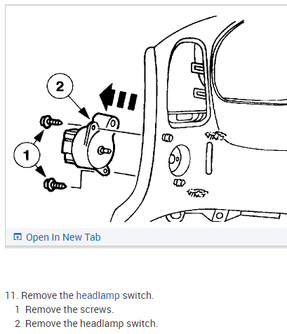

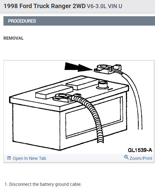

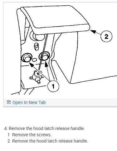

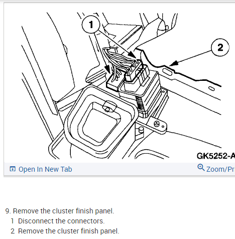

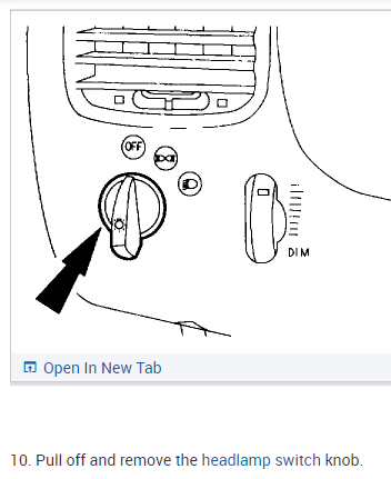

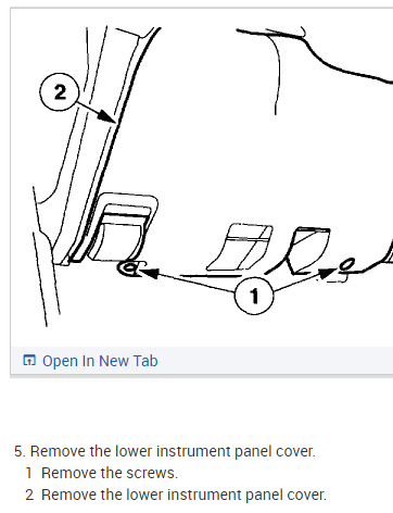

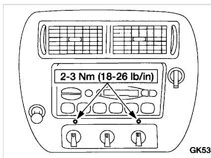

Hello, I'm Danny.

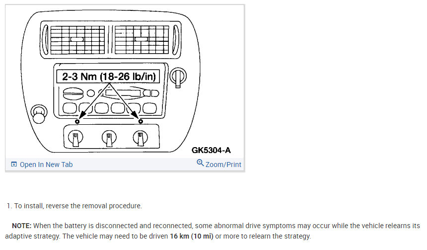

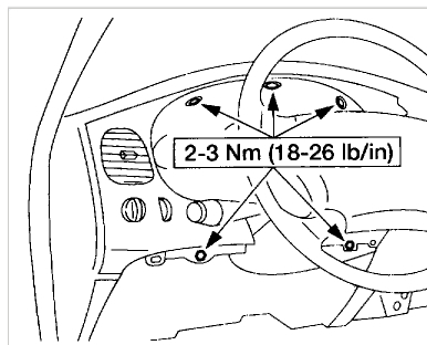

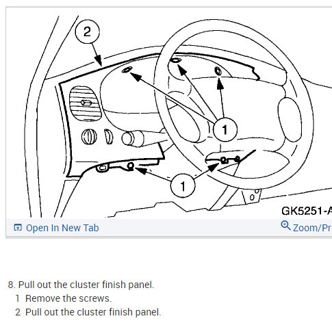

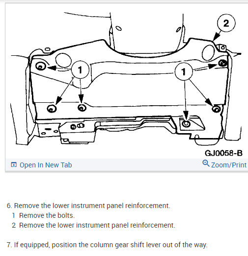

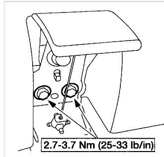

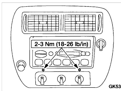

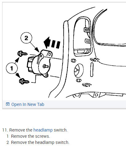

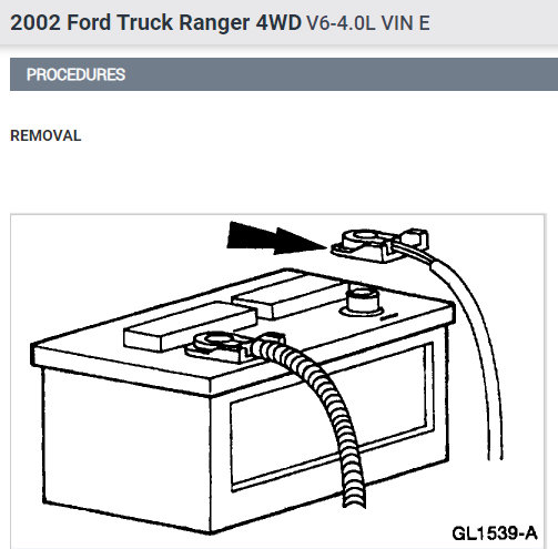

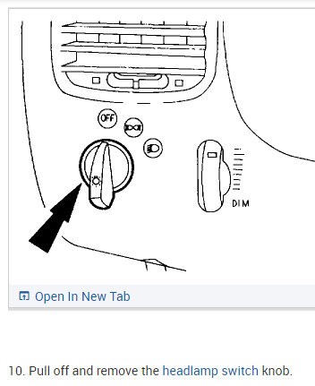

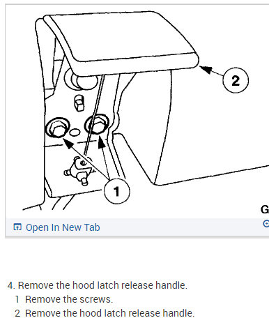

It sounds like you might be having an issue with a faulty headlight switch. I've attached picture steps below on how to remove and replace the headlight switch on your truck. Hope this helps and thanks for using 2CarPros.

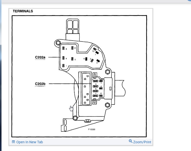

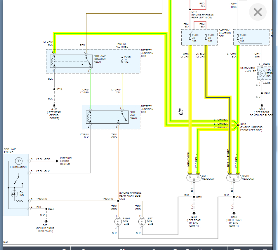

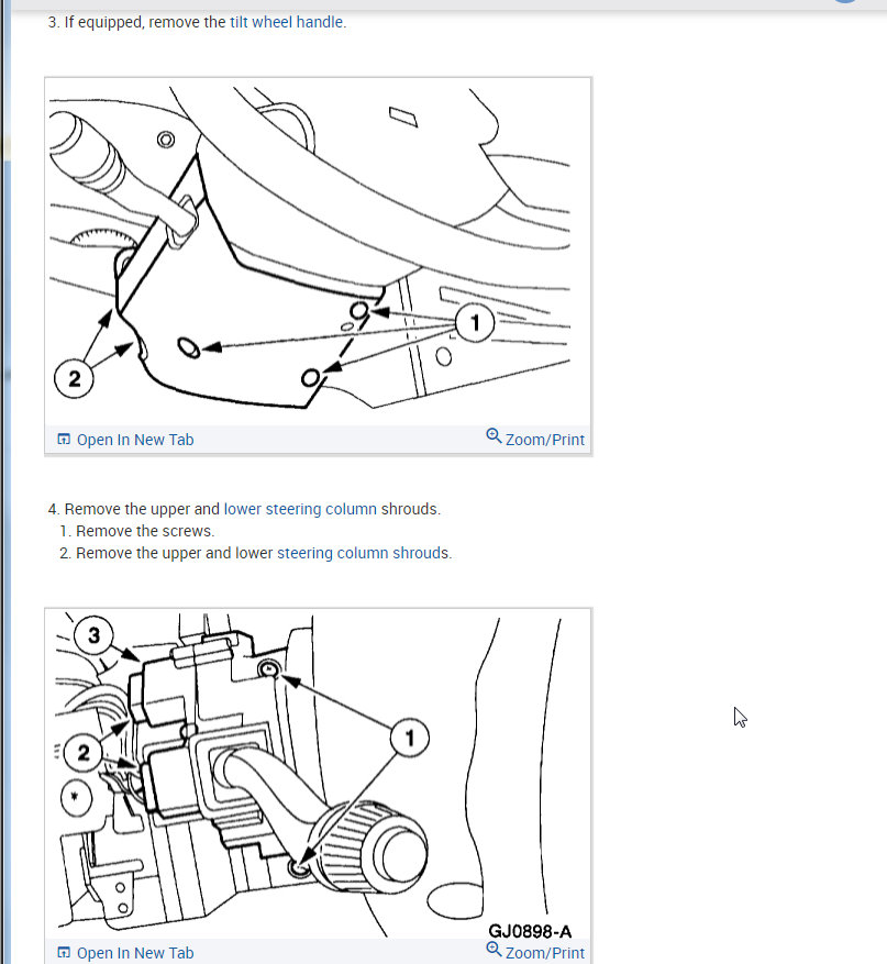

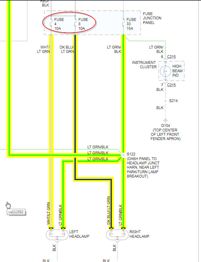

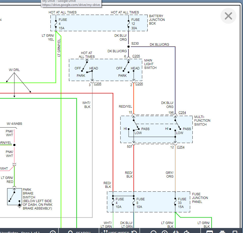

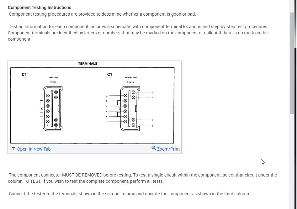

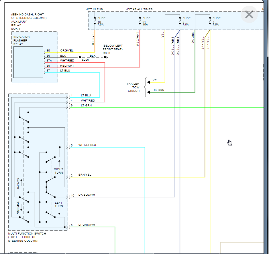

It is unlikely that this is a fuse issue but we need to check voltage at the multifunction switch to see if the lights are being commanded on. I attached the wiring diagram below for your review.
Also, I suspect this is a switch issue so I suspect we need to replace it and I attached the info below on how to do this.

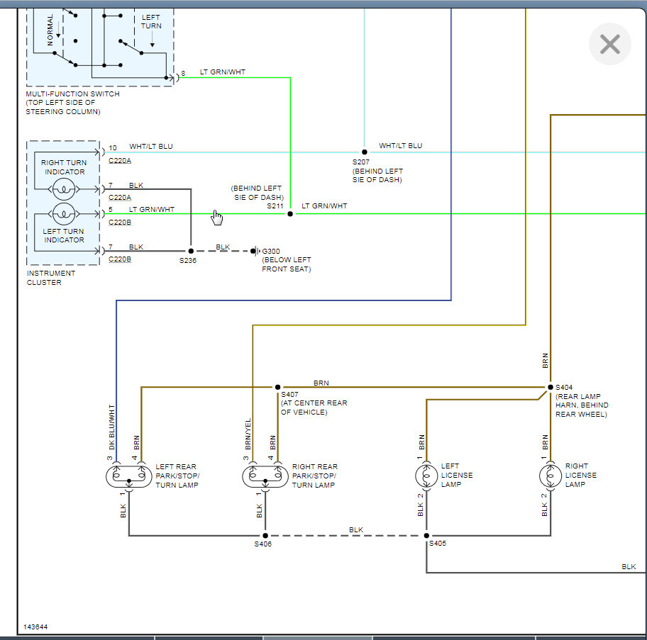

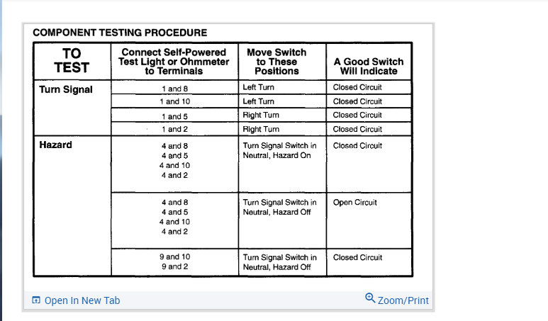

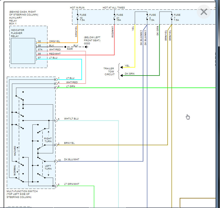

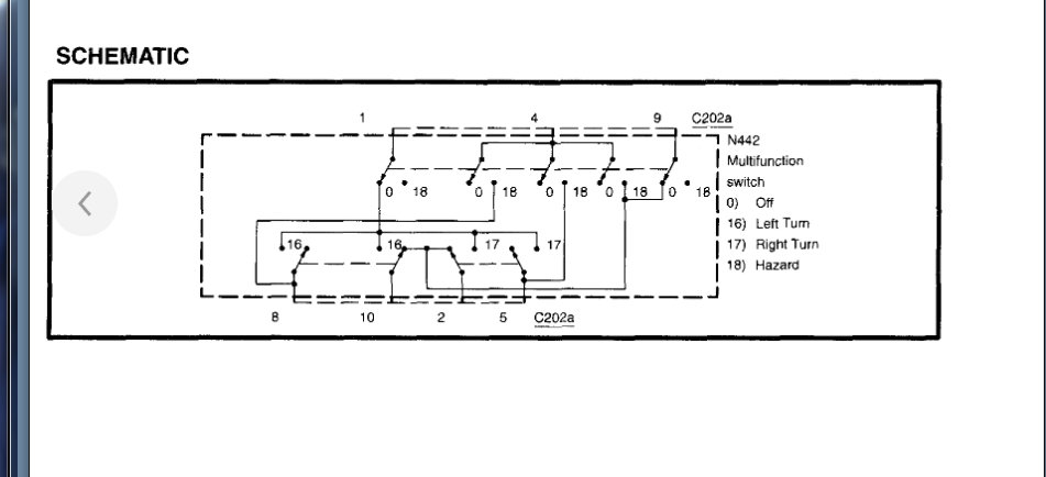

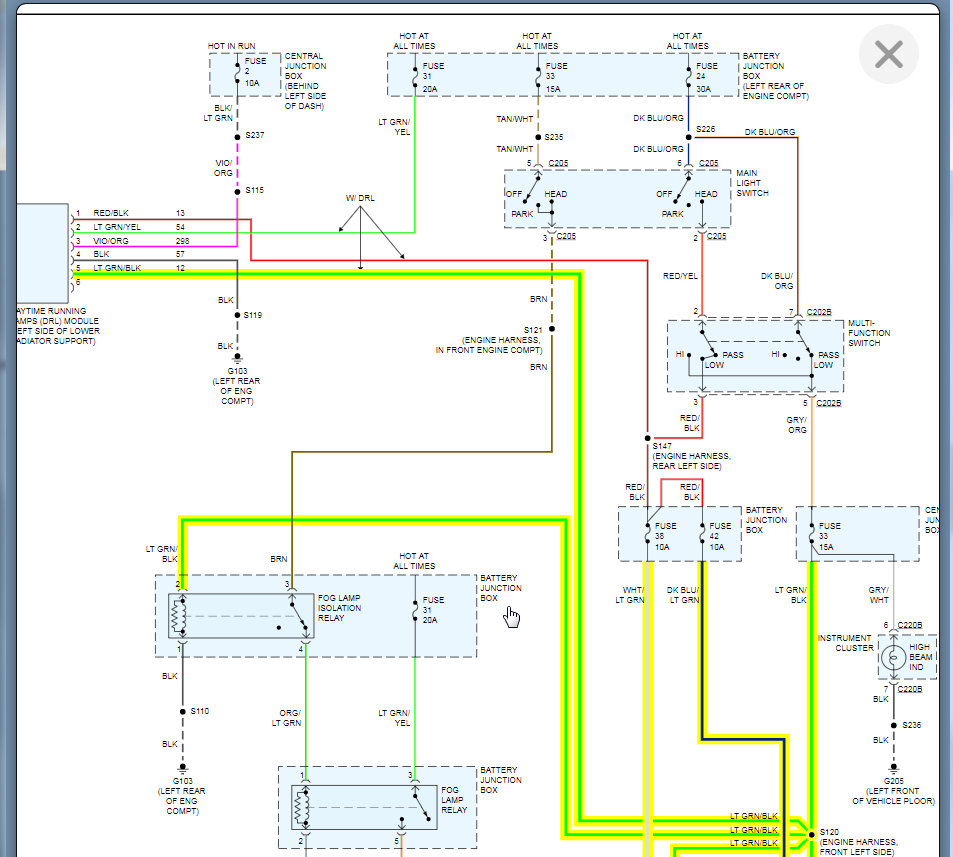

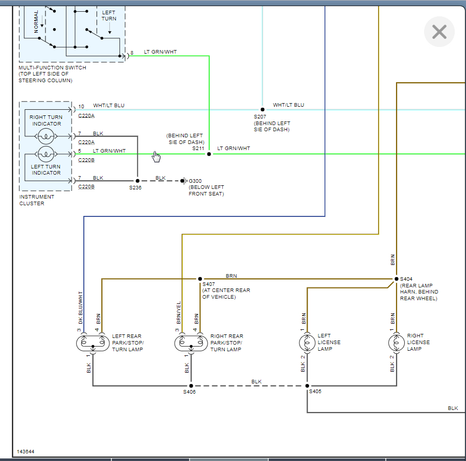

I'm working on my friends Ford Ranger, mileage unknown. All the exterior lights work accept the high beams. When using the turn signals and the 4-ways, only the rear ones work. The front ones don't come on. When the running lights are on, the front amber's come on, but don't flash. Any insight to these problems?
Jun 2, 2021 at 1:54 PM (Merged)
More than likely this is the multi-function switch. If you look at the wiring diagram, both the hazards and high beams run through the switch. It is odd that only the front hazards don't work but again this is the only thing that makes sense for both of these to not work. I included the test to proved this out because there is always a chance that you have two separate issues. However, I would track this down first or just go ahead and replace it as they are not that expensive.

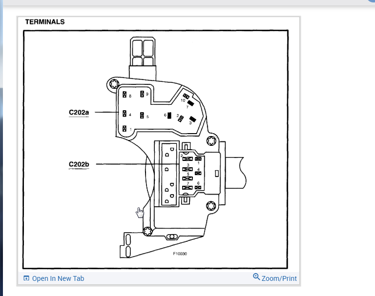

Couple questions. First does the high beam indicator work as well? If it does then I suspect we have an issue with the multifunction switch. The way this works is when you turn the switch to the low beams, it puts power through on the two circuits that I circled below.
Then when you switch to high beams, the switch actually changes to a different circuit internally and controls the voltage through on the same circuits. So if both low beams are not working then I would replace the switch and go from there.

Regular headlights do not turn on, but yes when I do the high beams that works and hi beam indicator does turn on as well.
Okay. Then assuming you have the same 1999 Ranger, I am confident that the switch is the issue. Here is that video again on how to replace it:

When light switch is turned on, the Red/Black wire must be HOT, if not the switch is faulty.
If Red/Black is HOT, check fuse # 4 and # 8 ( 10 A fuse in underdash fuse box).
At the headlights if there is voltage to the White/Light Green and Dark Green/Light Green wires, the bulbs are bad.

Fuse 33 is for the high beams.
When wires age, they tend to have higher resistance and this would result in them heating up. Ensure the wires clamped onto the terminals are tight and if the wire is old, you might have to consider replacing it. Ensure the terminals are tigh as well, a loose fitting would cause heat to build up.
One way of overcoming overheating of the headlight circuit and and prolonging the light switch life span is to install a relay and let it handle the high wattage rather than letting the high wattage go pass the light switch and wirings.

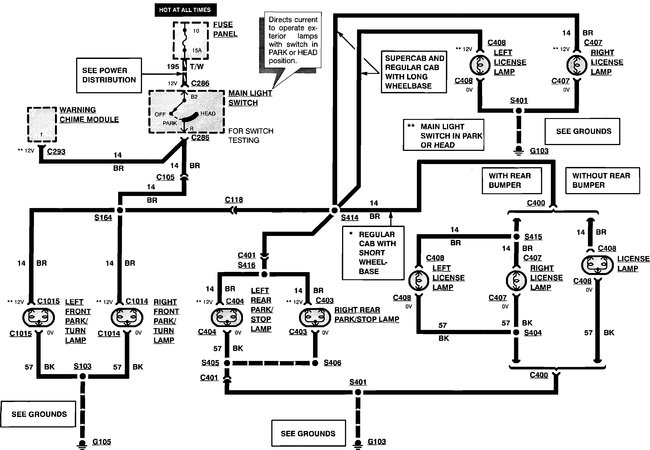

BMDOUBLE
  • 1,139 POSTS
Check the brown wire out of the headlight switch for 12 volts, also verify that grounds are good at the bulb sockets. I'll include the wire diagram to help you with this. Your screwdriver ignition shouldn't have anything to do with this because this circuit's fuse is hot at all times.
