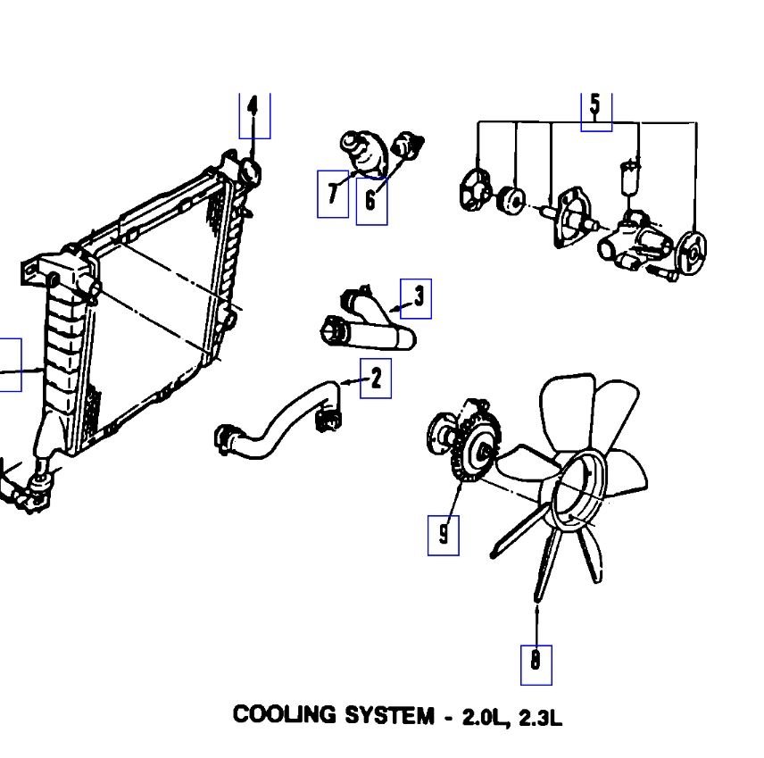

I overheated my truck and had to drive it a little farther than I should have to get to a safe place before stopping (my home). This was late at night. The next morning I filled the radiator with water and found that the water just poured out of the engine (not the radiator).
I am assuming one of two things: either I blew the head gasket or I cracked the block. I have not taken it to the mechanic yet due to towing costs, etc.
Several days later, I needed to move the truck over about a foot so I clenched my teeth and turned the key to see if I could accomplish that task. It started right up and I was able to back it a few feet and move it over. I did not drive it anywhere and do not plan to.
My question: Does the fact that it actually started after such a fiasco indicate that it might only be the gasket and not the block? And are there also other possibilities?
Monday, July 26th, 2010 AT 6:15 PM
BLUELIGHTNIN6
  • 16,542 POSTS
To just pour water out like that , I would look under it for a blown hose first. The hose blowing may have caused the initial overheating condition. To crack a bock to the point water just runs out is pretty unlikely... not impossible but unlikely
