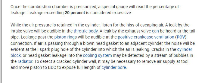

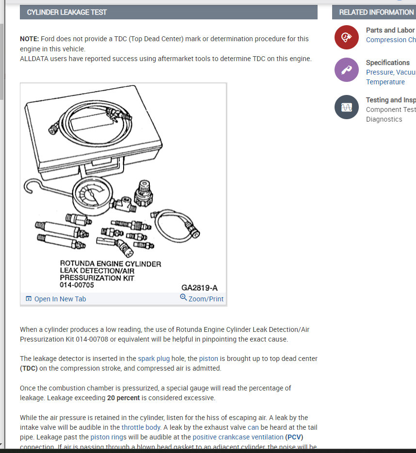

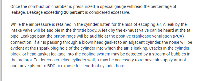

Also, we can do a cylinder leakage test. I am attaching the info from the manual on how to do this.
Please run through this material and let us know if you have questions.
