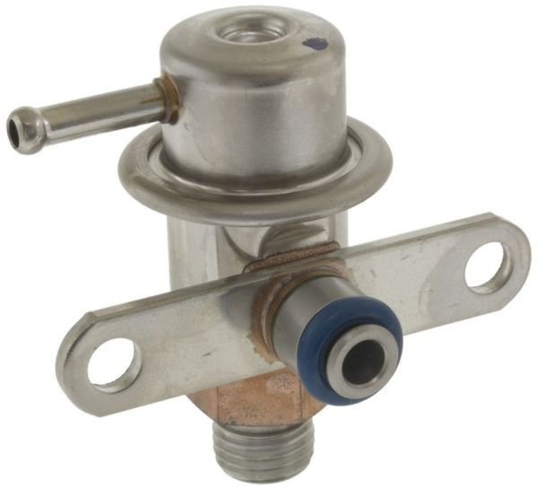

Nothing is making any sense on this truck. Alldata says the regulator is on the fuel rail. If you have a return line at the filter, then the filter has to be the regulator because if it was in the tank, it would return right back into the tank, It wouldn't be piped out of the truck.
I Googled the regulator and all but one pic shows the rail regulator below. One pic showed an in tank assembly with a regulator.

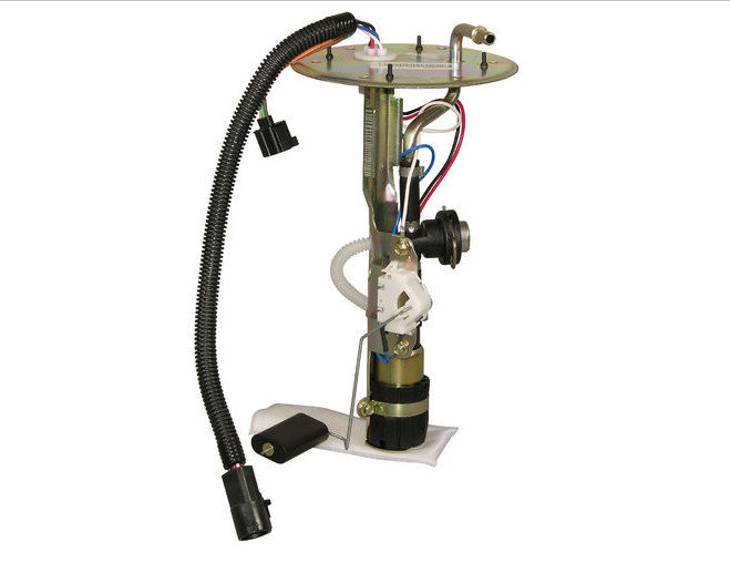

The following link goes to the pump I have. You will see there are 3 connections. My information is that there is a fuel pressure damper. I have the advantage of having the old pump and rack to look at. There are various sources describing the system as non return. he ford manual I have shows the component on the front passenger side of the rail. There is no return line.
https://www.showmethepartsdb.com/bin/showmeconnectdll.dll?lookup=partprint&part=000566496&id=98756AXFPWEB&storeid=&userid=
Wednesday, May 1st, 2019 AT 6:36 PM (Merged)
WRENCHTECH
  • 20,761 POSTS
A damper and a regulator are 2 entire, y different things. The damper merely smooths out the flow. This system is returnless from the filter to the engine but the pump is a return type pump. The filter has to be the regulator. That pump has a fuel out, a fuel in and a vapor line.

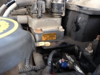

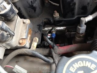

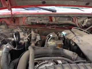

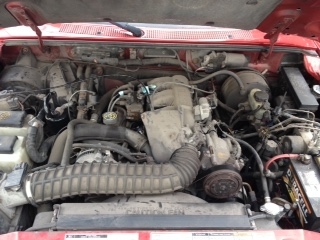

Yep I read through the post and conflicting information is tough to work with, it will hurt the cat for sure if it continues, can you post some pictures of the engine and fuel system so we can see what we have to deal with?

Ken, to recap the history. The truck died on me and would not start. Problem was diagnosed as fuel pump. New pump was installed and truck ran. Hesitated a little on acceleration in higher gears and took some time say 5 seconds after being shut down. Pump was checked and only running at 50 PSI. Pressure dropped to zero immediately when shutting off. Pump was seen as problem and was replaced with another new one. Same situation.
To confirm pump was OK, pinched fuel return line from filter and pressure immediately increased tom 80 PSI.
Contacted pump assembly manufacturer and he agreed problem was with pressure control valve.
Checked the old assembly with air pressure and it went up to 65 PSI and then released as indicated in manual.
Now in discussion with garage to replace pump third time and want to be sure that I do not damage engine if negotiation becomes a hassle.
Because of the cost of the pump I was charged, I am not going to give up easily so if they do not give in quickly, I want to be sure I do not further damage the engine as all in all it has served well for the ten years I owned the vehicle. And I want to run in for another 6-8 mos before replacing.

The engine should be okay, what is the truck doing now? Thanks for the pictures they help.
