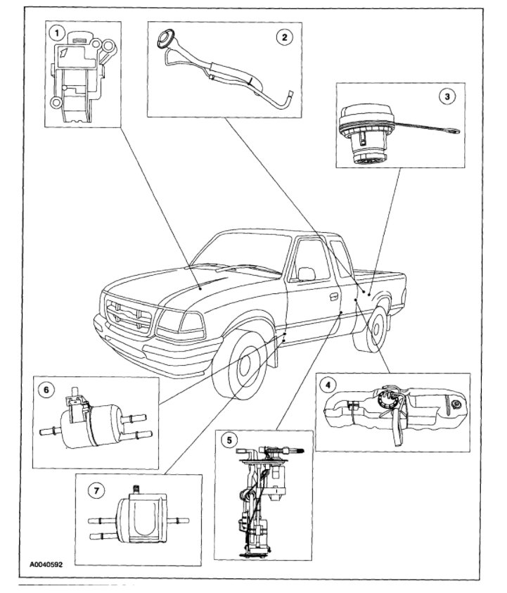

my 94 rangers fuel pump will not come on. new pump & filter. can connect from battery to pump and comes on but not when you turn the ignition key. tried everything i can think of anyone else have any suggestions.

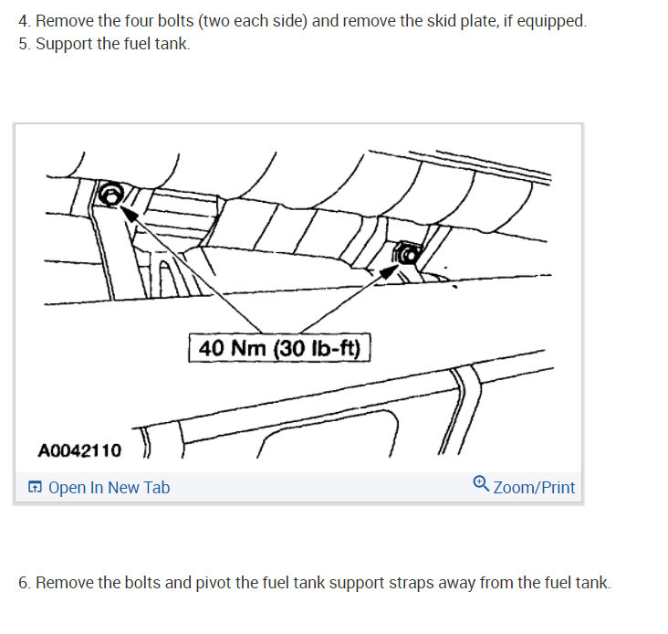

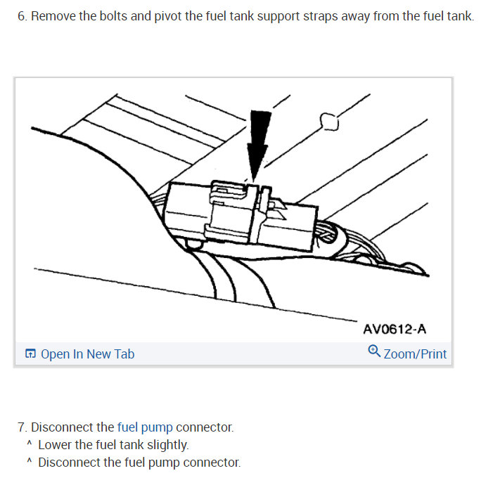

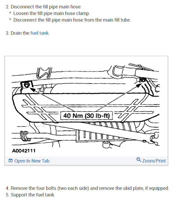

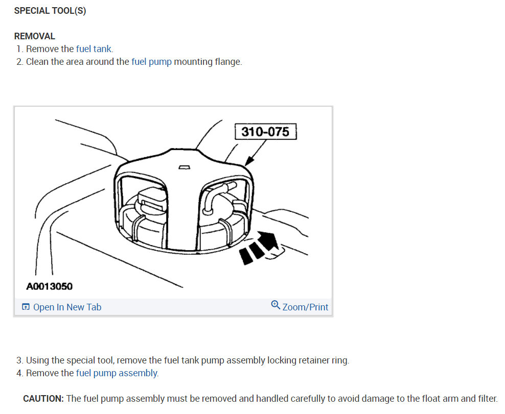

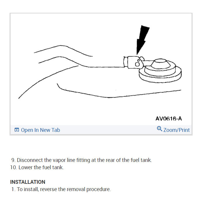

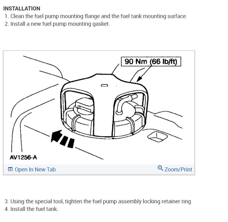

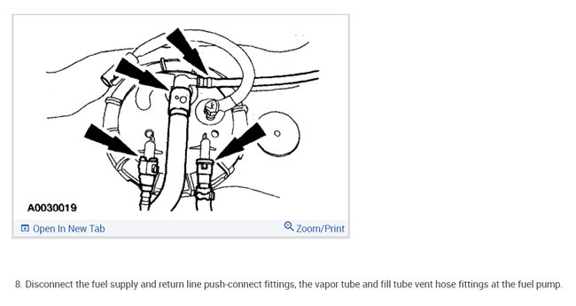

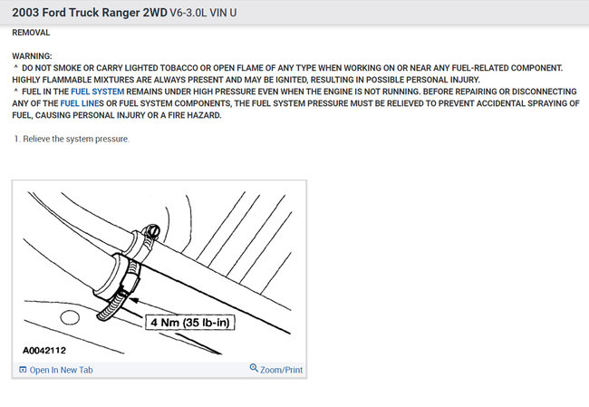

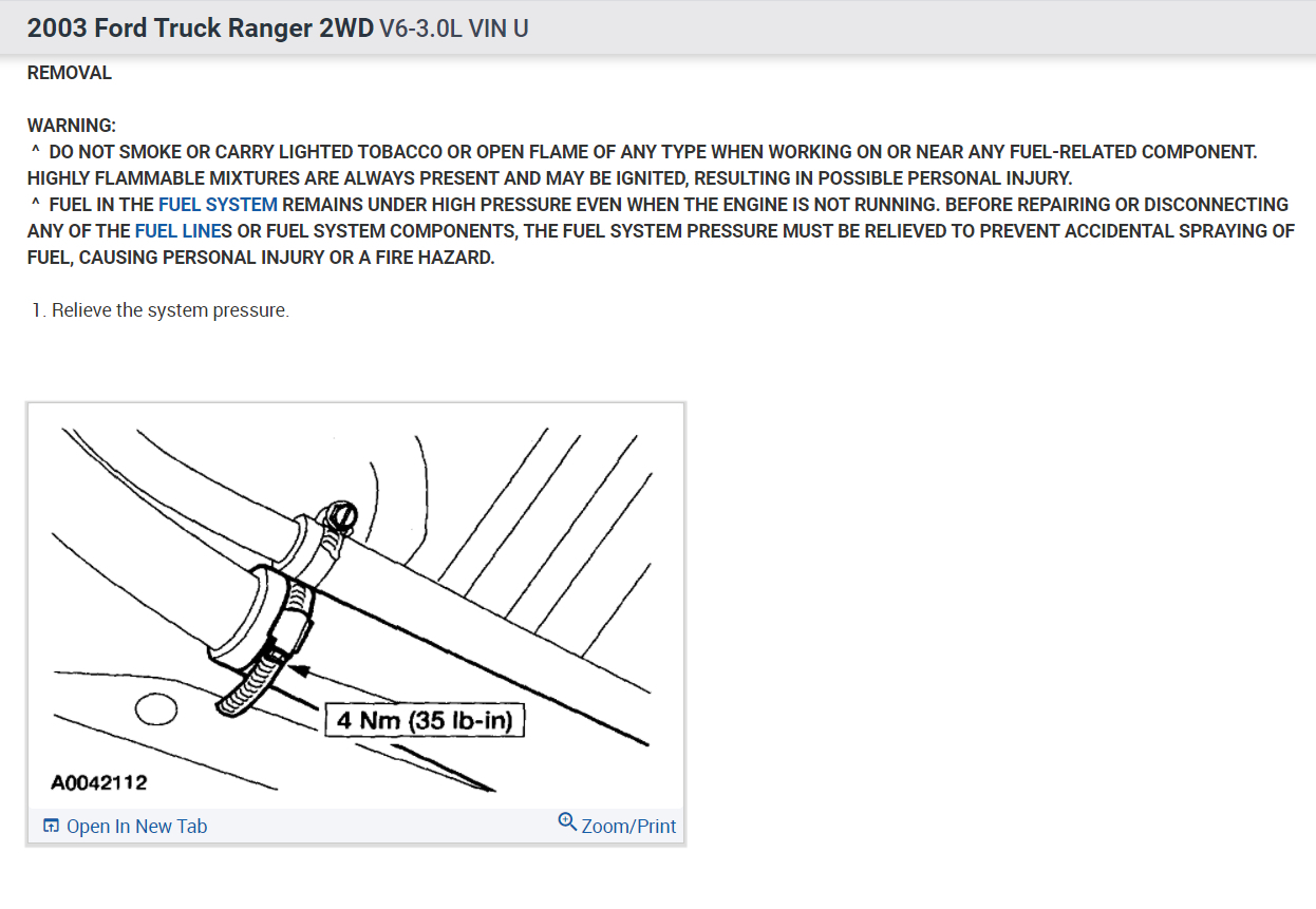

it sounds like the pump has failed which is common here is a guide to help walk you through the steps with instructions in the diagrams below to help you with your car.
https://www.2carpros.com/articles/how-to-replace-an-electric-fuel-pump

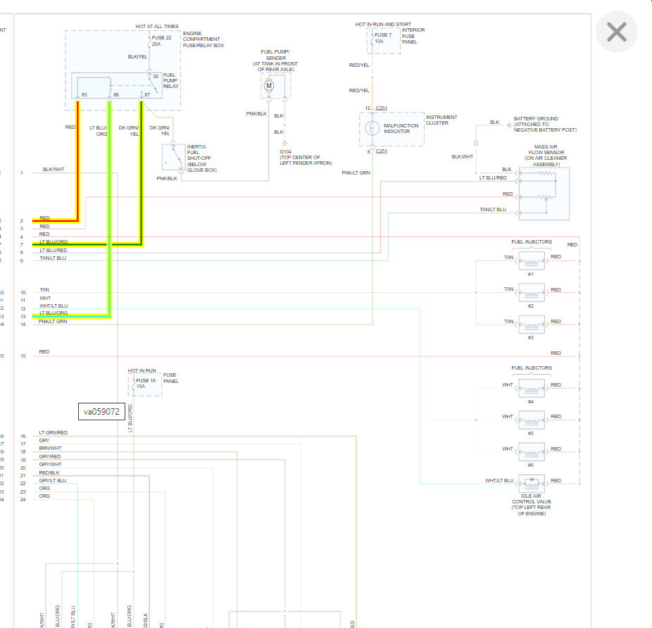

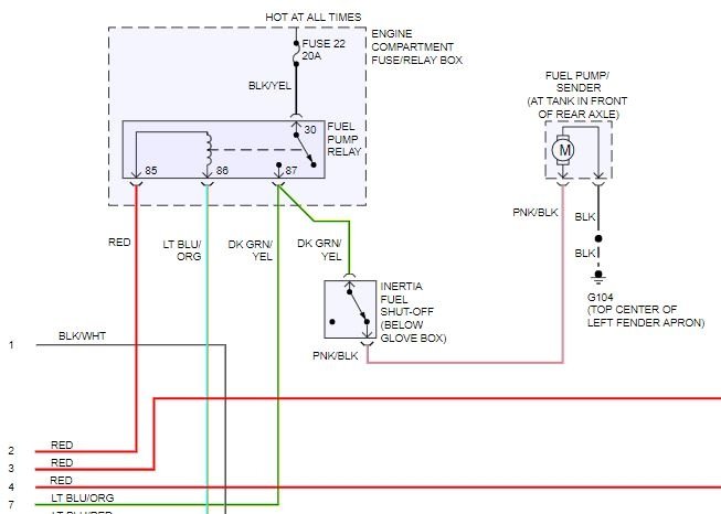

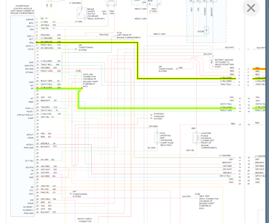

If the pump comes on and supplies pressure when you apply voltage then we most likely have a voltage issue. So we need to make sure the pump is not just coming on with no pressure.
However, I am including the wiring diagram below for this issue as well.

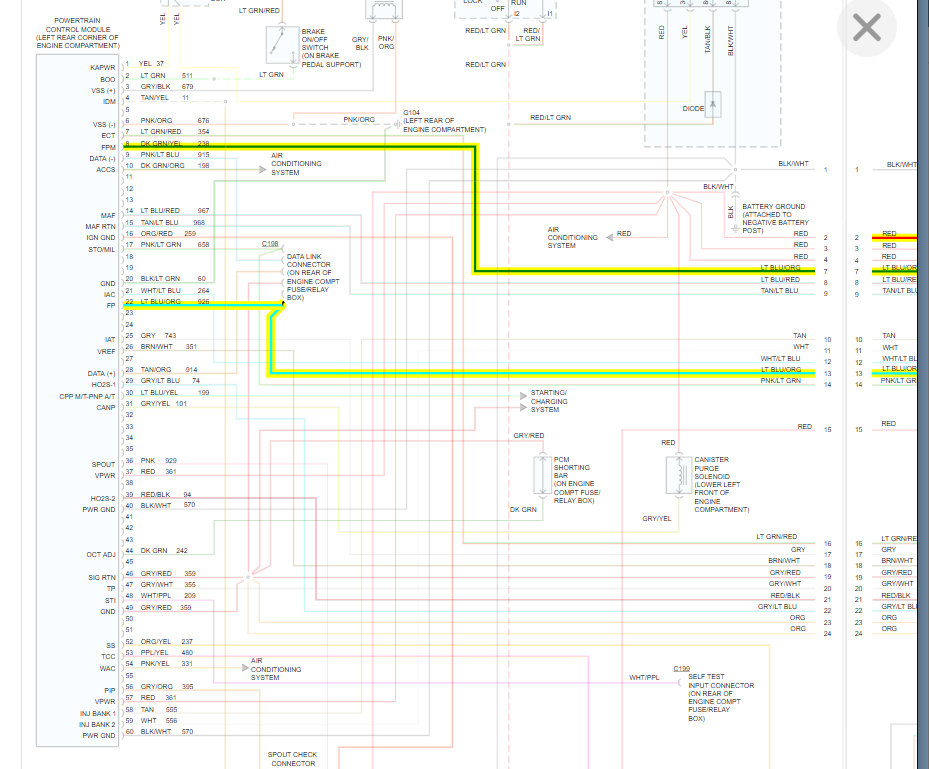

If you check the voltage at the relay you should have 12 volts on the red wire which is the voltage supply and then the PCM grounds that circuit on the Light Blue Orange wire which will close the relay. Then if the inertia switch is closed it will supply voltage to the pump. So we could have a relay or switch issue as well.
Check out the diagrams (Below). Please let us know what you find.

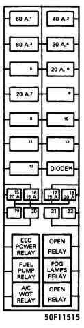

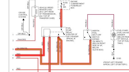

Have you performed any diagnosis on the vehicle yet? Checked fuses/relays and/or inspected the wiring to the fuel pump? Below is a wiring diagram for the fuel pump system on your vehicle. I've also attached a diagram of the under-hood fuse box showing the location of the fuel pump relay and fuel pump fuse(fuse 22). Let me know what you find.

Sounds like the PCM control of the relay has gone bad. The power for the fuel pump comes originally from fuse no. 22 20amp, when the computer energizes the relay it powers up the pump thru the inertia switch this is how it works

Okay, checked PCM relay gets hot on yellow wire constant tan and black wire gets hot when ignition is on grounds. checked fine however pin 85 red wire at Fuel pump relay does not get hot ignition on .has New fuel pump and ignition switch. please help

Disconnect the inertia switch and splice/tap into the pink and black wire make sure you use the same size wire with an inline fuse 10amp -install the toggle switch where you can reach it go thru the firewall straight to the battery positive terminal-your done
https://images.2carpros.com/forum/automotive_pictures/12900_fp1_12.jpg

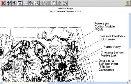

PCM location -see below
https://images.2carpros.com/forum/automotive_pictures/12900_pcm_8.jpg
Nov 24, 2020 at 8:52 AM (Merged)
FORD_BOY
  • 13 POSTS
that pic is it for the 1994 ford ranger xlt v6 3.0???
it looks like the pcm is close to the distrubition box under the hood would you just replace that or use the switch which would be better in my situation is the pcm just a simple unplug and plug in the new one
  • 75,992 POSTS
Its for a 3.0L engine-The PCM is an unplug and plug deal-The toggle switch method requires more time-But if its me lacking funds I'll go for the latter part just to buy time till I can afford a PCM.
